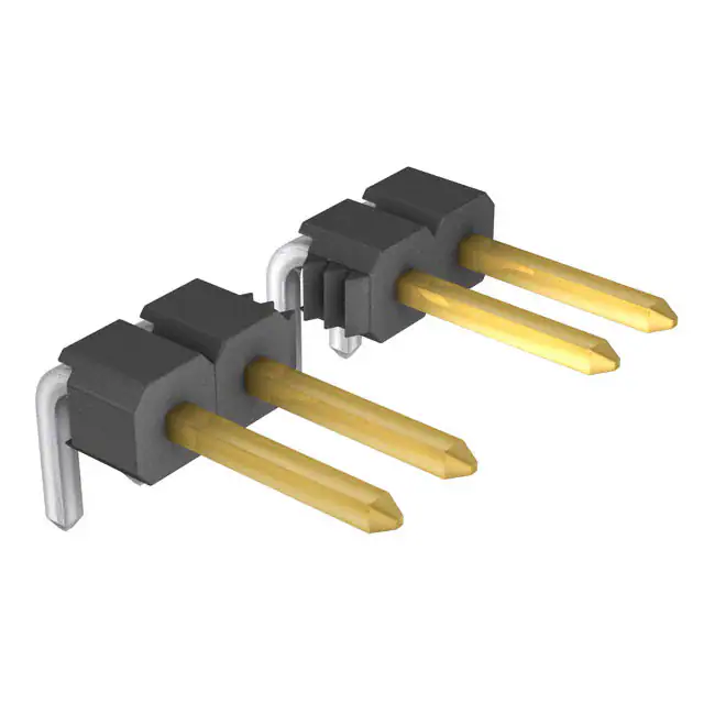

3M™ Pin Strip Header 2.54 mm and 2.54 mm x 2.54 mm, Right Angle, Solder Tail 961 Series • High temperature dielectric • “No lead” wave and reflow solder compatible • End stackable feature • Single- and dual row version • Mates with boardmount and wiremount products • RoHS Compliant. See the Regulatory Information Appendix (RIA) in the RoHS compliance section of www.3Mconnectors.com for compliance information (RIA E1 & C1 apply) Date Modified: November 26, 2012 TS-2182-C Sheet 1 of 2 Physical Insulation Material: High Temperature Thermo­plastic Flammability: UL 94V-0 Color: Black Contact Material: Copper Alloy Plating Underplating: 1.25–2,5 µm [50–100 µ’’] Nickel Wiping Area: Flash Gold Solder Tail Area: 1–3 µm [40–118 µ’’] Matte Tin Electrical Current Rating: 2 A Insulation Resistance: > 5 x 108 Ohm at 100 VDC Withstanding Voltage: 1000 VDC Environmental Temperature Range: -25 °C to +105 °C Processing Temperature: max. 260 °C (Profile per J-STD-020C) Moisture Sensitivity Level: 1 (per J-STD-020C) UL File No.: E68080 Interconnect Solutions www.3Mconnectors.com 3M is a trademark of the 3M Company For technical, sales or ordering ­information call your Local 3M Service Center 3M™ Pin Strip Header 2.54 mm and 2.54 mm x 2.54 mm, Right Angle, Solder Tail 961 Series PCB Layout n = No. of Contacts Tolerance Unless Noted [mm] Nominal Size 0.5–3 3–6 6–30 Linear Dim +/- 0.1 +/- 0.1 +/- 0.2 Radii +/- 0.2 +/- 0.5 +/- 1 30–120 +/- 0.3 +/- 1 Ordering Information 961XXX 5X04 AR (RIA E1 & C1 Apply) Rows: 1 = 1 Row 2 = 2 Row Contact Quantity: 02–36 Pins / 1 Row 04–72 Pins / 2 Row Mating Pin Length: Dim ‘B’ 6 = 6.1 mm [.24] 8 = 6.9 mm [.27] TS-2182-C Sheet 2 of 2 Interconnect Solutions www.3Mconnectors.com 3M is a trademark of the 3M Company For technical, sales or ordering ­information call your Local 3M Service Center Important Notice All statements, technical information, and recommendations related to 3M’s products are based on information believed to be reliable, but the accuracy or completeness is not guaranteed. Before using this product, you must evaluate it and determine if it is suitable for your intended application. You assume all risks and liability associated with such use. Any statements related to the product which are not contained in 3M’s current publications, or any contrary statements contained on your purchase order shall have no force or effect unless expressly agreed upon, in writing, by an authorized officer of 3M. Warranty; Limited Remedy; Limited Liability. This product will be free from defects in material and manufacture for a period of ninety (90) days from the time of purchase. 3M MAKES NO OTHER WARRANTIES INCLUDING, BUT NOT LIMITED TO, ANY IMPLIED WARRANTY OF MERCHANTABILITY OR FITNESS FOR A PARTICULAR PURPOSE. If this product is defective within the warranty period stated above, your exclusive remedy shall be, at 3M’s option, to replace or repair the 3M product or refund the purchase price of the 3M product. Except where prohibited by law, 3M will not be liable for any indirect, special, incidental or consequential loss or damage arising from this 3M product, regardless of the legal theory asserted. 3 3M Electronics Solutions Division 6801 River Place Blvd. Austin, TX 78726-9000 U.S.A. 1-800-225-5373 www.3Mconnectors.com Please recycle. Printed in USA. © 3M 2012. All rights reserved. RIA-2217A-E 3M is a trademark of 3M Company.

物料型号:3M™ Pin Strip Header 961系列
器件简介: - 高温绝缘材料 - 无铅波峰焊和回流焊兼容 - 端子堆叠特性 - 单排和双排版本 - 与板载和线载产品兼容 - 符合RoHS标准
引脚分配:文档提供了PCB布局示例,展示了引脚的排列和尺寸。
参数特性: - 绝缘材料:高温热塑性塑料,UL 94V-0阻燃等级 - 颜色:黑色 - 接触材料:铜合金 - 镀层:1.25-2.5微米镍底层,擦金区域为闪金 - 焊尾区域:1-3微米亚光锡 - 电流额定值:2A - 绝缘电阻:> 5 x 10^8欧姆(100VDC) - 耐压:1000VDC
