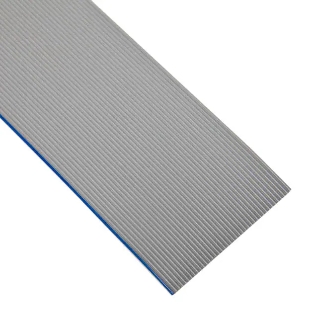

8 TM 3M 7 6 5 4 3 2 1 NOTES ROUND CONDUCTOR FLAT CABLE, HF365 SERIES * LOW SMOKE ZERO HALOGEN (LSZH) INSULATION. ADVANTAGES OF LSZH INSULATION ARE THE LOW SMOKE (IEC 61034-2-2005) AND LOW TOXICITY OF COMBUSTION GASES (NF X 70-100-2-2006), REDUCING THE RISK TO FIREFIGHTERS AND REDUCING THE SOOT AND CORROSION DAMAGE TO NEARBY EQUIPMENT. .050" 28 AWG STRANDED, HALOGEN FREE PO * 28 AWG WIRE ON .050 INCH CENTERS PERMITS MASS TERMINATION TO BROAD LINE OF IDC CONNECTORS. 2 IN THE EVENT OF CONFLICT BETWEEN THIS DATA AND THAT CONTAINED IN THE PRODUCT SPECIFICATION, THE PRODUCT SPECIFICATION TAKES PRECEDENT. * ZIPPABLE FOR BRANCHING OR DISCRETE TERMINATION. DIM. "A" D 1. REGULATORY INFORMATION: VISIT 3M.com/regs OR CONTACT YOUR 3M REPRESENTATIVE TO FIND THE RoHS COMPLIANCE STATUS OF THE 3M PART YOU ARE INTERESTED IN. D DIM. "B" TABLE 1 1.27 DIM. "A" DIM. "B" 04 06 08 09 10 11 12 14 15 16 18 20 24 25 26 30 34 36 37 40 44 50 60 64 HF365/04 HF365/06 HF365/08 HF365/09 HF365/10 HF365/11 HF365/12 HF365/14 HF365/15 HF365/16 HF365/18 HF365/20 HF365/24 HF365/25 HF365/26 HF365/30 HF365/34 HF365/36 HF365/37 HF365/40 HF365/44 HF365/50 HF365/60 HF365/64 .200+/-.010 [5.08] .300+/-.010 [7.62] .400+/-.010 [10.16] .450+/-.010 [11.43] .500+/-.010 [12.70] .550+/-.010 [13.97] .600+/-.010 [15.24] .700+/-.010 [17.78] .750+/-.010 [19.05] .800+/-.015 [20.32] .900+/-.015 [22.88] 1.000+/-.015 [25.40] 1.200+/-.015 [30.48] 1.250+/-.015 [31.75] 1.300+/-.015 [33.02] 1.500+/-.020 [38.10] 1.700+/-.020 [43.18] 1.800+/-.020 [45.72] 1.850+/-.020 [46.99] 2.000+/-.020 [50.80] 2.200+/-.020 [55.88] 2.500+/-.020 [63.50] 3.000+/-.020 [76.20] 3.200+/-.020 [81.28] .150+/-.007 [3.81] .250+/-.007 [6.35] .350+/-.007 [8.89] .400+/-.007 [10.16] .450+/-.007 [11.43] .500+/-.007 [12.70] .550+/-.007 [13.97] .650+/-.007 [16.51] .700+/-.007 [17.78] .750+/-.011 [19.05] .850+/-.011 [21.59] .950+/-.011 [24.13] 1.150+/-.011 [29.21] 1.200+/-.011 [30.48] 1.250+/-.011 [31.75] 1.450+/-.015 [36.83] 1.650+/-.015 [41.91] 1.750+/-.015 [44.45] 1.800+/-.015 [45.72] 1.950+/-.015 [49.53] 2.150+/-.015 [54.61] 2.450+/-.015 [62.23] 2.950+/-.015 [74.93] 3.150+/-.015 [80.01] 0.05 TYP. .035 .003 0.89 28 AWG 7 X 36 (7 X .127) TINNED STRANDED COPPER CONDUCTORS 0.08 HALOGEN FREE PO C NOTE: BLUE MARKING ON ONE EDGE OF CABLE DESIGNATES WIRE #1. 2 PHYSICAL: JACKET MATERIAL: HALOGEN FREE POLYOLEFIN (PO) COLOR: DARK GRAY 2 .127] TINNED STRANDED COPPER ELECTRICAL: VOLTAGE RATING: USA 300V CANADIAN 150V 10 INSULATION RESISTANCE: >1 X 10 /10ft. [3m] B DRAWING NUMBER MARKING: STANDARD: NONE CONDUCTORS: 28 AWG 7 X 36AWG [7 X CHARACTERISTIC IMPEDANCE: CAPACITANCE: INDUCTANCE: PROPAGATION DELAY: VELOCITY OF PROPAGATION: UNBALANCED 100 15.0 pF/ft [49.2 pF/m] .15 H/ft [.49 H/m] 1.51 ns/ft [4.95 ns/m] 68% EU:
HF365/40SF
- 物料型号:HF365系列,包括不同导体数量的型号,如HF365/04、HF365/06等。 - 器件简介:电缆采用低烟无卤(LSZH)绝缘材料,具有低烟(IEC 61034-2-2005)和低毒性燃烧气体(NF X 70-100-2-2006)的特点,减少对消防员的风险及对附近设备的污染和腐蚀损害。 - 引脚分配:文档中未明确提供引脚分配信息,但提到电缆的一边有蓝色标记以指示导线#1。 - 参数特性:电缆具有多种尺寸,例如宽度和厚度,以及不同的导体数量。导体为28 AWG 7 X 36(7 X 0.127)镀锡软铜线。 - 功能详解:电缆设计用于大量端接,可分支或单独端接。绝缘电阻大于10^10 ohms/10ft,物理特性包括特性阻抗100欧姆,电容15.0pF/ft,电感0.15亨利/英尺等。 - 应用信息:适用于需要低烟无卤绝缘材料的环境,如电子设备内部连接。 - 封装信息:电缆的护套材料为无卤聚烯烃(PO),颜色为深灰色,标记为标准无标记。
