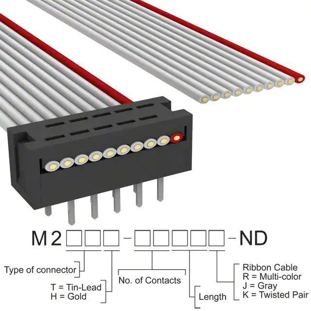

3M Pak 100 PCB .100″ × .100″ Two Row 994 Series S Fits standard .100″ × .100″ header layout S Uses less board area then 4--row design S Preassembled cover for fast termination Date Modified: April 29, 2004 TS-2100-01 Sheet 1 of 3 Physical Insulation Material: Flammability: Color: Contact Material: Plating Underplating: U--Slot and Solder Tails: Wire Accommodation: Marking: Glass Filled Thermoplastic UL 94V-0 Black Copper Alloy 50-90 µ″ [1.25-2.25 µm] Nickel 100-200 µ″ [2.5-5.0 µm] [90/10] Tin-Lead 28 AWG Stranded, PVC insulation, Gray or color-coded construction 3M logo Electrical Current Rating: 1.0 A Insulation Resistance: >1,000 ΜΩ min. at 500 VDC Withstanding Voltage 650 VAC for 1 minute Environmental Temperature Rating: --55°C to +105°C UL File No.: E68080 3 3M is a trademark of 3M Company. For technical, sales or ordering information call 800-225-5373 Interconnect Solutions http://www.3M.com/interconnects/ data_pp (For Web PDF Output) 3M Pak 100 PCB .100″ × .100″ Two Row 994 Series DIM. "A" DIM. "C" (BSC.) POS. #1 C .100 2.54 .236 6.00 .050 1.27 .244 6.20 .197 5.00 C .051 1.30 C .382 * 9.7 BEFORE ASS'Y .130 3.30 .138 3.50 .024 0.60 .012 0.30 .100 2.54 .100 2.54 * AFTER ASS'Y .244 [6.20] DIM. "B" C Inch [mm] Tolerance Unless Noted .0 Notes: 1. Use locator plate 3443-101R 2. Locator plate 3443-101M requires installation of modification kit to assemble product ± .1 Inch [ .00 .000 ± .01 ± .005 ] Dimensions for Reference Only Ordering Information 994XX-0016T Pin Quantity See table TS--2100--01 Sheet 2 of 3 3 3M is a trademark of 3M Company. For technical, sales or ordering information call 800-225-5373 Interconnect Solutions http://www.3M.com/interconnects/ data_pp (For Web PDF Output) 3M Pak 100 PCB .100″ × .100″ Two Row 994 Series Pin Quantity A B C Pin Quantity A B C 10 0.689 [17.50] 0.889 [22.58] 0.989 [25.12] 1.189 [30.20] 1.389 [35.28] 1.489 [37.82] 0.400 [10.16] 0.600 [15.24] 0.700 [17.78] 0.900 [22.86] 1.100 [27.94] 1.200 [30.48] 0.450 [11.43] 0.650 [16.51] 0.750 [19.05] 0.950 [24.13] 1.150 [29.21] 1.250 [31.75] 30 1.689 [42.90] 1.889 [47.98] 1.989 [50.52] 2.189 [55.60] 2.689 [68.30] 3.189 [81.00] 1.400 [35.56] 1.600 [40.64] 1.700 [43.18] 1.900 [48.26] 2.400 [60.96] 2.900 [73.66] 1.450 [36.83] 1.650 [41.91] 1.750 [44.45] 1.950 [49.53] 2.450 [62.23] 2.950 [74.93] 14 16 20 24 26 34 36 40 50 60 PC Board Footprint DIM. "A" -XDIM. "B" .100 2.54 .100 ±.002 2.54 ±0.05 .24 6.0 .068 1.73 ±.002 O .043 1.10 ±0.05 .300 7.62 AFTER PLATING l O .002 [0.05] X TS--2100--01 Sheet 3 of 3 3 3M is a trademark of 3M Company. For technical, sales or ordering information call 800-225-5373 Interconnect Solutions http://www.3M.com/interconnects/ data_pp (For Web PDF Output) Important Notice All statements, technical information, and recommendations related to 3M’s products are based on information believed to be reliable, but the accuracy or completeness is not guaranteed. Before using this product, you must evaluate it and determine if it is suitable for your intended application. You assume all risks and liability associated with such use. Any statements related to the product which are not contained in 3M’s current publications, or any contrary statements contained on your purchase order shall have no force or effect unless expressly agreed upon, in writing, by an authorized officer of 3M. Warranty; Limited Remedy; Limited Liability. This product will be free from defects in material and manufacture for a period of 90 days from the date of purchase. 3M MAKES NO OTHER WARRANTIES INCLUDING, BUT NOT LIMITED TO, ANY IMPLIED WARRANTY OF MERCHANTABILITY OR FITNESS FOR A PARTICULAR PURPOSE. If this product is defective within the warranty period stated above, your exclusive remedy shall be, at 3M’s option, to replace or repair the 3M product or refund the purchase price of the 3M product. Except where prohibited by law, 3M will not be liable for any loss or damage arising from this 3M product, whether direct, indirect, special, incidental or consequential regardless of the legal theory asserted. 3 Electronic Solutions Division 6801 River Place Blvd. Austin, TX 78726-9000 www.3M.com/esd © 3M 2004
