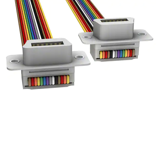

3M™ D Ribbon Wiremount Plug Molded Shell 3000 Series • • • • Accepts 26-28 AWG wire Accepts .050 inch round, flat or jacketed cable Low profile Flexible design offers various mounting applications • Contact design efficiency enables multiple insertion/withdrawals • Optional bail mount kit available • RoHS* compliant Date Modified: January 9, 2007 TS-0819-08 Sheet 1 of 3 Physical Insulation Material: Glass Filled Polyester (PBT) Flammability: Color: Contact Material: Plating: Underplating: Wiping Area: Strain Relief Material: Wire Accommodation: UL 94V-0 Gray Copper Alloy 100 μ″ [ 2.54 μm ] Nickel 30 μ″ [ 0.76 μm ] Gold Stainless Steel - 0.012 [ 0.30 ] Thick 26 and 28 AWG Solid or Stranded Marking: 3M Logo, Part Number Identification, Position 1 Electrical Current Rating: 1 A Insulation Resistance: > 1 × 109Ω at 500 VDC Withstanding Voltage: 1000 Vrms at Sea Level Environmental Temperature Rating: -55°C to +105°C "RoHS compliant" means that the product or part does not contain any of the following substances in excess of the following maximum concentration values in any homogeneous material, unless the substance is in an application that is exempt under RoHS: (a) 0.1% (by weight) for lead, mercury, hexavalent chromium, polybrominated biphenyls or polybrominated diphenyl ethers; or (b) 0.01% (by weight) for cadmium. Unless otherwise stated by 3M in writing, this information represents 3M's knowledge and belief based upon information provided by third party suppliers to 3M. UL File No.: E68080 3M Interconnect Solutions http://www.3M.com/interconnects/ 3M is a trademark of 3M Company. For technical, sales or ordering information call 800-225-5373 3M™ D Ribbon Wiremount Plug Molded Shell Contact Quantity 3M Part Number 14 24 3000 Series Dimension A B C 3572 1.75 [ 44.5 ] 1.42 [ 36.0 ] 1.28 [ 32.5 ] 3548 2.17 [ 55.1 ] 1.84 [ 46.8 ] 1.70 [ 43.2 ] 36 3366 2.68 [ 68.1 ] 2.35 [ 59.7 ] 2.21 [ 56.1 ] 50 3564 3.27 [ 83.1 ] 2.95 [ 74.8 ] 2.81 [ 71.4 ] Standard Body Strain Relief Flange .050 Ref [ 1.27 ] “U” Contact .32 [ 8.1 ] .82 [ 20.8 ] .187 [ 4.75 ] .60 [ 15.2 ] A B .085 [ 2.16 ] Contact Position 14, 24, 36, or 50 Contact Position 8, 13, 19, or 26 1 Cover See Ordering Information Contact Position 7, 12, 18, or 25 .46 [ 11.7 ] 3XXX .050 Typ [ 1.27 ] .16 [ 4.1 ] Contact Quantity Series Dimensions A B C 14 3572 1.58 [ 40.1 ] 1.20 [ 30.5 ] 1.28 [ 32.5 ] 24 3548 2.01 [ 51.1 ] 1.63 [ 41.4 ] 1.70 [ 43.2 ] 36 3366 2.52 [ 64.0 ] 2.14 [ 54.4 ] 2.21 [ 56.1 ] 50 3564 3.11 [ 79.0 ] 2.73 [ 69.3 ] 2.81 [ 71.4 ] Non-Conductive Adhesive Transfer with Liner Bailmount Body Strain Relief Flange “U” Contact .050 Ref [ 1.27 ] .32 [ 8.1 ] .82 [ 20.8 ] Contact Position 14, 24, 36, or 50 B Contact Position 8, 13, 19, or 26 In c h [m m ] .60 [ 15.2 ] T o le ra n c e U n le s s N o te d in c h 1 Contact Position 7, 12, 18, or 25 .0 .0 0 ± .1 ± .0 1 ± .0 0 5 .0 0 0 [ ] D im e n s io n s fo r R e fe re n c e O n ly .085 Ref [ 2.16 ] A Ordering Information Connector XXXX-100X Series See Table Optional 3475-X Bail Mount Kit (Order Separately) See TS-0142 60 = 14 Position Strain Relief (Order Separately) 3448-XX 0 = .158 [ 4.01 ] Dia Hole 1 = Bailmount 2 = #4-40 UNC Insert 61 = 24 Position 62 = 36 Position 63 = 50 Position For recommended 3M™ Mating Connectors refer to TS-2203. Assembly tools: 3M™ Press, 3640 (or equivalent) ; 3M™ Locator Plate, 3443-58; 3M™ Platen, 3442-9 3M Interconnect Solutions http://www.3M.com/interconnects/ TS-0819-08 Sheet 2 of 3 3M is a trademark of 3M Company. For technical, sales or ordering information call 800-225-5373 3M™ D Ribbon Wiremount Plug Molded Shell 3000 Series Notes: For rear mounting of connector with IEEE-488 Type 3M Jack Socket 3341-3, use .098″ [ 2.49 mm ] R. Cantact Quantity 3M Part Number Mounting Method 14 3572 Front 1.315 [33.41] 36 3366 Front 1.740 [44.20] 50 3564 Front 2.250 [57.16] 14 3572 Rear 2.845 [72.26] 24 3548 Rear 1.160 [29.46] 36 3366 Rear 1.585 [53.21] 50 3564 Rear 2.690 [68.33] Dimension "D" .075 ± .015 [ 1.9 ] .50 ± .02 [ 12.7 ] C Ref 3448-XX Strain Relief Material: Stainless Steel (Order Separately) TS-0819-08 Sheet 3 of 3 3M Interconnect Solutions http://www.3M.com/interconnects/ 3M is a trademark of 3M Company. For technical, sales or ordering information call 800-225-5373 Important Notice All statements, technical information, and recommendations related to 3M’s products are based on information believed to be reliable, but the accuracy or completeness is not guaranteed. Before using this product, you must evaluate it and determine if it is suitable for your intended application. You assume all risks and liability associated with such use. Any statements related to the product which are not contained in 3M’s current publications, or any contrary statements contained on your purchase order shall have no force or effect unless expressly agreed upon, in writing, by an authorized officer of 3M. Warranty; Limited Remedy; Limited Liability. This product will be free from defects in material and manufacture for a period of one (1) year from the time of purchase. 3M MAKES NO OTHER WARRANTIES INCLUDING, BUT NOT LIMITED TO, ANY IMPLIED WARRANTY OF MERCHANTABILITY OR FITNESS FOR A PARTICULAR PURPOSE. If this product is defective within the warranty period stated above, your exclusive remedy shall be, at 3M’s option, to replace or repair the 3M product or refund the purchase price of the 3M product. Except where prohibited by law, 3M will not be liable for any indirect, special, incidental or consequential loss or damage arising from this 3M product, regardless of the legal theory asserted. 3 3M Electronics 6801 River Place Blvd. Austin, TX 78726-9000 800/225-5373 www.3M.com/electronics Minimum 10% Post-Consumer Fiber Printed in USA. © 3M 2007

物料型号:3M™ D Ribbon Wiremount Plug Molded Shell 3000 Series
器件简介:该系列连接器接受26-28 AWG线材,兼容0.050英寸的圆形、扁平或带护套电缆。低轮廓设计,具有灵活性,适用于多种安装应用。接触设计效率高,允许多次插拔。可选的吊挂安装套件,符合RoHS标准。
引脚分配:提供14、24、36和50个接触点的配置。
参数特性:绝缘材料为玻璃填充聚酯(PBT),阻燃等级为UL 94V-0,颜色为灰色。接触材料为铜合金,镀层包括100微英寸镍底层和30微英寸金擦拭区。耐压电压为1000 Vrms,电流额定为1A,绝缘电阻大于1×10^9Ω。
功能详解:文档提供了连接器的详细尺寸、安装方法和推荐配件,如吊挂安装套件和压接工具。
应用信息:适用于需要灵活设计和多次插拔的应用场景。
封装信息:提供了连接器的详细尺寸和材料信息,包括不锈钢制的应变缓解法兰。
