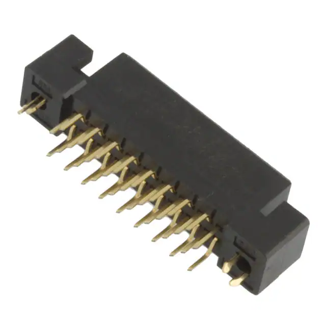

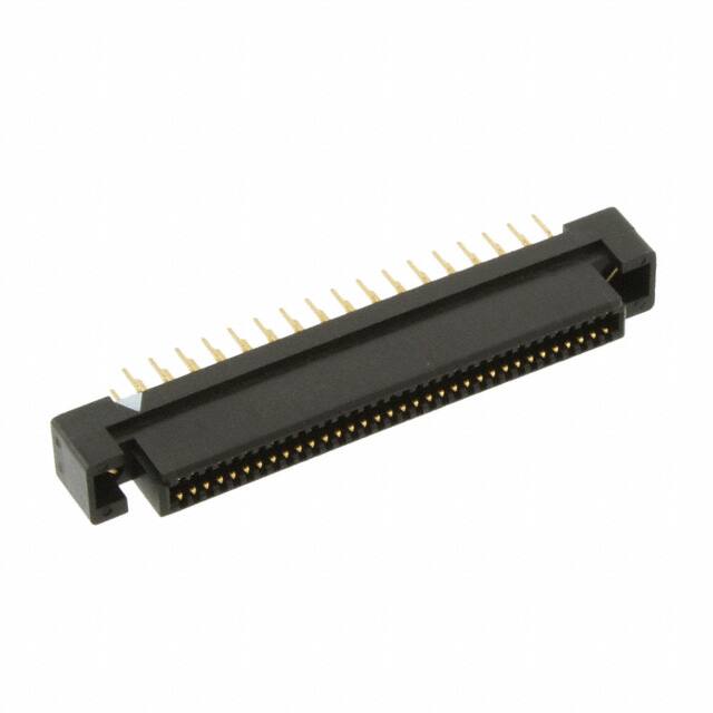

3M™ Pak 50 Socket .050" Straight and Right Angle Socket, with Ret. Clips, Flng. Option P50 Series • Contact design features two contact points and straight beam construction for connector reliability and low insertion force • Available retention clip secures connector for wave soldering eliminating additional hardware expenses • Horizontal, parallel or vertical mating available • Insulator design prevents mis-insertion errors and contact damage • Available with and without flanges • RoHS Compliant. See the Regulatory Information Appendix (RIA) in the "RoHS Compliance" section of www.3Mconnector.com for compliance information (RIA E1 and C1 apply) Date Modified: February 10, 2010  TS-2047-B Sheet 1 of 6 Physical Insulator: Material: Glass Filled Nylon Flammability: UL 94V-0 Color: Black Contact Material: Phosphor Bronze Plating: Underplating: Nickel Wiping Area: 10 µ" [ 0.25 µm ] Gold Solder Tails: Gold Flash Retaining Clips: Tin-Copper Mating Compatibility: TS-1144, TS-1162, TS-2046, TS-2048 Electrical Current Rating: 0.5 A Insulation Resistance: > 1 × 109 Ω at 500 VDC Withstanding Voltage: 650 VAC for 1 minute Environmental Temperature Rating: -55ºC to +85ºC Process Rating: 260ºC Wave Solder Compatible UL File No.: E68080 3 Electronic Solutions Division Interconnect Solutions http://www.3Mconnector.com 3M is a trademark of 3M Company. For technical, sales or ordering information call 800-225-5373 3M™ Pak 50 Socket .050" Straight and Right Angle Socket, with Ret. Clips, Flng. Option P50 Series Product Table / Dimensions for Straight Plug with Flanges, with and without Retention Clips Contact Quantity A B C D Contact Quantity A B C D 20 25.43 [1.001] 20.32 [0.800] 15.43 [0.608] 11.43 [0.450] 50 44.48 [1.751] 39.37 [1.550] 34.48 [1.358] 30.48 [1.200] 26 29.24 [1.151] 24.13 [0.950] 19.24 [0.758] 15.24 [0.600] 52 45.75 [1.801] 40.64 [1.600] 35.75 [1.408] 31.75 [1.250] 30 31.78 [1.251] 26.67 [1.050] 21.78 [0.858] 17.78 [0.700] 60 50.83 [2.001] 45.72 [1.800] 40.83 [1.608] 36.83 [1.450] 32 33.05 [1.301] 27.94 [1.100] 23.05 [0.908] 19.05 [0.750] 68 55.91 [2.201] 50.80 [2.000] 45.91 [1.808] 41.91 [1.650] 34 34.32 [1.351] 29.21 [1.150] 24.32 [0.958] 20.32 [0.800] 80 63.53 [2.501] 58.42 [2.300] 53.53 [2.108] 49.53 [1.950] 40 38.13 [1.501] 33.02 [1.300] 28.13 [1.108] 24.13 [0.950] 100 76.23 [3.001] 71.12 [2.800] 66.23 [2.608] 62.23 [2.450] With Retention Clips Without Retention Clips TS-2047-B Sheet 2 of 5 3 Electronic Solutions Division Interconnect Solutions http://www.3Mconnector.com 3M is a trademark of 3M Company. For technical, sales or ordering information call 800-225-5373 3M™ Pak 50 Socket .050" Straight and Right Angle Socket, with Ret. Clips, Flng. Option P50 Series Product Table / Dimensions for Straight Plug without Flanges Contact Quantity A B C Contact Quantity A B C 20 17.83 [0.702] 15.43 [0.608] 11.43 [0.450] 50 36.88 [1.452] 34.48 [1.358] 30.48 [1.200] 26 21.64 [0.852] 19.24 [0.758] 15.24 [0.600] 52 38.15 [1.502] 35.75 [1.408] 31.75 [1.250] 30 24.18 [0.952] 21.78 [0.858] 17.78 [0.700] 60 43.23 [1.702] 40.83 [1.608] 36.83 [1.450] 32 25.45 [1.002] 23.05 [0.908] 19.05 [0.750] 68 48.31 [1.902] 45.91 [1.808] 41.91 [1.650] 34 26.72 [1.052] 24.32 [0.958] 20.32 [0.800] 80 55.93 [2.202] 53.53 [2.108] 49.53 [1.950] 40 30.53 [1.202] 28.13 [1.108] 24.13 [0.950] 100 68.63 [2.702] 66.23 [2.608] 62.23 [2.450] Ordering Information Mounting Options: 0 = With Flanges 1 = Without Flanges, offered without retention clips only P5X - XXXS - XXX - EA Contact Quantity: See Table Solder Tail and Clip Options: S1 = Straight without Retention Clips SR1 = Right Angle without Retention Clips *R1 = Straight with Retention Clips *RR1 = Right Angle with Retention Clips *Note: R1 and RR1 do not apply to P51 3 Electronic Solutions Division Interconnect Solutions http://www.3Mconnector.com TS-2047-B Sheet 3 of 5 3M is a trademark of 3M Company. For technical, sales or ordering information call 800-225-5373 3M™ Pak 50 Socket .050" Straight and Right Angle Socket, with Ret. Clips, Flng. Option P50 Series Product Table / Dimensions for Right Angle Plug with Flanges, with and without Retention Clips Contact Quantity A B C D Contact Quantity A B C D 20 25.43 [1.001] 20.32 [0.800] 15.43 [0.608] 11.43 [0.450] 50 44.48 [1.751] 39.37 [1.550] 34.48 [1.358] 30.48 [1.200] 26 29.24 [1.151] 24.13 [0.950] 19.24 [0.758] 15.24 [0.600] 52 45.75 [1.801] 40.64 [1.600] 35.75 [1.408] 31.75 [1.250] 30 31.78 [1.251] 26.67 [1.050] 21.78 [0.858] 17.78 [0.700] 60 50.83 [2.001] 45.72 [1.800] 40.83 [1.608] 36.83 [1.450] 32 33.05 [1.301] 27.94 [1.100] 23.05 [0.908] 19.05 [0.750] 68 55.91 [2.201] 50.80 [2.000] 45.91 [1.808] 41.91 [1.650] 34 34.32 [1.351] 29.21 [1.150] 24.32 [0.958] 20.32 [0.800] 80 63.53 [2.501] 58.42 [2.300] 53.53 [2.108] 49.53 [1.950] 40 38.13 [1.501] 33.02 [1.300] 28.13 [1.108] 24.13 [0.950] 100 76.23 [3.001] 71.12 [2.800] 66.23 [2.608] 62.23 [2.450] With Retention Clips Without Retention Clips TS-2047-B Sheet 4 of 5 3 Electronic Solutions Division Interconnect Solutions http://www.3Mconnector.com 3M is a trademark of 3M Company. For technical, sales or ordering information call 800-225-5373 3M™ Pak 50 Socket .050" Straight and Right Angle Socket, with Ret. Clips, Flng. Option P50 Series Product Table / Dimensions for Right Angle Plug without Flanges Contact Quantity A B C Contact Quantity A B C 20 17.83 [0.702] 15.43 [0.608] 11.43 [0.450] 50 36.88 [1.452] 34.48 [1.358] 30.48 [1.200] 26 21.64 [0.852] 19.24 [0.758] 15.24 [0.600] 52 38.15 [1.502] 35.75 [1.408] 31.75 [1.250] 30 24.18 [0.952] 21.78 [0.858] 17.78 [0.700] 60 43.23 [1.702] 40.83 [1.608] 36.83 [1.450] 32 25.45 [1.002] 23.05 [0.908] 19.05 [0.750] 68 48.31 [1.902] 45.91 [1.808] 41.91 [1.650] 34 26.72 [1.052] 24.32 [0.958] 20.32 [0.800] 80 55.93 [2.202] 53.53 [2.108] 49.53 [1.950] 40 30.53 [1.202] 28.13 [1.108] 24.13 [0.950] 100 68.63 [2.702] 66.23 [2.608] 62.23 [2.450] TS-2047-B Sheet 5 of 5 3 Electronic Solutions Division Interconnect Solutions http://www.3Mconnector.com 3M is a trademark of 3M Company. For technical, sales or ordering information call 800-225-5373 Important Notice All statements, technical information, and recommendations related to 3M’s products are based on information believed to be reliable, but the accuracy or completeness is not guaranteed. Before using this product, you must evaluate it and determine if it is suitable for your intended application. You assume all risks and liability associated with such use. Any statements related to the product which are not contained in 3M’s current publications, or any contrary statements contained on your purchase order shall have no force or effect unless expressly agreed upon, in writing, by an authorized officer of 3M. Warranty; Limited Remedy; Limited Liability. This product will be free from defects in material and manufacture for a period of one (1) year from the time of purchase. 3M MAKES NO OTHER WARRANTIES INCLUDING, BUT NOT LIMITED TO, ANY IMPLIED WARRANTY OF MERCHANTABILITY OR FITNESS FOR A PARTICULAR PURPOSE. If this product is defective within the warranty period stated above, your exclusive remedy shall be, at 3M’s option, to replace or repair the 3M product or refund the purchase price of the 3M product. Except where prohibited by law, 3M will not be liable for any indirect, special, incidental or consequential loss or damage arising from this 3M product, regardless of the legal theory asserted.  3M Electronics Solutions Division 6801 River Place Blvd. Austin, TX 78726-9000 U.S.A. 1-800-225-5373 www.3Mconnector.com Please recycle. Printed in USA. © 3M 2010. All rights reserved. RIA-2217B-E 3M is a trademark of 3M Company.
