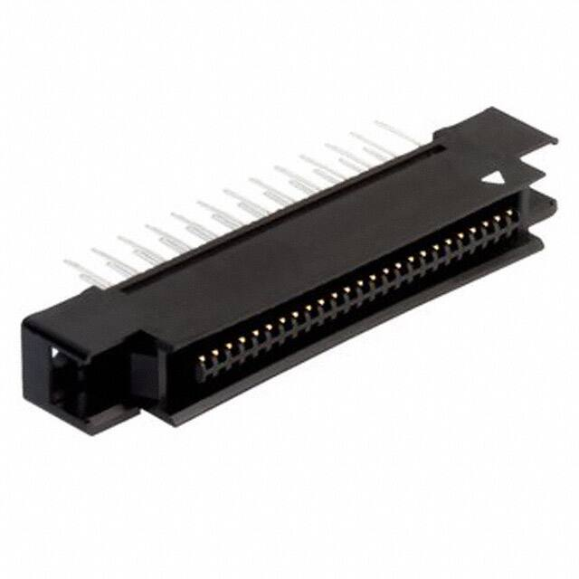

3M™ Pak 50 Boardmount Plug .050" Straight and Right Angle, Through-Hole P50E Series • P50E Plug offers straight and right angle throughhole options • Right angle P50E Plug comes with and without retention clips • Latch/eject mechanism maintains a secure connection • Mates to the P25E, P50E, and P50 wiremount socket • RoHS Compliant. See the Regulatory Information Appendix (RIA) in the "RoHS Compliance" section of www.3Mconnector.com for compliance information (RIA E1 and C1 apply) Date Modified: January 31, 2011 TS-1144-B Sheet 1 of 3 Physical Insulation: Material: Glass Filled Nylon Flammability: UL 94V-0 Color: Black Contact: Material: Copper Alloy Plating: Underplating: Nickel Wiping Area: 10 µ" [ 0.25 µm ] Gold Solder Tails: Gold Flash Retention Clips: Tin-Copper Mating Compatibility: TS-1143, TS-1141, TS-2047 Electrical Current Rating: 0.5 A Insulation Resistance: > 1 × 109 Ω at 500 VDC Withstanding Voltage: 650 VAC for 1 minute Environmental Temperature Rating: -55ºC to +85ºC Process Rating: 260ºC Wave Solder Compatible UL File No.: E68080 3 Electronic Solutions Division Interconnect Solutions http://www.3Mconnector.com 3M is a trademark of 3M Company. For technical, sales or ordering information call 800-225-5373 3M™ Pak 50 Boardmount Plug .050" Straight and Right Angle, Through-Hole P50E Series Product Table / Dimensions (For Straight and Right Angles) For 20,32,36,40,52,60,68,80,100 contacts Connector Outline n- Ø0.8 min. ( Ø 0.032 min.) n 6 1.27±0.05 (0.050±0.002) D±0.1(D±0.004) B±0.15(B±0.006) A 1 A B C D 20 27.83 [1.096] 22.86 [0.900] 15.83 [0.623] 11.43 [0.450] 26 31.64 [1.246] 26.67 [1.050] 19.64 [0.773] 15.24 [0.600] 30 34.18 [1.346] 29.21 [1.150] 22.18 [0.873] 17.78 [0.700] 32 35.45 [1.396] 30.48 [1.200] 23.45 [0.923] 19.05 [0.750] 34 36.72 [1.446] 31.75 [1.250] 24.72 [0.973] 20.32 [0.800] 36 37.99 [1.496] 33.02 [1.300] 25.99 [1.023] 21.59 [0.850] 40 40.53 [1.596] 35.56 [1.400] 28.53 [1.123] 24.13 [0.950] 50 46.88 [1.846] 41.91 [1.650] 34.88 [1.373] 30.48 [1.200] 52 48.15 [1.896] 43.18 [1.700] 36.15 [1.423] 31.75 [1.250] 60 53.23 [2.096] 48.26 [1.900] 41.23 [1.623] 36.83 [1.450] 68 58.31 [2.296] 53.34 [2.100] 46.31 [1.823] 41.91 [1.650] 80 65.93 [2.596] 60.96 [2.400] 53.93 [2.123] 49.53 [1.950] 100 78.63 [3.096] 73.66 [2.900] 66.63 [2.623] 62.23 [2.450] 1.905±0.05 (0.075±0.002) 5.715±0.05 (0.225±0.002) 2- Ø 2.3±0.1 (2- Ø 0.091±0.004) 5 3 n-1 3.7 (0.146) 3.3(0.130) Printed Circuit Board Layout  (Component Side View) Contact Quantity 42 Straight Plug 2- Ø 2.3±0.1 (2- Ø 0.091±0.004) n-1 n 5 3 1.27±0.05 6 (0.050±0.002) D±0.1(D±0.004) B±0.15(B±0.006) A 1 42 =Polarity identification Recommended PCB Thickness t=1.6 ±0.19(0.063±0.007) 1.905±0.05 (0.075±0.002) 5.715±0.05 (0.225±0.002) 3.7 (0.146)3.3(0.130) For 26,30,34,50 contacts Connector Outline n- Ø0.8 min. ( Ø 0.032 min.) Ordering Information Contact Quantity: See Table P50E - XXXP1 - XXX - EA Solder Tail/Clip Options: S1 = Straight tails, without Retention Clips SR1 = Right angle tails, without Retention Clips RR1 = Right angle tails, with Retention Clips TS-1144-B Sheet 2 of 3 3 Electronic Solutions Division Interconnect Solutions http://www.3Mconnector.com 3M is a trademark of 3M Company. For technical, sales or ordering information call 800-225-5373 3M™ Pak 50 Boardmount Plug .050" Straight and Right Angle, Through-Hole Right Angle Plug with Retention Clips P50E Series Right Angle Plug without Retention Clips 4 12.6 (0.496) 1.27±0.05(0.050±0.002) D±0.1(D±0.004) n 3.65 (0.144) B±0.15(B±0.006) A 4.8(0.189) 1.7(0.067) For 26,30,34,50 contacts Connector Outline n- Ø 0.8 min.( 0.032 min.) n-1 6 5 3 2- Ø 2.3±0.1 (2- Ø 0.091±0.004) 12.6 (0.496) 1 2 n 1.27±0.05(0.050±0.002) D±0.1(D±0.004) B±0.15(B±0.006) A =Polarity identification Recommended PCB Thickness t=1.6±0.19(0.063±0.007) 1 2 1.905±0.05 (0.075±0.002) 3.81±0.05 1.905±0.05 (0.150±0.002) (0.075±0.002) 8.5 max. (0.335 max.) PCB edge 6 5 3 8.5 max. (0.335 max.) PCB edge Connector Outline n- Ø 0.8 min.(Ø 0.032 min.) n-1 2- Ø 2.3±0.1 (2- Ø 0.091±0.004) 3.65 (0.144) 3.81±0.05 (0.150±0.002) For 20,32,36,40,52,60,68,80,100 contacts 4 1.905±0.05 (0.075±0.002) 1.905±0.05 (0.075±0.002) 4.8(0.189) 1.7(0.0 67) Printed Circuit Board Layout (Component Side View ) TS-1144-B Sheet 3 of 3 3 Electronic Solutions Division Interconnect Solutions http://www.3Mconnector.com 3M is a trademark of 3M Company. For technical, sales or ordering information call 800-225-5373 Important Notice All statements, technical information, and recommendations related to 3M’s products are based on information believed to be reliable, but the accuracy or completeness is not guaranteed. Before using this product, you must evaluate it and determine if it is suitable for your intended application. You assume all risks and liability associated with such use. Any statements related to the product which are not contained in 3M’s current publications, or any contrary statements contained on your purchase order shall have no force or effect unless expressly agreed upon, in writing, by an authorized officer of 3M. Warranty; Limited Remedy; Limited Liability. This product will be free from defects in material and manufacture for a period of one (1) year from the time of purchase. 3M MAKES NO OTHER WARRANTIES INCLUDING, BUT NOT LIMITED TO, ANY IMPLIED WARRANTY OF MERCHANTABILITY OR FITNESS FOR A PARTICULAR PURPOSE. If this product is defective within the warranty period stated above, your exclusive remedy shall be, at 3M’s option, to replace or repair the 3M product or refund the purchase price of the 3M product. Except where prohibited by law, 3M will not be liable for any indirect, special, incidental or consequential loss or damage arising from this 3M product, regardless of the legal theory asserted.  3M Electronics Solutions Division 6801 River Place Blvd. Austin, TX 78726-9000 U.S.A. 1-800-225-5373 www.3Mconnector.com Please recycle. Printed in USA. © 3M 2010. All rights reserved. RIA-2217B-E 3M is a trademark of 3M Company.
