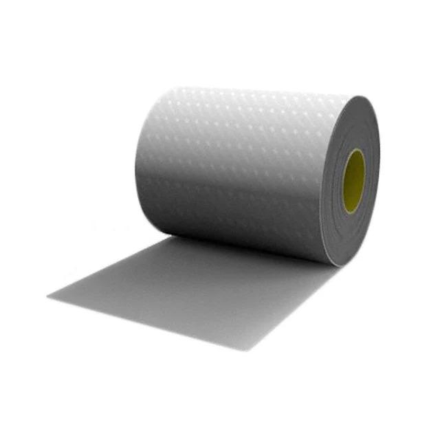

Technical Data | January 2017 3M™ Bumpon™ Protective Products Resilient Rollstock - Clear Series SJ5600 Product Description 3M™ Bumpon™ Protective Product SJ5600 series are resilient clear polyurethane rollstock products utilizing an aggressive acrylic-based, pressure sensitive adhesive. These products have a high strength acrylic adhesive that provides excellent shear properties at elevated temperatures. The adhesive adheres well to glass, many metal surfaces, some paints, and many high surface energy plastics (e.g. ABS and polycarbonate). Note: This adhesive is not recommended for use on low surface energy plastics (e.g. polypropylene, polyethylene), or powdercoat painted and other various surfaces. Product Construction 3M™ Bumpon™ Protective Products Products SJ5632 SJ5616 Clear polyurethane Clear polyurethane 4 mil, silicone coated, translucent polyester (PET), with printed 3M logo. 4 mil, silicone coated, translucent polyester (PET), with printed 3M logo. Acrylic Acrylic Color Transparent Transparent Thickness* 1/32 inches 0.031 inches (0.8 mm) 1/16 inches 0.062 inches (1.6 mm) 0.010 (0.25) 0.015 (0.38) 72 yards 36 yards Material Release Liner Adhesive Thickness Tolerance ± inches ± (mm) Roll Length Available Roll Widths Slitting Tolerance ± inches ± (mm) 4.5 inches (114.3 mm) 9 inches (228.6 mm) 4.5 inches (114.3 mm) 9 inches (228.6 mm) 0.031 (0.8) *Tested in accordance with ASTM-D-3767 method, procedure A (3.2 psi) measured without liner. Custom Rollstock Products 3M can customize thickness to your specifications. Call your 3M sales representative for details. Custom products require a minimum order quantity. The thickness capability range for 3M™ Bumpon™ Resilient Rollstock SJ5600 series is 1/32 in. (0.031) minimum and 1/16 in. (0.167) maximum. 1 3M™ Bumpon™ Protective Products Resilient Rollstock - Clear Series SJ5600 Typical Physical Properties and Performance Characteristics Note: The following technical information and data should be considered representative or typical only and should not be used for specification purposes. Property Test Method*** Test Results Hardness, Shore M ASTM-D-2240 73-78 Approximate Density, lb./ft.2 (gm/cm3) 70 (1.1) Resilience, % ASTM-D-2632 8-11 Kinetic Coefficient of Friction* ASTM-D-1894    Glass, Stainless Steel >1 Abrasion Resistance, gm/1000 cycles ASTM-C-501; Taber H, 1 kg < 0.13 Tensile, lb./in.2 (MPa) ASTM-D-412, Die A > 580 (4.0) Elongation, % ASTM-D-412, Die A 100 Stain Resistance** 3M - 24 hrs. at 158°F against white paint, 7 days, 7 days exposed to UV No staining Solvent Resistance** 3M - 24 hr. immersion    5% Detergent in water    25% Detergent in water    5% Bleach in water    Gasoline (10% ethanol)    Motor Oil (10W30)   Isopropyl Alcohol No apparent effect No apparent effect No apparent effect Slight swelling No apparent effect Slight swelling Flammability Listing Classification UL94HB Load Tolerance The “recommended” maximum load which 3M™ Bumpon™ Protective Product SJ5600 series rollstock will support is 100 psi (690 kPa) at 21°C (70°F) to 49°C (120°F). Application Temperature 4°C (40°F) to 52°C (125°F) Service Temperature -34°C (-30°F) to 66°C (150°F); 107°C (225°F) intermittent exposure * Two important laws of friction applicable to 3M™ Bumpon™ Protective Products Resilient Rollstock are (1) friction is independent of the area of contact between solids and (2) friction is proportional to the load between solids surfaces. Thus, if the load (weight) is doubled the force required to cause surface sliding is also doubled. This is expressed mathematically as follows: Slide force = (kinetic coefficient of friction) x (weight) ** = Reference test for 24 hours only. Results may vary for different product application conditions. *** = When ASTM method is listed, data was collected in accordance with ASTM test method. 2 3M™ Bumpon™ Protective Products Resilient Rollstock - Clear Series SJ5600 Typical Adhesive Performance Characteristics Note: The following technical information and data should be considered representative or typical only and should not be used for specification purposes. Static Shear Adhesive Performance Temperature Tested at: Time to Failure, minutes 24°C (75°F) > 10,000 49°C (120°F) > 10,000 70°C (158°F) > 10,000 82°C (180°F) > 10,000 One in. overlap shear test; tested in accordance with the ASTM-D-3654-M (1000 gram) method; testing completed on stainless steel test panels using 3M™ Bumpon™ Protective Product SJ5616. 90° Peel Adhesion Performance Substrate Peel Force, oz. per 1 inch (N/cm) Polypropylene 6 (0.67) Polystyrene 22 (2.45) ABS 45 (5.01) Stainless Steel 45 (5.01) Aluminum 45 (5.01) Glass 45 (5.01) 3M Test Method TM-2065; 72 hour dwell, 1 inch wide samples pulled at 12 in. per minute. Testing completed using Bumpon Protective Product SJ5616. Environmental Exposure 3M™ Bumpon™ Protective Products Resilient Rollstock Clear Series is intended for interior applications where resilience and all other physical properties will remain unchanged. When exposed to UV light for extended periods, some discoloration may occur. Bumpon clear rollstock may be used outdoors in a protected area with some discoloration possible. Simultaneous exposure to high humidity and temperature may degrade (soften) the product composition. 3 3M™ Bumpon™ Protective Products Resilient Rollstock - Clear Series SJ5600 Features • Transparent – universal color match • Excellent resistance to yellowing • Can be die cut to a variety of shapes and sizes • Good resistance (resulting from a urethane composition which contains no plasticizers) to marring or staining • Long aging resiliency – will not crack or harden • Excellent cushioning properties • Excellent abrasion resistance • Vibration and shock damping • Easy application – pressure sensitive adhesive backing Application Ideas • Die cut shapes for glass table tops, cushioning glass from metal and wood frames • Die cut shapes for use as cushions and spacers on cabinet doors, drawers, and lids • Die cut shapes for use as skid-resistant feet on small appliances and desk top equipment, hand held or desktop electronic devices • Die cut shapes for use as cushions and pads on glass or clear plastic shelves • Strips or pads for use as skid-resistant surfaces on glass or clear plastic shelves • Spacer or stop to prevent surface damage • Corner protection strips • Door kick pads • Anti-rattle spacer to fill gaps, dampen noise and reduce vibration Application Techniques To obtain maximum adhesion, surfaces must be unified, dry, and free of contaminants. Surface contact is fundamental to adhesive performance. To maximize contact on a substrate: • Clean surfaces with low strength solvents such as isopropyl alcohol (rubbing alcohol) or heptane. Note: Be sure to follow the solvent’s manufacturer’s precautions and directions for use when using solvents. • Apply firm pressure to increase the cold flow and contact of the adhesive with the substrate. • Allow time (dwell) to increase the surface contact and adhesion. Note: Product selection is ultimately the user’s responsibility. Users should conduct their own tests under actual use and storage conditions to determine whether the product is fit for a particular purpose and method of application. Storage and Shelf Life The shelf life of 3M™ Bumpon™ Protective Products SJ5600 Series is 18 months from the date of manufacture when stored in the original packaging materials and stored at 16-27°C (60-80°F) and 50% relative humidity. 4 3M™ Bumpon™ Protective Products Resilient Rollstock - Clear Series SJ5600 Regulatory: For regulatory information about this product, contact your 3M representative. Technical Information: The technical information, recommendations and other statements contained in this document are based upon tests or experience that 3M believes are reliable, but the accuracy or completeness of such information is not guaranteed. Product Use: Many factors beyond 3M’s control and uniquely within user’s knowledge and control can affect the use and performance of a 3M product in a particular application. Given the variety of factors that can affect the use and performance of a 3M product, user is solely responsible for evaluating the 3M product and determining whether it is fit for a particular purpose and suitable for user’s method of application. Warranty, Limited Remedy, and Disclaimer: Unless an additional warranty is specifically stated on the applicable 3M product packaging or product literature, 3M warrants that each 3M product meets the applicable 3M product specification at the time 3M ships the product. 3M MAKES NO OTHER WARRANTIES OR CONDITIONS, EXPRESS OR IMPLIED, INCLUDING, BUT NOT LIMITED TO, ANY IMPLIED WARRANTY OR CONDITION OF MERCHANTABILITY OR FITNESS FOR A PARTICULAR PURPOSE OR ANY IMPLIED WARRANTY OR CONDITION ARISING OUT OF A COURSE OF DEALING, CUSTOM OR USAGE OF TRADE. If the 3M product does not conform to this warranty, then the sole and exclusive remedy is, at 3M’s option, replacement of the 3M product or refund of the purchase price. Limitation of Liability: Except where prohibited by law, 3M will not be liable for any loss or damage arising from the 3M product, whether direct, indirect, special, incidental or consequential, regardless of the legal theory asserted, including warranty, contract, negligence or strict liability. Electronics Materials Solutions Division 3M Center, Building 224-3N-11 St. Paul, MN 55144-1000 Phone 1-800-251-8634 Fax 651-778-4244 Web www.3M.com/electronics 3M and Bumpon are trademarks of 3M Company. Please recycle. ©3M 2017. All rights reserved. 60-5002-0524-4
