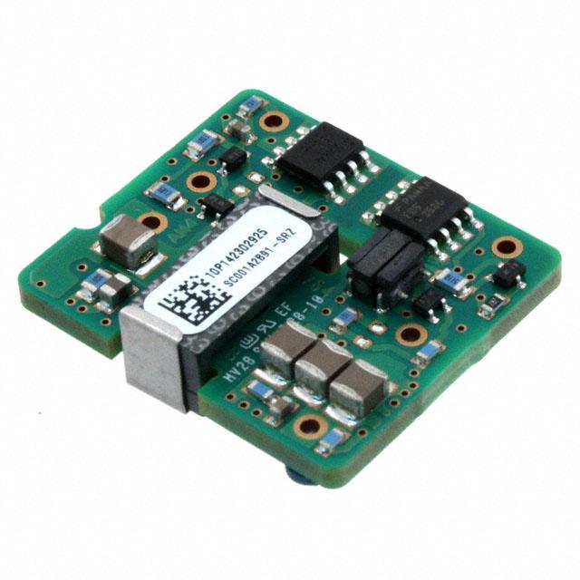

GE Data Sheet SW/SC001/003 Series DC-DC Converter Power Modules: 18-36V & 36-75Vdc Input; 3.3V-15Vdc Output; 1-3.5A Output Current Features ▪ Compliant to RoHS II EU Directive 2011/65/EC and amended Directive (EU) 2015/863. (-Z versions) ▪ Compliant to REACH Directive (EC) No 1907/2006 ▪ Delivers up to 3.5A Output current 15V (1A), 12V (1.25A), 5.0V (3A) and 3.3V (3.5A) Representative Photo. Actual product may vary. RoHS Compliant ▪ High efficiency – 86% at 5.0V full load (VIN=54 Vdc) ▪ Low output ripple and noise ▪ Small Size and low profile 27.94mm x 24.38mm x 8.5mm Applications (1.10 x 0.96 x 0.335 in) ▪ Wireless Networks ▪ Distributed power architectures ▪ Optical and Access Network Equipment ▪ Enterprise Networks ▪ Latest generation IC’s (DSP, FPGA, ASIC) and Microprocessor powered applications ▪ TH version is LW series compatible ▪ Surface mount (SMT) or Through hole (TH) ▪ Remote On/Off (optional pin on TH version) ▪ Output overcurrent/voltage protection ▪ Single Tightly regulated output ▪ Output voltage adjustment trim 10% ▪ Wide operating temperature range (-40°C to 85°C) ▪ Output voltage adjustment-Trim, pin optional for TH version (Suffix 9) Meets the voltage insulation requirements for ETSI 300-132-2 and complies with and is Licensed for Basic Insulation ▪ CE mark meets the 2014/35/EU directive§ Surface Mount/Tape and Reel (-SR Suffix) ▪ ANSI/UL* 62368-1 and CAN/CSA† C22.2 No. 62368-1 Recognized, DIN VDE‡ 0868-1/A11:2017 (EN62368-1:2014/A11:2017) ▪ ISO** 9001 and ISO 14001 certified manufacturing facilities Options ▪ ▪ ▪ Industry Standard pin-out: Remote On/Off logic (positive or negative), pin optional for TH version (Suffix 1 or 4) Description The SW/SC series power modules are isolated dc-dc converters that operate over a wide range of input voltage (VIN = 18 - 36Vdc for SC modules and VIN = 36 – 75Vdc for SW modules) and provide a single precisely regulated output. This series is a low cost, smaller size alternative to the existing LW/LAW/LC with enhanced performance parameters. The output is fully isolated from the input, allowing versatile polarity configurations and grounding connections. The modules exhibit high efficiency, typical efficiency of 86% for 5.0V/3A. Built-in filtering for both input and output minimizes the need for external filtering. § This product is intended for integration into end-use equipment. All of the required procedures of end-use equipment should be followed. * UL is a registered trademark of Underwriters Laboratories, Inc. † CSA is a registered trademark of Canadian Standards Association. ‡ VDE is a trademark of Verband Deutscher Elektrotechniker e.V. ** ISO is a registered trademark of the International Organization of Standards March 18, 2021 ©2013 General Electric Company. All rights reserved. Page 1 Data Sheet GE SW/SC001/003 Series DC-DC Power Module 18-36Vdc & 36-75Vdc Input; 3.3-15Vdc Output; 1-3.5A Output Current Absolute Maximum Ratings Stresses in excess of the absolute maximum ratings can cause permanent damage to the device. These are absolute stress ratings only, functional operation of the device is not implied at these or any other conditions in excess of those given in the operations sections of the data sheet. Exposure to absolute maximum ratings for extended periods can adversely affect the device reliability. Parameter Device Symbol Min Max Unit SW VIN -0.3 80 Vdc SC VIN -0.3 50 All VIN, trans -0.3 100 Vdc All TA -40 85 °C Storage Temperature All Tstg -55 125 °C I/O Isolation Voltage (100% factory Hi-Pot tested) All ⎯ ⎯ 2250 Vdc Input Voltage (Continuous) Transient (100ms) Operating Ambient Temperature (see Thermal Considerations section) Electrical Specifications Unless otherwise indicated, specifications apply over all operating input voltage, resistive load, and temperature conditions. Parameter Device Symbol Min Typ Max Unit Operating Input Voltage SW VIN 36 54 75 Vdc SC VIN 18 27 36 Vdc Maximum Input Current (VIN=0V to 75V, IO=IO, max) SW IIN,max 0.6 Adc SC IIN,max 1.2 Adc Inrush Transient All 2 0.05 A2s Input Reflected Ripple Current, peak-to-peak (5Hz to 20MHz, 12μH source impedance; VIN=0V to 75V, IO= IOmax ; see Test configuration section) All 30 mAp-p Input Ripple Rejection (120Hz) All 50 dB (VIN=0V to 36V, IO=IO, max) EMC, EN55032 It See EMC Considerations section CAUTION: This power module is not internally fused. An input line fuse must always be used. This power module can be used in a wide variety of applications, ranging from simple standalone operation to being part of complex power architecture. To preserve maximum flexibility, internal fusing is not included; however, to achieve maximum safety and system protection, always use an input line fuse. The safety agencies require a fast-acting fuse with a maximum rating of 3A (see Safety Considerations section). Based on the information provided in this data sheet on inrush energy and maximum dc input current, the same type of fuse with a lower rating can be used. Refer to the fuse manufacturer’s data sheet for further information. March 18, 2021 ©2013 General Electric Company. All rights reserved. Page 2 Data Sheet GE SW/SC001/003 Series DC-DC Power Module 18-36Vdc & 36-75Vdc Input; 3.3-15Vdc Output; 1-3.5A Output Current Electrical Specifications (continued) Parameter Output Voltage Set-point Device Symbol Min Typ Max Unit All VO, set -1.5 ⎯ +1.5 % VO, set VO -3.0 ⎯ +3.0 % VO, set VO, adj -10.0 +10.0 % VO, set 0.3 % VO, set (VIN=VIN,nom, IO=IO, max, TA=25°C) Output Voltage (Over all operating input voltage, resistive load, and temperature conditions until end of life) Adjustment Range All Selected by external resistor Output Regulation Line (VIN=VIN, min to VIN, max) (relative to actual VO, set at 50% load) All ⎯ 0.05 Load (IO=IO, min to IO, max) (relative to actual VO, set at Typical VIN) All ⎯ 0.05 0.2 % VO, set Temperature (Tref=TA, min to TA, max) All ⎯ ⎯ 1.00 % VO, set RMS (5Hz to 20MHz bandwidth) 5V, 3.3V ⎯ ⎯ 25 mVrms Peak-to-Peak (5Hz to 20MHz bandwidth) 5V, 3.3V ⎯ ⎯ 75 mVpk-pk RMS (5Hz to 20MHz bandwidth) 15V, 12V ⎯ ⎯ 35 mVrms Peak-to-Peak (5Hz to 20MHz bandwidth) 15V, 12V Output Ripple and Noise on nominal output Measured with 10uF Tantalum and 1uF ceramic (VIN=VIN, nom IO=80%IO, max TA=25°C) External Capacitance Output Current ⎯ ⎯ 100 mVpk-pk 3.3V, 5V CO, max 0 ⎯ 1000 μF 12V, 15V CO, max 0 ⎯ 220 μF 15V Io 0 ⎯ 1.0 Adc 12V Io 0 ⎯ 1.25 Adc 5V Io 0 ⎯ 3.0 Adc 3.3V Io 0 ⎯ 3.5 Adc Output Current Limit Inception 15V IO, lim 1.1 ⎯ ⎯ Adc (Hiccup Mode) 12V IO, lim 1.4 ⎯ ⎯ Adc Output Short-Circuit Current VO ≤ 250 mV @ 25o C 5V IO, lim 3.2 4.2 ⎯ Adc 3.3V IO, lim 3.7 ⎯ ⎯ Adc 15V IO, s/c ⎯ ⎯ 0.8 Arms 12V IO, s/c ⎯ ⎯ 1.2 Arms 5V IO, s/c ⎯ ⎯ 0.7 Arms 3.3V IO, s/c ⎯ ⎯ 1.5 Arms SW (15V) η ⎯ 88.0 ⎯ % VIN=VIN, nom, TA=25°C SW (12V) η ⎯ 87.0 ⎯ % IO=IO, max, VO= VO, set SW (5.0V) η ⎯ 86.0 ⎯ % SW (3.3V) η 83.0 85.0 ⎯ % Efficiency SC (12V) η ⎯ 85.0 ⎯ % SC (5.0V) η ⎯ 85.5 ⎯ % SC (3.3V) η ⎯ 85.5 ⎯ % VIN=VIN, nom and IO= IO, max All fsw ⎯ 300 ⎯ kHz VIN=VIN, nom and IO= 0.5 x IO, max All fsw ⎯ 440 ⎯ kHz Switching Frequency (Variable with Line & Load) March 18, 2021 ©2013 General Electric Company. All rights reserved. Page 3 Data Sheet GE SW/SC001/003 Series DC-DC Power Module 18-36Vdc & 36-75Vdc Input; 3.3-15Vdc Output; 1-3.5A Output Current Electrical Specifications (continued) Parameter Device Symbol Min Typ Max Unit All Vpk All ts ⎯ 1.5 ⎯ % VO, set ⎯ 800 ⎯ s Symbol Min Typ Max Unit Dynamic Load Response (Io/t=0.1A/s, VIN=VIN, nom, TA=25°C) Load Change from Io= 50% to 75% or 25% to 50% of Io,max: Peak Deviation Settling Time (Vo
