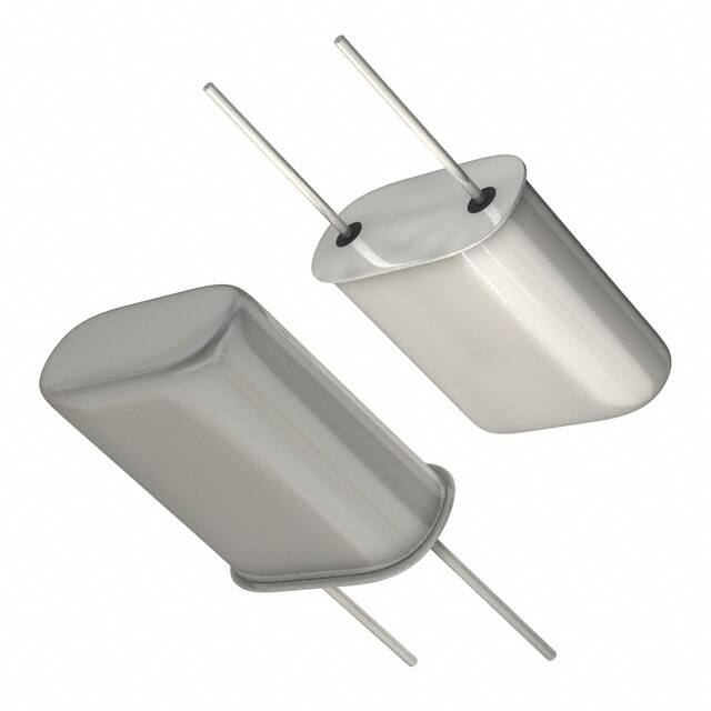

    无源晶振 8MHz ±20ppm 18pF 35Ω -30℃~+85℃
AB-8.000MHZ-N2 数据手册
HC49/U CRYSTAL AB Pb RoHS/RoHS II Compliant 11.5 x 5.0 x 13.46mm | | | | | | | | | | | | | | | Moisture Sensitivity Level (MSL) – This product is not Moisture Sensitive - MSL = 1 APPLICATIONS: • CPU, Memory • Computer, printer • Data communication (1MHz) • Data input - output machine (1MHz) FEATURES: • High precision availability • Resistance welded • Ideal for large pullability application • Wide frequency range STANDARD SPECIFICATIONS: Parameters Minimum Frequency Range 1.8432 Drive level dependency (DLD), minimum 7 points tested: from 1µW to 500µW. Maximum 160.000 Fundamental 3rd Overtone 5th Overtone 7th Overtone +70 +125 +50 Operation Mode Operating Temperature Storage Temperature Frequency Tolerance @+25°C Frequency Stability over the operating temperature ( ref. to +25°C) Equivalent series resistance (R1) Shunt capacitance (C0) Load capacitance (CL) Drive Level Aging@25°C±3°C Insulation Resistance Typical 0 -55 -50 -100 +100 Units Notes MHz 1.8432MHz – 24.000MHz 24.01MHz – 66.00MHz 66.01MHz – 122.00MHz 122.01MHz – 160.00MHz See options ºC ºC ppm See options ppm See options See table 1 below 7 pF 18 pF 100 1000 µW ±5 ppm 500 M Change in frequency (Maximum - Minimum) over DLD range < ±10ppm; Change in ESR (Maximum - Minimum) over DLD range < 25% of Max ESR value; Maximum ESR over DLD range < Max ESR value. See options First year @100Vdc±15V Table 1 FREQUENCY (MHz) 1.8432-1.999 2.000-2.399 2.400-2.999 3.000-3.699 3.700-4.199 4.200-4.899 4.900-5.999 6.000-7.999 8.000-9.999 10.000-12.499 12.50-50.00 24.00-66.00 66.01-122.00 122.01-160.00 LLC Operation Mode HC49/U Fundamental HC49/U (3rd OT) HC49/U (5th OT) HC49/U (7th OT) 5101 Hidden Creek Ln Spicewood TX 78669 Phone: 512-371-6159 | Fax: 512-351-8858 For terms and conditions of sales, please visit: www.abracon.com ESR max 750 550 350 200 100 70 50 40 35 30 25 40 80 120 ABRACON IS REVISED: 10.29.2018 ISO9001-2015 CERTIFIED HC49/U CRYSTAL AB Pb RoHS/RoHS II Compliant 11.5 x 5.0 x 13.46mm | | | | | | | | | | | | | | | OPTIONS AND PART IDENTIFICATION: (Left blank if standard) AB - MHz - - - - - - P a c k a g in g Blank: Bulk (std.) T: Tape & Reel (For MJ option only) Frequency in MH z Please specify the frequency in x x .x x x x M Hz. e .g . 14.3181MHz Q u a lit y F a c t o r * * * Minimum QXXXk Value Valu e Added L o a d Capacit anc e (pF) Please specify CL (Minimum 10 pF) in pF or S fo r series Custo m E SR if other than st a n d a r d I Insulator Tab QXX T rimmed lea ds See Ta ble 2 MJ Metal jacket Operation Mode Fund. AT > 24MHz F ify a value in (e .g .: R40) FB O Operating Temp. 1: ± 10 pp m Freq . St abilit y Option s fo r A T Cut only * 7: ± 15 pp m U * * : ± 1 0 p pm 2: ± 20 ppm G: ± 15 ppm Freq. Tolerance A: -10°C ~ + 60° C B: -20°C ~ + 70° C C: -30°C ~ + 70° C N: -30°C ~ + 85° C D: -40°C ~ + 85° C 3: ± 25 ppm X: ± 20 ppm 4: ± 30 ppm W : ± 25 ppm Y: ± 30 ppm Fund. BT>24MHz 3rd OT>66MHz NOTE: *:Fr equency Stability ± 100 ppm max at -10 to +60C only for BT cut. ** : -10 to +60C only. *** : Quality factor must be ac companied by a k value H: ± 35 ppm Z: ± 5 0 p pm Table 2 CODES TRIMMED L in(mm) Q45 0.45 (11.43) Q40 0.40 (10.16) Q35 0.35 (8.89) Q30 0.30 (7.62) Q25 0.25 (6.35) Q20 0.20 (5.08) Q15 0.15 (3.81) Q10 0.10 (2.54) Q115 0.115 (2.92) LLC NOTE: Use appropriat e code numbers for other trimmed lengths not liste d. (e.g. Q14 for 0.14 inch (3.55 mm)) 5101 Hidden Creek Ln Spicewood TX 78669 Phone: 512-371-6159 | Fax: 512-351-8858 For terms and conditions of sales, please visit: www.abracon.com ABRACON IS REVISED: 10.29.2018 ISO9001-2015 CERTIFIED HC49/U CRYSTAL AB Pb RoHS/RoHS II Compliant 11.5 x 5.0 x 13.46mm | | | | | | | | | | | | | | | OUTLINE DRAWING: Insulator Tab For Option I Dimensions: inch (mm) LLC 5101 Hidden Creek Ln Spicewood TX 78669 Phone: 512-371-6159 | Fax: 512-351-8858 For terms and conditions of sales, please visit: www.abracon.com ABRACON IS REVISED: 10.29.2018 ISO9001-2015 CERTIFIED HC49/U CRYSTAL AB Pb RoHS/RoHS II Compliant 11.5 x 5.0 x 13.46mm | | | | | | | | | | | | | | | OUTLINE DIMENSION CONTD... Metal Jacket Formed Leads For Option MJ T 1,000 pcs/reel Dimensions: mm TAPE & REEL: T: 1,000 pcs/reel Tape and reel packaging applies only to MJ (metal jacket) option E E2 F P2 ØD0 P0 W 1.75±0.10 22.25 MIN. 11.5±0.10 2.00±0.10 1.50±0.10 4.00±0.10 24.00±0.30 Dimensions: mm ATTENTION: Abracon LLC’s products are COTS – Commercial-Off-The-Shelf products; suitable for Commercial, Industrial and, where designated, Automotive Applications. Abracon’s products are not specifically designed for Military, Aviation, Aerospace, Life-dependant Medical applications or any application requiring high reliability where component failure could result in loss of life and/or property. For applications requiring high reliability and/or presenting an extreme operating environment, written consent and authorization from Abracon LLC is required. Please contact Abracon LLC for more information. LLC 5101 Hidden Creek Ln Spicewood TX 78669 Phone: 512-371-6159 | Fax: 512-351-8858 For terms and conditions of sales, please visit: www.abracon.com ABRACON IS REVISED: 10.29.2018 ISO9001-2015 CERTIFIED

物料型号:HC49/U
器件简介:HC49/U晶体振荡器是一款符合RoHS/RoHS II标准的电子元件,尺寸为11.5 x 5.0 x 13.46mm,不敏感于潮湿,适用于大型拉力应用。
引脚分配:文档中未明确提供引脚分配信息。
参数特性: - 频率范围:1.8432MHz至160.000MHz - 工作模式:基频和3次、5次、7次泛音 - 工作温度:0℃至+70℃ - 存储温度:-55℃至+125℃ - 频率容差:-50ppm至+50ppm(25°C时) - 等效串联电阻(ESR):见表1 - 并联电容(C0):最大7pF - 负载电容(CL):18pF起,可选项 - 驱动电平:100μW至1000μW - 老化率:首年±5ppm - 绝缘电阻:最小500MΩ(100Vdc±15V)
功能详解:HC49/U晶体振荡器具有高精度、抗拉力、宽频率范围等特点,适用于CPU、内存、计算机、打印机、数据通信等领域。
应用信息:适用于CPU、内存、计算机、打印机、数据通信(1MHz)、数据输入输出机(1MHz)。
封装信息:标准封装尺寸为11.5 x 5.0 x 13.46mm,提供金属外壳(MJ)选项。
