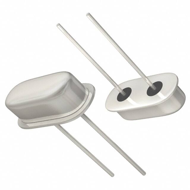

HC/49US (AT49) MICROPROCESSOR CRYSTAL ABL Series Pb Moisture Sensitivity Level (MSL) – This product is Hermetically Sealed and not Moisture Sensitive - MSL = N/A: Not Applicable FEATURES: • High reliability & Low Cost • Tight stability & extended temperature • Proven resistance welded metal package RoHS/RoHS II 11.5 x 5.0 x 3.5 mm | | | | | | | | | | | | | | | APPLICATIONS: • Home electronics • Computers, modems, and communications • High-precision TCXO and clock applications • Microprocessors STANDARD SPECIFICATIONS: Parameters Minimum Frequency Range Operation mode Operating Temperature Storage Temperature Frequency Tolerance Frequency Stability over the Operating Temperature ( ref. to +25°C) Equivalent series resistance (R1) Shunt capacitance (C0) Load capacitance (CL) Drive Level Aging @ 25°C per year Insulation Resistance Typical Frequency (MHz) 3.579 - 4.999 (Fund.) 5.000 - 5.999 (Fund.) 6.000 - 7.999 (Fund.) 8.000 - 8.999 (Fund.) 9.000 - 9.999 (Fund.) 10.000 - 15.999 (Fund.) 16.000 - 50.000 (Fund.) 34.000 - 70.00 (3rd O/T) Units Notes 3.579545 70 3.579545 33.999 34.00 70.00 24.01 50.00 0 -55 -50 +70 +125 +50 ºC ºC ppm See options -50 +50 ppm See options See table 1 below 7 18 100 1000 ±5 500 ±10 Drive Level Dependency (DLD, Minimum 7 points tested: from 1µW to 500µW) Table 1 Maximum 25% of Max ESR Max ESR in Table 1 MHz Ω pF pF µW ppm MΩ ppm Ω Ω Fundamental ATcut (Standard) 3rd OT AT-cut (Standard) Fundamental ATcut (See options) See options See options @ 100Vdc ± 15V Δfrequency (Max – Min) ΔESR (Max – Min) Max ESR over DLD range ESR(Ω) max. 180 120 100 80 60 50 40 80 Lorem ipsum REVISED: 03.27.2018 ABRACON IS LL C 5101 Hidden Creek Lane Spicewood TX 78669 Phone: 512-371-6159 | Fax: 512-351-8858 For terms and conditions of sale please visit: www.abracon.com ABRACON IS ISO9001-2008 CERTIFIED HC/49US (AT49) MICROPROCESSOR CRYSTAL ABL Series Pb RoHS/RoHS II 11.5 x 5.0 x 3.5 mm | | | | | | | | | | | | | | | OPTIONS AND PART IDENTIFICATION: (Left blank if standard) ABL - MHz - - - - - Packaging Blank: Bulk T: Tape & Reel TRAY: Tray Frequency in MHz Please specify the frequency in xx.xxxxMHz. e.g. 14.3181MHz Load Capacitance (pF) Please specify CL (Minimum 10pF) in pF or S for series I L2 QXX Q15 Custom ESR if other than standard R□ □: Specify a value in Ω (e.g.: R40) Value Added Insulator Tab Middle 3rd lead Trimmed leads for 0.15" length Oscillation Mode F: Fund. AT>24MHz Operating Temp. A: -10°C ~ +60°C B: -20°C ~ +70°C C: -30°C ~ +70°C N: -30°C ~ +85°C D: -40°C ~ +85°C J*: -40°C ~ +105°C K*: -40°C ~ +125°C L*: -55°C ~ +125°C Freq. Tolerance H5: ± 5 ppm 1: ± 10 ppm 7: ± 15 ppm 2: ± 20 ppm 3: ± 25 ppm 4: ± 30 ppm Freq. Stability U**: ± 10 ppm G: ± 15 ppm X: ± 20 ppm W: ± 25 ppm Y: ± 30 ppm H: ± 35 ppm Q: ± 100 ppm R: ± 150 ppm NOTE: * Frequency stability ±50ppm, ±100ppm, ±150ppm only. Contact ABRACON for tighter frequency stability. ** Contact ABRACON for availability of ±10ppm with other operating temperature options. REVISED: 03.27.2018 ABRACON IS LL C 5101 Hidden Creek Lane Spicewood TX 78669 Phone: 512-371-6159 | Fax: 512-351-8858 For terms and conditions of sale please visit: www.abracon.com ABRACON IS ISO9001-2008 CERTIFIED HC/49US (AT49) MICROPROCESSOR CRYSTAL ABL Series Pb RoHS/RoHS II 11.5 x 5.0 x 3.5 mm | | | | | | | | | | | | | | | OUTLINE DRAWING: L 5.5mm Min 20.0 ± 0.5mm Packaging Bulk Tape & Reel ABL SERIES HC49/US (AT49) MICROPROCESSOR CRYSTAL 8.0 Date of Issue: Jan. 2nd, 2013 11.5 x 5.0 x 3.5 mm Page (8) of (10) Abracon Drawing # 450667 L Revision #: T Packaging: Dimensions: inch (mm) T= Tape and reel (1,000pcs/reel) TAPE & REEL: T= Tape and reel (1,000pcs/reel) Dimensions: mm REVISED: 03.27.2018 ABRACON IS LL C 5101 Hidden Creek Lane Spicewood TX 78669 Phone: 512-371-6159 | Fax: 512-351-8858 For terms and conditions of sale please visit: www.abracon.com ABRACON IS ISO9001-2008 CERTIFIED

物料型号:HC/49US (AT49) MICROPROCESSOR CRYSTAL ABL Series
器件简介:该系列是用于微处理器的晶体振荡器,具有高可靠性和低成本,适用于多种应用场景。
引脚分配:文档中未明确提供引脚分配信息。
参数特性: - 频率范围:3.579545 MHz 至 70 MHz - 工作模式:基础AT切割(标准)和3次谐波AT切割(标准) - 工作温度:0°C 至 +70°C - 存储温度:-55°C 至 +125°C - 频率容差:-50 ppm 至 +50 ppm - 频率稳定性:在工作温度范围内相对于+25°C的-50 ppm至+50 ppm - 等效串联电阻(R1):见表1 - 并联电容(C0):最大7 pF - 负载电容(CL):18 pF,可选项 - 驱动级别:100 uW 至 1000 uW - 年老化率:±5 ppm - 绝缘电阻:500 MO,在100Vdc±15V下
功能详解:文档中未提供详细的功能解释。
应用信息:适用于家用电器、计算机、调制解调器、通信设备、高精度TCXO和时钟应用、微处理器等。
封装信息:尺寸为11.5 x 5.0 x 3.5 mm,提供散装、卷带和托盘包装。
