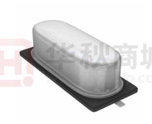

HC/ 49US (AT49) LOW PROFILE SURFACE MOUNT MICROPROCESSOR CRYSTAL ABLS2 Moisture Sensitivity Level (MSL) – This product is Hermetically Sealed and not Moisture Sensitive - MSL = N/A: Not Applicable FEATURES: • Suitable for RoHS compliant reflow • Low height reduced to 3.3mm • Available suitable for thin equipment • Tight stability & extended temperature Pb RoHS Compliant Reduced height to 3.3mm 11.4 x 4.7 x 3.3 mm APPLICATIONS: • Computers, Modems, Microprocessors • Wireless Applications STANDARD SPECIFICATIONS: PARAMETERSParameters Frequency Range Minimum Typical Maximum 3.579545 ----- 24.00 24.01 ----- 50.00 24.01 ----- 70.00 Units Notes MHz Fundamental AT (Standard) Fundamental AT or BT (See options) 3rd Overtone (Standard) Fundamental or 3rd Overtone 0 ----+70 -55 ----+125 -50 ----+50 ºC ºC ppm -50 ----- +50 ppm Equivalent series resistance (R1) Shunt capacitance (C0) ----- See table 1 below ----- 7 Ω pF Load capacitance (CL) ----- 18 ----- pF Drive Level ----- 100 1000 µW Aging -5 ----- +5 ppm Operation Mode Operating Temperature Storage Temperature Frequency Tolerance @+25°C Frequency Stability over the Operating Temperature ( ref. to +25°C) Insulation Resistance Drive level dependency (DLD) See options See options See options (For BT cut, ±100ppm max.at -10° C to +60° C only) Standard (See options if other than STD) @25°C±3°C First year @ 100Vdc ± 15V 500 --------MΩ Minimum 7 points tested: from 1µW to 500µW. Change in frequency (Maximum - Minimum) over DLD range < ±10ppm Change in ESR (Maximum - Minimum) over DLD range < 25% of Max ESR value. Maximum ESR over DLD range < Max ESR value. TABLE 1: ESR FREQUENCY (MHz) 3.579545 - 4.999 (Fund.) 5.000 - 5.999 (Fund.) 6.000 - 7.999 (Fund.) 8.000 - 8.999 (Fund.) 9.000 - 9.999 (Fund.) 10.000 - 15.999 (Fund.) 16.000 - 50.000 (Fund.) 24.01 - 31.999 (3rd O/T) 32.000 - 70.00 (3rd O/T) ESR (Ω) 180 120 100 80 60 50 40 100 80 REVISED: 11.15.2016 LL C 5101 Hidden Creek Lane Spicewood TX 78669 Phone: 512-371-6159 | Fax: 512-351-8858 For terms and conditions of sale please visit: www.abracon.com ABRACON IS ISO9001-2008 CERTIFIED ) HC/ 49US (AT49) LOW PROFILE SURFACE MOUNT MICROPROCESSOR CRYSTAL ABLS2 Reduced height to 3.3mm Pb RoHS Compliant 11.4 x 4.7 x 3.3 mm | | | | | | | | | | | | | | | Options and Part Identification (left blank if standard) ABLS2 - MHz - - - - Packaging Blank: Bulk T: Tape&Reel Frequency in MHz Please specify the frequency in MHz. e.g. 14.31818MHz Oscillation Mode F: Fund. AT>24MHz FB: Fund. BT>24MHz Load Capacitance (pF) Please specify CL (Minimum 10pF) in pF or S for series Custom ESR if other than standard R□ □: Specify a value in Ω (e.g.: R40) Operating Temp. A: -10°C ~ +60°C B: -20°C ~ +70°C C: -30°C ~ +70°C N: -30°C ~ +85°C D: -40°C ~ +85°C J*: -40°C ~ +105°C K*: -40°C ~ +125°C L*: -55°C ~ +125°C Freq. Tolerance H5: ± 5 ppm 1: ± 10 ppm 7: ± 15 ppm 2: ± 20 ppm 3: ± 25 ppm 4: ± 30 ppm Freq. Stability U**: ± 10 ppm G: ± 15 ppm X: ± 20 ppm W: ± 25 ppm Y: ± 30 ppm H: ± 35 ppm Q: ± 100 ppm R: ± 150 ppm NOTE: Fundamental BT frequency stability ± 100ppm max. at -10° C to +60° C only. * Frequency stability ±50ppm, ±100ppm, ±150ppm only. Contact ABRACON for tighter frequency stability. ** Contact ABRACON for availability of ±10ppm with other Operating Temperature options. LL C 5101 Hidden Creek Lane Spicewood TX 78669 Phone: 512-371-6159 | Fax: 512-351-8858 For terms and conditions of sale please visit: www.abracon.com REVISED: 11.15.2016 ABRACON IS ISO9001-2008 CERTIFIED HC/ 49US (AT49) LOW PROFILE SURFACE MOUNT MICROPROCESSOR CRYSTAL ABLS2 Reduced height to 3.3mm Pb RoHS Compliant 11.4 x 4.7 x 3.3 mm | | | | | | | | | | | | | | | OUTLINE DRAWING: TAPE & REEL: T = tape and reel (1000pcs/reel) Reflow Profile Zone Description Temperature Time 1 Preheat TSMIN ~ TSMAX 150°C ~ 180°C 60 ~ 120 sec. 2 TL 230°C 30 ~ 40 sec. 3 TP 260°C 10 sec. MAX Peak Heat Dimensions: mm ATTENTION: Abracon products are COTS - Commercial-Off-The-Shelf products; suitable for Commercial, Industrial and, where designated, Automotive Applications. Abracon’s products are not specifically designed for Military, Aviation, Aerospace, Life-dependant Medical applications or any application requiring high reliability where component failure could result in loss of life and/or property. For applications requiring high reliability and/or presenting an extreme operating environment, written consent and authorization from Abracon is required. Please contact Abracon for more information. LL C 5101 Hidden Creek Lane Spicewood TX 78669 Phone: 512-371-6159 | Fax: 512-351-8858 For terms and conditions of sale please visit: www.abracon.com REVISED: 11.15.2016 ABRACON IS ISO9001-2008 CERTIFIED
ABLS2-8.000MHZ-D4Y-T
物料型号:ABLS2
器件简介:该振荡器适用于RoHS兼容的回流焊,适用于薄型设备,具有降低至3.3mm的低高度,并且具有紧密的稳定性和扩展的温度范围。
引脚分配:文档中未明确提供引脚分配信息。
参数特性: - 频率范围:3.579545 MHz至70.00 MHz - 工作模式:基础模式或第三倍频模式 - 工作温度:0℃至+70℃ - 存储温度:-55℃至+125℃ - 频率容差:-50 ppm至+50 ppm - 频率稳定性:-50 ppm至+50 ppm - 等效串联电阻(ESR):见下表 - 并联电容(C0):7 pF - 负载电容(CL):18 pF(标准值,其他值见选项) - 驱动级别:100 μW至1000 μW - 老化:-5 ppm至+5 ppm - 绝缘电阻:500 MΩ - 驱动级别依赖性(DLD):详细测试结果见文档
功能详解:文档中未明确提供功能详解
应用信息:适用于计算机、调制解调器、微处理器、无线应用。
封装信息:11.4 x 4.7 x 3.3 mm,适用于RoHS。
