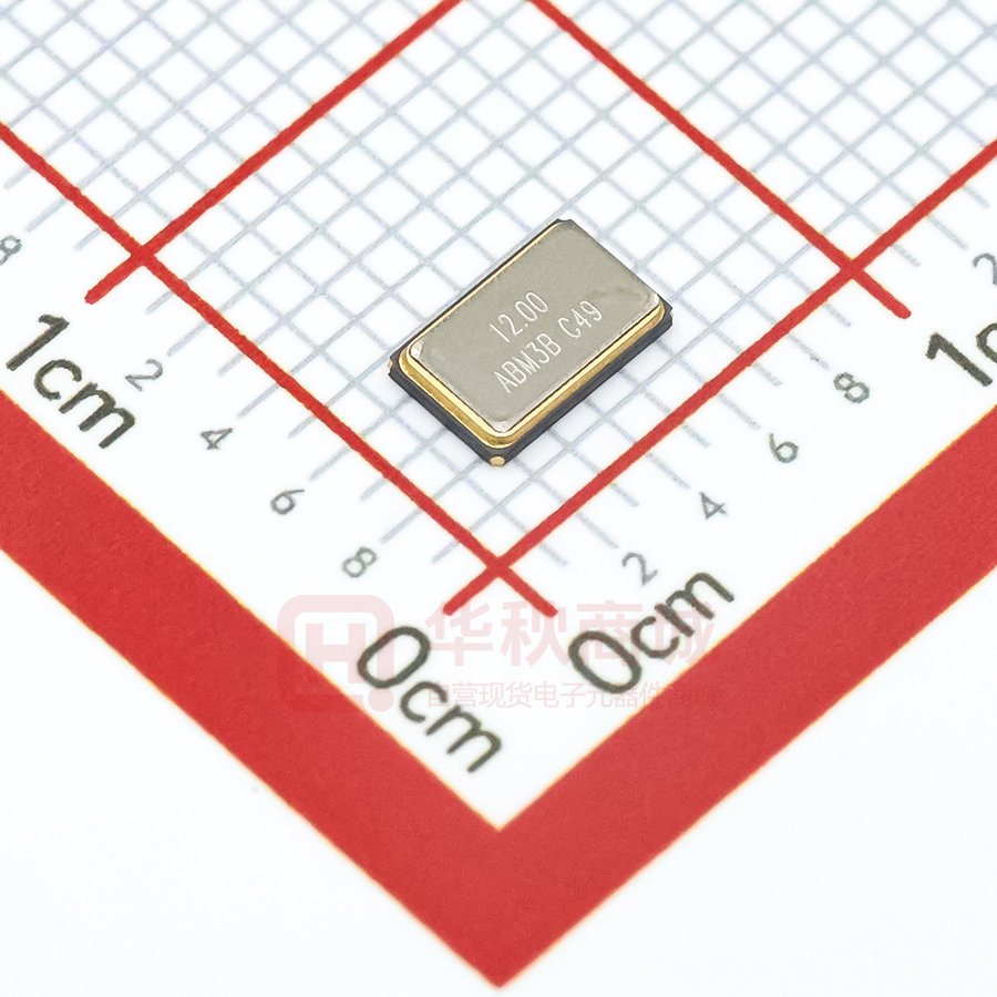

CERAMIC SMD CRYSTAL ABM3B Pb RoHS Compliant FEATURES: • Fundamental mode. • Suitable for reflow. • Tight Stability available. • Ceramic package and metal lid assures high precision and reliability. • Seam sealing. 5.0 X 3.2 X 1.1mm | | | | | | | | | | | | | | | APPLICATIONS: • Cellular telephones, Pagers. • Communication and Test equipment. • High Density applications. • PCMCIA and wireless applications. STANDARD SPECIFICATIONS: PARAMETERS ABRACON P/N Frequency Range ABM3B Series 8.0MHz - 50.0MHz (Fundamental 50.1MHz - 125MHz (3rd overtone) Operation Mode Operating Temperature Storage Temperature Frequency Tolerance @ 25°C Fundamental or 3rd overtone - 10°C to + 60°C (see options) - 40°C to + 85°C ± 50 ppm max. (see options) Frequency Stability over the Operating Temperature (Ref to + 25°C) Equivalent Series Resistance Shunt Capacitance C0 Load Capacitance CL Drive Level Aging (First Year) @ 25°C ± 3°C Insulation Resistance ± 50 ppm max. (see options) See table 1 7 pF max. 18 pF (see options) 100 µW max., 10 µW typical ± 5ppm max. 500 M Ω min at 100Vdc ± 15 V TABLE 1- Standard ESR Frequency (MHz) 8.000 - 9.999 (Fund.) 10.000 -11.999 (Fund.) 12.000 - 15.999 (Fund.) ABRACON IS 9001:2008 ISOISO 9001 / QS 9000 CERTIFIED ESR( Ω) max 200 100 70 Frequency (MHz) 16.000 - 50.000 (Fund.) 50.001 - 80.000 (3rd OT) 80.001 - 125.000 (3rd OT) LLC ESR( Ω max ) 50 60 80 2 Faraday, Suite# B | Irvine | CA 92618 Revised: 08.25.15 Ph. 949.546.8000 | Fax. 949.546.8001 Visit www.abracon.com for Terms and Conditions of Sale CERAMIC SMD CRYSTAL ABM3B Pb RoHS Compliant 5.0 X 3.2 X 1.1mm | | | | | | | | | | | | | | | OPTIONS AND PART IDENTIFICATION: (Left blank if standard) ABM3B – MHz - - - - Height (mm) Blank: 1.1mm max 1: 0.8mm max Packaging Blank: Bulk T: 1k pcs per reel T2: 250 pcs per reel Frequency in MHz e.g. 8.000MHz 14.31818MHz 26.000MHz 125.000MHz Load Capacitance Please specify CL(6 to 32pF) in pF or S for Series Please contact ABRACON for values under 6pF - ESRSTD if Custom other than standard R□ □: Specify a value in Ω (e.g.: R40) Operating Temp. E: 0°C ~ +70°C B: -20°C ~ +70°C C: -30°C ~ +70°C N: -30°C ~ +85°C D: -40°C ~ +85°C J****: -40°C ~ +105°C K****: -40°C ~ +125°C L*: -55°C ~ +125°C Freq. Tolerance 1: ± 10 ppm 7: ± 15 ppm 2: ± 20 ppm 3: ± 25 ppm 4: ± 30 ppm Freq. Stability U**: ± 10 ppm G***: ± 15 ppm X: ± 20 ppm W: ± 25 ppm Y: ± 30 ppm H: ± 35 ppm Z: ± 100 ppm (*) Option Z only (**)Standard temp or options E and B only (***)Standard temp or options E, B, C and N only. (****) Freq. stability ±50ppm and ±100ppm only. Contact ABRACON for tighter freq. stability. OUTLINE DIMENSIONS: Please see Table 2 below for height and chamfer information. Chamfer on PIN 1 (Default) Table 2 Height (mm) Chamfer PIN # ABM3B 1.1mm max #1 (Default), #4 (See Note) ABM3B1 0.8mm max #1 (Default), #4 (See Note) Chamfer on PIN 4 (See Note) Note: Due to the availability of raw materials, this part may be manufactured with the chamfer on pin 4. Be advised that this does not affect the electrical characteristics of the crystal in any way. ABRACON IS 9001:2008 ISOISO 9001 / QS 9000 CERTIFIED LLC Dimension : Inches (mm) 2 Faraday, Suite# B | Irvine | CA 92618 Revised: 08.25.15 Ph. 949.546.8000 | Fax. 949.546.8001 Visit www.abracon.com for Terms and Conditions of Sale CERAMIC SMD CRYSTAL ABM3B Pb RoHS Compliant 5.0 X 3.2 X 1.1mm | | | | | | | | | | | | | | | REFLOW PROFILE: TAPE & REEL: T=1000pcsTape and reel T2=250pcsTape and reel Dimension : mm ATTENTION: Abracon Corporation’s products are COTS – Commercial-Off-The-Shelf products; suitable for Commercial, Industrial and, where designated, Automotive Applications. Abracon’s products are not specifically designed for Military, Aviation, Aerospace, Life-dependant Medical applications or any application requiring high reliability where component failure could result in loss of life and/or property. For applications requiring high reliability and/or presenting an extreme operating environment, written consent and authorization from Abracon Corporation is required. Please contact Abracon Corporation for more information. ABRACON IS 9001:2008 ISOISO 9001 / QS 9000 CERTIFIED LLC 2 Faraday, Suite# B | Irvine | CA 92618 Revised: 08.25.15 Ph. 949.546.8000 | Fax. 949.546.8001 Visit www.abracon.com for Terms and Conditions of Sale

物料型号:ABM3B
器件简介:ABM3B是一款陶瓷表面贴装晶体振荡器,符合RoHS标准,尺寸为5.0 x 3.2 x 1.1mm。
引脚分配:文档中未明确提供引脚分配信息,但通常这类晶体振荡器会有四个引脚,分别为GND、GND、1号引脚和2号引脚。
参数特性: - 频率范围:8.0MHz至50.0MHz(基频)或50.1MHz至125MHz(三次谐波) - 工作模式:基频或三次谐波 - 工作温度:10°C至+60°C(有其他选项) - 存储温度:-40°C至+85°C - 频率容差:±50ppm(有其他选项) - 频率稳定性:±50ppm(有其他选项) - 等效串联电阻:见表1 - 并联电容:最大7pF - 负载电容:18pF(有其他选项) - 驱动电平:最大100mW,典型10mW - 老化率:第一年±5ppm - 绝缘电阻:最小500MΩ
功能详解:文档中未提供详细的功能解释,但晶体振荡器通常用于为电子设备提供稳定的时钟信号。
应用信息:适用于手机、寻呼机、通信和测试设备、高密度应用、PCMCIA和无线应用。
封装信息:陶瓷封装和金属盖确保了高精度和可靠性。还提供了不同的封装选项,如高度和包装方式。
