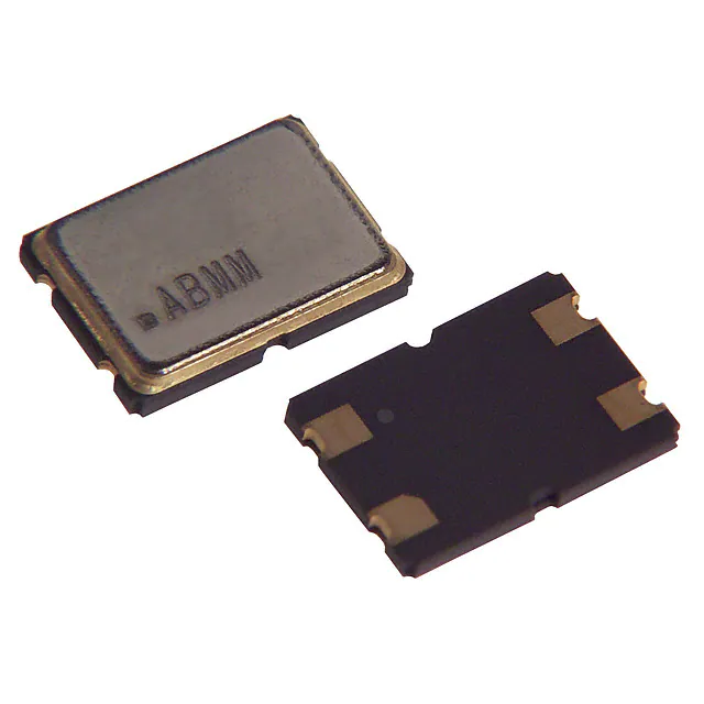

    无源晶振 27MHz ±20ppm 18pF 40Ω -20℃~+70℃
ABMM-27.000MHZ-B2-T 数据手册
CERAMIC SURFACE MOUNT MICROPROCESSOR CRYSTAL ABMM Pb RoHS Compliant FEATURES: • Suitable for RoHS reflow • Low height 1.3 mm max • AT-strip cut offers a tight tolerance & stability 7.0 x 5.0 x 1.3 mm | | | | | | | | | | | | | APPLICATIONS: • Computers, Modems, Microprocessors • Communication, Test equipment • PCMCIA STANDARD SPECIFICATIONS: PARAMETERS ABRACON P/N Frequency Range ABMM 6.0 MHz to 125 MHz Operation Mode AT-cut 6.0 MHz ~ 33.0 MHz (Fundamental: Standard) 33.01 MHz - 125 MHz (Third-Overtone: Standard) 33.01 MHz ~ 50.0 MHz (Fundamental: Please spedcify. See options) Operating Temperature Storage Te mperature Frequency Tolerance at +25°C Frequency Stability over the Operating Temp. (Ref to +25°C) Equivalent Series Resistance Shunt Capacitance C 0 Load Capacitance C L Drive Level Aging at 25°C (first year) Insulation Resistance - 10°C to + 60°C (see options) - 40°C to + 85°C ± 50 ppm max. (see options) ± 50 ppm max. (see options) See Table 1 7pF max. 18pF (see options) 500µW max., 100µW typical ± 5ppm max. 500MΩ min at 100Vdc ± 15V TABLE 1: STANDARD ESR Frequency (MHz) 6.000 - 11.999(Fund) 12.000 - 20.000(Fund) ESR (Ω) Max 70 50 Frequency (MHz) 20.000 - 50.000(Fund) 33.000 - 125.00(3rd O/T) ESR (Ω) Max 40 80 OPTIONS & PART IDENTIFICATION: (Left blank if standard) ABMM – MHz - -R - - - - - Fre qu e nc y in MHz e .g. 6.000MHz 14.318 18MHz 26.000 MHz Pac kag ing Blan k: Bulk T: Ta pe & Ree l (1k) T2: Ta pe & Ree l (250) Load Capac itance P lea se s pe cify CL (8 to 33 pF) in pF or S for S e rie s P lea se co nta ct ABRACON fo r othe r va lue s Mode F: Fund.AT for >33 MHz ES R if o the r than S TD S pe cify a va lue in Ω Ope rating Te mp. E: 0°C ~ +70°C B: -20°C ~ +70°C C: -30°C ~ +70°C N: -30°C ~ +85°C D: -40°C ~ +85°C ABRACON IS ISO9001:2008 CE RTIFIED Fre q. Tole ranc e 1: ± 10 ppm 7: ± 15 ppm 2: ± 20 ppm 3: ± 25 ppm 4: ± 30 ppm Fre q. S tability U: ± 10 pp m (*) G: ± 15 ppm (**) X: ± 20 pp m W: ± 25 pp m Y: ± 30 pp m H: ± 35 pp m * -10 to +60°C only. ** Option E, B, and10 to +60°C only. Revised: 02.26.12 Visit www.abracon.com for Terms & Conditions of Sale 30332 Esperanza, Rancho Santa Margarita, California 92688 tel 949-546-8000 | fax 949-546-8001| www.abracon.com | | CERAMIC SURFACE MOUNT MICROPROCESSOR CRYSTAL ABMM Pb RoHS Compliant 7.0 x 5.0 x 1.3 mm | | | | | | | | | | | | | | | OUTLINE DRAWING: Dime nsion : Inche s (mm) Note 1: A longer pad (1.5mm) may appear on either pad 2, 3, or 4. Note 2: A chamfer of 0.3mm may appear on pad 1 or 2. Note 3: Pads 2 and 4 are connected to the metal lid. REFLOW PROFILE: TAPE & REEL: Tape and reel 1,000 pcs/reel Dimensions: mm Need a test socket for the ABMM Series? To view compatible PRECISION TEST & BURN-IN SOCKETS for these parts, click here. ABRACONISIS ABRACON ISO 9001 / QS 9000 ISO9001:2008 CE R CE RTIFIED ATTENTION: Abracon Corporation’s products are COTS – Commercial-Off-The-Shelf products; suitable for Commercial, Industrial and, where designated, Automotive Applications. Abracon’s products are not specifically designed for Military, Aviation, Aerospace, Life-dependant Medical applications or any application requiring high reliability where component failure could result in loss of life and/or property. For applications requiring high reliability and/or presenting an extreme operating environment, written consent and authorization from Abracon Corporation is required. Please contact Abracon Corporation for more information. Revised: 02.26.12 Visit www.abracon.com for Terms & Conditions of Sale 30332 Esperanza, Rancho Santa Margarita, California 92688 tel 949-546-8000 | fax 949-546-8001| www.abracon.com
