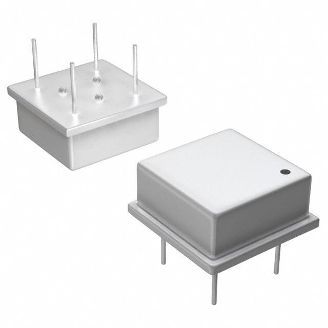

    有源晶振 48.000000MHz ±30ppm 3.3V -20℃~+70℃ HCMOS, TTL
ACHL-48.000MHZ-EK 数据手册
HALF SIZE DIP LOW VOLTAGE 3.3VHCMOS/TTL COMPATIBLE CRYSTAL CLOCK OSCILLATOR Sensitivity Level (MSL) – This product is Hermetically ACHL Series Moisture Sealed and not Moisture Sensitive - MSL = N/A: Not Applicable Pb RoHS Compliant 13.2 x 13.2 x 5.5mm APPLICATIONS: FEATURES: • Tri-state Enable/Disable option • Low supply voltage 3.3V • HCMOS and TTL compatible • Tight symmetry option 50% +/-5% • Clock signal sources for digital chips and microprocessors • Low power applications STANDARD SPECIFICATIONS: Parameters Frequency Range Operating Temperature Storage Temperature Overall Frequency Stability Supply Voltage (Vdd) 0.400MHz ~ 24.999MHz Input Current 25.000MHz ~ 99.999MHz 100.000MHz ~ 16000MHz Symmetry (@ 1/2Vdd) Minimum 0.400 0 -55 -100 2.97 Typical ----------------3.3 ------------- ------------- 40 50 ------------- ------------- Maximum 160.000 +70 +125 +100 3.63 20 40 80 60 Units MHz °C °C ppm V Notes See options See options mA % See options VOH VOL --------0.9*Vdd ----- ----------------- 10 5 4 15 5 ----0.1*Vdd VIH 2.2 ----- ----- V VIL ----- ----- 0.8 V Output Enable time Output Disable time --------- Start-up Time ----- --------1 4 100 10 ms ns ms Phase Jitter RMS (12~20MHz) ----- ----- 1 ps Reference only. Please contact Abracon for specific frequencies Aging -5.0 ----- +5.0 ppm @+25°C First year Rise and Fall Time (Tr/Tf) 0.400MHz ~ 24.999MHz 25.000MHz ~ 99.999MHz 100.000MHz ~ 16000MHz Output Load Output Voltage Tri-state Function ns pF TTL V V See options "1" or Open: Oscillation "0": Output disable (Hi Z) For option A only For option A only * Overall frequency stability includes initial tolerance, temperature stability, and aging. OPTIONS & PART IDENTIFICATION: (Left blank if standard) ACHL - MHz - - - - Pin form G: Gull Wing G3; Gull Wing Q25: 0.25” (6.35) Frequency in MHz e.g. 24.576MHz 14.31818MHz 26.000MHz Q20: 0.20” (5.08) Operating Temp. I: 0°C ~ +50°C D: -10°C ~ +60°C E: -20°C ~ +70°C F: -30°C ~ +70°C N: -30°C ~ +85°C L: -40°C ~ +85°C Q15: 0.15” (3.81) Freq. Stability J: ± 20 ppm(*) R: ± 25 ppm K: ± 30 ppm H: ± 35 ppm C: ± 50 ppm Symmetry Blank: 40/60% @1/2Vdd S: 45/55% @1/2Vdd Tri-state Blank: No Tri-state A: Tri-state on pin 1 (*) Temp option I, D, E and 0°C ~ +70°C only. ABRACON IS ISO9001:2008 CE RTIFIED CE RTIFIED LLC Output Load Blank: 15pF 30: 30pF 50: 50pF 2 Faraday, Suite# B | Irvine | CA 92618 Revised: 01.20.16 Ph. 949.546.8000 | Fax. 949.546.8001 Visit www.abracon.com for Terms and Conditions of Sale HALF SIZE DIP LOW VOLTAGE 3.3VHCMOS/TTL COMPATIBLE CRYSTAL CLOCK OSCILLATOR ACHL Series Pb RoHS Compliant 13.2 x 13.2 x 5.5mm | | | | | | | | | | | | | | OUTLINE DIMENSIONS: Pin 1 4 5 8 Note: Recommend using an approximately 0.01uF bypass capacitor between PIN 2 and 4. Function Tri-State/NC GND Output Vdd Dimensions: inches (mm) Packaging 40pcs /tube ATTENTION:Abracon Corporation’s products are COTS – Commercial-Off-The-Shelf products; suitable for Commercial, Industrial and, where designated, Automotive Applications. Abracon’s products are not specifically designed for Military, Aviation, Aerospace, Life-dependant Medical applications or any application requiring high reliability where component failure could result in loss of life and/or property. For applications requiring high reliability and/or presenting an extreme operating environment, written consent and authorization from Abracon Corporation is required. Please contact Abracon Corporation for more information. ABRACON IS ISO9001:2008 CE RTIFIED CE RTIFIED LLC 2 Faraday, Suite# B | Irvine | CA 92618 Revised: 01.20.16 Ph. 949.546.8000 | Fax. 949.546.8001 Visit www.abracon.com for Terms and Conditions of Sale |
ACHL-48.000MHZ-EK
- 物料型号: ACHL系列 - 器件简介: 该振荡器是为数字芯片和微处理器提供时钟信号源的低电压、低功耗产品,兼容HCMOS和TTL。 - 引脚分配: - 引脚1: 三态/无连接(NC) - 引脚4: 地(GND) - 引脚5: 输出 - 引脚8: 电源(Vdd) - 参数特性: - 频率范围: 0.400 MHz 至 160.000 MHz - 工作温度: 0℃ 至 +70℃ - 存储温度: -55℃ 至 +125℃ - 供电电压: 2.97V 至 3.63V - 输入电流: 20mA至80mA,取决于频率范围 - 对称性: 40% 至 60%,取决于选项 - 上升和下降时间: 4ns 至 10ns,取决于频率范围 - 输出负载: 15pF至50pF,取决于选项 - 功能详解: - 三态功能允许振荡器输出禁用(HiZ)或启用 - 启动时间: 1ms 至 10ms - 相位抖动: 1ps (参考值,具体频率请联系厂家) - 老化率: -5.0 ppm 至 +5.0 ppm (第一年在+25°C) - 应用信息: 适用于商业、工业和指定的汽车应用。不特别设计用于军事、航空、航天、生命依赖的医疗应用或任何需要高可靠性的应用。 - 封装信息: 尺寸为13.2 x 13.2 x 5.5mm,推荐在引脚2和4之间使用大约0.01uF的旁路电容器。
