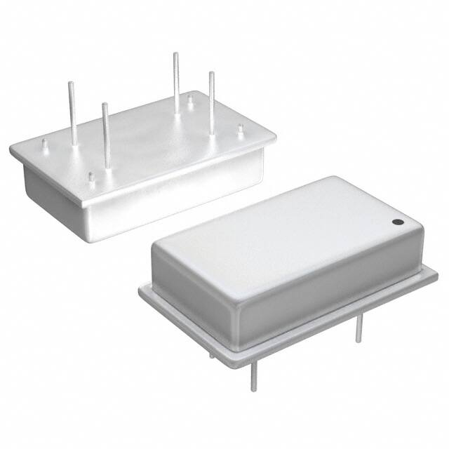

FULL SIZE DIP LOW VOLTAGE 3.3V CRYSTAL CLOCK OSCILLATOR ACOL Series ESD Sensitive Pb RoHS/RoHS II compliant 20.2 x 12.6 x 5.08 mm APPLICATIONS: FEATURES: • Tristate Enable/Disable option. • Low supply voltage. • HCMOS and TTL compatible. • Tight symmetry option. • Clock signal sources for digital chips and microprocessors. • Low power applications. STANDARD SPECIFICATIONS: Minimum 0.320 0 -55 -100 2.97 Typical 3.3 320.000kHz ~ 24.000MHz 24.001MHz ~ 49.999MHz Input Current 50.000MHz ~ 79.999MHz 80.000MHz ~ 200.000MHz 320.000kHz ~ 49.999MHz 45 Rise and Fall Time (Tr/Tf) Units MHz °C °C ppm V Notes See options See options 50.000MHz ~ 200.000MHz 40 mA 55 % 10 5 320.000kHz ~ 24.000MHz 24.001MHz ~ 200.000MHz 24.001MHz ~ 200.000MHz (50pF output load) 15 10 15 5 Output Load 80.000MHz ~ 200.000MHz Tri-state Function (Option A) ns 10 32.000kHz ~ 79.999MHz Output Voltage See options 60 EO Symmetry @ 1/2Vdd for HCMOS or @ 1.4Vdc for TTL Maximum 200.000 +70 +125 +100 3.63 20 30 45 55 L Parameters Frequency Range Operating Temperature Storage Temperature Overall Frequency Stability Supply Voltage (Vdd) VOH VOL 0.9*Vdd VIH 2.2 0.1*Vdd VIL Output Enable time Output Disable time Startup Time pF TTL pF TTL V V V 0.8 V 4 100 10 ms ns ms See options "1" or Open: Oscillation "0": Output disable (Hi Z) For option A only For option A only * Overall frequency stability includes initial tolerance and temperature stability. ABRACON IS ISO9001:2008 CE RTIFIED CE RTIFIED LLC 2 Faraday, Suite# B | Irvine | CA 92618 Revised: 09.25.15 Ph. 949.546.8000 | Fax. 949.546.8001 Visit www.abracon.com for Terms and Conditions of Sale FULL SIZE DIP LOW VOLTAGE 3.3V CRYSTAL CLOCK OSCILLATOR ACOL Series Pb RoHS/RoHS II compliant 20.2 x 12.6 x 5.08 mm OPTIONS & PART IDENTIFICATION: (Left blank if standard) ACOL- MHz- - - - - - Frequency in MHz e.g. 24.576MHz 14.31818MHz 26.000MHz Pin form G: Gull Wing Q25: 0.25” (6.35) Q20: 0.20” (5.08) Q15: 0.15” (3.81) Operating Temp. I: 0°C ~ +50°C D: -10°C ~ +60°C E: -20°C ~ +70°C F: -30°C ~ +70°C N: -30°C ~ +85°C L: -40°C ~ +85°C Output Load L 50: 50pF (25≤F≤100MHz only) Freq. Stability J*: ± 20 ppm R: ± 25 ppm K: ± 30 ppm H: ± 35 ppm C: ± 50 ppm Symmetry S: 45/55%@1/2Vdd T: 47.5/52.5%@1/2Vdd EO * Temp option I, D, E only and 0 to +70oC only Tri-state A: Tri-state on pin 1 OUTLINE DIMENSIONS: Pin 1 7 8 14 Function Tri-State/NC GND Output Vdd Note: Recommend using an approximately 0.01uF bypass capacitor between PIN 7 and 14. Dimensions: inches (mm) Packaging: 25pcs /tube ATTENTION: Abracon Corporation’s products are COTS – Commercial-Off-The-Shelf products; suitable for Commercial, Industrial and, where designated, Automotive Applications. Abracon’s products are not specifically designed for Military, Aviation, Aerospace, Life-dependant Medical applications or any application requiring high reliability where component failure could result in loss of life and/or property. For applications requiring high reliability and/or presenting an extreme operating environment, written consent and authorization from Abracon Corporation is required. Please contact Abracon Corporation for more information. ABRACON IS ISO9001:2008 CE RTIFIED CE RTIFIED LLC 2 Faraday, Suite# B | Irvine | CA 92618 Revised: 09.25.15 Ph. 949.546.8000 | Fax. 949.546.8001 Visit www.abracon.com for Terms and Conditions of Sale
ACOL-24.576MHZ-EK
物料型号:ACOL系列
器件简介:该振荡器具有三态使能/禁用选项,低供电电压,与HCMOS和TTL兼容,并提供紧密对称选项。
引脚分配: - 1:三态/无连接 - 7:地 - 8:输出 - 14:供电电压(Vdd)
参数特性: - 频率范围:0.320 MHz 至 200.000 MHz - 工作温度:0℃ 至 +70℃ - 存储温度:-55℃ 至 +125℃ - 整体频率稳定性:-100 ppm 至 +100 ppm - 供电电压(Vdd):2.97V 至 3.63V - 输入电流:20 mA(320 kHz 至 24 MHz),30 mA(24.001 MHz 至 49.999 MHz),45 mA(50 MHz 至 79.999 MHz),55 mA(80 MHz 至 200 MHz) - 输出负载:15 pF(80 MHz 至 200 MHz),5 pF(TTL) - 输出电压:VOH 为 0.9 Vdd,VOL 为 0.1 Vdd - 三态功能(选项A):VIH 为 2.2V,VIL 为 0.8V
功能详解: - 三态功能允许振荡器输出禁用(高阻态)或正常振荡。 - 推荐在引脚7和14之间使用大约0.01uF的旁路电容器。
应用信息: - 数字芯片和微处理器的时钟信号源。 - 低功耗应用。
封装信息: - 尺寸:20.2 x 12.6 x 5.08 mm - 包装:每管25个
