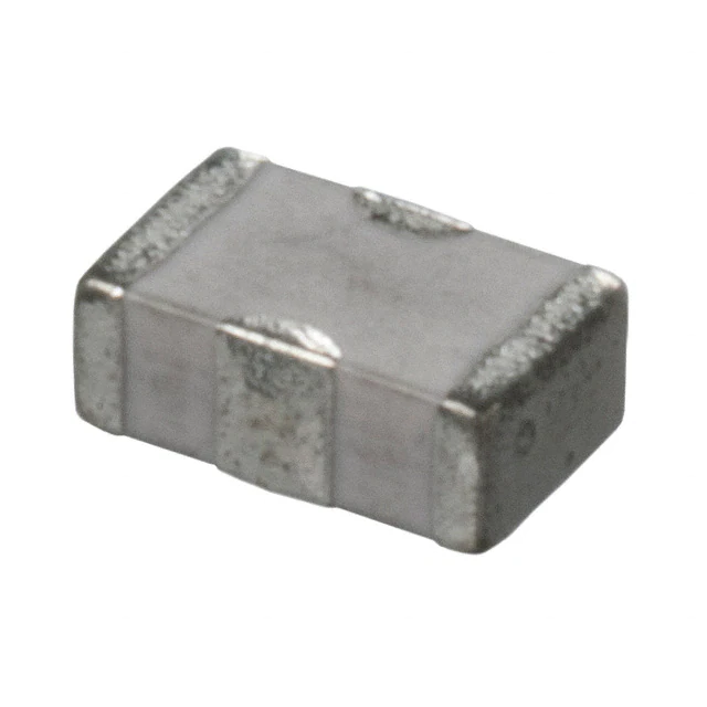

3-Terminal EMI Filter AEMIF-0805 Pb RoHS/RoHS II Compliant FEATURES: • Multilayer and low profile structure enables high density mounting • Closed magnetic circuit minimizes crosstalk • Sharp attenuation characteristic beyond cutoff frequency achieves excellent EMI suppression • Wide range of cutoff frequencies from 100MHz to 500MHz available 2.0 x 1.2 x 0.96mm APPLICATIONS: • Noise removal from signal lines in digital cameras, computers, game consoles, LED TVs, etc. • Suppression of noise generated by high speed digital circuits such as clock lines STANDARD SPECIFICATIONS: Operating Temperature -40ºC to +85ºC Storage Temperature -10ºC to +40ºC, 70% RH max. in tape and reel Units -3dB Cut-off Frequency MHz Cut-off Frequency Tolerance % Rated Voltage Rated Current V mA Min. Insulation Resistance MΩ AEMIF-0805-101M-16 100 M 16 200 AEMIF-0805-151M-16 150 M 16 AEMIF-0805-201M-16 200 M AEMIF-0805-301M-16 300 AEMIF-0805-401M-16 AEMIF-0805-501M-16 Part Number Max. DC Resistance Attenuation Ω dB 200 1.5 20.0 dB min. at 250-2000 MHz 200 200 1.0 20.0 dB min. at 350-2000 MHz 16 250 200 1.0 20.0 dB min. at 450-2000 MHz M 16 300 200 1.0 20.0 dB min. at 550-2000 MHz 400 M 16 300 200 0.8 20.0 dB min. at 800-2000 MHz 500 M 16 300 200 0.8 20.0 dB min. at 1000-2000 MHz Test Equipment Items Test Equipment Cut off Frequency HP8753E or equivalent DC Resistance HP4338 or equivalent Insulation Resistance TH2682 or equivalent Attenuation HP8753E or equivalent PART NUMBER IDENTIFICATION AEMIF-0805- Cutoff Frequency Please refer to the Table ABRACON IS ISOISO 9001 9001:2008 / QS 9000 CE RTIFIED Tolerance Code M: ± 20% - - Rated Voltage Please refer to the Table Packaging T: 4kpcs/reel Revised: 07.28.14 Visit www.abracon.com for Terms & Conditions of Sale 30332 Esperanza, Rancho Santa Margarita, California 92688 tel 949-546-8000| fax 949-546-8001 | www.abracon.com 3-Terminal EMI Filter AEMIF-0805 Pb RoHS/RoHS II Compliant 2.0 x 1.2 x 0.96mm FREQUENCY CHARACTERISTIC AEMIF-0805-101M-16 ABRACON IS ISOISO 9001 9001:2008 / QS 9000 CE RTIFIED AEMIF-0805-151M-16 AEMIF-0805-201M-16 AEMIF-0805-301M-16 AEMIF-0805-401M-16 AEMIF-0805-501M-16 Revised: 07.28.14 Visit www.abracon.com for Terms & Conditions of Sale 30332 Esperanza, Rancho Santa Margarita, California 92688 tel 949-546-8000| fax 949-546-8001 | www.abracon.com 3-Terminal EMI Filter AEMIF-0805 Pb RoHS/RoHS II Compliant 2.0 x 1.2 x 0.96mm OUTLINE DIMENSION: L W T e1 e2 e3 2.0±0.2 1.2±0.2 0.96±0.2 0.3±0.15 0.5±0.15 0.3±0.15 Recommended Land Pattern A B C D E 0.6 1.4 3.2 1.2 2.2 Dimension: mm EQUIVALENT CIRCUIT: ABRACON IS ISOISO 9001 9001:2008 / QS 9000 CE RTIFIED Revised: 07.28.14 Visit www.abracon.com for Terms & Conditions of Sale 30332 Esperanza, Rancho Santa Margarita, California 92688 tel 949-546-8000| fax 949-546-8001 | www.abracon.com 3-Terminal EMI Filter AEMIF-0805 Pb RoHS/RoHS II Compliant 2.0 x 1.2 x 0.96mm REFLOW PROFILE: Peak 260 ˚C max 260 ˚C 217 ˚C • • • • • • Max Ramp Up Rate=3 ˚C/s ec . Max Ramp Down Rate=6 ˚C/sec . 60∼90s ec . 200 ˚C 150 ˚C 60∼120sec . 25 ˚C Preheat condition: 150 ~200oC/60~120sec. Allowed time above 217 oC: 60~90sec. Max temp: 260 oC Max time at max temp: 10sec. Solder paste: Sn/3.0Ag/0.5Cu Allowed Reflow time: 2x max Time 25 ˚C to Peak =8 min max TAPE & REEL T= tape and reel (4,000pcs/reel) A B P W K max T max 1.42 2.25 4.0 8.0 1.14 0.27 Dimension: mm ATTENTION: Abracon Corporation’s products are COTS – Commercial-Off-The-Shelf products; suitable for Commercial, Industrial and, where designated, Automotive Applications. Abracon’s products are not specifically designed for Military, Aviation, Aerospace, Life-dependant Medical applications or any application requiring high reliability where component failure could result in loss of life and/or property. For applications requiring high reliability and/or presenting an extreme operating environment, written consent and authorization from Abracon Corporation is required. Please contact Abracon Corporation for more information. ABRACON IS ISOISO 9001 9001:2008 / QS 9000 CE RTIFIED Revised: 07.28.14 Visit www.abracon.com for Terms & Conditions of Sale 30332 Esperanza, Rancho Santa Margarita, California 92688 tel 949-546-8000| fax 949-546-8001 | www.abracon.com
