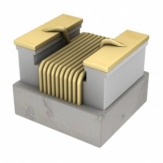

    高频电感 700mΩ 180nH ±5% 620mA 750MHz 2.29mm 2.92 x 2.79mm IND_2.92X2.79MM_SM
AISC-1008-R18J-T 数据手册
SMD Wire-Wound Chip Inductor (Ceramic or Ferrite Core) AISC-1008(F) SERIES Pb 2.92 x 2.79 x 2.29mm RoHS/RoHS II Compliant MSL = MSL - 1 FEATURES APPLICATIONS • Ceramic construction assures the utmost thermal stability & high SRF • Exceptionally high Q compared to non-wirewound inductors, especially at high frequencies • Inductance options from 4.7nH to 8200nH • Widely applied in VCO, SAW circuit for GSM, & CDMA communications • Used in hard disk, notebook computers & other electronic equipment Electrical Specifications Part Number AISC-1008Inductance Inductance Code Units nH Symbol L Min. L/Q Test Max. DC Max. Rated Min. Self-resonant Tolerance Quality Freq. Resistance Current Frequency Factor MHz Ω mA MHz Q Freq. DCR Ir S.R.F AISC-1008-R0047 4.7 J, K, M 50 50/1500 0.11 1000 >6000 AISC-1008-R010 10 G, J, K, M 50 50/500 0.08 1000 4100 AISC-1008-R012 12 G, J, K, M 50 50/500 0.09 1000 3300 AISC-1008-R015 15 G, J, K, M 50 50/500 0.13 1000 2500 AISC-1008-R018 18 G, J, K, M 50 50/350 0.11 1000 2500 AISC-1008-R022 22 G, J, K, M 55 50/350 0.12 1000 2400 AISC-1008-R027 27 G, J, K, M 55 50/350 0.13 1000 1600 AISC-1008-R033 33 G, J, K, M 60 50/350 0.14 1000 1600 AISC-1008-R039 39 G, J, K, M 50 50/350 0.15 1000 1500 AISC-1008-R047 47 G, J, K, M 65 50/350 0.16 1000 1500 AISC-1008-R056 56 G, J, K, M 50 50/350 0.18 1000 1300 AISC-1008-R068 68 G, J, K, M 65 50/350 0.21 1000 1200 AISC-1008-R082 82 G, J, K, M 60 50/350 0.22 1000 800 AISC-1008-R10 100 G, J, K, M 60 25/350 0.56 650 1000 AISC-1008-R12 120 G, J, K, M 60 25/350 0.63 650 950 AISC-1008-R15 150 G, J, K, M 50 25/100 0.62 580 800 AISC-1008-R18 180 G, J, K, M 50 25/100 0.7 620 750 AISC-1008-R22 220 G, J, K, M 50 25/100 0.8 500 630 AISC-1008-R27 270 G, J, K, M 50 25/100 0.91 500 600 AISC-1008-R33 330 G, J, K, M 50 25/100 1.05 450 530 AISC-1008-R39 390 G, J, K, M 50 25/100 1.12 470 480 LLC 5101 Hidden Creek Ln Spicewood TX 78669 Phone: 512-371-6159 | Fax: 512-351-8858 For terms and conditions of sales, please visit: www.abracon.com REVISED: 09.05.2018 ABRACON IS ISO9001-2015 CERTIFIED SMD Wire-Wound Chip Inductor (Ceramic or Ferrite Core) AISC-1008(F) SERIES Pb 2.92 x 2.79 x 2.29mm RoHS/RoHS II Compliant MSL = MSL - 1 Electrical Specifications Part Number AISC-1008Inductance Inductance Code Units nH Symbol L Min. L/Q Test Max. DC Max. Rated Min. Self-resonant Tolerance Quality Freq. Resistance Current Frequency Factor MHz Ω mA MHz Q Freq. DCR Ir S.R.F AISC-1008-R47 470 G, J, K, M 50 25/100 1.19 470 450 AISC-1008-R56 560 G, J, K, M 50 25/100 1.33 400 390 AISC-1008-R62 620 G, J, K, M 45 25/100 1.4 300 375 AISC-1008-R68 680 G, J, K, M 45 25/100 1.47 400 360 AISC-1008-R75 750 G, J, K, M 45 25/100 1.54 360 360 AISC-1008-R82 820 G, J, K, M 45 25/100 1.61 400 330 AISC-1008-R91 910 G, J, K, M 35 25/50 1.68 380 295 AISC-1008-1R0 1,000 G, J, K, M 35 25/50 1.8 370 270 AISC-1008-1R2 1,200 G, J, K, M 35 7.9/50 2 310 200 AISC-1008-1R5 1,500 G, J, K, M 28 7.9/50 2.3 330 150 AISC-1008-1R8 1,800 G, J, K, M 28 7.9/50 2.6 300 120 AISC-1008-2R2 2,200 G, J, K, M 28 7.9/50 2.8 280 100 AISC-1008-1R7 2,700 G, J, K, M 22 7.9/25 3.2 290 90 AISC-1008-3R3 3,300 G, J, K, M 22 7.9/25 3.4 290 70 AISC-1008-3R9 3,900 G, J, K, M 17 7.9/25 3.6 260 60 AISC-1008-4R7 4,700 G, J, K, M 20 7.9/25 4 260 50 AISC-1008-5R6 5,600 G, J, K, M 20 7.9/25 5.7 240 40 AISC-1008-6R8 6,800 G, J, K, M 20 7.9/25 7.7 200 40 AISC-1008-8R2 8,200 G, J, K, M 20 7.9/25 10.7 150 30 AISC-1008F-R33 330 J, K, M 50 25/100 0.17 700 600 AISC-1008F-1R0 1,000 J, K, M 20 7.9/50 0.80 600 250 AISC-1008F-1R2 1,200 J, K, M 37 7.9/50 0.80 650 250 AISC-1008F-1R5 1,500 J, K, M 35 7.9/50 0.76 630 190 AISC-1008F-1R8 1,800 J, K, M 33 7.9/50 0.84 600 170 AISC-1008F-2R2 2,200 J, K, M 30 7.9/50 1.15 520 150 AISC-1008F-2R7 2,700 J, K, M 25 7.9/50 1.30 490 120 AISC-1008F-3R3 3,300 J, K, M 23 7.9/50 1.70 450 100 AISC-1008F-3R9 3,900 J, K, M 26 7.9/25 2.00 420 100 AISC-1008F-4R7 4,700 J, K, M 31 7.9/7.9 1.68 400 60 AISC-1008F-5R6 5,600 J, K, M 23 7.9/7.9 2.65 380 80 AISC-1008F-6R8 6,800 J, K, M 20 7.9/7.9 3.00 360 60 AISC-1008F-8R2 8,200 J, K, M 20 7.9/7.9 3.30 330 40 AISC-1008F-100 10,000 J, K, M 15 7.9/7.9 2.95 300 40 LLC 5101 Hidden Creek Ln Spicewood TX 78669 Phone: 512-371-6159 | Fax: 512-351-8858 For terms and conditions of sales, please visit: www.abracon.com REVISED: 09.05.2018 ABRACON IS ISO9001-2015 CERTIFIED SMD Wire-Wound Chip Inductor (Ceramic or Ferrite Core) AISC-1008(F) SERIES Pb 2.92 x 2.79 x 2.29mm RoHS/RoHS II Compliant MSL = MSL - 1 Operating Temperature: -40ºC to +125ºC for AISC-1008, -40ºC to +85ºC for AISC-1008F Storage Temperature: -10ºC to +40ºC, 70% RH max. Rated Current (Ir): Ir is direct electric current as chip surface temperature rose just 20°C against chip initial surface temperature (Ta) Electrical Characteristics Curves LLC 5101 Hidden Creek Ln Spicewood TX 78669 Phone: 512-371-6159 | Fax: 512-351-8858 For terms and conditions of sales, please visit: www.abracon.com REVISED: 09.05.2018 ABRACON IS ISO9001-2015 CERTIFIED SMD Wire-Wound Chip Inductor (Ceramic or Ferrite Core) AISC-1008(F) SERIES Pb 2.92 x 2.79 x 2.29mm RoHS/RoHS II Compliant MSL = MSL - 1 Part Number Identification AISC-1008 Material Code Blank: Ceramic F: Ferrite - Inductance Code Please refer to the table - Tolerance Code Packaging T: Tape & Reel (2k/reel) G: ±2% J: ±5% K: ±10% M: ±20% Marking: No Marking LLC 5101 Hidden Creek Ln Spicewood TX 78669 Phone: 512-371-6159 | Fax: 512-351-8858 For terms and conditions of sales, please visit: www.abracon.com REVISED: 09.05.2018 ABRACON IS ISO9001-2015 CERTIFIED SMD Wire-Wound Chip Inductor (Ceramic or Ferrite Core) AISC-1008(F) SERIES Pb 2.92 x 2.79 x 2.29mm RoHS/RoHS II Compliant MSL = MSL - 1 Mechanical Dimensions A MAX. 2.92 B MAX. 2.79 C MAX. 2.29 D REF. 0.51 E 2.1±0.2 F 0.5±0.2 H REF. 2.54 I REF. 1.02 J REF. 1.27 Dimensions: mm LLC 5101 Hidden Creek Ln Spicewood TX 78669 Phone: 512-371-6159 | Fax: 512-351-8858 For terms and conditions of sales, please visit: www.abracon.com REVISED: 09.05.2018 ABRACON IS ISO9001-2015 CERTIFIED SMD Wire-Wound Chip Inductor (Ceramic or Ferrite Core) AISC-1008(F) SERIES Pb 2.92 x 2.79 x 2.29mm RoHS/RoHS II Compliant MSL = MSL - 1 Materials No A B C Components Coating Core Wire D Electrodes Material Ultraviolet epoxy resin Ceramic Polyurethane system enameled copper wire AISC-1008: Mo-Mn with Ni and Au plating AISC-1008F: Ag-Pd with Ni-Sn plating Reflow Profile 3 Tp Tp Critical Zone TL to Tp Ramp Up Temperature TL TSMAX TL TSMIN Ramp Down Preheat 1 2 25 t 25˚C to Peak Time Zone Description 1 Preheat 2 Reflow 3 Peak heat Temperature TSMIN ~ TSMAX 150°C ~ 200°C TL 217°C TP 260°C LLC Times 60 ~ 120 sec. 60 ~ 90 sec. 10 sec. MAX 5101 Hidden Creek Ln Spicewood TX 78669 Phone: 512-371-6159 | Fax: 512-351-8858 For terms and conditions of sales, please visit: www.abracon.com REVISED: 09.05.2018 ABRACON IS ISO9001-2015 CERTIFIED SMD Wire-Wound Chip Inductor (Ceramic or Ferrite Core) AISC-1008(F) SERIES Pb 2.92 x 2.79 x 2.29mm RoHS/RoHS II Compliant MSL = MSL - 1 Packing T= tape and reel (2,000pcs/reel) A 2.73±0.2 P 4.0±0.1 B 2.90±0.2 K Max 2.34±0.2 T 0.23±0.1 Dimensions: mm LLC 5101 Hidden Creek Ln Spicewood TX 78669 Phone: 512-371-6159 | Fax: 512-351-8858 For terms and conditions of sales, please visit: www.abracon.com REVISED: 09.05.2018 ABRACON IS ISO9001-2015 CERTIFIED
AISC-1008-R18J-T
物料型号:AISC-1008(F)系列,其中"F"表示使用铁氧体芯。
器件简介:该系列电感器采用陶瓷构造,确保了极高的热稳定性和高自谐振频率(SRF)。与非绕线电感器相比,尤其在高频下,具有异常高的Q值。
引脚分配:文档中没有提供具体的引脚分配信息,但通常SMD电感器有端点引脚用于连接电路。
参数特性:提供了不同型号的电感值、公差、最小品质因数(Q)、L/Q测试频率、最大直流电阻(DCR)、最大额定电流(Ir)和最小自谐振频率(S.R.F)。
功能详解:广泛应用于VCO、GSM和CDMA通信的SAW电路,也用于硬盘、笔记本电脑等电子设备。
应用信息:文档中没有提供具体的应用案例,但提到了电感器在通信和电子设备中的应用。
封装信息:提供了电感器的尺寸和材料代码,以及标记代码和包装信息。例如,"T"表示胶带和卷轴(2000件/卷)。
