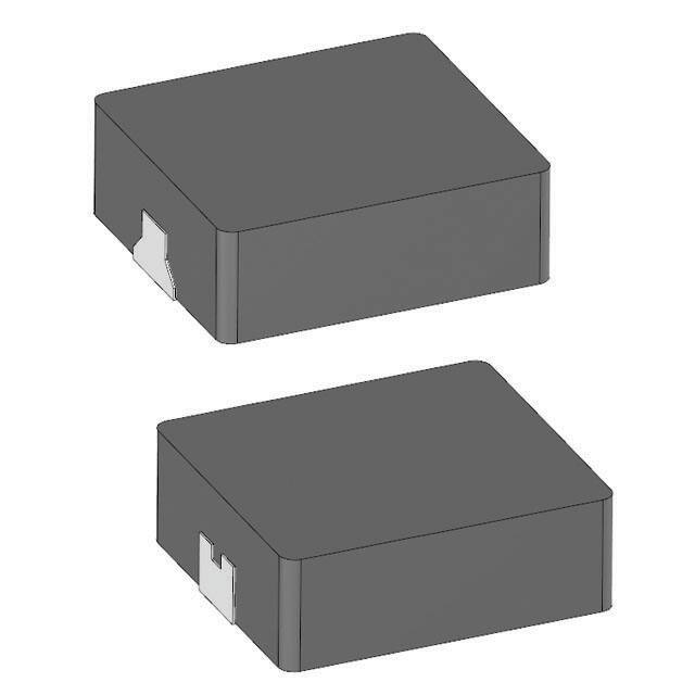

    SMD,11x10mm
    固定电感器 Nonstandard 82µH ±20% 2.3A 270mΩ
AMDLA1004S-820MT 数据手册
AMDLA1004S MOLDED INDUCTOR ™ LLC FEATURES ISO 9001:2015 CERTIFIED GENERAL SPECIFICATIONS ELECTRICAL SPECIFICATIONS @ 25°C INDUCTANCE (uH) TOLERANCE (%) IRMS (A) ISAT (A) 0.15 0.22 0.36 0.42 0.47 0.56 0.68 1.0 1.5 2.2 3.3 4.7 5.6 6.8 8.2 10.0 15.0 22.0 33.0 47.0 68.0 82.0 100.0 30 20 20 20 20 20 20 20 20 20 20 20 20 20 20 20 20 20 20 20 20 20 20 44 36 33 32 32 25 23 20 17.5 15 11 8.8 8 7.8 7.6 7.5 6.25 5 4.4 3.5 2.6 2.3 2 82 70 51 50 46 34 31 29 26 20 17.5 15.2 14.1 12.2 9.5 8.6 7 6.2 5.5 4 3.2 3 2.7 DC RESISTANCE (mΩ) TYP MAX 0.5 0.72 1.05 1.15 1.3 1.6 1.9 2.9 3.7 5.8 10.5 15.8 19 22 25 27 41 58 84 125 184 240 270 0.6 0.83 1.18 1.3 1.5 1.8 2.2 3.25 4.2 6.7 11.8 19 22.8 24.5 28 30 45 66 91 143 210 270 310 TYPE Non-Lead Frame Non-Lead Frame Non-Lead Frame Non-Lead Frame Non-Lead Frame Non-Lead Frame Non-Lead Frame Non-Lead Frame Non-Lead Frame Lead Frame Lead Frame Lead Frame Lead Frame Lead Frame Lead Frame Lead Frame Lead Frame Lead Frame Lead Frame Lead Frame Lead Frame Lead Frame Lead Frame * Please refer to Part Identification section Operating Temperature: -55°C to +155°C with (40°C rise) Irms current. Maximum Part Temperature: +155°C Components Storage Temperature: -55°C to +125°C Tape and Reel Packaging Temperature: -55°C to +80°C MSL: Level 1 MATERIALS Core: Wire: Terminal: Ink: Metal Alloy Copper Tin Plating Black PRODUCT DIMENSIONS 11.0 ± 0.3 2.0 ± 0.3 Bottom View (Lead Frame) 3.8 ± 0.2 Top View Test Conditions Inductance: 100 kHz, 1 V, 0 Adc Humidity Range: 85 ± 2% RH Temperature Rise Current: Current measured at Δ T of 40°C Saturation Current: Current measured at Δ L of 30% Front View 2.0 ± 0.3 PART BUILDER Side View (Lead Frame) 3.0 ± 0.3 Bottom View (Non-Lead Frame) AMDLA1004S 1R0 M T Series Inductance* Tol. 1 Packaging 2 1. Tolerance: M = 20% N = 30% RECOMMENDED LANDING PATTERN 12.5 2. Packaging: B = Bulk T = Tape and Reel (500pcs/reel) *Refer to Electrical Specification table Side View (Non-Lead Frame) 3.5 AMDLA1004S-R15NT AMDLA1004S-R22MT AMDLA1004S-R36MT AMDLA1004S-R42MT AMDLA1004S-R47MT AMDLA1004S-R56MT AMDLA1004S-R68MT AMDLA1004S-1R0MT AMDLA1004S-1R5MT AMDLA1004S-2R2MT AMDLA1004S-3R3MT AMDLA1004S-4R7MT AMDLA1004S-5R6MT AMDLA1004S-6R8MT AMDLA1004S-8R2MT AMDLA1004S-100MT AMDLA1004S-150MT AMDLA1004S-220MT AMDLA1004S-330MT AMDLA1004S-470MT AMDLA1004S-680MT AMDLA1004S-820MT AMDLA1004S-101MT ROHS COMPLIANT 2.5 ± 0.3 • PART NUMBER* Pb Shielded construction Soft saturation Low DCR per cubic mm Designed for switching frequencies between 100KHz-2MHz Automotive option available upon request 10.0 ± 0.3 • • • • Check Inventory Request Samples 5.4 Dimensions: mm ™ LLC Revised 05/01/20 AMDLA1004S MOLDED INDUCTOR ™ LLC RECOMMENDED REFLOW PROFILE 3 Tp Tp Critical Zone TL to Tp Ramp Up Temperature TL TSMAX TL TSMIN Ramp Down Preheat 1 2 25 t 25˚C to Peak Time ZONE DESCRIPTION 1 Preheat 2 Reflow 3 Peak Heat TEMPERATURE Tsmin ~ Tsmax 150°C ~ 200°C TL 217°C TP 260°C TIMES 60 ~ 180 sec. 60 ~ 150 sec. 10 sec. MAX ™ LLC Revised 05/01/20 AMDLA1004S MOLDED INDUCTOR ™ LLC PACKAGING Tape and Reel: 500 Units per Carton: 4,000 T&R per Carton: 8 Weight per Carton: 13.9 kg Weight per Unit: 2.2 g Carton Dimensions: 410 x 325 x 415 mm TYPE A B C D 13” x 24 mm 24.4 +2/-0 100.0 ± 2.0 13.5 +0.5/-0.2 330.0 B0 11.6 ± 0.1 A0 10.4 ± 0.1 K0 4.5 ± 0.1 P W F T D 16.0 ± 0.1 24.0 ± 0.3 11.5 ± 0.1 0.35 ± 0.05 1.5 ± 0.1 Dimensions: mm This product is commercial off-the-shelf (COTS) and not specifically designed for automotive, military, aviation, aerospace, implantable, life-dependent medical or safety applications. This product is not recommended for use in any application requiring high reliability in which component failure could result in loss of life and/or property damage without prior written approval from Abracon. Specifications are subject to change without notice. Contact Abracon for more information. ™ LLC Headquarters: 5101 Hidden Creek Ln Spicewood TX 78669 Phone: 512-371-6159 | Fax: 512-351-8858 Revised 05/01/20
