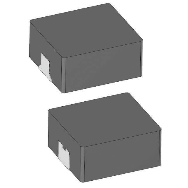

    固定电感器 Nonstandard 68µH ±20% 4.8A 100mΩ
AMDLA1306S-680MT 数据手册
AMDLA1306S MOLDED INDUCTOR ™ LLC FEATURES ISO 9001:2015 CERTIFIED GENERAL SPECIFICATIONS ELECTRICAL SPECIFICATIONS @ 25°C INDUCTANCE (uH) TOLERANCE (%) IRMS (A) ISAT (A) 0.10 0.22 0.47 0.56 0.68 0.82 1.0 1.2 1.5 1.8 2.2 3.3 4.7 5.6 6.8 8.2 10 22.0 33.0 47.0 68.0 82.0 100.0 30 20 20 20 20 20 20 20 20 20 20 20 20 20 20 20 20 20 20 20 20 20 20 60 42 35 33.5 33 31 29 27 25 23 21 19 17 15 14 12.5 11 8 6.5 5.7 4.8 4 3.8 115 105 58 50 46 39 36 33 30 27 24 22.5 21 19.5 18 17 15 9 8 6.8 5 4.2 4 DC RESISTANCE (mΩ) TYP MAX 0.2 0.4 0.88 1.10 1.25 1.30 1.50 1.80 2.20 3.20 3.70 5.30 6.80 8.30 9.80 12 13 31 46 58 82 110 140 0.25 0.46 1.02 1.3 1.5 1.65 1.8 2.2 2.53 3.6 4.2 6.2 8 9.8 11.3 13.8 15.8 35 55 67 100 132 161 TYPE Non-Lead Frame Non-Lead Frame Non-Lead Frame Non-Lead Frame Non-Lead Frame Non-Lead Frame Non-Lead Frame Non-Lead Frame Non-Lead Frame Non-Lead Frame Lead Frame Lead Frame Lead Frame Lead Frame Lead Frame Lead Frame Lead Frame Lead Frame Lead Frame Lead Frame Lead Frame Lead Frame Lead Frame * Please refer to Part Identification section Operating Temperature: -55°C to +155°C with (40°C rise) Irms current. Maximum Part Temperature: +155°C Components Storage Temperature: -55°C to +125°C Tape and Reel Packaging Temperature: -55°C to +80°C MSL: Level 1 MATERIALS Core: Wire: Terminal: Ink: Metal Alloy Copper Tin Plating Black PRODUCT DIMENSIONS 13.5 ± 0.5 2.3 ± 0.3 Bottom View (Lead Frame) 6.2 ± 0.3 Top View Test Conditions Inductance: 100 kHz, 1 V, 0 Adc Humidity Range: 85 ± 2% RH Temperature Rise Current: Current measured at Δ T of 40°C Saturation Current: Current measured at Δ L of 30% Front View 2.3 ± 0.3 PART BUILDER Side View (Lead Frame) 4.0 ± 0.3 Bottom View (Non-Lead Frame) AMDLA1306S 1R0 M T Series Inductance* Tol. 1 Packaging 2 1. Tolerance: M = 20% N = 30% RECOMMENDED LANDING PATTERN 14.5 2. Packaging: B = Bulk T = Tape and Reel (500pcs/reel) *Refer to Electrical Specification table Side View (Non-Lead Frame) 5.0 AMDLA1306S-R10NT AMDLA1306S-R22MT AMDLA1306S-R47MT AMDLA1306S-R56MT AMDLA1306S-R68MT AMDLA1306S-R82MT AMDLA1306S-1R0MT AMDLA1306S-1R2MT AMDLA1306S-1R5MT AMDLA1306S-1R8MT AMDLA1306S-2R2MT AMDLA1306S-3R3MT AMDLA1306S-4R7MT AMDLA1306S-5R6MT AMDLA1306S-6R8MT AMDLA1306S-8R2MT AMDLA1306S-100MT AMDLA1306S-220MT AMDLA1306S-330MT AMDLA1306S-470MT AMDLA1306S-680MT AMDLA1306S-820MT AMDLA1306S-101MT ROHS COMPLIANT 4.7 ± 0.3 • PART NUMBER* Pb Shielded construction Soft saturation Low DCR per cubic mm Designed for switching frequencies between 100KHz-2MHz Automotive option available upon request 12.6 ± 0.2 • • • • Check Inventory Request Samples 8.0 Dimensions: mm ™ LLC Revised 05/01/20 AMDLA1306S AMDLA1306S MOLDED MOLDED INDUCTOR INDUCTOR ™ ™ LLC LLC RECOMMENDED REFLOW PROFILE 3 Tp Tp Critical Zone TL to Tp Ramp Up Temperature TL TSMAX TL TSMIN Ramp Down Preheat 1 2 25 t 25˚C to Peak Time ZONE DESCRIPTION 1 Preheat 2 Reflow 3 Peak Heat TEMPERATURE Tsmin ~ Tsmax 150°C ~ 200°C TL 217°C TP 260°C TIMES 60 ~ 180 sec. 60 ~ 150 sec. 10 sec. MAX ™ LLC Revised 05/01/20 AMDLA1306S AMDLA1306S MOLDED MOLDED INDUCTOR INDUCTOR ™ ™ LLC LLC PACKAGING Tape and Reel: 500 Units per Carton: 4,000 T&R per Carton: 8 Weight per Carton: 27.1 kg Weight per Unit: 5.5 g Carton Dimensions: 410 x 325 x 415 mm TYPE A B C D 13” x 24 mm 24.4 +2/-0 100.0 ± 2.0 13.5 +0.5/-0.2 330.0 B0 14.1 ± 0.1 A0 12.9 ± 0.1 K0 7.0 ± 0.1 P W F T D 16.0 ± 0.1 24.0 ± 0.3 11.5 ± 0.1 0.35 ± 0.05 1.5 ± 0.1 Dimensions: mm This product is commercial off-the-shelf (COTS) and not specifically designed for automotive, military, aviation, aerospace, implantable, life-dependent medical or safety applications. This product is not recommended for use in any application requiring high reliability in which component failure could result in loss of life and/or property damage without prior written approval from Abracon. Specifications are subject to change without notice. Contact Abracon for more information. ™ LLC Headquarters: 5101 Hidden Creek Ln Spicewood TX 78669 Phone: 512-371-6159 | Fax: 512-351-8858 Revised 05/01/20
AMDLA1306S-680MT
物料型号:AMDLA1306S 器件简介:一种电感器,具有不同的电感值和公差,适用于不同的电流和直流电阻规格。
引脚分配:有铅框架和无铅框架两种类型,具体尺寸和引脚信息参见数据手册的详细视图。
参数特性:包括电感值、公差、电流额定值、饱和电流、直流电阻等。
功能详解:具有屏蔽构造,软饱和特性,低直流电阻,适用于100kHz至2MHz的开关频率。
还可根据要求提供汽车选项。
应用信息:适用于需要高可靠性的商业应用,但不建议在汽车、军事、航空、航天、植入式、生命依赖医疗或安全应用中使用,除非得到Abracon的书面批准。
封装信息:提供通孔和表面贴装两种封装方式,具体尺寸和包装信息参见数据手册。
请根据具体应用需求和环境条件选择合适的型号和封装。
