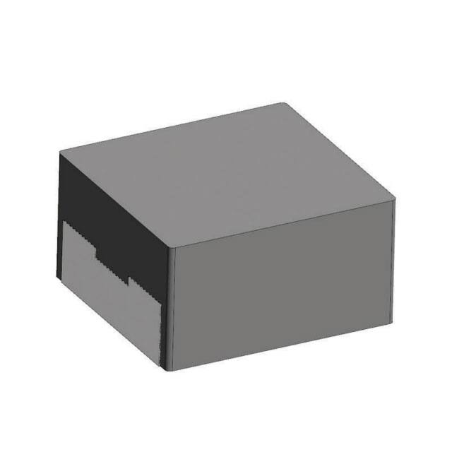

    固定电感器 Nonstandard 1.5µH ±20% 57A 1.15mΩ
AMDLA2213Q-1R5MT 数据手册
AMDLA2213Q MOLDED INDUCTOR ™ LLC FEATURES • • • • • AEC-Q200 Qualified Shielded construction Soft saturation Low DCR per cubic mm Designed for switching frequencies between 100KHz-2MHz ELECTRICAL SPECIFICATIONS @ 25°C PART NUMBER* INDUCTANCE (uH) TOLERANCE (%) IRMS (A) ISAT (A) 1.5 2.0 2.2 3.0 3.3 4.7 6.8 10 22 23 33 47 68 75 82 100 20 20 20 20 20 20 20 20 20 20 20 20 20 20 20 20 57 54 52 48 47 44 36 30 18 18 16 14 12 11 10 9.5 48 45 43 39 37 34 32 20 14 14 10.5 10 9.0 8.5 7.7 7.5 AMDLA2213Q-1R5MT AMDLA2213Q-2R0MT AMDLA2213Q-2R2MT AMDLA2213Q-3R0MT AMDLA2213Q-3R3MT AMDLA2213Q-4R7MT AMDLA2213Q-6R8MT AMDLA2213Q-100MT AMDLA2213Q-220MT AMDLA2213Q-230MT AMDLA2213Q-330MT AMDLA2213Q-470MT AMDLA2213Q-680MT AMDLA2213Q-750MT AMDLA2213Q-820MT AMDLA2213Q-101MT Check Inventory Request Samples MAX 1.0 1.02 1.05 1.42 1.5 1.9 2.7 3.8 9.2 9.2 13.5 17.3 26.2 27.5 31.0 36.0 1.15 1.2 1.25 1.64 1.75 2.2 3.1 4.15 11 11 15.4 20.8 29.5 31.6 34.2 40 ISO 9001:2015 CERTIFIED Pb ROHS COMPLIANT GENERAL SPECIFICATIONS DC RESISTANCE (mΩ) TYP AEC-Q200 QUALIFIED TYPE Lead Frame Lead Frame Lead Frame Lead Frame Lead Frame Lead Frame Lead Frame Lead Frame Lead Frame Lead Frame Lead Frame Lead Frame Lead Frame Lead Frame Lead Frame Lead Frame * Please refer to Part Identification section Test Conditions Inductance: 100 kHz, 1 V, 0 Adc Humidity Range: 85 ± 2% RH Temperature Rise Current: Current measured at Δ T of 40°C Saturation Current: Current measured at Δ L of 30% Operating Temperature: -55°C to +155°C with (40°C rise) Irms current. Maximum Part Temperature: +155°C Components Storage Temperature: -55°C to +125°C Tape and Reel Packaging Temperature: -55°C to +80°C MSL: Level 1 MATERIALS Core: Wire: Terminal: Ink: Metal Alloy Copper Tin Plating Black PRODUCT DIMENSIONS 23.5 ± 0.5 AMDLA2213Q 1R0 M T Series Inductance* Tol. 1 Packaging 2 1. Tolerance: M = 20% 2. Packaging: B = Bulk T = Tape and Reel (80pcs/reel) *Refer to Electrical Specification table Top View Bottom View 12.6 ± 0.40 PART BUILDER 19.0 ± 0.3 22.0 ± 0.3 5.0 ± 0.4 Front View Side View RECOMMENDED LANDING PATTERN 19.6 24.0 12.5 Dimensions: mm ™ LLC Revised 05/11/20 AMDLA2213Q MOLDED INDUCTOR ™ LLC RECOMMENDED REFLOW PROFILE 3 Tp Tp Critical Zone TL to Tp Ramp Up Temperature TL TSMAX TL TSMIN Ramp Down Preheat 1 2 25 t 25˚C to Peak Time ZONE DESCRIPTION 1 Preheat 2 Reflow 3 Peak Heat TEMPERATURE Tsmin ~ Tsmax 150°C ~ 200°C TL 217°C TP 260°C TIMES 60 ~ 180 sec. 60 ~ 150 sec. 10 sec. MAX ™ LLC Revised 05/11/20 AMDLA2213Q MOLDED INDUCTOR ™ LLC PACKAGING Tape and Reel: 80 Units per Carton: 320 T&R per Carton: 4 Weight per Carton: 14.9 kg Weight per Unit: 35.5 g Carton Dimensions: 410 x 325 x 415 mm B0 25.0 ± 0.1 TYPE A B C D 13” x 44 mm 44.4 +2/-0 100.0 ± 2.0 13.0 +0.5/-0.2 330.0 A0 23.0 ± 0.1 K0 13.6 ± 0.1 P P₀ P₂ W F T D 32.0 ± 0.1 4.0 ± 0.05 2.0 ± 0.05 44.0 ± 0.3 20.2 ± 0.1 0.5 ± 0.05 1.5 ± 0.1 Dimensions: mm This product is commercial off-the-shelf (COTS) and not specifically designed for automotive, military, aviation, aerospace, implantable, life-dependent medical or safety applications. This product is not recommended for use in any application requiring high reliability in which component failure could result in loss of life and/or property damage without prior written approval from Abracon. Specifications are subject to change without notice. Contact Abracon for more information. ™ LLC Headquarters: 5101 Hidden Creek Ln Spicewood TX 78669 Phone: 512-371-6159 | Fax: 512-351-8858 Revised 05/11/20
