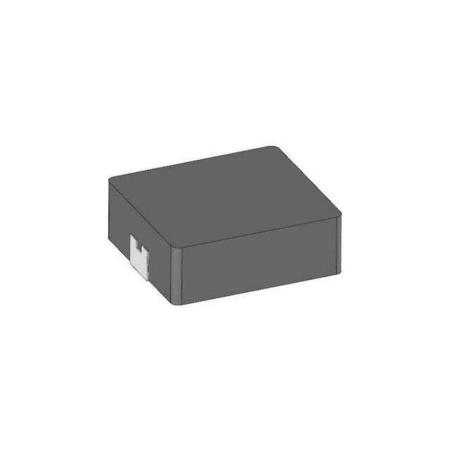

    固定电感器 Nonstandard 10µH ±20% 7.5A 30mΩ
AMPLA1004S-100MT 数据手册
AMPLA1004S MOLDED INDUCTOR LLC FEATURES ISAT (A) 0.15 0.19 0.22 0.24 0.27 0.30 0.36 0.39 0.45 0.47 0.56 0.68 0.75 0.88 1.0 1.2 1.5 1.8 2.2 2.5 3.0 3.3 3.9 4.0 4.7 5.6 6.2 6.8 7.3 8.2 10.0 15.0 18.0 22.0 27.0 33.0 47.0 68.0 30 30 20 20 20 20 20 20 20 20 20 20 20 20 20 20 20 20 20 20 20 20 20 20 20 20 20 20 20 20 20 20 20 20 20 20 20 20 43 36 35 34 33 32 31 30 29 28 25 22 22 20 18 17 16 14 12 11.5 11.5 11 10.5 10.2 10.0 9.0 8.7 8.5 8.3 8.0 7.5 6.25 5.5 5.0 4.0 3.5 3.0 2.0 75 70 60 60 60 60 60 60 45 43 40 39 39 38 36 33 33 30 27 23 21 20 19 18 17 14 13.7 13.5 13 12.5 12 10 9.0 7.0 6.0 5.0 4.5 3.0 DC RESISTANCE (mΩ) TYP MAX 0.5 0.6 0.8 0.8 0.82 0.94 1.05 1.1 1.3 1.3 1.6 2.4 2.4 2.5 3.0 3.3 4.0 5.3 6.5 7.9 10 10.8 12.6 13 15 17 17.2 17.5 19 20 27 40 56 64 86 92 145 205 0.6 0.9 1.0 1.0 1.0 1.1 1.2 1.3 1.5 1.5 1.8 2.7 2.7 2.9 3.3 3.8 4.6 6.4 7.0 8.7 11.5 11.8 14.5 15 15.5 19.3 21.3 23.3 21.8 22.5 30 45 62 74 100 112 167 240 TYPE Non-Lead Frame Non-Lead Frame Non-Lead Frame Non-Lead Frame Non-Lead Frame Non-Lead Frame Non-Lead Frame Non-Lead Frame Non-Lead Frame Non-Lead Frame Non-Lead Frame Non-Lead Frame Non-Lead Frame Non-Lead Frame Non-Lead Frame Non-Lead Frame Non-Lead Frame Lead Frame Lead Frame Lead Frame Lead Frame Lead Frame Lead Frame Lead Frame Lead Frame Lead Frame Lead Frame Lead Frame Lead Frame Lead Frame Lead Frame Lead Frame Lead Frame Lead Frame Lead Frame Lead Frame Lead Frame Lead Frame MATERIALS Core: Wire: Terminal: Ink: Paint: Carbonyl Powder Copper Tin Plating Black Gray PRODUCT DIMENSIONS 11.0 ± 0.5 2.3 ± 0.3 3.0 ± 0.3 IRMS (A) Operating Temperature: -55°C to +125°C with (40°C rise) Irms current. Maximum Part Temperature: +125°C Components Storage Temperature: -55°C to +125°C Tape and Reel Packaging Temperature: -55°C to +80°C MSL: Level 1 Bottom View (Lead Frame) Top View 3.8 ± 0.2 AMPLA1004S-R15NT AMPLA1004S-R19NT AMPLA1004S-R22MT AMPLA1004S-R24MT AMPLA1004S-R27MT AMPLA1004S-R30MT AMPLA1004S-R36MT AMPLA1004S-R39MT AMPLA1004S-R45MT AMPLA1004S-R47MT AMPLA1004S-R56MT AMPLA1004S-R68MT AMPLA1004S-R75MT AMPLA1004S-R88MT AMPLA1004S-1R0MT AMPLA1004S-1R2MT AMPLA1004S-1R5MT AMPLA1004S-1R8MT AMPLA1004S-2R2MT AMPLA1004S-2R5MT AMPLA1004S-3R0MT AMPLA1004S-3R3MT AMPLA1004S-3R9MT AMPLA1004S-4R0MT AMPLA1004S-4R7MT AMPLA1004S-5R6MT AMPLA1004S-6R2MT AMPLA1004S-6R8MT AMPLA1004S-7R3MT AMPLA1004S-8R2MT AMPLA1004S-100MT AMPLA1004S-150MT AMPLA1004S-180MT AMPLA1004S-220MT AMPLA1004S-270MT AMPLA1004S-330MT AMPLA1004S-470MT AMPLA1004S-680MT TOLERANCE (%) ISO 9001:2015 CERTIFIED GENERAL SPECIFICATIONS ELECTRICAL SPECIFICATIONS @ 25°C INDUCTANCE (uH) ROHS COMPLIANT Front View Side View (Lead Frame) 2.3 ± 0.3 3.0 ± 0.3 • PART NUMBER* Pb Shielded construction Soft saturation High current density Designed for switching frequencies between 100KHz-2MHz Automotive option available upon request 10.0 ± 0.3 • • • • Check Inventory Request Samples Bottom View (Non-Lead Frame) Side View (Non-Lead Frame) RECOMMENDED LANDING PATTERN 13.6 Test Condtions Inductance: 100 kHz, 1 V, 0 Adc Humidity Range: 85 ± 2% RH Temperature Rise Current: Current measured at ∆ T of 40°C Saturation Current: Current measured at ∆ L of 30% LLC 3.5 * Please refer to Part Identification section 5.4 Dimensions: mm Revised 09/23/19 AMPLA1004S MOLDED INDUCTOR LLC PART BUILDER AMPLA1004S 1R0 M Series Inductance* Tol. 1. Tolerance: M = 20% N = 30% T 1 Packaging 2 2. Packaging: B = Bulk T = Tape and Reel (500pcs/reel) *Refer to Electrical Specification table RECOMMENDED REFLOW PROFILE 3 Tp Tp Critical Zone TL to Tp Ramp Up Temperature TL TSMAX TL TSMIN Ramp Down Preheat 1 2 25 t 25˚C to Peak Time ZONE DESCRIPTION 1 Preheat 2 Reflow 3 Peak Heat LLC TEMPERATURE Tsmin ~ Tsmax 150°C ~ 200°C TL 217°C TP 260°C TIMES 60 ~ 180 sec. 60 ~ 150 sec. 10 sec. MAX Revised 09/23/19 AMPLA1004S MOLDED INDUCTOR LLC PACKAGING Tape and Reel: 500 Units per Carton: 4,000 T&R per Carton: 8 Weight per Carton: 14.7 kg Weight per Unit: 2.4 g Carton Dimensions: 410 x 325 x 415 mm TYPE A B C D 13” x 24 mm 24.4 +2/-0 100.0 ± 2.0 13.5 +0.5/-0.2 330.0 B0 11.6 ± 0.1 A0 10.4 ± 0.1 K0 4.5 ± 0.1 P W F T D 4.5 ± 0.1 24.0 ± 0.3 11.5 ± 0.1 0.35 ± 0.05 1.5 ± 0.1 Dimensions: mm This product is commercial off-the-shelf (COTS) and not specifically designed for automotive, military, aviation, aerospace, implantable, life-dependent medical or safety applications. This product is not recommended for use in any application requiring high reliability in which component failure could result in loss of life and/or property damage without prior written approval from Abracon. Specifications are subject to change without notice. Contact Abracon for more information. LLC Headquarters: 5101 Hidden Creek Ln Spicewood TX 78669 Phone: 512-371-6159 | Fax: 512-351-8858 Revised 09/23/19
AMPLA1004S-100MT
物料型号:AMPLA1004S MOLDED INDUCTOR
器件简介:AMPLA1004S是一款屏蔽构造的电感器,具有软饱和特性和高电流密度,设计用于100kHz至2MHz的开关频率,可应要求提供汽车选项。
引脚分配:文档中没有提供具体的引脚分配信息。
参数特性: - 工作温度范围:-55°C至+125°C - 最大部件温度:+125°C - 存储温度:-55°C至+125°C - 胶带和卷轴包装温度:-55°C至+80°C - 湿度范围:85 ± 2% RH - 饱和电流:在电感变化30%时测量的电流 - 温度上升电流:在ΔT为40°C时测量的电流
功能详解:AMPLA1004S电感器适用于高电流密度和高频率应用,具有软饱和特性,有助于减少开关时的损耗。
应用信息:该产品是商业现成产品(COTS),不特别设计用于汽车、军事、航空、航天、植入式、生命依赖医疗或安全应用。在任何需要高可靠性的应用中,如果组件故障可能导致生命损失和/或财产损害,不推荐使用此产品,除非事先获得Abracon的书面批准。
封装信息:AMPLA1004S提供多种电感值和公差选项,有非铅框架和铅框架两种封装类型。具体尺寸和推荐焊接图案在文档中有详细说明。
