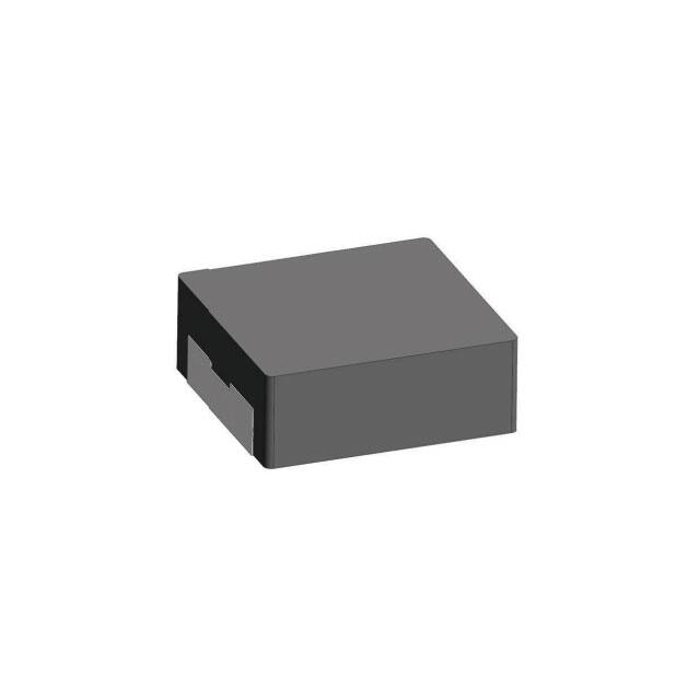

    固定电感器 Nonstandard 15µH ±20% 12.5A 20.5mΩ
AMPLA1707Q-150MT 数据手册
AMPLA1707Q MOLDED INDUCTOR ™ LLC FEATURES • • • • • AEC-Q200 Qualified Shielded construction Soft saturation Low DCR per cubic mm Designed for switching frequencies between 100KHz-2MHz ELECTRICAL SPECIFICATIONS @ 25°C INDUCTANCE (uH) TOLERANCE (%) IRMS (A) ISAT (A) 0.45 0.47 1.0 1.3 1.5 1.8 2.2 3.3 4.7 5.6 6.8 7.4 8.2 10 15 22 33 39 47 56 68 82 100 20 20 20 20 20 20 20 20 20 20 20 20 20 20 20 20 20 20 20 20 20 20 20 62 62 52 49 47 45 43.5 28 25 21 19 18.5 18 16.5 12.5 12 10.7 9.2 8.7 7.8 7 5.7 5.3 125 123 70 67 65 63 62 54 50 45 39 34 31 29 27 23 20 18 16 15 13 12 12 AMPLA1707Q-R45MT AMPLA1707Q-R47MT AMPLA1707Q-1R0MT AMPLA1707Q-1R3MT AMPLA1707Q-1R5MT AMPLA1707Q-1R8MT AMPLA1707Q-2R2MT AMPLA1707Q-3R3MT AMPLA1707Q-4R7MT AMPLA1707Q-5R6MT AMPLA1707Q-6R8MT AMPLA1707Q-7R4MT AMPLA1707Q-8R2MT AMPLA1707Q-100MT AMPLA1707Q-150MT AMPLA1707Q-220MT AMPLA1707Q-330MT AMPLA1707Q-390MT AMPLA1707Q-470MT AMPLA1707Q-560MT AMPLA1707Q-680MT AMPLA1707Q-820MT AMPLA1707Q-101MT DC RESISTANCE (mΩ) TYP MAX 0.80 0.95 1.6 1.7 2.0 2.1 2.4 3.5 4.8 5.8 8.4 8.8 9.6 11.8 17.8 25.1 38 40 48 54 68 87 102 0.96 1.03 2.0 2.3 2.5 2.5 2.7 3.9 5.5 7.05 9.2 9.7 10.8 13 20.5 26.5 44 48 55 62 80 100 118 AEC-Q200 QUALIFIED ISO 9001:2015 CERTIFIED Pb ROHS COMPLIANT GENERAL SPECIFICATIONS TYPE Lead Frame Lead Frame Lead Frame Lead Frame Lead Frame Lead Frame Lead Frame Lead Frame Lead Frame Lead Frame Lead Frame Lead Frame Lead Frame Lead Frame Lead Frame Lead Frame Lead Frame Lead Frame Lead Frame Lead Frame Lead Frame Lead Frame Lead Frame * Please refer to Part Identification section Operating Temperature: -55°C to +125°C with (40°C rise) Irms current. Maximum Part Temperature: +125°C Components Storage Temperature: -55°C to +125°C Tape and Reel Packaging Temperature: -55°C to +80°C MSL: Level 1 MATERIALS Core: Wire: Terminal: Ink: Paint: Carbonyl Powder Copper Tin Plating Black Gray PRODUCT DIMENSIONS 17.6 ± 0.4 16.9 ± 0.3 Test Conditions Inductance: 100 kHz, 1 V, 0 Adc Humidity Range: 85 ± 2% RH Temperature Rise Current: Current measured at ∆ T of 40°C Saturation Current: Current measured at ∆ L of 30% 2.10 ± 0.3 11.9 ± 0.3 PART NUMBER* Check Inventory Request Samples Bottom View 6.7 ± 0.3 Top View PART BUILDER Front View AMPLA1707Q 1R0 M T Series Inductance* Tol. 1 Packaging 2 RECOMMENDED LANDING PATTERN 18.5 2. Packaging: B = Bulk T = Tape and Reel (200pcs/reel) *Refer to Electrical Specification table 12.5 1. Tolerance: M = 20% Side View 12.2 Dimensions: mm ™ LLC Revised 04/17/20 AMPLA1707Q MOLDED INDUCTOR ™ LLC RECOMMENDED REFLOW PROFILE 3 Tp Tp Critical Zone TL to Tp Ramp Up Temperature TL TSMAX TL TSMIN Ramp Down Preheat 1 2 25 t 25˚C to Peak Time ZONE DESCRIPTION 1 Preheat 2 Reflow 3 Peak Heat TEMPERATURE Tsmin ~ Tsmax 150°C ~ 200°C TL 217°C TP 260°C TIMES 60 ~ 180 sec. 60 ~ 150 sec. 10 sec. MAX ™ LLC Revised 04/17/20 AMPLA1707Q MOLDED INDUCTOR ™ LLC PACKAGING Tape and Reel: 200 Units per Carton: 800 T&R per Carton: 4 Weight per Carton: 12.8 kg Weight per Unit: 11.5 g Carton Dimensions: 410 x 325 x 415 mm B0 18.5 ± 0.1 TYPE A B C D 13” x 32 mm 32.4 +2/-0 100.0 ± 2.0 13.0 +0.5/-0.2 330.0 A0 17.5 ± 0.1 K0 7.5 ± 0.1 P 24.0 ± 0.1 P0 4.0 ± 0.1 P₂ W F T D 2.0 ± 0.05 32.0 ± 0.3 14.2 ± 0.1 0.5 ± 0.05 1.5 ± 0.1 Dimensions: mm This product is commercial off-the-shelf (COTS) and not specifically designed for automotive, military, aviation, aerospace, implantable, life-dependent medical or safety applications. This product is not recommended for use in any application requiring high reliability in which component failure could result in loss of life and/or property damage without prior written approval from Abracon. Specifications are subject to change without notice. Contact Abracon for more information. ™ LLC Headquarters: 5101 Hidden Creek Ln Spicewood TX 78669 Phone: 512-371-6159 | Fax: 512-351-8858 Revised 04/17/20
