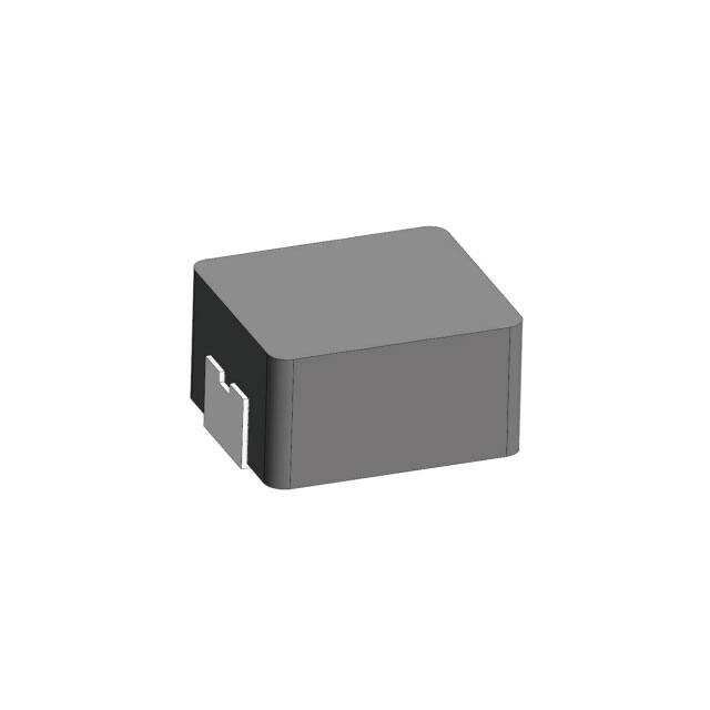

    固定电感器 Nonstandard 3.3µH ±20% 3.5A 76mΩ
AMPLA4020Q-3R3MT 数据手册
AMPLA4020Q MOLDED INDUCTOR ™ LLC FEATURES • • • • • AEC-Q200 Qualified Shielded construction Soft saturation Low DCR per cubic mm Designed for switching frequencies between 100KHz-2MHz ELECTRICAL SPECIFICATIONS @ 25°C INDUCTANCE (uH) TOLERANCE (%) IRMS (A) ISAT (A) 0.10 0.18 0.22 0.33 0.36 0.47 0.56 0.68 1.0 1.2 1.5 2.2 3.3 4.7 5.6 6.8 8.2 10.0 15.0 22.0 30 30 30 20 20 20 20 20 20 20 20 20 20 20 20 20 20 20 20 20 12.0 13.5 13.0 10.0 9.0 8.0 7.3 7.0 5.0 4.8 4.5 4.0 3.5 2.6 2.2 2.1 2.0 1.8 1.5 1.2 35 28 24 18 15 12 10 10 8.5 7.8 7.0 6.0 4.0 3.5 3.0 2.8 2.5 2.3 1.9 1.4 AMPLA4020Q-R10NT AMPLA4020Q-R18NT AMPLA4020Q-R22NT AMPLA4020Q-R33MT AMPLA4020Q-R36MT AMPLA4020Q-R47MT AMPLA4020Q-R56MT AMPLA4020Q-R68MT AMPLA4020Q-1R0MT AMPLA4020Q-1R2MT AMPLA4020Q-1R5MT AMPLA4020Q-2R2MT AMPLA4020Q-3R3MT AMPLA4020Q-4R7MT AMPLA4020Q-5R6MT AMPLA4020Q-6R8MT AMPLA4020Q-8R2MT AMPLA4020Q-100MT AMPLA4020Q-150MT AMPLA4020Q-220MT DC RESISTANCE (mΩ) TYP MAX 3.2 4.6 6.6 7.8 8.7 11.2 13.5 16 22 25 34.8 51 69 95 112 150 158 215 325 470 4 5.4 7.3 8.6 12 14 16 19 27 30 42 61 76 105 125 172 180 243 374 500 AEC-Q200 QUALIFIED ISO 9001:2015 CERTIFIED Pb ROHS COMPLIANT GENERAL SPECIFICATIONS TYPE Lead Frame Lead Frame Lead Frame Lead Frame Lead Frame Lead Frame Lead Frame Lead Frame Lead Frame Lead Frame Lead Frame Lead Frame Lead Frame Lead Frame Lead Frame Lead Frame Lead Frame Lead Frame Lead Frame Lead Frame * Please refer to Part Identification section Operating Temperature: -55°C to +125°C with (40°C rise) Irms current. Maximum Part Temperature: +125°C Components Storage Temperature: -55°C to +125°C Tape and Reel Packaging Temperature: -55°C to +80°C MSL: Level 1 MATERIALS Core: Wire: Terminal: Ink: Paint: Carbonyl Powder Copper Tin Plating Black Gray PRODUCT DIMENSIONS Test Conditions Inductance: 100 kHz, 1 V, 0 Adc Humidity Range: 85 ± 2% RH Temperature Rise Current: Current measured at ∆ T of 40°C Saturation Current: Current measured at ∆ L of 30% 0.76 ± 0.3 4.06 ± 0.25 4.45 ± 0.25 2.0 ± 0.20 PART NUMBER* Check Inventory Request Samples Top View Bottom View AMPLA4020Q 1R0 M T Series Inductance* Tol. 1 Packaging 2 Front View Side View RECOMMENDED LANDING PATTERN 5.2 2. Packaging: B = Bulk T = Tape and Reel (3,000pcs/reel) 2.4 1. Tolerance: M = 20% N = 30% 1.8 ± 0.2 PART BUILDER *Refer to Electrical Specification table 2.2 Dimensions: mm ™ LLC Revised 04/17/20 AMPLA4020Q MOLDED INDUCTOR ™ LLC RECOMMENDED REFLOW PROFILE 3 Tp Tp Critical Zone TL to Tp Ramp Up Temperature TL TSMAX TL TSMIN Ramp Down Preheat 1 2 25 t 25˚C to Peak Time ZONE DESCRIPTION 1 Preheat 2 Reflow 3 Peak Heat TEMPERATURE Tsmin ~ Tsmax 150°C ~ 200°C TL 217°C TP 260°C TIMES 60 ~ 180 sec. 60 ~ 150 sec. 10 sec. MAX ™ LLC Revised 04/17/20 AMPLA4020Q MOLDED INDUCTOR ™ LLC PACKAGING Tape and Reel: 3,000 Units per Carton: 24,000 T&R per Carton: 8 Weight per Carton: 9.72 kg Weight per Unit: 0.175 g Carton Dimensions: 410 x 325 x 415 mm TYPE A B C D 13” x 12 mm 12.4 +2/-0 100.0 ± 2.0 13.0 +0.5/-0.2 330.0 B0 5.0 ± 0.1 A0 4.4 ± 0.1 K0 2.3 ± 0.1 P W F T D 8.0 ± 0.1 12.0 ± 0.3 5.5 ± 0.1 0.35 ± 0.05 1.5 Dimensions: mm This product is commercial off-the-shelf (COTS) and not specifically designed for automotive, military, aviation, aerospace, implantable, life-dependent medical or safety applications. This product is not recommended for use in any application requiring high reliability in which component failure could result in loss of life and/or property damage without prior written approval from Abracon. Specifications are subject to change without notice. Contact Abracon for more information. ™ LLC Headquarters: 5101 Hidden Creek Ln Spicewood TX 78669 Phone: 512-371-6159 | Fax: 512-351-8858 Revised 04/17/20
