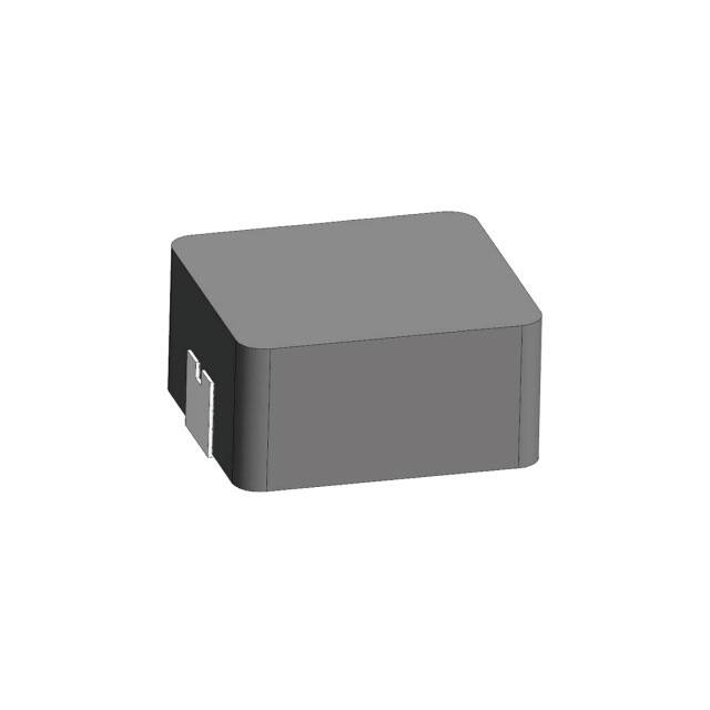

AMPLA5030Q-R47MT
AMPLA5030Q-R47MT
    ABRACON(阿布雷肯)
    SMD,5.7x5.2mm
    固定电感器 ±20% 12A 470nH 5.70 x 5.20mm 非标准
AMPLA5030Q-R47MT 数据手册
AMPLA5030Q AUTOMOTIVE MOLDED INDUCTOR INDUCTANCE (uH) TOLERANCE (%) IRMS (A) ISAT (A) 0.15 0.20 0.25 0.33 0.47 0.56 0.68 0.82 1.0 1.2 1.5 2.2 3.3 4.7 5.6 6.8 10.0 15.0 22.0 30 30 20 20 20 20 20 20 20 20 20 20 20 20 20 20 20 20 20 18.0 16.0 15.0 14.0 12.0 10.0 8.5 8.0 7.0 6.5 6.0 5.5 5.0 4.6 4.25 4.0 2.75 2.1 1.9 30.0 25.0 20.0 18.0 16.0 15.0 14.0 12.5 11.0 11.0 10.0 9.0 8.0 6.0 4.5 4.3 3.5 2.6 1.7 AMPLA5030Q-R15NT AMPLA5030Q-R20NT AMPLA5030Q-R25MT AMPLA5030Q-R33MT AMPLA5030Q-R47MT AMPLA5030Q-R56MT AMPLA5030Q-R68MT AMPLA5030Q-R82MT AMPLA5030Q-1R0MT AMPLA5030Q-1R2MT AMPLA5030Q-1R5MT AMPLA5030Q-2R2MT AMPLA5030Q-3R3MT AMPLA5030Q-4R7MT AMPLA5030Q-5R6MT AMPLA5030Q-6R8MT AMPLA5030Q-100MT AMPLA5030Q-150MT AMPLA5030Q-220MT Check Inventory AEC-Q200 Qualified Shielded construction Soft saturation High current density Designed for switching frequencies between 100KHz-2MHz ELECTRICAL SPECIFICATIONS @ 25°C PART NUMBER* LLC Request Samples FEATURES • • • • • ™ DC RESISTANCE (mΩ) TYP MAX 2.3 2.6 3.7 4.3 6.4 8.0 10.0 11.5 13 14 16 25 32 50 55 68 110 165 220 2.7 3.2 4.1 5.0 7.4 10 12 13 14 16 25 35 38 53 63 76.2 128 190 250 AEC-Q200 QUALIFIED ISO 9001:2015 CERTIFIED Pb ROHS COMPLIANT GENERAL SPECIFICATIONS TYPE Lead Frame Lead Frame Lead Frame Lead Frame Lead Frame Lead Frame Lead Frame Lead Frame Lead Frame Lead Frame Lead Frame Lead Frame Lead Frame Lead Frame Lead Frame Lead Frame Lead Frame Lead Frame Lead Frame * Please refer to Part Identification section Operating Temperature: -55°C to +125°C with (40°C rise) Irms current. Maximum Part Temperature: +125°C Components Storage Temperature: -55°C to +125°C Tape and Reel Packaging Temperature: -55°C to +80°C MSL: Level 1 Not recommended for D.I. water wash MATERIALS Core: Wire: Terminal: Ink: Paint: Carbonyl Powder Copper Tin Plating Black Gray PRODUCT DIMENSIONS Test Conditions Inductance: 100 kHz, 1 V, 0 Adc Humidity Range: 85 ± 2% RH Temperature Rise Current: Current measured at ∆ T of 40°C Saturation Current: Current measured at ∆ L of 30% 1.1 ± 0.3 5.2 ± 0.2 1.5 ± 0.2 5.7 ± 0.3 Top View AMPLA5030Q 1R0 M Series Inductance* Tol. 1. Tolerance: M = 20% N = 30% T 1 Packaging Bottom View 2.8 ± 0.20 PART BUILDER Front View 2 2. Packaging: B = Bulk T = Tape and Reel (2,000pcs/reel) Side View RECOMMENDED LANDING PATTERN 6.5 1.8 *Refer to Electrical Specification table 2.5 Dimensions: mm ™ LLC Revised 12/26/19 AMPLA5030Q AUTOMOTIVE MOLDED INDUCTOR ™ LLC RECOMMENDED REFLOW PROFILE 3 Tp Tp Critical Zone TL to Tp Ramp Up Temperature TL TSMAX TL TSMIN Ramp Down Preheat 1 2 25 t 25˚C to Peak Time ZONE DESCRIPTION 1 Preheat 2 Reflow 3 Peak Heat TEMPERATURE Tsmin ~ Tsmax 150°C ~ 200°C TL 217°C TP 260°C TIMES 60 ~ 180 sec. 60 ~ 150 sec. 10 sec. MAX ™ LLC Revised 12/26/19 AMPLA5030Q AUTOMOTIVE MOLDED INDUCTOR ™ LLC PACKAGING Tape and Reel: 2,000 Units per Carton: 16,000 T&R per Carton: 8 Weight per Carton: 12.5 kg Weight per Unit: 0.46 g Carton Dimensions: 410 x 325 x 415 mm TYPE A B C D 13” x 12 mm 12.4 +2/-0 100.0 ± 2.0 13.0 +0.5/-0.2 330.0 B0 6.2 ± 0.1 A0 5.5 ± 0.1 K0 3.3 ± 0.1 P W F T D 8.0 ± 0.1 12.0 ± 0.3 5.5 ± 0.1 0.35 ± 0.05 1.5 ± 0.1 Dimensions: mm This product is commercial off-the-shelf (COTS) and not specifically designed for automotive, military, aviation, aerospace, implantable, life-dependent medical or safety applications. This product is not recommended for use in any application requiring high reliability in which component failure could result in loss of life and/or property damage without prior written approval from Abracon. Specifications are subject to change without notice. Contact Abracon for more information. ™ LLC Headquarters: 5101 Hidden Creek Ln Spicewood TX 78669 Phone: 512-371-6159 | Fax: 512-351-8858 Revised 12/26/19
