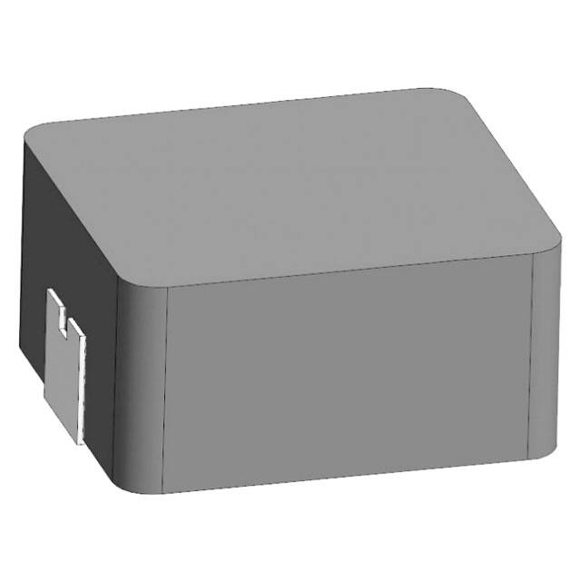

    固定电感器 Nonstandard 150nH ±30% 18A 2.7mΩ
AMPLA5030S-R15NT 数据手册
AMPLA5030S MOLDED INDUCTOR LLC FEATURES • • • • ELECTRICAL SPECIFICATIONS @ 25°C INDUCTANCE (uH) TOLERANCE (%) IRMS (A) ISAT (A) 0.15 0.20 0.25 0.33 0.47 0.56 0.68 0.82 1.0 1.2 1.5 2.2 3.3 4.7 5.6 6.8 10.0 15.0 22.0 30 30 20 20 20 20 20 20 20 20 20 20 20 20 20 20 20 20 20 18.0 16.0 15.0 14.0 12.0 10.0 8.5 8.0 7.0 6.5 6.0 5.5 5.0 4.6 4.25 4.0 2.75 2.1 1.9 30.0 25.0 20.0 18.0 16.0 15.0 14.0 12.5 11.0 11.0 10.0 9.0 8.0 6.0 4.5 4.3 3.5 2.6 1.7 AMPLA5030S-R15NT AMPLA5030S-R20NT AMPLA5030S-R25MT AMPLA5030S-R33MT AMPLA5030S-R47MT AMPLA5030S-R56MT AMPLA5030S-R68MT AMPLA5030S-R82MT AMPLA5030S-1R0MT AMPLA5030S-1R2MT AMPLA5030S-1R5MT AMPLA5030S-2R2MT AMPLA5030S-3R3MT AMPLA5030S-4R7MT AMPLA5030S-5R6MT AMPLA5030S-6R8MT AMPLA5030S-100MT AMPLA5030S-150MT AMPLA5030S-220MT Pb Shielded construction Soft saturation High current density Designed for switching frequencies between 100KHz-2MHz Automotive option available upon request • PART NUMBER* Check Inventory Request Samples DC RESISTANCE (mΩ) TYP MAX 2.3 2.6 3.7 4.3 6.4 8.0 10.0 11.5 13 14 16 25 32 50 55 68 110 165 220 2.7 3.2 4.1 5.0 7.4 10 12 13 14 16 25 35 38 53 63 76.2 128 190 250 ROHS COMPLIANT ISO 9001:2015 CERTIFIED GENERAL SPECIFICATIONS TYPE Lead Frame Lead Frame Lead Frame Lead Frame Lead Frame Lead Frame Lead Frame Lead Frame Lead Frame Lead Frame Lead Frame Lead Frame Lead Frame Lead Frame Lead Frame Lead Frame Lead Frame Lead Frame Lead Frame Operating Temperature: -55°C to +125°C with (40°C rise) Irms current. Maximum Part Temperature: +125°C Components Storage Temperature: -55°C to +125°C Tape and Reel Packaging Temperature: -55°C to +80°C MSL: Level 1 MATERIALS Core: Wire: Terminal: Ink: Paint: Carbonyl Powder Copper Tin Plating Black Gray * Please refer to Part Identification section PRODUCT DIMENSIONS Test Conditions Inductance: 100 kHz, 1 V, 0 Adc Humidity Range: 85 ± 2% RH Temperature Rise Current: Current measured at ∆ T of 40°C Saturation Current: Current measured at ∆ L of 30% 1.1 ± 0.3 5.2 ± 0.2 1.5 ± 0.2 5.7 ± 0.3 Top View AMPLA5030S 1R0 M Series Inductance* Tol. 1. Tolerance: M = 20% N = 30% T 1 Packaging Bottom View 2.8 ± 0.20 PART BUILDER Front View 2 2. Packaging: B = Bulk T = Tape and Reel (2,000pcs/reel) Side View RECOMMENDED LANDING PATTERN 6.5 1.8 *Refer to Electrical Specification table 2.5 Dimensions: mm LLC Revised 09/23/19 AMPLA5030S MOLDED INDUCTOR LLC RECOMMENDED REFLOW PROFILE 3 Tp Tp Critical Zone TL to Tp Ramp Up Temperature TL TSMAX TL TSMIN Ramp Down Preheat 1 2 25 t 25˚C to Peak Time ZONE DESCRIPTION 1 Preheat 2 Reflow 3 Peak Heat LLC TEMPERATURE Tsmin ~ Tsmax 150°C ~ 200°C TL 217°C TP 260°C TIMES 60 ~ 180 sec. 60 ~ 150 sec. 10 sec. MAX Revised 09/23/19 AMPLA5030S MOLDED INDUCTOR LLC PACKAGING Tape and Reel: 2,000 Units per Carton: 16,000 T&R per Carton: 8 Weight per Carton: 12.5 kg Weight per Unit: 0.46 g Carton Dimensions: 410 x 325 x 415 mm TYPE A B C D 13” x 12 mm 12.4 +2/-0 100.0 ± 2.0 13.0 +0.5/-0.2 330.0 B0 6.2 ± 0.1 A0 5.5 ± 0.1 K0 3.3 ± 0.1 P W F T D 8.0 ± 0.1 12.0 ± 0.3 5.5 ± 0.1 0.35 ± 0.05 1.5 ± 0.1 Dimensions: mm This product is commercial off-the-shelf (COTS) and not specifically designed for automotive, military, aviation, aerospace, implantable, life-dependent medical or safety applications. This product is not recommended for use in any application requiring high reliability in which component failure could result in loss of life and/or property damage without prior written approval from Abracon. Specifications are subject to change without notice. Contact Abracon for more information. LLC Headquarters: 5101 Hidden Creek Ln Spicewood TX 78669 Phone: 512-371-6159 | Fax: 512-351-8858 Revised 09/23/19
