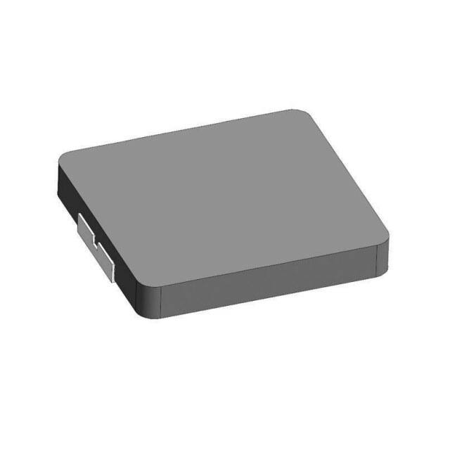

    固定电感器 Nonstandard 3.3µH ±20% 3.2A 103mΩ
AMPLA7012Q-3R3MT 数据手册
AMPLA7012Q MOLDED INDUCTOR ™ LLC FEATURES • • • • • AEC-Q200 Qualified Shielded construction Soft saturation Low DCR per cubic mm Designed for switching frequencies between 100KHz-2MHz ELECTRICAL SPECIFICATIONS @ 25°C PART NUMBER* INDUCTANCE (uH) TOLERANCE (%) IRMS (A) ISAT (A) 0.10 0.22 0.33 0.47 0.68 1.0 1.2 1.5 2.2 3.3 4.7 6.8 10.0 30 30 20 20 20 20 20 20 20 20 20 20 20 16.0 11.0 9.5 8.5 7.0 6.0 5.0 4.5 4.0 3.2 2.5 2.1 1.8 30 19 16 12 9.0 7.0 6.8 6.5 5.0 4.0 3.8 3.0 2.5 AMPLA7012Q-R10NT AMPLA7012Q-R22NT AMPLA7012Q-R33MT AMPLA7012Q-R47MT AMPLA7012Q-R68MT AMPLA7012Q-1R0MT AMPLA7012Q-1R2MT AMPLA7012Q-1R5MT AMPLA7012Q-2R2MT AMPLA7012Q-3R3MT AMPLA7012Q-4R7MT AMPLA7012Q-6R8MT AMPLA7012Q-100MT Check Inventory Request Samples DC RESISTANCE (mΩ) TYP MAX 3.3 6.5 9.0 13 17 27 31 35 53 90 130 172 280 4.0 7.5 10 17 19 30 36 40 61 103 150 198 290 AEC-Q200 QUALIFIED ISO 9001:2015 CERTIFIED Pb ROHS COMPLIANT GENERAL SPECIFICATIONS TYPE Lead Frame Lead Frame Lead Frame Lead Frame Lead Frame Lead Frame Lead Frame Lead Frame Lead Frame Lead Frame Lead Frame Lead Frame Lead Frame * Please refer to Part Identification section Test Conditions Inductance: 100 KHz, 1 V, 0 Adc Humidity Range: 85 ± 2% RH Temperature Rise Current: Current measured at ∆ T of 40°C Saturation Current: Current measured at ∆ L of 30% Operating Temperature: -55°C to +125°C with (40°C rise) Irms current. Maximum Part Temperature: +125°C Components Storage Temperature: -55°C to +125°C Tape and Reel Packaging Temperature: -55°C to +80°C MSL: Level 1 MATERIALS Core: Wire: Terminal: Ink: Paint: Carbonyl Powder Copper Tin Plating Black Gray 1R0 M T Series Inductance* Tol. 1 Packaging 2 1. Tolerance: M = 20% N = 30% 2. Packaging: B = Bulk T = Tape and Reel (3,000pcs/reel) *Refer to Electrical Specification table 1.8 ± 0.3 Top View Bottom View 1.0 ± 0.2 AMPLA7012Q 7.0 ± 0.3 6.6 ± 0.3 PART BUILDER Front View Side View RECOMMENDED LANDING PATTERN 3.0 7.7 2.5 Dimensions: mm ™ LLC Revised 04/17/20 2.5 ± 0.3 PRODUCT DIMENSIONS AMPLA7012Q MOLDED INDUCTOR ™ LLC RECOMMENDED REFLOW PROFILE 3 Tp Tp Critical Zone TL to Tp Ramp Up Temperature TL TSMAX TL TSMIN Ramp Down Preheat 1 2 25 t 25˚C to Peak Time ZONE DESCRIPTION 1 Preheat 2 Reflow 3 Peak Heat TEMPERATURE Tsmin ~ Tsmax 150°C ~ 200°C TL 217°C TP 260°C TIMES 60 ~ 180 sec. 60 ~ 150 sec. 10 sec. MAX ™ LLC Revised 04/17/20 AMPLA7012Q MOLDED INDUCTOR ™ LLC PACKAGING Tape and Reel: 3,000 Units per Carton: 24,000 T&R per Carton: 8 Weight per Carton: 12.9 kg Weight per Unit: 0.26 g Carton Dimensions: 410 x 325 x 415 mm TYPE A B C D 13” x 16 mm 16.4 +2/-0 100.0 ± 2.0 13.0 +0.5/-0.2 330.0 B0 7.7 ± 0.1 A0 7.0 ± 0.1 K0 1.5 ± 0.1 P W F T D 12.0 ± 0.1 16.0 ± 0.3 7.5 ± 0.1 0.35 ± 0.05 1.5 ± 0.1 Dimensions: mm This product is commercial off-the-shelf (COTS) and not specifically designed for automotive, military, aviation, aerospace, implantable, life-dependent medical or safety applications. This product is not recommended for use in any application requiring high reliability in which component failure could result in loss of life and/or property damage without prior written approval from Abracon. Specifications are subject to change without notice. Contact Abracon for more information. ™ LLC Headquarters: 5101 Hidden Creek Ln Spicewood TX 78669 Phone: 512-371-6159 | Fax: 512-351-8858 Revised 04/17/20
