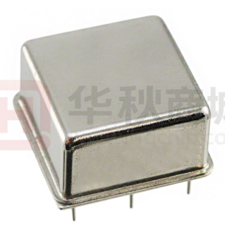

OVEN CONTROLLED CRYSTAL OSCILLATOR AOCJY2 Series ESD Sensitive Pb RoHS / RoHS II Compliant FEATURES: 21.0 x 21.0 x 11.0 mm APPLICATIONS: • Cellular Infrastructure • Radar Systems • Test & Measurement Equipment • GPS Tracking with precision hold-over accuracy • WiMax / WLAN • 21.0 x 21.0 x 11.0 mm Leaded- RoHS Compliant Reflow-able Package • SC-Cut, High “Q” resonator based design • Either Sinewave or CMOS RF output • Available with ±30 ppb over -40°C to +75°C operating temperature range • Tighter Stabilities to ±5.0 ppb over 0°C to +50°C also available • Exceptional long-term Aging of ±500 ppb max. over 10-Year Product Life • Excellent close-in phase noise (-140 dBc/Hz Max. @100Hz offset; 10MHz carrier) STANDARD SPECIFICATIONS: Parameters Minimum Typical Maximum Units 100.00 MHz Notes Notes RF Output Frequency 10.00 Standard Available Frequencies 10.00, 12.80, 13.00, 26.00, 38.88, 40.00, 100.00 MHz Waveform Level "1" (Logic High) Level "0" (Logic Low) Load Rise & Fall Time Duty Cycle Waveform Peak Power Output Load Short Term Stability Operable Temperature Range Overall Frequency range CMOS 0.9*Vdd 0.1*Vdd 15 6.0 55 45 Volts Volts pf ns % Sinewave 2.00 dBm Ω /second 50 -10 2x10 -40 Alan Variance See Stability Options 75 ºC 0º C to +50ºC (Note #1) ±5.00 ppb Default Spec. -20º C to +70ºC ±10.00 ppb Option “E” ±30.00 ppb Option “F” ±5.00 ppb ±5.00 ppb ±100.00 3.00 1.00 3.46 ppb Watts Watts Volts Frequency Stability Options -40º C to +75ºC Frequency Stability vs. Supply Voltage (Vdd ± 5%) Frequency Stability vs. Load Variation (± 10%) Warm-Up @ 25 ºC Power Consumption @ turn on Power Consumption Steady State Supply Voltage (Vdd) Note #1: ABRACON IS IS ABRACON ISO9001:2008 CERTIFIED RTIFIED CE 3.13 3.30 In < 3-minutes See Options ±5.00 ppb stability is only available for F0 < 40MHz. For frequencies above 40MHz, the best available frequency stability is ±10.00 ppb over -20°C to +70°C Visit www.abracon.com for Terms & Conditions of Sale Revised: 08.12.14 30332 Esperanza, Rancho Santa Margarita, California 92688 tel 949-546-8000 | fax 949-546-8001 | www.abracon.com OVEN CONTROLLED CRYSTAL OSCILLATOR AOCJY2 Series ESD Sensitive Pb RoHS / RoHS II Compliant 21.0 x 21.0 x 11.0 mm STANDARD SPECIFICATIONS - continued. Parameters Minimum Typical Maximum Units Notes Aging Daily First Year 10-Years Spectral Content Spurious Response Phase Noise (10MHz Carrier) @ 5V @ 1 Hz offset @ 10 Hz offset @ 100 Hz offset @ 1,000 Hz offset @ 10,000 Hz offset Electrical Frequency Adjustment Control Voltage Range (Vc) Frequency Pull Range Frequency Pull Slope 0.0 ±0.70 ppb ppb ppb -35 dBc -90 -120 -140 -145 -150 dBc dBc dBc dBc dBc Vdd Volts ppm Positive Control Voltage Port Impedance Center Control Voltage ±1.0 ±100 ±500 10 kΩ (Vdd/2) -0.5 Vdd/2 (Vdd/2) +0.5 Volts 2.70 4.40 -40 2.80 4.50 2.90 4.60 +100 Volts Volts ºC Reference Voltage (Vdd=3.3V) Reference Voltage (Vdd=5.0V) Storage Temperature Control Voltage Port Impedance Center Control Voltage Output @ Pin#5 Output @ Pin#5 OPTIONS AND PART IDENTIFICATION (Left blank if standard) AOCJY2 - - MHz - - Supply Voltage Option Blank : 3.30V A : 5.00V Frequency in MHz Such as; 10.000 MHz 26.000 MHz 100.000 MHz ABRACON IS IS ABRACON ISO9001:2008 CERTIFIED RTIFIED CE RF Output Options Blank : CMOS SW : Sinewave Temperature Options E : -20°C to +70°C F : -40°C to +75°C Visit www.abracon.com for Terms & Conditions of Sale Revised: 08.12.14 30332 Esperanza, Rancho Santa Margarita, California 92688 tel 949-546-8000 | fax 949-546-8001 | www.abracon.com OVEN CONTROLLED CRYSTAL OSCILLATOR AOCJY2 Series ESD Sensitive Pb RoHS / RoHS II Compliant 21.0 x 21.0 x 11.0 mm OUTLINE DIMENSIONS PACKAGING: (20) units per tray REFLOW PROFILE: TS ma x to TL (Ramp-up Ra te) 3°C/se cond ma x. Prehe at Temperature Min. (TS Min.) 150°C Temperature Typica l (T S Typ.) 175°C Temperature Max. (TS Ma x.) 200°C Time (tS ) 60 ~ 180 s econds Ra mp-up ra te (TL to Tp ) 3°C/se cond ma x. Time Ma inta ine d Above: --Tempera ture (TL)/Time (TL) 217°C/60 ~ 150 s econds Pe ak Temperature (Tp) 250°C max. for 10 s e conds Targe t P ea k Tempe ra ture (Tp Targe t) 250°C +0/-5°C Time within 5°C of actua l pea k (tp) 20 ~ 40 se conds Ra mp-down Rate 6°C/se cond ma x. Tune 25°C to Pe ak Temperature (t) 8 minute s ma x. ATTENTION: Abracon Corporation’s products are COTS – Commercial-Off-The-Shelf products; suitable for Commercial, Industrial and, where designated, Automotive Applications. Abracon’s products are not specifically designed for Military, Aviation, Aerospace, Life-dependant Medical applications or any application requiring high reliability where component failure could result in loss of life and/or property. For applications requiring high reliability and/or presenting an extreme operating environment, written consent and authorization from Abracon Corporation is required. Please contact Abracon Corporation for more information. ABRACON IS IS ABRACON ISO9001:2008 CERTIFIED RTIFIED CE Visit www.abracon.com for Terms & Conditions of Sale Revised: 08.12.14 30332 Esperanza, Rancho Santa Margarita, California 92688 tel 949-546-8000 | fax 949-546-8001 | www.abracon.com
AOCJY2-100.000MHZ-F
物料型号:AOCJY2 Series
器件简介:该系列是烤箱控制晶体振荡器,具有高Q谐振器设计,可提供正弦波或CMOS射频输出。
引脚分配: - 1:电源 - 2:输出 - 3:地 - 4:控制电压 - 5:参考电压/NC
参数特性: - 频率范围:10.00 MHz 至 100.00 MHz - 标准可用频率:10.00, 12.80, 13.00, 26.00, 38.88, 40.00, 100.00 MHz - 短期稳定性:2x10^-10 /second - 工作温度范围:-40°C 至 +75°C - 长期老化:±500 ppb 最大值,10年产品寿命内 - 优异的接近相位噪声:-140 dBc/Hz 最大值 @100Hz偏移; 10MHz载波
功能详解: - 可提供±30 ppb的稳定性在-40°C至+75°C的工作温度范围内 - 可选择±5.0 ppb的稳定性在0°C至+50°C - 优秀的长期老化特性:±500 ppb最大值,10年产品寿命内 - 可调频率,控制电压范围0.0至Vdd
应用信息: - 适用于蜂窝基础设施、雷达系统、测试和测量设备、GPS跟踪、WiMax/WLAN等应用
封装信息:21.0 x 21.0 x 11.0 mm,符合RoHS/RoHS II标准的有铅回流封装。
