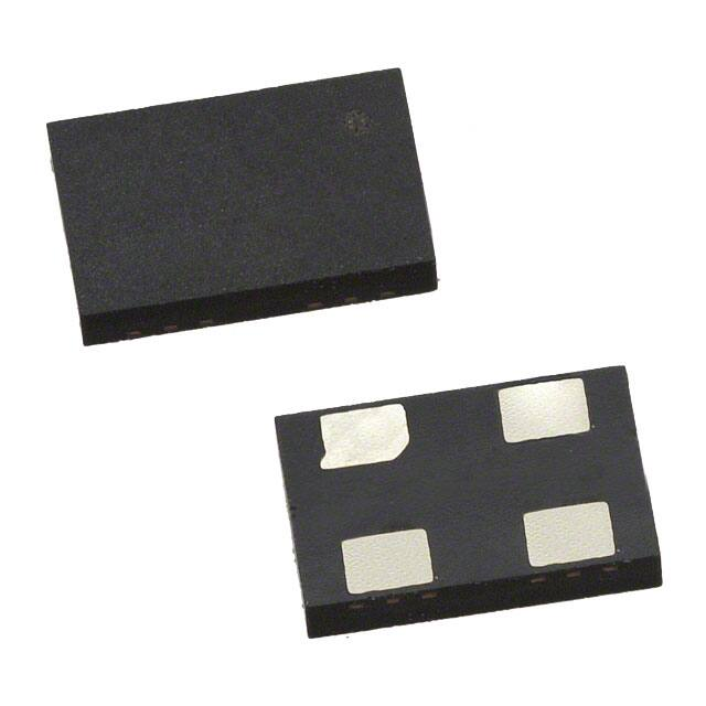

MEMS CLOCK OSCILLATOR ASFLM ASFLM Pb RoHS/RoHS II Compliant FEATURES: • Low Power Consumption • Low Stand by Current • Exceptional Stability Over Temp. at -40°C to +85°C • Available over Extended Temp Range • Low Cost-Compact QFN Plastic Packaging • Compact Package design Life Siz e 5.0 x 3.2 x 0.8 5 mm APPLICATIONS: • CCD Clock for VTR Camera • Equipment Connected to PCs • Low Profile Equipment • Lower Cost Crystal Oscillator Replacement • Computers and Peripherals • Portable Electronics (MP3 Players, Games) • Consumer Electronics such as TV’s, DVR’s, etc. • Vibrant, Shock-Prone & Humid Environments for Industrial Equipment • Demanding Military & Automotive Electronics STANDARD SPECIFICATIONS: Parameters Frequency Range: Operating Temperature: Storage Temperature: Supply Voltage (Vdd): Minimum 1.0 0 - 55 Maximum 150 +70 +150 7 ----- 40.0 to 79.9999MHz ----- 8 80.0 to 124.9999MHz ----- 9 15 125.0 to 150MHz ----- 10 15 VOH 0.8*Vdd ----- ----- VOL ----- ----- 0.2*Vdd ----- 1.3 3.0 Output Voltage: Tr Rise Time: Fall Time: Tf Output Load: Symmetry: Startup Time: Disable Time: Disable Stand-by Current: Tri-state Function (Stand-by) : Cycle to cycle jitter: Aging: Units MHz °C °C Notes See options See options 15 15 1.0 to 39.9999MHz Supply Current (no load): Typical ------------+1.8 ~ +3.3 3.0 1.3 15pF max / 10kΩ min. 45 ----55 ----1.5 3.0 ----20 100 15 --------"1" (VIH≥0.75*Vdd) or Open: Oscillation "0" (VIH 1,000pcs) ASFLM Supply Voltage 1: 3.0 ± 0.3V 2: 3.3 ± 0.3V 3: 2.5 ± 0.2V 4: 1.8 ± 0.15V 5: 2.8 ± 0.2V Frequency in MHz e.g. 14.3181 MHz (Maximum 4 digits after decimal) - Operating Temp. Blank: 0°C ~ +70°C E: -20°C ~ +70°C L: -40°C ~ +85°C MHz - - Packaging Overall Freq. Stability Blank*: 72pcs / Tube Blank: ±100ppm T: 1,000pcs / reel R: ±25ppm T3: 3,000pcs / reel C: ±50ppm * For Quick turn-around programmable orders < 1000pcs: Due to the immediate availability of stock and the qty of the order, the parts may be delivered as BULK: Cut Tape, Loose parts in Antistatic Bag or in Tube(s). The MOQ per the series will still apply for Tube packaging. Un-Programmed Orders (Quantity < 1,000pcs) Blank un-programmed oscillators are available for quick turn engineering requirements. Please call ABRACON for more information. ASFLM - BLANK - Operating Temp. Freq. Stability EC: ± 50 ppm / -20°C to +70°C ER: ± 25 ppm / -20°C to +70°C - Packaging Blank: 72pcs / Tube T: 1,000pcs / reel T3: 3,000pcs / reel LC: ± 50 ppm / -40°C to +85°C LR: ± 25 ppm / -40°C to +85°C REVISED: 1.4.2021 5101 Hidden Creek Ln Spicewood TX 78669 Phone: 512-371-6159 | Fax: 512-351-8858 For terms and conditions of sales, please visit: www.abracon.com ABRACON IS ISO9001-2015 CERTIFIED | MEMS CLOCK OSCILLATOR ASFLM ASFLM Pb RoHS/RoHS II Compliant Life Siz e 5.0 x 3.2 x 0.8 5 mm | | | | | | | | | | | | | | OUTLINE DRAWING: AV L (Left blank if standard) Note: Recommend using an approximately 0.01uF bypass capacitor between PIN 2 and 4. Dimensions: mm (Inches) Tape and reel 1,000pcs/reel TAPE & REEL: REFLOW PROFILE: Tape 1: Tape 2: Tube: 72 pcs/tube Unit orientation in tube: Dimensions: mm ATTENTION: Abracon LLC’s products are COTS – Commercial-Off-The-Shelf products; suitable for Commercial, Industrial and, where designated, Automotive Applications. Abracon’s products are not specifically designed for Military, Aviation, Aerospace, Life-dependent Medical applications or any application requiring high reliability where component failure could result in loss of life and/or property. For applications requiring high reliability and/or presenting an extreme operating environment, written consent and authorization from Abracon LLC is required. Please contact Abracon LLC for more information. REVISED: 1.4.2021 5101 Hidden Creek Ln Spicewood TX 78669 Phone: 512-371-6159 | Fax: 512-351-8858 For terms and conditions of sales, please visit: www.abracon.com ABRACON IS ISO9001-2015 CERTIFIED |
ASFLM1-50.000MHZ-C-T
物料型号:ASFLM
器件简介:MEMS CLOCK OSCILLATOR是一种低功耗、高稳定性的时钟振荡器,适用于多种电子设备。
引脚分配: - 1: Standby - 2: GND - 3: Output - 4: VDD
参数特性: - 频率范围:1.0 MHz 至 150 MHz - 工作温度:0℃ 至 +70℃(有扩展温度范围选项) - 存储温度:-55℃ 至 +150℃ - 供电电压:+1.8V 至 +3.3V(有不同选项) - 无负载供电电流:7 mA 至 15 mA(取决于频率和供电电压) - 输出电压:VOH 为 0.8 Vdd,VOL 为 0.2 Vdd - 上升时间/下降时间:1.3 ns 至 3.0 ns - 输出负载:最大15pF,最小10kΩ - 对称性:45% 至 55%(@1/2Vdd) - 启动时间:1.5 ms 至 3.0 ms - 禁用时间:20 ns 至 100 ns - 禁用待机电流:15 μA - 三态功能(待机):"1" (VIH≥0.75 Vdd) 或打开:振荡 "0" (VIH<0.25 Vdd): 高阻态
功能详解: - 具有低功耗、低待机电流、出色的温度稳定性(-40°C 至 +85°C)、低成本、紧凑的QFN塑料封装等特点。 - 适用于便携式电子设备、消费电子产品、工业设备以及要求严格的军事和汽车电子。
应用信息: - 适用于VTR摄像机的CCD时钟、连接到PC的设备、低轮廓设备、便携式电子产品(如MP3播放器、游戏机)、电视、DVR等消费电子产品,以及工业设备和军事汽车电子产品。
封装信息: - 尺寸:5.0 x 3.2 x 0.85 mm - 引脚分配和推荐焊盘图案已提供 - 封装类型包括Tube和Reel,具体数量和尺寸已在文档中说明
