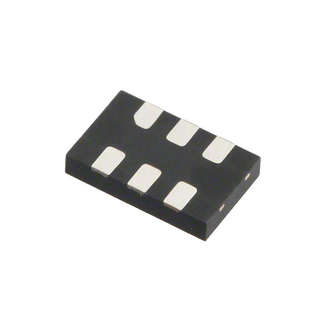

MEMS CLOCK OSCILLATOR ASFLMP ASFLMP Pb Moisture Sensitivity Level- MSL 1 Life S ize 5.0 x 3.2 x 0.85 mm RoHS/RoHS II compliant APPLICATIONS: FEATURES: • Low Power Consumption for high speed communication • Exceptional Stability Over Temp. at -40 to +85°C, ±15ppm • Extended Automotive Grade Temp. stability at -55 to +125°C, ±25ppm • MIL-STD-883 shock and vibration compliant • Durable QFN Plastic Compact Packaging • Standby or Disable Tri-state function • Low jitter (Period jitter RMS and Phase jitter RMS) • Storage Area Networks (SATA, SAS, Fiber Channel) • Passive Optical Networks (EPON, 10G-EPON, GPON, 10G-PON) • Ethernet (1G, 10GBASE-T,/KR/LR/SR, FCoE • PCI Express • Display port • High power supply noise reduction, -50dBc STANDARD SPECIFICATIONS: Key Electrical Specifications – CMOS, LVPECL, LVDS, and HCSL Parameters Frequency Range Minimum Typical Maximum CMOS 2.3000* 170.0000 CMOS 3.3000* 170.0000 LVPECL 2.3000* 460.0000 LVDS 2.3000* 460.0000 HCSL 2.3000* 460.0000 Operating Temperature Storage Temperature Overall Frequency Stability Supply Voltage (Vdd) Startup Time -20 -55 -50 +2.25 Enable Time Disable Time Disable Current Tri-state Function (Standby/Disable) Aging +70 +150 +50 +3.6 5 20 5 5 20 22 0.095 "1" (VIH≥0.75*Vdd) or Open: Oscillation "0" (VIL 1,000pcs) ASFLMP Output Type C: CMOS LP: LVPECL LV: LVDS HC: HCSL Frequency in MHz e.g. 156.2500 MHz (Maximum 4 digits after decimal) - MHz - Operating Temp. Blank: -20°C ~ +70°C L: -40°C ~ +85°C X: -40°C ~ +105°C Z**: -55°C ~ +125°C - Overall Freq. Stability Blank: ±50ppm Y: ±10ppm* R: ±25 ppm - Tri-state (Pin 1) Blank: Tri-state PD: Power Down * Temp option L, X or -20°C ~ +70°C, only ** CMOS output only *** For Quick turn-around programmable orders < 1000pcs: Due to the immediate availability of stock and the qty of the order, the parts may be delivered as BULK: Cut Tape, Loose parts in Antistatic Bag or in Tube(s). The MOQ per the series will still apply for Tube packaging. Packaging Blank***: Tube (72pcs / Tube) T: Tape & Reel (1kpcs / reel) T3: Tape & Reel (3kpcs / reel) Un-Programmed Orders Blank un-programmed oscillators are available for quick turn engineering requirements. Please call ABRACON for more information. ASFLMP Output Type C: CMOS LP: LVPECL LV: LVDS HC: HCSL Operating Temp. Blank: -20°C ~ +70°C L: -40°C ~ +85°C X: -40°C ~ +105°C Z**: -55°C ~ +125°C - BLANK - Overall Freq. Stability Blank: ±50ppm Y: ±10ppm* R: ±25 ppm - - Tri-state (Pin 1) Blank: Tri-state PD: Power Down Packaging Blank: Tube (72pcs / Tube) T: Tape & Reel (1kpcs / reel) T3: Tape & Reel (3kpcs / reel) * Temp option L, X or -20°C ~ +70°C, only ** CMOS output only LLC 5101 Hidden Creek Ln Spicewood TX 78669 Phone: 512-371-6159 | Fax: 512-351-8858 For terms and conditions of sales, please visit: www.abracon.com REVISED: 11.30.2018 ABRACON IS ISO9001-2015 CERTIFIED MEMS CLOCK OSCILLATOR ASFLMP ASFLMP Pb RoHS/RoHS II compliant Life Size 5.0 x 3.2 x 0.85 mm | | | | | | || | | | | | | | NOMINAL PERFORMANCE PARAMETERS (Unless specified otherwise: T=25° C, VDD=3.3 V) CMOS OUTPUT Test Circuit LVPECL output Test Circuit LLC 5101 Hidden Creek Ln Spicewood TX 78669 Phone: 512-371-6159 | Fax: 512-351-8858 For terms and conditions of sales, please visit: www.abracon.com REVISED: 11.30.2018 ABRACON IS ISO9001-2015 CERTIFIED MEMS CLOCK OSCILLATOR ASFLMP ASFLMP Pb RoHS/RoHS II compliant Life Size 5.0 x 3.2 x 0.85 mm | | | | | | | | | | | | | | LVDS output Test Circuit HCSL output Test Circuit LLC 5101 Hidden Creek Ln Spicewood TX 78669 Phone: 512-371-6159 | Fax: 512-351-8858 For terms and conditions of sales, please visit: www.abracon.com REVISED: 11.30.2018 ABRACON IS ISO9001-2015 CERTIFIED MEMS CLOCK OSCILLATOR ASFLMP ASFLMP Pb RoHS/RoHS II compliant Life Size 5.0 x 3.2 x 0.85 mm | | | | | | | | | | | | | | | REFLOW PROFILE: OUTLINE DIMENSIONS: Pin # 1 2 3 4 5 6 Function Tri-state NC GND Output NC (CMOS) Output (LVPECL, LVDS, HCSL) Vdd Note: Recommend using an approximately 0.01uF bypass capacitor between PIN 6 and 3. Recommended Land Pattern for LVPECL, LVDS, HCSL 6 4 1 3 Dimensions: mm (inches) Recommended Land Pattern for CMOS TAPE AND REEL: T= 1,000pcs/reel (D=180mm), T3= 3,000pcs/reel (D=330mm) Tape 1 Tape 2 Tube: 72 pcs/tube Unit orientation in tube: Dimensions: mm ATTENTION: Abracon LLC’s products are COTS – Commercial-Off-The-Shelf products; suitable for Commercial, Industrial and, where designated, Automotive Applications. Abracon’s products are not specifically designed for Military, Aviation, Aerospace, Life-dependent Medical applications or any application requiring high reliability where component failure could result in loss of life and/or property. For applications requiring high reliability and/or presenting an extreme operating environment, written consent and authorization from Abracon LLC is required. Please contact Abracon LLC for more information. LLC 5101 Hidden Creek Ln Spicewood TX 78669 Phone: 512-371-6159 | Fax: 512-351-8858 For terms and conditions of sales, please visit: www.abracon.com REVISED: 11.30.2018 ABRACON IS ISO9001-2015 CERTIFIED
ASFLMPLV-34.000MHZ-LR-T
物料型号:ASFLMP
器件简介:MEMS CLOCK OSCILLATOR是一种小型化、低功耗、高稳定性的时钟振荡器,适用于高速通信、存储区域网络、以太网、PCI Express等多种应用。
引脚分配: - 1:三态控制引脚 - 2:无连接(CMOS) - 3:地(GND) - 4:输出引脚 - 5:无连接(LVPECL, LVDS, HCSL) - 6:供电电压(Vdd)
参数特性: - 工作温度范围:-40至+85°C(商业/工业级),-55至+125°C(扩展汽车级) - 频率范围:CMOS, LVPECL, LVDS, HCSL分别为2.3MHz至170MHz - 电源电压:2.25V至3.6V - 启动时间:5毫秒 - 使能时间:20纳秒(STD三态),5毫秒(PD电源关闭选项) - 关闭时间:5纳秒 - 关闭电流:20至22毫安(STD三态),0.095毫安(PD电源关闭选项) - 老化率:首年±5ppm
功能详解: - 低功耗,适用于高速通信 - 出色的温度稳定性 - 符合MIL-STD-883的冲击和振动标准 - 耐用的QFN塑料紧凑封装 - 待机或禁用的三态功能 - 高电源噪声抑制,-50dBc - 低抖动(周期抖动均方根和相位抖动均方根)
应用信息: - 存储区域网络(如SATA, SAS, Fiber Channel) - 被动光网络(如EPON, 10G-EPON, GPON, 10G-PON) - 以太网(1G, 10GBASE-T, FCoE) - PCI Express - 显示端口
封装信息:5.0 x 3.2 x 0.85 mm,符合RoHS/RoHS II标准,湿度敏感等级为MSL 1。
制造商信息:Abracon LLC,ISO9001-2015认证,位于美国德克萨斯州Spicewood。
