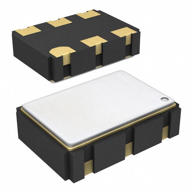

Programmable - High Performance SMD Crystal Oscillator ASG-C Series Pb RoHS Compliant Moisture Sensitivity Level (MSL) - This product is Hermetically Sealed and not Moisture Sensitive; therefore MSL = N/A (Not Applicable) APPLICATIONS: FEATURES: • ASG series is a High Performance crystal based oscillator; available either as an XO or a VCXO • Frequency range from 10MHz to 250MHz with LVCMOS output • Available from 10MHz to 1.50GHz with LVDS or LVPECL output • Offered with either 2.50V or 3.30V bias voltage • Quick turn, 1~5 business days for small quantity orders 7.0 x 5.0 x 2.0mm | | | | | | | | | | | | | | • Networking, SONET/SDH • WiMax / WLAN • Computing • Phase Locked Loops • Direct Digital Synthesis (DDS) • DSL/ADSL • Base Terminal Stations STANDARD SPECIFICATIONS: Parameters Vdd = 3.3V Vdd = 2.5V Frequency Range: Operating Temperature: Storage Temperature: Overall Frequency Stability: Initial Set Tolerance Stability over operating temperature Aging @ 25ºC over 10-years Frequency variation over supply voltage change (±5%) Frequency variation over load variation (15pF ± 5%) Vdd = 3.3V Supply Voltage (Vdd): Vdd = 2.5V Vdd = 3.3V Input Current: Vdd = 2.5V Symmetry: Rise and Fall Time (Tr/Tf): Minimum 10 10 -40 -55 -50 -5.00 -35.00 -7.00 Maximum 250 250 +85 +125 +50 +5.00 +35.00 +7.00 Units MHz MHz °C °C ppm ppm ppm ppm -2.00 +2.00 ppm -1.00 +1.00 ppm 3.465 2.625 45 35 52 1000 15 V V mA mA % ps pF 3.135 2.375 48 Typical < ±1.00 < ±20.00 3.300 2.500 50 < 450 Output Load: VOH Output Voltage: Vcontrol Range Frequency Pull Control Port Bandwidth tjit(ϕ) ] Vdd * 0.10 < 2.0 3.0 "1" (VIH ≥ 0.7*Vdd) or Open: Oscillation "0" (VIL < 0.3*Vdd) : High Z 0.00 Vdd ±50 10 Enable/Disable Function : Integer Mode Fractional Mode See Note # 1 Frequency dependent Frequency dependent @ 1/2Vdd CMOS V VOL Start-up Time: Phase jitter RMS [ See Note #2 Vdd * 0.90 Notes V ms Volts ppm kHz < 0.60 1.60 ps 12kHz to 20MHz < 0.90 1.60 ps 12kHz to 20MHz Note #1: Inclusive of initial tolerance at 25ºC±3ºC, operating temperature range, input voltage variation, load variation & aging. Note #2: The rms jitter over 12kHz to 20MHz Bandwidth is dependent on the carrier and whether or not the final frequency is achieved without engaging the Fractional Mode ABRACON IS ISO9001:2008 CERTIFIED CE RTIFIED Visit www.abracon.com for Terms & Conditions of Sale Revised: 04.27.12 30332 Esperanza, Rancho Santa Margarita, California 92688 tel 949-546-8000 | fax 949-546-8001 | www.abracon.com | Programmable - High Performance SMD Crystal Oscillator ASG-C Series Pb RoHS Compliant 7.0 x 5.0 x 2.0mm | | | | | | | | | | | | | | OVERALL SYSTEM BLOCK DIAGRAM PHASE NOISE & JITTER CHARACTERISTICS 100MHz Carrier ABRACON IS ISO9001:2008 CERTIFIED CE RTIFIED 156.25MHz Carrier Visit www.abracon.com for Terms & Conditions of Sale Revised: 04.27.12 30332 Esperanza, Rancho Santa Margarita, California 92688 tel 949-546-8000 | fax 949-546-8001 | www.abracon.com | Programmable - High Performance SMD Crystal Oscillator ASG-C Series Pb RoHS Compliant 7.0 x 5.0 x 2.0mm | | | | | | | | | | | | | | FREQUENCY STABILITY VS. TEMPERATURE FREQUENCY PULLING VS. CONTROL VOLTAGE (VCXO MODE) PART IDENTIFICATION: ASG - C - Fixed or Pull-able X = Fixed Oscillator V = VCXO - - MHz - Operating Voltage 3.30V = A 2.50V = B Frequency in MHz Please specify the Frequency in MHz e.g. 100.000 MHz Packaging Blank = Bulk T = Tape & Reel MARKING: Top Line: Bottom Line: ASG GYWW WW = Work Week Pin# 1 Identifier Year Code (B=2011, C=2012, etc.) Internal Tracking Code ABRACON IS ISO9001:2008 CERTIFIED CE RTIFIED | Visit www.abracon.com for Terms & Conditions of Sale Revised: 04.27.12 30332 Esperanza, Rancho Santa Margarita, California 92688 tel 949-546-8000 | fax 949-546-8001 | www.abracon.com Programmable - High Performance SMD Crystal Oscillator ASG-C Series Pb RoHS Compliant 7.0 x 5.0 x 2.0mm | | | | | | | | | | | | | | OUTLINE DIMENSIONS: Pin # Pin Description For VCXO configuration 1 2 Voltage Control for VCXO Output Enable (OE) 3 4 5 6 GND RF Output N/C Vdd Pin # Pin Description For XO configuration 1 Output Enable (OE) 2 N/C for XO 3 4 5 6 GND RF Output N/C Vdd REFLOW PROFILE: ABRACON IS ISO9001:2008 CERTIFIED CE RTIFIED Visit www.abracon.com for Terms & Conditions of Sale Revised: 04.27.12 30332 Esperanza, Rancho Santa Margarita, California 92688 tel 949-546-8000 | fax 949-546-8001 | www.abracon.com | Programmable - High Performance SMD Crystal Oscillator ASG-C Series Pb RoHS Compliant 7.0 x 5.0 x 2.0mm | | | | | | | | | | | | | | TAPE & REEL: T= Tape and reel (2,000pcs/reel) ATTENTION: Abracon Corporation’s products are COTS – Commercial-Off-The-Shelf products; suitable for Commercial, Industrial and, where designated, Automotive Applications. Abracon’s products are not specifically designed for Military, Aviation, Aerospace, Life-dependant Medical applications or any application requiring high reliability where component failure could result in loss of life and/or property. For applications requiring high reliability and/or presenting an extreme operating environment, written consent and authorization from Abracon Corporation is required. Please contact Abracon Corporation for more information. ABRACON IS ISO9001:2008 CERTIFIED CE RTIFIED Visit www.abracon.com for Terms & Conditions of Sale Revised: 04.27.12 30332 Esperanza, Rancho Santa Margarita, California 92688 tel 949-546-8000 | fax 949-546-8001 | www.abracon.com |
ASG-C-V-B-50.000MHZ-T
物料型号:ASG-C
器件简介: - ASG系列是一款高性能的晶体振荡器,可用作XO或VCXO。 - 频率范围从10MHz至250MHz,支持LVCMOS输出。 - 10MHz至1.50GHz的频率范围支持LVDS或LVPECL输出。 - 提供2.50V或3.30V的偏置电压选项。 - 快速交付,小批量订单1至5个工作日内发货。
引脚分配: - VCXO配置:1-电压控制,2-输出使能(OE),3-GND,4-RF输出,5-N/C,6-Vdd。 - XO配置:1-输出使能(OE),2-N/C,3-GND,4-RF输出,5-N/C,6-Vdd。
参数特性: - 工作温度范围:-40℃至+85℃。 - 存储温度范围:-55℃至+125℃。 - 整体频率稳定性:-50至+50ppm。 - 初始设置容差:-5.00至+5.00ppm。 - 工作温度范围内的稳定性:-35.00至+35.00ppm。 - 25°C下10年老化:-7.00至+7.00ppm。
功能详解: - 支持网络、SONET/SDH、WiMax/WLAN、计算、相位锁定环、直接数字合成(DDS)、DSL/ADSL、基站终端等应用。 - 提供使能/禁用功能,控制端口带宽为10kHz,频率拉锯为±50ppm。
应用信息: - 适用于商业、工业以及指定的汽车应用。不特别设计用于军事、航空、航天、生命依赖的医疗应用或任何需要高可靠性的应用。
封装信息: - 尺寸为7.0 x 5.0 x 2.0mm,符合RoHS标准。
