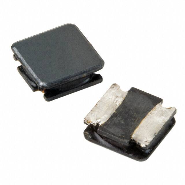

ASPI-0615FS-330M-T2
ASPI-0615FS-330M-T2
    ABRACON(阿布雷肯)
    非标准
    固定电感器 Nonstandard 33µH ±20% 900mA 310mΩ
ASPI-0615FS-330M-T2 数据手册
LOW PROFILE SHIELDED SMD CHIP POWER INDUCTOR ASPI-0615FS Pb RoHS/RoHS II Compliant 6.0 x 6.0 x 2.0mm APPLICATIONS: FEATURES: ELECTRICAL SPECIFICATIONS: : Part Number ASPI-0615FSInductance Code Units Symbol ASPI-0615FS-R50 ASPI-0615FS-R80 ASPI-0615FS-1R5 ASPI-0615FS-2R2 ASPI-0615FS-3R3 ASPI-0615FS-4R7 ASPI-0615FS-5R6 ASPI-0615FS-6R8 ASPI-0615FS-100 ASPI-0615FS-150 ASPI-0615FS-220 ASPI-0615FS-330 ASPI-0615FS-470 ASPI-0615FS Series -40 C to +125 C (Incl -40 C to +125 C ing self generated heat) Inductance Inductance Tolerance DCR H L 0.5 0.8 1.5 2.2 3.3 4.7 5.6 6.8 10 15 22 33 47 % M, N N N N N M, N M, N M, N M, N M, N M, N M, N M, N M, N m DCR 9 12 17 24 30 43 55 60 90 120 170 310 370 DCR Tolerance Saturation Current Temperature Rise Current % A Isat 7.00 6.00 4.00 3.50 2.80 2.40 2.20 2.00 1.90 1.30 1.10 0.90 0.80 A Irms 5.20 4.10 3.60 2.90 2.80 2.20 2.00 1.80 1.50 1.20 1.00 0.90 0.80 ±30% ±20% Test Conditions 1. Ind ctance is mea red in P-4285A Precision CR Meter. 2. R C is mea red in U-5011 milli ohm meter.(or e i alent). 3. Isat : Based on i ctance change ( o : -30%) 4. Irms : Based on temperat re rise ( T : 40oC TYP. ) 5. Test Fre : 100K z, 1Vrms OPTIONS AND PART IDENTIFICATION ASPI-0615FS- Inductance Code Please refer to Electrical Specification Table - Tolerance Code N: ±30% M: ±20%* LLC Packaging T2: Tape and Reel (2 cs reel) 5101 Hidden Creek Ln Spicewood TX 78669 Phone: 512-371-6159 | Fax: 512-351-8858 For terms and conditions of sales, please visit: www.abracon.com *M for = 3.3 ~ 47µ onl ABRACON IS REVISED: 11-26-19 ISO9001-2015 CERTIFIED LOW PROFILE SHIELDED SMD CHIP POWER INDUCTOR ASPI-0615FS Pb RoHS/RoHS II Compliant 6.0 x 6.0 x 2.0mm OUTLINE DRAWING: A B C D Typ. 6.0±0.2 6.0±0.2 2.0±0.2 1.50 3 1 2 4 Recommended Land Pattern Circuit Schematic No Polarity Dimension: mm Material No 1 2 3 4 Part Name Ferrite core Terminals Coil Adhesive Magnetic Powder LLC Material Ni-Zn Ferrite Ag/Ni/Sn Cu/P180 Grd 1 Silicon Base Resin Ni-Zn Ferrite 5101 Hidden Creek Ln Spicewood TX 78669 Phone: 512-371-6159 | Fax: 512-351-8858 For terms and conditions of sales, please visit: www.abracon.com ABRACON IS REVISED: 11-26-19 ISO9001-2015 CERTIFIED LOW PROFILE SHIELDED SMD CHIP POWER INDUCTOR ASPI-0615FS Pb RoHS/RoHS II Compliant 6.0 x 6.0 x 2.0mm TAPE & REEL: T2: 2,000pcs / reel Ao 6.35 Bo 6.20 Ko 2.40 W 16.00 P 12.00 T 0.40 A 330 B 21.0±0.8 C 13.5±0.5 G 16.6 N 99.5 T 21 Dimension: mm LLC 5101 Hidden Creek Ln Spicewood TX 78669 Phone: 512-371-6159 | Fax: 512-351-8858 For terms and conditions of sales, please visit: www.abracon.com ABRACON IS REVISED: 11-26-19 ISO9001-2015 CERTIFIED LOW PROFILE SHIELDED SMD CHIP POWER INDUCTOR ASPI-0615FS Pb RoHS/RoHS II Compliant 6.0 x 6.0 x 2.0mm REFLOW PROFILE: 3 Tp Tp Critical Zone TL to Tp Ramp Up Temperature TL TSMAX TL TSMIN Ramp Down Preheat 1 25 2 t 25˚C to Peak Time Zone Description 1 Preheat / Soak 2 3 Peak heat Temperature TSMAX 150°C Time 60 ~ 100 sec. TL 200°C 20 sec. MAX TP 260°C 10 sec. MAX Dimension: mm ATTENTION: Abracon Corporation’s products are COTS – Commercial-Off-The-Shelf products; suitable for Commercial, Industrial and, where designated, Automotive Applications. Abracon’s products are not specifically designed for Military, Aviation, Aerospace, Life-dependant Medical applications or any application requiring high reliability where component failure could result in loss of life and/or property. For applications requiring high reliability and/or presenting an extreme operating environment, written consent and authorization from Abracon Corporation is required. Please contact Abracon Corporation for more information. LLC 5101 Hidden Creek Ln Spicewood TX 78669 Phone: 512-371-6159 | Fax: 512-351-8858 For terms and conditions of sales, please visit: www.abracon.com ABRACON IS REVISED: 11-26-19 ISO9001-2015 CERTIFIED
