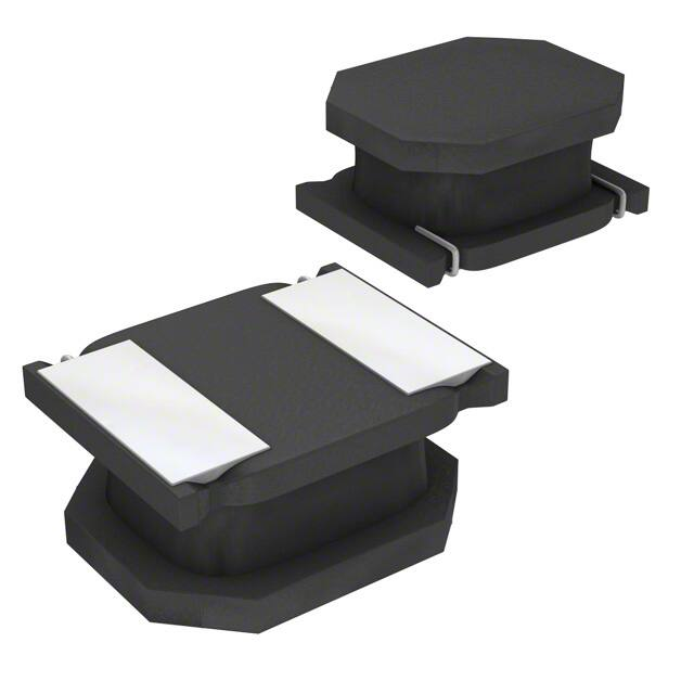

    固定电感器 Nonstandard 1µH ±20% 1.6A 114mΩ
ASPI-2010-1R0M-T 数据手册
Wire Wound Magnetically Shielded SMD Power Inductor ASPI-2010 series Pb ASPI-2010 RoHS/RoHS II Compliant 2.0 x 1.6 x 1.0 mm FEATURES: APPLICATIONS: • • • • • • Mobile phones • MP3 & 4 and other portable communication equipment • Digital cameras. Small size and low profile: 1.0mm Small DCR and high rated current High reliability to mechanical stress Magnetically shielded by magnetic powder molding Suitable for RoHS reflow profile ELECTRICAL SPECIFICATIONS: ASPI-2010 Series -40˚C ~ +125˚C (including self heating) -10˚C ~ +40˚C and 70% R.H. max. Abracon P/N: Operating Temperature & Humidity : Storage Temperature & Humidity: Part Number ASPI-2010Inductance Code Inductance L Tolerance DC Resistance Typ DC Resistance Max Saturation Current Typ Saturation Current Max Temperature Rise Current Typ Temperature Rise Current Max Units μH − Ω Typ Ω Max A Typ A Max A Typ A Max Symbol L M ASPI-2010-R47 0.47 M 0.049 0.059 2.30 2.85 2.35 2.60 ASPI-2010-R68 0.68 M 0.063 0.076 1.95 2.45 2.05 2.25 ASPI-2010-1R0 1.0 M 0.095 0.114 1.65 1.85 1.45 1.60 ASPI-2010-1R5 1.5 M 0.145 0.174 1.35 1.65 1.25 1.40 ASPI-2010-2R2 2.2 M 0.220 0.264 1.20 1.45 1.10 1.20 ASPI-2010-3R3 3.3 M 0.279 0.335 0.90 1.05 0.88 0.98 ASPI-2010-4R7 4.7 M 0.399 0.479 0.70 0.85 0.74 0.82 ASPI-2010-6R8 6.8 M 0.680 0.816 0.60 0.70 0.52 0.58 DCR Isat Irms Test Conditions: a. Ambient Temperature: 20± 15oC b. Relative Humidity: 65%±20% c. Air Pressure: 86KPa to 106KPa Inductance (L): WK3260B LCR meter or equivalent, 1MHz Direct Current Resistance (DCR): HIOKI 3540 or equivalent Saturation Current (Isat): WK3260B LCR meter or equivalent Isat: Based on inductance change (∆ L/Lo ≈ -30%) Temperature rise current (Irms): Electric Power, Electric current meter, Thermometer Irms: Based on temperature rise (∆ T : 40 oC TYP. ) ABRACON IS ISO9001:2008 CE RTIFIED Revised: 02.20.13 Visit www.abracon.com for Terms & Conditions of Sale 30332 E speranza, Rancho Santa Margarita, California 92688 tel 949-546-8000 | fax 949-546-8001| www.abracon.com Wire Wound Magnetically Shielded SMD Power Inductor ASPI-2010 series RoHS/RoHS II Compliant Pb ASPI-2010 2.0 x 1.6 x 1.0 mm ELECTRICAL CHARACTERISTICS CURVES PART IDENTIFICATION: ASPI-2010- - Tolerance M: ±20% Inductance Code Please refer to the table above Packaging T: Tape and Reel (2kpcs / reel) OUTLINE DIMENSION: Recommended Land Pattern A B C Max. D E F a Typ. b Typ. c Typ. 2.0±0.2 1.6±0.2 1.0 1.2±0.2 0.60±0.2 0.80±0.2 0.70 0.70 1.70 Dimensions: mm ABRACON IS ISO9001:2008 CE RTIFIED Revised: 02.20.13 Visit www.abracon.com for Terms & Conditions of Sale 30332 E speranza, Rancho Santa Margarita, California 92688 tel 949-546-8000 | fax 949-546-8001| www.abracon.com Wire Wound Magnetically Shielded SMD Power Inductor ASPI-2010 series Pb ASPI-2010 RoHS/RoHS II Compliant 2.0 x 1.6 x 1.0 mm MATERIAL: No Components Material 1 Ferrite Core 2 Wire 3 Magnetic Glue 4 Plating Electrodes Plating: Ag/Ni/Sn 5 Outer Electrodes Top surface solder coating: Sn96.5%/Ag3%/Cu0.5% Ni-Zn Ferrite Polyurethane System enameled copper wire Epoxy resin and magnetic powder OUTLINE PROFILE: DIMENSION: REFLOW ∆ Preheat condition: 150 ~200˚C /60~120sec. ∆ Allowed time above 217˚C: 60~90sec. ∆ Max temp: 260˚C ∆ Max time at max temp: 5sec. ∆ Solder paste: Sn/3.0Ag/0.5Cu ∆ Allowed Reflow time: 2x max ABRACON IS ISO9001:2008 CE RTIFIED Revised: 02.20.13 Visit www.abracon.com for Terms & Conditions of Sale 30332 E speranza, Rancho Santa Margarita, California 92688 tel 949-546-8000 | fax 949-546-8001| www.abracon.com Wire Wound Magnetically Shielded SMD Power Inductor ASPI-2010 series ASPI-2010 RoHS/RoHS II Compliant Pb 2.0 x 1.6 x 1.0 mm TAPE & REEL: T: 2,000pcs / reel Ao Bo W E F Po P1 1.90±0.05 2.20±0.05 8.0±0.1 1.75±0.1 3.5±0.05 4.0±0.1 4.0±0.1 P2 2.0±0.05 Do T K 1.5+0.1/-0.0 0.25±0.02 1.20±0.05 Storage Conditions a. b. c. d. To maintain the solderability of terminal electrodes and to keep the packing material in good condition, temperature and humidity in the storage area should be controlled. Recommended conditions: -10oC ~ +40 oC, 70% RH (Max.) Even under ideal storage conditions, solderability of products electrodes may decrease as time passes. For this reason, product should be used within one year from the time of delivery. In case of storage over 6 months, solderability shall be checked before actual usage. Dimension: mm ATTENTION: Abracon Corporation’s products are COTS – Commercial-Off-The-Shelf products; suitable for Commercial, Industrial and, where designated, Automotive Applications. Abracon’s products are not specifically designed for Military, Aviation, Aerospace, Life-dependant Medical applications or any application requiring high reliability where component failure could result in loss of life and/or property. For applications requiring high reliability and/or presenting an extreme operating environment, written consent and authorization from Abracon Corporation is required. Please contact Abracon Corporation for more information. ABRACON IS ISO9001:2008 CE RTIFIED Revised: 02.20.13 Visit www.abracon.com for Terms & Conditions of Sale 30332 E speranza, Rancho Santa Margarita, California 92688 tel 949-546-8000 | fax 949-546-8001| www.abracon.com
