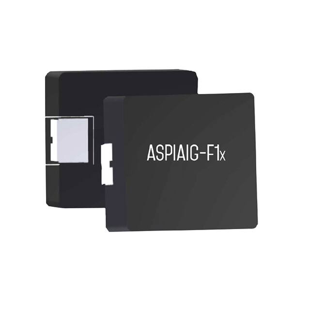

    固定电感器 Nonstandard 190nH ±20% 36A 0.9mΩ
ASPIAIG-F1040-R19N-T 数据手册
AUTOMOTIVE GRADE MOLDED POWER INDUCTOR ASPIAIG-F1x FEATURES APPLICATIONS • • • • • • • • • • • • • • • • • • • • • PPAP ready and supported Molded wire-wound construction with shielding 55 Wide operating temperature range 11.0 x 10.0 x 3.8 mm 13.5 x 12.5 x 6.2 mm MSL = 1 Pb RoHS/RoHS II Compliant Body electronics and comfort system Infotainment and entertainment Electric vehicles Lighting Solar inverters and power Industrial and robotics Medium and high power switch mode power supplies Point of load (POL) applications Motor control and motor drivvers OPTIONS AND PART IDENTIFICATION ASPIAIG - F Series No. 1040 1265 - - Inductance Code Please refer to Electrical Spec table Tolerance M: ±20% N: ±30% Packaging T: Tape and Reel (500 pcs / reel) TEST CONDITIONS Isat: DC current at which the inductance drops 30% from its value without current Irms: MECHANICAL DIMENSIONS SERIES A B C D E SERIES L TYP. ASPIAIG-F1040 ASPIAIG-F1265 11.0 ± 0.5 13.5 ± 0.5 10.0 ± 0.3 12.5 ± 0.3 3.8 ± 0.2 6.2 ± 0.3 2.3 ± 0.3 2.3 ± 0.3 3.0 ± 0.3 4.7 ± 0.3 ASPIAIG-F1040 ASPIAIG-F1265 13.6 14.2 G TYP. H TYP. 5.4 8.0 3.5 5.0 Dimension: mm 5101 Hidden Creek Lane Spicewood TX 78751 Phone: 512-371-6159 | Fax: 512-351-8858 For terms and conditions of sales visit:www.abracon.com REVISED: 08/03/2021 ABRACON IS ISO9001-2015 CERTIFIED AUTOMOTIVE GRADE MOLDED POWER INDUCTOR ASPIAIG-F1x 11.0 x 10.0 x 3.8 mm 13.5 x 12.5 x 6.2 mm MSL = 1 Pb RoHS/RoHS II Compliant ELECTRICAL SPECIFICATIONS Part Number Units Symbol ASPIAIG-F1040-R15 ASPIAIG-F1040-R19 ASPIAIG-F1040-R20 ASPIAIG-F1040-R22 ASPIAIG-F1040-R24 ASPIAIG-F1040-R27 ASPIAIG-F1040-R30 ASPIAIG-F1040-R36 ASPIAIG-F1040-R39 ASPIAIG-F1040-R45 ASPIAIG-F1040-R47 ASPIAIG-F1040-R56 ASPIAIG-F1040-R68 ASPIAIG-F1040-R75 ASPIAIG-F1040-R88 ASPIAIG-F1040-1R0 ASPIAIG-F1040-1R2 ASPIAIG-F1040-1R5 ASPIAIG-F1040-1R8 ASPIAIG-F1040-2R2 ASPIAIG-F1040-2R5 ASPIAIG-F1040-3R0 ASPIAIG-F1040-3R3 ASPIAIG-F1040-3R9 ASPIAIG-F1040-4R0 ASPIAIG-F1040-4R7 ASPIAIG-F1040-5R6 ASPIAIG-F1040-6R2 ASPIAIG-F1040-6R5 ASPIAIG-F1040-6R8 ASPIAIG-F1040-7R3 ASPIAIG-F1040-8R2 ASPIAIG-F1040-100 ASPIAIG-F1040-150 ASPIAIG-F1040-180 ASPIAIG-F1040-220 ASPIAIG-F1040-270 ASPIAIG-F1040-330 ASPIAIG-F1040-470 ASPIAIG-F1040-680 ASPIAIG-F1040-820 Inductance 0.1MHz/1.0V H L 0.15 0.19 0.20 0.22 0.24 0.27 0.30 0.36 0.39 0.45 0.47 0.56 0.68 0.75 0.88 1.00 1.20 1.50 1.80 2.20 2.50 3.00 3.30 3.90 4.00 4.70 5.60 6.20 6.50 6.80 7.30 8.20 10.0 15.0 18.0 22.0 27.0 33.0 47.0 68.0 82.0 Tolerance % M, N 30% 30% 30% 20% 20% 20% 20% 20% 20% 20% 20% 20% 20% 20% 20% 20% 20% 20% 20% 20% 20% 20% 20% 20% 20% 20% 20% 20% 20% 20% 20% 20% 20% 20% 20% 20% 20% 20% 20% 20% 20% DC Resistance Saturation Current Temperature Rise Current Max Typ A Isat 75 70 70 60 60 60 60 60 60 45 43 40 39 39 38 36 33 33 30 27 23 21 20 19 18 17 14 13.7 13.6 13.5 13 12.5 12 10 9 7 6 5 4.5 3 2.5 Typ A Irms 43 36 35 35 34 33 32 31 30 29 28 25 22 22 20 18 17 16 14 12 11.5 11.5 11 10.5 10.2 10 9 8.7 8.6 8.5 8.3 8 7.5 6.25 5.5 5 4 3.5 3 2 1.5 DCR 0.6 0.9 0.95 1 1 1 1.1 1.2 1.3 1.5 1.5 1.8 2.7 2.7 2.9 3.3 3.8 4.6 6.4 7 8.7 11.5 11.8 14.5 15 15.5 19.3 21.3 22.3 23.3 21.8 22.5 30 45 62 74 100 112 167 240 320 5101 Hidden Creek Lane Spicewood TX 78751 Phone: 512-371-6159 | Fax: 512-351-8858 For terms and conditions of sales visit:www.abracon.com Type Non-Lead Frame Non-Lead Frame Non-Lead Frame Non-Lead Frame Non-Lead Frame Non-Lead Frame Non-Lead Frame Non-Lead Frame Non-Lead Frame Non-Lead Frame Non-Lead Frame Non-Lead Frame Non-Lead Frame Non-Lead Frame Non-Lead Frame Non-Lead Frame Non-Lead Frame Non-Lead Frame Lead Frame Lead Frame Lead Frame Lead Frame Lead Frame Lead Frame Lead Frame Lead Frame Lead Frame Lead Frame Lead Frame Lead Frame Lead Frame Lead Frame Lead Frame Lead Frame Lead Frame Lead Frame Lead Frame Lead Frame Lead Frame Lead Frame Lead Frame REVISED: 08/03/2021 ABRACON IS ISO9001-2015 CERTIFIED AUTOMOTIVE GRADE MOLDED POWER INDUCTOR ASPIAIG-F1x 11.0 x 10.0 x 3.8 mm 13.5 x 12.5 x 6.2 mm MSL = 1 Pb RoHS/RoHS II Compliant ELECTRICAL SPECIFICATIONS Part Number Inductance Tolerance 0.1MHz/1.0V DC Resistance Max Saturation Current Temperature Rise Current Typ Typ A A Type Units H % Symbol L M, N DCR Isat Irms 0.15 20% 0.6 118 55 Non-Lead Frame ASPIAIG-F1265-R22 0.22 20% 0.6 112 53 Non-Lead Frame ASPIAIG-F1265-R30 0.30 20% 0.72 72 48 Non-Lead Frame ASPIAIG-F1265-R33 0.33 20% 0.8 68 46 Non-Lead Frame ASPIAIG-F1265-R36 0.36 20% 0.9 66 45 Non-Lead Frame ASPIAIG-F1265-R40 0.40 20% 1 64 44 Non-Lead Frame ASPIAIG-F1265-R47 0.47 20% 1.2 63 41 Non-Lead Frame ASPIAIG-F1265-R50 0.50 20% 1.25 60 40 Non-Lead Frame ASPIAIG-F1265-R56 0.56 20% 1.2 58 37 Non-Lead Frame ASPIAIG-F1265-R68 0.68 20% 1.5 55 35 Non-Lead Frame ASPIAIG-F1265-R82 0.82 20% 1.9 50 33 Non-Lead Frame ASPIAIG-F1265-1R0 1.00 20% 2.3 48 30 Non-Lead Frame ASPIAIG-F1265-1R2 1.20 47 28 Non-Lead Frame 1.50 20% 20% 2.4 ASPIAIG-F1265-1R5 3 45 27 ASPIAIG-F1265-1R8 1.80 20% 4 40 24 Non-Lead Frame Lead Frame ASPIAIG-F1265-2R2 2.20 20% 4.2 37 22 Lead Frame ASPIAIG-F1265-2R7 2.70 5.5 32 20 ASPIAIG-F1265-3R3 3.30 20% 20% 6.8 30 18 Lead Frame Lead Frame ASPIAIG-F1265-4R7 4.70 20% 8.4 28 13.5 Lead Frame ASPIAIG-F1265-5R6 5.60 20% 10 23 12.5 Lead Frame ASPIAIG-F1265-6R8 6.80 20% 11.5 18 11.5 Lead Frame ASPIAIG-F1265-8R2 8.20 20% 15.5 16 10.5 Lead Frame ASPIAIG-F1265-100 10.0 20% 16.5 15.5 10 Lead Frame ASPIAIG-F1265-130 13.0 20% 24 13 9 Lead Frame ASPIAIG-F1265-150 15.0 20% 28 13 9 Lead Frame ASPIAIG-F1265-220 22.0 20% 37 12 9 Lead Frame ASPIAIG-F1265-330 33.0 20% 58 11 8 Lead Frame ASPIAIG-F1265-470 47.0 20% 90 9.5 6.5 Lead Frame ASPIAIG-F1265-680 68.0 20% 130 7.8 4.8 Lead Frame ASPIAIG-F1265-101 100 20% 165 5.5 4.2 Lead Frame ASPIAIG-F1265-R15 5101 Hidden Creek Lane Spicewood TX 78751 Phone: 512-371-6159 | Fax: 512-351-8858 For terms and conditions of sales visit:www.abracon.com REVISED: 08/03/2021 ABRACON IS ISO9001-2015 CERTIFIED AUTOMOTIVE GRADE MOLDED POWER INDUCTOR ASPIAIG-F1x 11.0 x 10.0 x 3.8 mm 13.5 x 12.5 x 6.2 mm MSL = 1 Pb RoHS/RoHS II Compliant REFLOW Zone Description 1 Preheat Temperature TSMIN SMAX Times TL 2 3 TP Peak heat 10 sec. MAX PACKING (TAPE & REEL: 500 PCS/REEL) A B 100 ± 2 SERIES W F P D ASPIAIG-F1040 ASPIAIG-F1265 24.0±0.3 24.0±0.3 11.5±0.1 11.5±0.1 16.0±0.1 16.0±0.1 1.5±0.1 1.5±0.1 A0 10.4±0.1 12.9±0.1 B0 11.6±0.1 13.0±0.1 T 0.35±0.05 0.35±0.05 5101 Hidden Creek Lane Spicewood TX 78751 Phone: 512-371-6159 | Fax: 512-351-8858 For terms and conditions of sales visit:www.abracon.com C D 330 K0 4.5±0.1 7.0±0.1 REVISED: 08/03/2021 ABRACON IS ISO9001-2015 CERTIFIED
