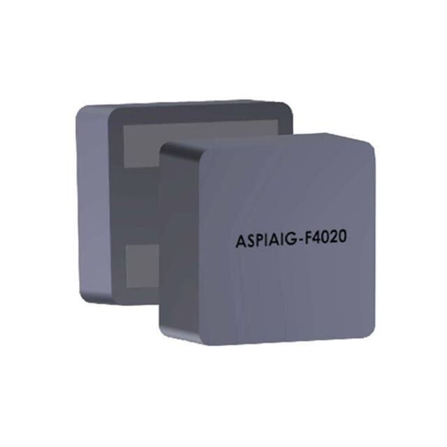

    固定电感器 Nonstandard 720nH ±20% 10.5A 11.6mΩ
ASPIAIG-F4020-R72M-T 数据手册
HIGH CURRENT SHIELDED SMD POWER INDUCTOR AIG ASPIAIG-F SERIES Dimensions vary MSL = 1 Pb RoHS/RoHS II Compliant SERIES DESCRIPTION The ASPIAIG-F series of molded smd power inductors come in a variety of package sizes. The series supports current handling up FEATURES APPLICATIONS • • • • • • • • • • • • • • • • PPAP ready and supported Excellent current handling – up to 36A Soft saturation Shielded construction reduces EMI • • • • • Automotive grade 1 and electric vehicles ADAS and body electronics Infotainment systems Lighting Motor control Solar inverters and solar power DC/DC converters in distributed power systems DC/DC converters for FPGA (Field Programmable Gate Array) Battery powered device Thin type on-board power supply module for exchangers VRM (Voltage Regulator Module) for server converters Graphics card (Buck converters) OPTIONS AND PART IDENTIFICATION - ASPIAIG-F SERIES # 4020 LR4020 5020 5030 6030 6050 7020 7030 INDUCTANCE CODE Please refer to Electrical Spec Table LLC TOLERANCE M: ±20% SERIES # 4020 LR4020 5020 5030 6030 6050 7020 7030 PACKAGING (T = TAPE AND REEL) T: 3k pcs / reel T: 3k pcs / reel T: 3k pcs /reel T: 2k pcs /reel T: 1k pcs /reel T: 800 pcs /reel T: 2k pcs/reel T: 1.5k pcs/reel 1501 Hidden Creek Lane Spicewood TX 78751 Phone: 512-371-6159 | Fax: 512-351-8858 For terms and conditions of sales visit: www.abracon.com REVISED: 05.01.2019 ABRACON IS ISO9001-2015 CERTIFIED HIGH CURRENT SHIELDED SMD POWER INDUCTOR AIG ASPIAIG-F SERIES Dimensions vary MSL = 1 Pb RoHS/RoHS II Compliant ELECTRICAL SPECIFICATIONS OPERATING TEMPERATURE -40°C - 125°C (including self-temperature rise) PART NUMBER UNITS SYMBOL ASPIAIG-F4020-R10 ASPIAIG-F4020-R22 ASPIAIG-F4020-R36 ASPIAIG-F4020-R40 ASPIAIG-F4020-R56 ASPIAIG-F4020-R60 ASPIAIG-F4020-R72 ASPIAIG-F4020-1R0 ASPIAIG-F4020-1R2 ASPIAIG-F4020-1R5 ASPIAIG-F4020-1R8 ASPIAIG-F4020-2R2 ASPIAIG-FLR4020-R47 ASPIAIG-FLR4020-R68 ASPIAIG-FLR4020-R82 ASPIAIG-FLR4020-1R0 ASPIAIG-FLR4020-1R2 ASPIAIG-FLR4020-1R5 ASPIAIG-FLR4020-2R0 ASPIAIG-FLR4020-2R2 ASPIAIG-FLR4020-3R3 ASPIAIG-FLR4020-4R7 ASPIAIG-F5020-R15 ASPIAIG-F5020-R16 ASPIAIG-F5020-R33 ASPIAIG-F5020-R47 ASPIAIG-F5020-R56 ASPIAIG-F5020-R68 ASPIAIG-F5020-R80 ASPIAIG-F5020-R82 ASPIAIG-F5020-1R0 ASPIAIG-F5020-1R2 ASPIAIG-F5020-1R5 INDUCTANCE 0.1MHz/0.1V µH L 0.10 0.22 0.36 0.40 0.56 0.60 0.72 1.00 1.20 1.50 1.80 2.20 0.47 0.68 0.82 1.00 1.20 1.50 2.00 2.20 3.30 4.70 0.15 0.16 0.33 0.47 0.56 0.68 0.80 0.82 1.00 1.20 1.50 TOLERANCE STORAGE CONDITION -10°C - +40°C and R.H. 60%max DC RESISTANCE MAX % M 20% 20% 20% 20% 20% 20% 20% 20% 20% 20% 20% 20% 20% 20% 20% 20% 20% 20% 20% 20% 20% 20% 20% 20% 20% 20% 20% 20% 20% 20% 20% 20% 20% DCR 2.42 4.60 6.30 7.73 9.30 9.52 11.60 14.60 17.90 23.50 28.00 38.70 6.8 8.2 9.5 11.7 13.4 15.8 23.3 23.5 38.3 57.2 4.60 4.60 7.00 8.05 9.54 10.2 11.8 12.7 13.8 16.3 18.7 SATURATION CURRENT MAX A Isat 33.0 18.8 15.0 13.5 12.6 12.3 10.6 8.8 7.8 7.4 7.0 6.0 12.5 10.0 9.0 8.0 7.5 6.7 5.0 4.8 4.4 3.5 27.0 27.0 24.0 20.0 16.0 14.0 13.5 13.0 12.8 12.2 11.7 TEMPERATURE RISE CURRENT MAX A Irms 18.0 16.8 14.5 14.0 12.0 11.7 10.5 9.6 9.0 7.6 7.0 5.6 13.2 12.0 11.5 11.0 9.5 9.1 8.2 8.0 5.5 5.1 18.8 18.8 14.4 14.1 13.9 13.4 13.0 12.0 10.5 9.40 8.80 Test Conditions Isat: Current at which the inductance drops 30% from its value without current Irms: Current that causes the temperature rise (ΔT, approximate 40 ˚C) from 20°C ambient LLC 1501 Hidden Creek Lane Spicewood TX 78751 Phone: 512-371-6159 | Fax: 512-351-8858 For terms and conditions of sales visit: www.abracon.com REVISED: 05.01.2019 ABRACON IS ISO9001-2015 CERTIFIED HIGH CURRENT SHIELDED SMD POWER INDUCTOR AIG ASPIAIG-F SERIES Dimensions vary MSL = 1 Pb RoHS/RoHS II Compliant ELECTRICAL SPECIFICATIONS PART NUMBER UNITS SYMBOL ASPIAIG-F5030-R15 ASPIAIG-F5030-R16 ASPIAIG-F5030-R33 ASPIAIG-F5030-R56 ASPIAIG-F5030-R60 ASPIAIG-F5030-R80 ASPIAIG-F5030-R82 ASPIAIG-F5030-1R0 ASPIAIG-F5030-1R2 ASPIAIG-F5030-1R5 ASPIAIG-F5030-1R8 ASPIAIG-F5030-2R2 ASPIAIG-F5030-3R3 ASPIAIG-F5030-4R7 ASPIAIG-F6050-1R0 ASPIAIG-F6050-1R2 ASPIAIG-F6050-1R5 ASPIAIG-F6050-1R8 ASPIAIG-F6050-2R2 ASPIAIG-F6050-3R3 ASPIAIG-F6050-4R3 ASPIAIG-F6050-4R7 PART NUMBER INDUCTANCE TOLERANCE 0.1MHz/0.1V µH L 0.15 0.16 0.33 0.56 0.60 0.80 0.82 1.00 1.20 1.50 1.80 2.20 3.30 4.70 1.00 1.20 1.50 1.80 2.20 3.30 4.30 4.70 INDUCTANCE MAX % M 20% 20% 20% 20% 20% 20% 20% 20% 20% 20% 20% 20% 20% 20% 20% 20% 20% 20% 20% 20% 20% 20% TOLERANCE 0.1MHz/0.1V UNITS SYMBOL ASPIAIG-F6030-R18 ASPIAIG-F6030-R33 ASPIAIG-F6030-R56 ASPIAIG-F6030-1R0 ASPIAIG-F6030-1R2 ASPIAIG-F6030-1R8 ASPIAIG-F6030-2R2 ASPIAIG-F6030-3R3 ASPIAIG-F6030-4R5 DC RESISTANCE % M 20% 20% 20% 20% 20% 20% 20% 20% 20% L 0.18 0.33 0.56 1.00 1.20 1.80 2.20 3.30 4.50 DCR 2.31 2.33 3.52 4.52 4.52 5.65 5.78 7.60 9.70 11.2 12.7 14.5 23.1 36.3 4.52 5.83 6.3 7.1 8.5 12.5 16.2 18.4 SELF-RESONANT FREQUENCY REF MHz SRF 143 78 70 52 47 33 29 25 20 SATURATION CURRENT MAX A Isat 32.5 32.0 26.0 20.2 20.0 18.0 17.6 14.3 13.5 12.5 11.3 9.0 8.7 7.0 18.0 16.0 14.5 13.5 12.0 10.0 8.5 8.0 DC RESISTANCE MAX DCR 1.75 2.50 3.31 6.05 7.40 10.2 12.2 20.8 25.3 TEMPERATURE RISE CURRENT MAX A Irms 22.2 22.2 19.2 17.7 17.7 13.1 12.9 12.2 11.0 10.5 10.1 9.70 8.10 5.90 20.0 18.0 17.0 16.0 13.0 11.0 9.0 8.5 SATURATION CURRENT MAX A Isat 36.0 28.0 25.0 18.0 16.0 13.0 11.0 9.00 8.00 TEMPERATURE RISE CURRENT MAX A Irms 32.0 25.0 22.0 18.0 16.0 14.0 10.0 8.00 7.00 Test Conditions Isat: Current at which the inductance drops 30% from its value without current Irms: Current that causes the temperature rise (ΔT, approximate 40 ˚C) from 20°C ambient LLC 1501 Hidden Creek Lane Spicewood TX 78751 Phone: 512-371-6159 | Fax: 512-351-8858 For terms and conditions of sales visit: www.abracon.com REVISED: 05.01.2019 ABRACON IS ISO9001-2015 CERTIFIED HIGH CURRENT SHIELDED SMD POWER INDUCTOR AIG ASPIAIG-F SERIES Dimensions vary MSL = 1 Pb RoHS/RoHS II Compliant ELECTRICAL SPECIFICATIONS PART NUMBER INDUCTANCE TOLERANCE 0.1MHz/0.1V UNITS SYMBOL ASPIAIG-F7020-R27 ASPIAIG-F7020-R31 ASPIAIG-F7020-R33 ASPIAIG-F7020-R47 ASPIAIG-F7020-R68 ASPIAIG-F7020-1R0 ASPIAIG-F7030-R60 ASPIAIG-F7030-1R0 ASPIAIG-F7030-1R5 ASPIAIG-F7030-2R2 ASPIAIG-F7030-3R3 ASPIAIG-F7030-4R7 ASPIAIG-F7030-5R6 ASPIAIG-F7030-6R8 ASPIAIG-F7030-8R2 DC RESISTANCE MAX % M 20% 20% 20% 20% 20% 20% 20% 20% 20% 20% 20% 20% 20% 20% 20% L 0.27 0.31 0.33 0.47 0.68 1.00 0.60 1.00 1.50 2.20 3.30 4.70 5.60 6.80 8.20 DCR 3.5 4.8 4.8 6.2 9.2 10.8 3.2 5.0 8.25 13.7 18.0 26.7 33.2 42.5 48.73 SATURATION CURRENT MAX A Isat 32.0 31.0 31.0 25.0 23.0 20.0 32.0 28.0 23.5 17.0 13.0 12.2 11.5 11.0 9.0 TEMPERATURE RISE CURRENT MAX A Irms 21.0 20.0 19.0 17.0 13.0 11.0 23.0 21.8 15.3 13.0 10.0 9.0 7.3 6.8 5.9 D ±0.3 mm 6.6 6.2 6.2 6.2 6.2 6.2 6.6 6.6 6.6 6.2 6.2 6.2 6.2 6.2 6.2 ELECTRICAL CHARACTERISTICS ASPIAIG-F4020-R10 ASPIAIG-F4020-R22 ASPIAIG-F4020-R40 ASPIAIG-F4020-R56 LLC 1501 Hidden Creek Lane Spicewood TX 78751 Phone: 512-371-6159 | Fax: 512-351-8858 For terms and conditions of sales visit: www.abracon.com ASPIAIG-F4020-R36 ASPIAIG-F4020-R60 REVISED: 05.01.2019 ABRACON IS ISO9001-2015 CERTIFIED HIGH CURRENT SHIELDED SMD POWER INDUCTOR AIG ASPIAIG-F SERIES Dimensions vary MSL = 1 Pb RoHS/RoHS II Compliant ELECTRICAL SPECIFICATIONS ASPIAIG-F4020-R72 ASPIAIG-F4020-1R0 ASPIAIG-F4020-1R5 ASPIAIG-F4020-1R8 ASPIAIG-FLR4020-R47 ASPIAIG-FLR4020-R68 ASPIAIG-FLR4020-1R0 ASPIAIG-FLR4020-1R2 LLC 1501 Hidden Creek Lane Spicewood TX 78751 Phone: 512-371-6159 | Fax: 512-351-8858 For terms and conditions of sales visit: www.abracon.com ASPIAIG-F4020-1R2 ASPIAIG-F4020-2R2 ASPIAIG-FLR4020-R82 ASPIAIG-FLR4020-1R5 REVISED: 05.01.2019 ABRACON IS ISO9001-2015 CERTIFIED HIGH CURRENT SHIELDED SMD POWER INDUCTOR AIG ASPIAIG-F SERIES Dimensions vary MSL = 1 Pb RoHS/RoHS II Compliant ELECTRICAL CHARACTERISTICS ASPIAIG-FLR4020-2R0 ASPIAIG-FLR4020-2R2 ASPIAIG-FLR4020-3R3 ASPIAIG-FLR4020-4R7 ASPIAIG-F5020-R15 ASPIAIG-F5020-R16 ASPIAIG-F5020-R47 ASPIAIG-F5020-R47 LLC 1501 Hidden Creek Lane Spicewood TX 78751 Phone: 512-371-6159 | Fax: 512-351-8858 For terms and conditions of sales visit: www.abracon.com ASPIAIG-F5020-R33 ASPIAIG-F5020-R68 REVISED: 05.01.2019 ABRACON IS ISO9001-2015 CERTIFIED HIGH CURRENT SHIELDED SMD POWER INDUCTOR AIG ASPIAIG-F SERIES Dimensions vary MSL = 1 Pb RoHS/RoHS II Compliant ELECTRICAL CHARACTERISTICS ASPIAIG-F5020-R80 ASPIAIG-F5020-R82 ASPIAIG-F5020-1R2 ASPIAIG-F5020-1R0 ASPIAIG-F5020-1R5 ASPIAIG-F5030-R15 ASPIAIG-F5030-R16 ASPIAIG-F5030-R56 ASPIAIG-F5030-R60 LLC 1501 Hidden Creek Lane Spicewood TX 78751 Phone: 512-371-6159 | Fax: 512-351-8858 For terms and conditions of sales visit: www.abracon.com ASPIAIG-F5030-R33 ASPIAIG-F5030-R80 REVISED: 05.01.2019 ABRACON IS ISO9001-2015 CERTIFIED HIGH CURRENT SHIELDED SMD POWER INDUCTOR AIG ASPIAIG-F SERIES Dimensions vary MSL = 1 Pb RoHS/RoHS II Compliant ELECTRICAL CHARACTERISTICS ASPIAIG-F5030-R82 ASPIAIG-F5030-1R0 ASPIAIG-F5030-1R5 ASPIAIG-F5030-1R8 ASPIAIG-F5030-3R3 ASPIAIG-F5030-1R2 ASPI-AIGF5030-2R2 ASPIAIG-F5030-4R7 ASPIAIG-F6030-R18 ASPIAIG-F6030-R33 LLC 1501 Hidden Creek Lane Spicewood TX 78751 Phone: 512-371-6159 | Fax: 512-351-8858 For terms and conditions of sales visit: www.abracon.com ASPIAIG-F6030-R56 REVISED: 05.01.2019 ABRACON IS ISO9001-2015 CERTIFIED HIGH CURRENT SHIELDED SMD POWER INDUCTOR AIG ASPIAIG-F SERIES Dimensions vary MSL = 1 Pb RoHS/RoHS II Compliant ELECTRICAL CHARACTERISTICS ASPIAIG-F6030-1R0 ASPIAIG-F6030-1R2 ASPIAIG-F6030-1R8 ASPIAIG-F6030-2R2 ASPIAIG-F6030-3R3 ASPIAIG-F6030-4R5 ASPIAIG-F6050-1R0 ASPIAIG-F6050-1R2 ASPIAIG-F6050-1R5 ASPIAIG-F6050-1R8 ASPIAIG-F6050-2R2 ASPIAIG-F6050-3R3 LLC 1501 Hidden Creek Lane Spicewood TX 78751 Phone: 512-371-6159 | Fax: 512-351-8858 For terms and conditions of sales visit: www.abracon.com REVISED: 05.01.2019 ABRACON IS ISO9001-2015 CERTIFIED HIGH CURRENT SHIELDED SMD POWER INDUCTOR AIG ASPIAIG-F SERIES Dimensions vary MSL = 1 Pb RoHS/RoHS II Compliant ELECTRICAL CHARACTERISTICS ASPIAIG-F6050-4R3 ASPIAIG-F6050-4R7 ASPIAIG-F7020-R27 ASPIAIG-F7020-R31 ASPIAIG-F7020-R33 ASPIAIG-F7020-R47 ASPIAIG-F7020-R68 ASPIAIG-F7020-1R0 ASPIAIG-F7030-R60 ASPIAIG-F7030-1R0 ASPIAIG-F7030-1R5 LLC 1501 Hidden Creek Lane Spicewood TX 78751 Phone: 512-371-6159 | Fax: 512-351-8858 For terms and conditions of sales visit: www.abracon.com REVISED: 05.01.2019 ABRACON IS ISO9001-2015 CERTIFIED HIGH CURRENT SHIELDED SMD POWER INDUCTORAIG ASPIAIG-F SERIES Dimensions vary MSL = 1 Pb RoHS/RoHS II Compliant ELECTRICAL SPECIFICATIONS ASPIAIG-F7030-2R2 ASPIAIG-F7030-3R3 ASPIAIG-F7030-5R6 ASPIAIG-F7030-4R7 ASPIAIG-F7030-6R8 ASPIAIG-F7030-8R2 MECHANICAL DIMENSIONS Dimension: mm SERIES ASPIAIG-F4020 ASPIAIG-FLR4020 ASPIAIG-F5020 ASPIAIG-F5030 ASPIAIG-F6030 ASPIAIG-F6050 ASPIAIG-F7020 A 4.1 ± 0.2 4.1 ± 0.2 5.5 ± 0.2 5.5 ± 0.2 6.6 ± 0.2 6.6 ± 0.2 7.8 ± 0.25 B 4.1 ± 0.2 4.1 ± 0.2 5.3 ± 0.2 5.3 ± 0.2 6.4 ± 0.2 6.4 ± 0.2 7.6 ± 0.2 C 1.9 ± 0.2 1.9 ± 0.2 1.9 ± 0.2 2.9 ± 0.2 2.8 ± 0.2 4.8 ± 0.2 1.85 ± 0.2 D 3.4 ± 0.3 3.4 ± 0.3 4.3 ± 0.3 4.3 ± 0.3 5.3 ± 0.3 5.3 ± 0.3 SEE SPEC TABLE E 0.88 ± 0.2 0.88 ± 0.2 1.1 ± 0.2 1.1 ± 0.2 1.4 ± 0.2 1.4 ± 0.2 1.75 ± 0.2 ASPIAIG-F7030 7.8 ± 0.25 7.6 ± 0.2 2.90 ± 0.2 SEE SPEC TABLE 1.75 ± 0.2 LLC F 1.6 ± 0.25 1.6 ± 0.25 2.3 ± 0.25 2.3 ± 0.25 2.6 ± 0.25 2.6 ± 0.25 3.15 ± 0.25 3.15 ± 0.25 1501 Hidden Creek Lane Spicewood TX 78751 Phone: 512-371-6159 | Fax: 512-351-8858 For terms and conditions of sales visit: www.abracon.com SERIES ASPIAIG-F4020 ASPIAIG-FLR4020 ASPIAIG-F5020 ASPIAIG-F5030 ASPIAIG-F6030 ASPIAIG-F6050 ASPIAIG-F7020 ASPIAIG-F7030 L typ G typ H typ 3.4 1.4 3.8 4.5 2.0 4.7 5.6 2.5 5.6 7.4 2.8 7.2 REVISED: 05.01.2019 ABRACON IS ISO9001-2015 CERTIFIED HIGH CURRENT SHIELDED SMD POWER INDUCTORAIG ASPIAIG-F SERIES Dimensions vary MSL = 1 Pb RoHS/RoHS II Compliant REFLOW Zone Description 1 Preheat Temperature TSMIN ~ TSMAX 150°C ~ 180°C TL 217°C TP 245°C 2 3 Peak heat Times 120 ~ 180 sec. 60 ~ 150 sec. 5 sec. MAX PACKING (TAPE & REEL) SERIES ASPIAIG-F4020 ASPIAIG-FLR4020 ASPIAIG-F5020 ASPIAIG-F5030 ASPIAIG-F6030 ASPIAIG-F6050 ASPIAIG-F7020 ASPIAIG-F7030 W 12.0±0.3 12.0±0.3 12.0±0.3 16.0±0.3 16.0±0.3 16.0±0.3 16.0±0.3 16.0±0.3 F 5.5±0.1 5.5±0.1 7.5±0.1 7.5±0.1 7.5±0.1 7.5±0.1 7.5±0.1 7.5±0.1 P 8.0±0.1 8.0±0.1 8.0±0.1 8.0±0.1 12.0±0.1 12.0±0.1 12.0±0.1 12.0±0.1 D 1.5±0.1 1.5±0.1 1.5±0.1 1.5±0.1 1.5±0.1 1.5±0.1 1.5±0.1 1.5±0.1 A0 4.4±0.1 4.4±0.1 5.7±0.1 5.8±0.1 6.8±0.1 6.8±0.1 8.2±0.1 8.2±0.1 B0 4.4 ±0.1 4.4 ±0.1 6.0 ±0.1 5.6 ±0.1 7.0 ±0.1 7.0 ±0.1 8.0 ±0.1 8.0 ±0.1 T 0.35±0.1 0.35±0.1 0.35±0.05 0.35±0.05 0.35±0.1 0.35±0.1 0.35±0.1 0.35±0.1 SERIES A B ASPIAIG-F4020 ASPIAIG-FLR4020 12.4+2/-0 100 ± 2 ASPIAIG-F5020 ASPIAIG-F5030 ASPIAIG-F6030 ASPIAIG-F6050 16.4+2/-0 100 ± 2 ASPIAIG-F7020 ASPIAIG-F7030 Dimension: mm LLC 1501 Hidden Creek Lane Spicewood TX 78751 Phone: 512-371-6159 | Fax: 512-351-8858 For terms and conditions of sales visit: www.abracon.com K0 2.3±0.1 2.3±0.1 2.3±0.1 3.3±0.1 3.3±0.1 5.3±0.1 2.3±0.1 3.3±0.1 C D 13.0+0.5/-0.2 330 13.0+0.5/-0.2 330 REVISED: 05.01.2019 ABRACON IS ISO9001-2015 CERTIFIED
物料型号:ASPIAIG-F系列,包括不同的型号如ASPIAIG-F4020、ASPIAIG-FLR4020、ASPIAIG-F5020等。
器件简介:ASPIAIG-F系列是高电流屏蔽SMD功率电感器,适用于DC/DC转换器、FPGA的DC/DC转换器、服务器电压调节模块、高电流低剖面POL转换器等。
引脚分配:文档中没有提供具体的引脚分配信息。
参数特性:包括工作温度范围-40°C至125°C,存储条件-10°C至+40°C,湿度最大60%。电感值、公差、最大直流电阻、最大饱和电流、最大温升电流等电气规格。
功能详解:电感器具有优秀的电流处理能力,最高可达36A,极低的直流电阻,软饱和特性,以及屏蔽结构减少电磁干扰。
应用信息:适用于汽车级1和电动车、ADAS和车身电子、信息娱乐系统、照明、电机控制、太阳能逆变器和太阳能电源、电池供电设备、薄型板载电源模块、服务器电压调节模块、图形卡(降压转换器)等。
