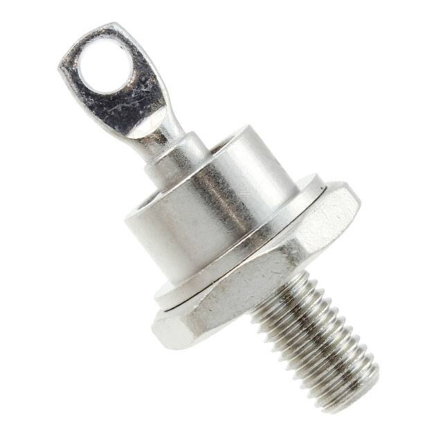

1N3305 thru 1N3350B and 1N4549B thru 1N4556B 50 WATT ZENER DIODES SCOTTSDALE DIVISION APPEARANCE These high power 50 W Zener diodes represented by the JEDEC registered 1N3305 thru 1N3350B and 1N4549 thru 1N4556B series provide voltage regulation in a selection over a 3.9 V to 200 V broad range of voltages. They may be operated up to 50 W with adequate mounting and heat sinking with their low thermal resistance. These Zeners are also available in JAN, JANTX, JANTXV military qualifications. Microsemi also offers numerous other Zener products to meet higher and lower power applications. DO- 5 IMPORTANT: For the most current data, consult MICROSEMI’s website: http://www.microsemi.com FEATURES • • • • • • • • • JEDEC registered 1N3305 thru 1N3350B and 1N4549 thru 1N4556B Internal solder bond construction Hermetically sealed (welded) Zener Voltage 3.9V to 200V. Also available in JAN, JANTX, and JANTXV qualifications per MIL-PRF-19500/358 by adding the JAN, JANTX, or JANTXV prefixes to part numbers for desired level of screening; (e.g. JANTX1N3305B, JANTXV1N3318B, etc. Standard polarity is anode to case Reverse polarity with cathode to case by designating R suffix in part number, e.g. 1N3305RB, etc. Consult factory for surface mount equivalents • • • • • MECHANICAL AND PACKAGING o o Junction & Storage Temperatures: -65 C to +175 C DC Power Dissipation: 50 watts at TC < 75 oC Power Derating: 0.5 W/oC above 75oC Forward Voltage @ 10 A: 1.5 Volts THERMAL RESISTANCE: 2.0 oC/W maximum junction to hexagonal base (1.5 oC/W typical) Solder temperatures: 260 oC for 10 s (max) • • • • • • Copyright  2003 11-12-2003 REV A Regulates voltage over a broad operating current and temperature range Standard voltage tolerances are +/- 5% with B suffix, +/-10% with an A suffix, and +/-20% with no suffix Consult factory for +/-2% or +/-1% with a C or D suffix respectively Reverse polarity available Nonsensitive to ESD per MIL-STD-750 Method 1020 Inherently radiation hard as described in Microsemi MicroNote 050 CASE: Industry Standard DO-5 (DO-203AB), 11/16 inch hexagonal stud with 1/4-28 threads welded hermetically sealed metal and glass FINISH: All external surfaces are corrosion resistant and terminal solderable. POLARITY: Standard Polarity units are connected anode to case. Reverse polarity (cathode to case) is indicated by Suffix R in part number WEIGHT: 15 grams MOUNTING HARDWARE: Consult factory for optional insulator, bushing, solder terminal, washers and nut See package dimensions on last page Microsemi Scottsdale Division 8700 E. Thomas Rd. PO Box 1390, Scottsdale, AZ 85252 USA, (480) 941-6300, Fax: (480) 947-1503 Page 1 1N3305 – 1N3350B 350B 1N4549B – 1N4556B • (DO-203AB) APPLICATIONS / BENEFITS MAXIMUM RATINGS • • • • • WWW . Microsemi .C OM DESCRIPTION 1N3305 thru 1N3350B and 1N4549B thru 1N4556B 50 WATT ZENER DIODES SCOTTSDALE DIVISION ZENER TEST CURRENT (IZT) mA † 3,200 2,900 2,650 2,450 2,250 2,000 1,850 1,650 1,850 1,700 1,500 1,370 1,200 1,100 1,000 960 890 830 780 740 700 660 630 570 520 500 460 420 380 350 320 290 280 270 250 245 240 220 200 180 170 150 140 120 120 110 100 95 90 85 80 70 68 65 MAX. DYNAMIC IMPEDANCE (Note 3) † ZZT @ IZT OHMS 0.16 0.16 0.12 0.12 0.12 0.14 0.16 0.24 0.20 0.30 0.40 0.50 0.60 0.80 1.00 1.10 1.20 1.40 1.60 1.80 2.00 2.20 2.40 2.50 2.60 2.70 2.80 3.00 3.20 3.50 4.00 4.50 4.50 5.00 5.00 5.20 5.50 6.00 7.00 8.00 9.00 11.00 15.00 20.00 25.00 30.00 40.00 50.00 60.00 75.00 80.00 85.00 90.00 100.00 ZZK @ IZK = 5 mA OHMS 400 500 600 650 900 1,000 200 100 70 70 70 70 80 80 80 80 80 80 80 80 80 80 80 80 80 90 90 90 90 90 90 90 100 100 100 100 100 110 120 140 150 160 180 200 210 220 240 275 325 400 450 500 525 600 MAX. DC ZENER CURRENT (IZM) mA 11,900 10,650 9,700 8,900 8,100 7,300 6,650 6,050 6,600 5,900 5,200 4,800 4,300 3,900 3,800 3,300 3,000 2,800 2,650 2,500 2,300 2,200 2,100 1,900 1,750 1,550 1,500 1,400 1,300 1,150 1,050 975 930 880 830 810 790 740 660 600 540 490 420 400 380 365 335 310 290 270 250 230 220 200 MAX. REVERSE CURRENT** IR(max) @ VR µA 150 150 100 20 20 20 10 10 300 125 50 25 25 10 10 10 10 10 10 10 10 10 10 10 10 10 10 10 10 10 10 10 10 10 10 10 10 10 10 10 10 10 10 10 10 10 10 10 10 10 10 10 10 10 VOLTS 0.5 0.5 1.0 1.0 1.0 2.0 2.0 3.0 4.5 5.0 5.4 6.1 6.7 8.4 9.1 9.9 11.4 11.4 12.2 13.0 13.7 13.7 15.2 16.7 18.2 18.2 20.6 22.8 25.1 27.4 29.7 32.7 32.7 35.8 38.8 38.8 42.6 42.6 47.1 51.7 56.0 62.2 69.2 76.0 83.0 83.0 91.2 99.8 114.0 114.0 121.6 121.6 136.8 152.0 TYPICAL TEMP. COEFF. αVZ o %/ C -0.046 -0.033 -0.015 +/-0.010 +0.030 +0.049 +0.053 +0.057 0.040 0.045 0.048 0.050 0.055 0.060 0.065 0.065 0.070 0.070 0.070 0.075 0.075 0.075 0.075 0.080 0.080 0.080 0.085 0.085 0.085 0.085 0.090 0.090 0.090 0.090 0.090 0.090 0.090 0.090 0.090 0.090 0.090 0.090 0.090 0.090 0.095 0.095 0.095 0.095 0.095 0.095 0.095 0.095 0.095 0.100 *JEDEC Registered Data. **Not JEDEC Data. †Have JAN and JANTX and TXV Qualifications to MIL-S-19500/358. Copyright  2003 11-12-2003 REV A Microsemi Scottsdale Division 8700 E. Thomas Rd. PO Box 1390, Scottsdale, AZ 85252 USA, (480) 941-6300, Fax: (480) 947-1503 Page 2 1N3305 – 1N3350B 1N4549B – 1N4556B JEDEC TYPE NO. (Note 1) †1N4549B †1N4550B †1N4551B †1N4552B †1N4553B †1N4554B 1N4555B 1N4556B †1N3305B †1N3306B †1N3307B †1N3308B †1N3309B †1N3310B †1N3311B †1N3312B 1N3313B †1N3314B †1N3315B 1N3316B †1N3317B 1N3318B †1N3319B †1N3320B †1N3321B 1N3322B †1N3323B †1N3324B †1N3325B †1N3326B †1N3327B †1N3328B 1N3329B †1N3330B 1N3331B †1N3332B 1N3333B †1N3334B †1N3335B †1N3336B †1N3337B †1N3338B †1N3339B †1N3340B 1N3341B †1N3342B †1N3343B †1N3344B 1N3345B †1N3346B †1N3347B 1N3348B †1N3349B †1N3350B NOMINAL ZENER VOLTAGE VZ @ IZT Volts (Note 2) † 3.9 4.3 4.7 5.1 5.6 6.2 6.8 7.5 6.8 7.5 8.2 9.1 10.0 11.0 12.0 13.0 14.0 15.0 16.0 17.0 18.0 19.0 20.0 22.0 24.0 25.0 27.0 30.0 33.0 36.0 39.0 43.0 45.0 47.0 50.0 51.0 52.0 56.0 62.0 68.0 75.0 82.0 91.0 100.0 105.0 110.0 120.0 130.0 140.0 150.0 160.0 175.0 180.0 200.0 WWW . Microsemi .C OM *ELECTRICAL CHARACTERISTICS @ 30oC Case Temperature 1N3305 thru 1N3350B and 1N4549B thru 1N4556B 50 WATT ZENER DIODES SCOTTSDALE DIVISION See further notes on following page 1. When using JEDEC numbers an R suffix should be used to signify reversed polarity. The suffixes A and B indicate tolerances of 10% and 5% respectively. No suffix or just R denotes +/-20% tolerance. Example: 1N3319RB is a REVERSED polarity, 20 volt unit having a +/-5% tolerance on Zener Voltage. 2. 3. Zener Voltage (VZ) is measured with junction in thermal equilibrium with 30 C stud temperature. The Zener impedance is derived from the 60 cycle ac voltage, which results when an ac current having an rms value equal to 10% of the dc zener current (IZT or IZK) is superimposed on IZT or IZK. Zener impedance is measured at 2 points to ensure a sharp knee on the breakdown curve and to eliminate unstable units. A curve showing the variation of zener impedance vs. zener current for three representative types is shown in Figure 2. Also see Microsemi MicroNote 202. o Rated Power Dissipation - Watts OUTLINE AND CIRCUIT WWW . Microsemi .C OM NOTES: o Stud Temperature C FIGURE 1 Power Derating Curve FIGURE 2 Typical Zener Impedance vs. Zener Current PACKAGE DIMENSIONS 1N3305 – 1N3350B 350B 1N4549B – 1N4556B All Dimensions in: INCH mm Copyright  2003 11-12-2003 REV A Microsemi Scottsdale Division 8700 E. Thomas Rd. PO Box 1390, Scottsdale, AZ 85252 USA, (480) 941-6300, Fax: (480) 947-1503 Page 3
1N3345RB
物料型号:文档描述了Microsemi的50W Zener二极管,型号包括1N3305至1N3350B和1N4549至1N4556B系列。
器件简介:这些高功率Zener二极管提供在3.9V至200V的宽电压范围内的电压调节。它们可以在适当的安装和散热条件下工作至50W,具有低热阻。
引脚分配:文档中没有明确指出具体的引脚分配图,但提到了标准极性是阳极到外壳,而反向极性(阴极到外壳)通过在型号后添加"R"后缀来表示。
参数特性:文档列出了Zener二极管的主要特性,包括JEDEC注册型号、标称Zener电压、Zener测试电流、最大动态阻抗、最大直流Zener电流、最大反向电流和典型温度系数。
功能详解:Zener二极管具有内部焊接键合结构和密封(焊接)的Zener电压,具有标准电压容差,并且有JAN、JANTX和JANTXV的军事资格认证。
应用信息:文档中提到了Zener二极管的多种应用和好处,包括在宽广的电流和温度范围内调节电压、内部焊接键合结构、密封封装、可提供反向极性选项、对静电放电不敏感等。
封装信息:Zener二极管采用行业标准的DO-5(DO-203AB)封装,具有11/16英寸的六角形螺柱和1/4-28螺纹,焊接密封的金属和玻璃。
