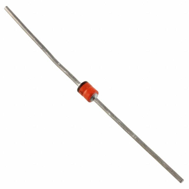

1N4954 thru 1N4996, 1N5968 thru 1N5969, and 1N6632 thru 1N6637 VOIDLESS-HERMETICALLY-SEALED 5 WATT GLASS ZENER DIODES SCOTTSDALE DIVISION APPEARANCE This Zener Voltage Regulator series is military qualified to MIL-PRF19500/356 and is ideal for high-reliability applications where a failure cannot be tolerated. These industry-recognized 5 Watt Zener Voltage Regulators are hermetically sealed with voidless-glass construction using an internal metallurgical bond. It includes Zener selections from 3.3 to 390 volts in standard 5% tolerances as well as tighter tolerances identified by different suffix letters on the part number. They are also available in surface-mount packages (see separate data sheet for 1N4954US thru 1N4996US, 1N5968US thru 1N5969US, and 1N6632US thru 1N6637US). Microsemi also offers numerous other Zener products to meet higher and lower power ratings in both thru-hole and surface mount packages. WWW . Microsemi .C OM DESCRIPTION “E” Package IMPORTANT: For the most current data, consult MICROSEMI’s website: http://www.microsemi.com FEATURES • • • • • • • APPLICATIONS / BENEFITS Popular JEDEC registered series Voidless hermetically sealed glass package Extremely robust construction Triple-layer passivation Internal “Category I” Metallurgical bonds for 1N4954 thru 1N4996, and “Category III” for 1N6632 thru 1N6637 as well as 1N5968 thru 1N5959 JAN, JANTX, JANTXV, and JANS available per MILPRF-19500/356 Surface mount equivalents also available in a square end-cap MELF configuration with “US” suffix (see separate data sheet for 1N4954US thru 1N4996US, 1N6632US thru 1N6637US and 1N5968US thru 1N5969US • • • • • • • MAXIMUM RATINGS • • • • • MECHANICAL AND PACKAGING o Operating (TJ) Temperature: -65 C to +175 C. Storage Temperature: -65oC to +175oC. Power Dissipation: 5 Watts @ TL = 65oC at 3/8 inch (10 mm) from body for 1N4954 thru 1N4996; and o TL = 25 C for 1N6632 thru 1N6637, 1N5968 thru 1N5969. Derate linearly above these temperatures to zero at 175oC. Thermal Resistance: 22oC/W junction to lead at 3/8 inch (10 mm) from body for 1N4954 thru 1N4996 and o 30 C/W for 1N6632 thru 1N6637, 1N5968 thru 1N5969 Thermal Impedance at 10 ms: 1.8oC/W for 1N4954 thru 1N4996, and 3.0oC/W for both the 1N6632 thru 1N6637 & 1N5968 thru 1N5969 Forward Voltage: 1.50 V at 1.0 A Copyright © 2010 3-29-2010 REV G; SA5-37.pdf • • • • • CASE: Hermetically sealed voidless hard glass with Tungsten slugs TERMINATIONS: Axial-leads are Copper with Tin/Lead (Sn/Pb) finish. Note: Previous inventory had solid Silver (Ag) axial-leads and no finish. MARKING: Body painted and part number, etc. POLARITY: Cathode indicated by band Tape & Reel option: Standard per EIA-296 Weight: 750 mg Microsemi Page 1 • Scottsdale Division 8700 E. Thomas Rd. PO Box 1390, Scottsdale, AZ 85252 USA, (480) 941-6300, Fax: (480) 947-1503 1N4954 thru 1N4996 1N5968 thru 1N5969 1N6632 thru 1N6637 • o Regulates voltage over a broad operating current and temperature range Extensive selection from 3.3 to 390 V Standard voltage tolerances are plus/minus 5% with no suffix Tight tolerances available in plus or minus 2% or 1% with C or D suffix respectively Flexible axial-lead mounting terminals Nonsensitive to ESD per MIL-STD-750 Method 1020 Inherently radiation hard as described in Microsemi MicroNote 050 1N4954 thru 1N4996, 1N5968 thru 1N5969, and 1N6632 thru 1N6637 VOIDLESS-HERMETICALLY-SEALED 5 WATT GLASS ZENER DIODES SCOTTSDALE DIVISION TYPE* MAXIMUM ZENER IMPEDANCE ZZ @ ZZK* @ IZT IZK=1mA VOLTAGE REGULATION (Note 1) Δ VZ TEST CURRENT VOLTS mA OHMS OHMS VOLTS 1N6632 1N6633 1N6634 1N6635 1N6636 1N6637 3.3 3.6 3.9 4.3 4.7 5.1 380 350 320 290 260 240 3.0 2.5 2.0 2.0 2.0 1.5 500 500 500 500 450 400 1N5968 1N5969 1N4954 1N4955 1N4956 1N4957 1N4958 1N4959 1N4960 1N4961 1N4962 1N4963 1N4964 1N4965 1N4966 1N4967 1N4968 1N4969 1N4970 1N4971 1N4972 1N4973 1N4974 1N4975 1N4976 1N4977 1N4978 1N4979 1N4980 1N4981 1N4982 1N4983 1N4984 1N4985 1N4986 1N4987 1N4988 1N4989 1N4990 1N4991 1N4992 1N4993 1N4994 1N4995 1N4996 5.6 6.2 6.8 7.5 8.2 9.1 10.0 11 12 13 15 16 18 20 22 24 27 30 33 36 39 43 47 51 56 62 68 75 82 91 100 110 120 130 150 160 180 200 220 240 270 300 330 360 390 220 220 175 175 150 150 125 125 100 100 75 75 65 65 50 50 50 40 40 30 30 30 25 25 20 20 20 20 15 15 12 12 10 10 8 8 5 5 5 5 5 4 4 3 3 1.0 1.0 1.0 1.5 1.5 2.0 2.0 2.5 2.5 3.0 3.5 3.5 4.0 4.5 5.0 5.0 6.0 8 10 11 14 20 25 27 35 42 50 55 80 90 110 125 170 190 330 350 450 500 550 650 800 950 1175 1400 1800 400 1000 1000 800 600 400 125 130 140 145 150 155 160 165 170 175 180 190 200 220 230 240 250 270 320 400 500 620 720 760 800 1000 1150 1250 1500 1650 1750 1850 2000 2050 2100 2150 2200 2300 2500 IZT MAXIMUM REVERSE LEAKAGE CURRENT VOLTAGE MAXIMUM TEMPERATURE COEFF. αVZ @ IZT MAXIMUM CONTINUOUS CURRENT SURGE CURRENT @ 8.3 ms sq. wave IR VR VOLTS %/oC mA AMPS 0.90 0.80 0.75 0.70 0.60 0.50 μA 300 250 175 25 20 5 1.0 1.0 1.0 1.0 1.0 1.0 -.075 -.070 -.060 -.050 +/-.025 +/-.030 1440 1320 1220 1100 1010 930 20.0 18.7 17.6 16.4 15.3 14.4 0.4 0.5 0.7 0.7 0.7 0.7 0.8 0.8 0.8 0.9 1.0 1.1 1.2 1.5 1.8 2.0 2.0 2.5 2.8 3.0 3.0 3.3 3.5 4.0 4.4 5.0 5.5 6.0 6.6 7.5 8.0 9.0 10 11 13 14 16 18 19 22 25 28 32 35 40 5000 1000 150 100 50 25 25 10 10 10 5 5 5 2 2 2 2 2 2 2 2 2 2 2 2 2 2 2 2 2 2 2 2 2 2 2 2 2 2 2 2 2 2 2 2 4.28 4.74 5.2 5.7 6.2 6.9 7.6 8.4 9.1 9.9 11.4 12.2 13.7 15.2 16.7 18.2 20.6 22.8 25.1 27.4 29.7 32.7 35.8 38.8 42.6 47.1 51.7 56.0 62.2 69.2 76.0 83.6 91.2 98.8 114.0 121.6 136.8 152 167 182 206 228 251 274 297 .04 .04 .05 .06 .06 .06 .07 .07 .07 .08 .08 .08 .085 .085 .085 .090 .090 .090 .095 .095 .095 .095 .095 .095 .095 .100 .100 .100 .100 .100 .100 .100 .100 .105 .105 .105 .110 .110 .115 .115 .120 .120 .120 .120 .120 865 765 700 630 580 520 475 430 395 365 315 294 264 237 216 198 176 158 144 132 122 110 100 92 84 76 70 63.0 58.0 52.5 47.5 43.0 39.5 36.6 31.6 29.4 26.4 23.6 21.6 19.8 17.5 15.6 14.4 13.0 12.0 20 20 29.3 26.4 24 22 20 19 18 16 12 10 9.0 8.0 7.0 6.5 6.0 5.5 5.0 4.5 4.0 3.5 3.2 3.0 2.8 2.5 2.2 2.0 1.8 1.6 1.4 1.2 1.00 0.80 0.75 0.70 0.60 0.50 0.50 0.40 0.35 0.30 0.25 0.22 0.20 IZM IZSM *IZK = 5 mA for 1N5968 NOTE 1: Maximum voltage change ΔVZ between 10% of IZM and 50% of IZM Copyright © 2010 3-29-2010 REV G; SA5-37.pdf Microsemi Scottsdale Division 8700 E. Thomas Rd. PO Box 1390, Scottsdale, AZ 85252 USA, (480) 941-6300, Fax: (480) 947-1503 Page 2 1N4954 thru 1N4996 1N5968 thru 1N5969 1N6632 thru 1N6637 NOMINAL ZENER VOLTAGE VZ @ IZT WWW . Microsemi .C OM ELECTRICAL CHARACTERISTICS @ 25oC 1N4954 thru 1N4996, 1N5968 thru 1N5969, and 1N6632 thru 1N6637 SCOTTSDALE DIVISION ZZT or ZZK VF IR IZM IZSM Zener Voltage: The zener voltage the device will exhibit at a specified current (IZ) in its breakdown region. Regulator Current: The dc regulator current (IZ), at a specified test point (IZT), or near breakdown knee (IZK). Dynamic Impedance: The small signal impedance of the diode when biased to operate in its breakdown region at a specified rms current modulation (typically 10% of IZT or IZK) and superimposed on IZT or IZK respectively. Maximum Forward Voltage: The maximum forward voltage the device will exhibit at a specified current. Maximum Reverse Current: The maximum reverse (leakage) current that will flow at the specified voltage and temperature. Maximum Regulator (Zener) Current: The maximum rated dc current for the specified power rating. Maximum Zener Surge Current: The nonrepetitive peak value of zener surge current at a specified wave form. WWW . Microsemi .C OM SYMBOLS & DEFINITIONS Definition Symbol VZ IZ, IZT, IZK VOIDLESS-HERMETICALLY-SEALED 5 WATT GLASS ZENER DIODES GRAPHS FIGURE 1 POWER DISSIPATION vs. LEAD TEMPERATURE DERATING CURVE FIGURE 2 SURGE POWER vs. SURGE DURATION 1N4954 thru 1N4996 1N5968 thru 1N5969 1N6632 thru 1N6637 FIGURE 3 TYPICAL ZENER IMPEDANCE vs. ZENER CURRENT Copyright © 2010 3-29-2010 REV G; SA5-37.pdf Microsemi Scottsdale Division 8700 E. Thomas Rd. PO Box 1390, Scottsdale, AZ 85252 USA, (480) 941-6300, Fax: (480) 947-1503 Page 3 1N4954 thru 1N4996, 1N5968 thru 1N5969, and 1N6632 thru 1N6637 SCOTTSDALE DIVISION VOIDLESS-HERMETICALLY-SEALED 5 WATT GLASS ZENER DIODES WWW . Microsemi .C OM PACKAGE DIMENSIONS Lead Tolerance = + .002 -.003 in *Includes sections of the lead or fillet over which the lead diameter is uncontrolled. 1N4954 thru 1N4996 1N5968 thru 1N5969 1N6632 thru 1N6637 Copyright © 2010 3-29-2010 REV G; SA5-37.pdf Microsemi Scottsdale Division 8700 E. Thomas Rd. PO Box 1390, Scottsdale, AZ 85252 USA, (480) 941-6300, Fax: (480) 947-1503 Page 4
1N4963
物料型号: - 1N4954至1N4996 - 1N5968至1N5969 - 1N6632至1N6637
器件简介: 这些是无空洞、真空密封的5瓦特玻璃齐纳二极管,符合MIL-PRF19500/356军用标准,适用于高可靠性应用,如在故障不可接受的情况下。这些齐纳电压调节器采用内部冶金键合的无空洞玻璃结构,提供从3.3至390伏的标准5%容差齐纳选择,以及通过不同的后缀字母标识的更严格容差。
引脚分配: - 轴向引脚为铜质,表面镀锡/铅(Sn/Pb)。 - 以前的库存有纯银(Ag)轴向引脚,没有镀层。
参数特性: - 工作温度范围:-65°C至+175°C - 存储温度范围:-65°C至+175°C - 功率耗散:5瓦特 - 热阻:对于1N4954至1N4996为22°C/W,对于1N6632至1N6637和1N5968至1N5969为30°C/W
功能详解: - 这些二极管具有广泛的选择范围,从3.3伏到390伏。 - 标准电压容差为正负5%,没有后缀。 - 提供正负2%或1%的紧密容差,分别带有C或D后缀。 - 灵活的轴向引脚安装终端。 - 根据MIL-STD-750方法1020,对ESD不敏感。 - 固有的辐射硬度如Microsemi MicroNote 050所述。
应用信息: 这些齐纳二极管适用于需要电压调节的广泛应用,包括军事和航空航天应用,以及其他需要高可靠性的场合。
封装信息: - 封装类型:真空密封无空洞硬质玻璃,带有钨塞。 - 封装尺寸:具体尺寸在文档中有详细描述。
