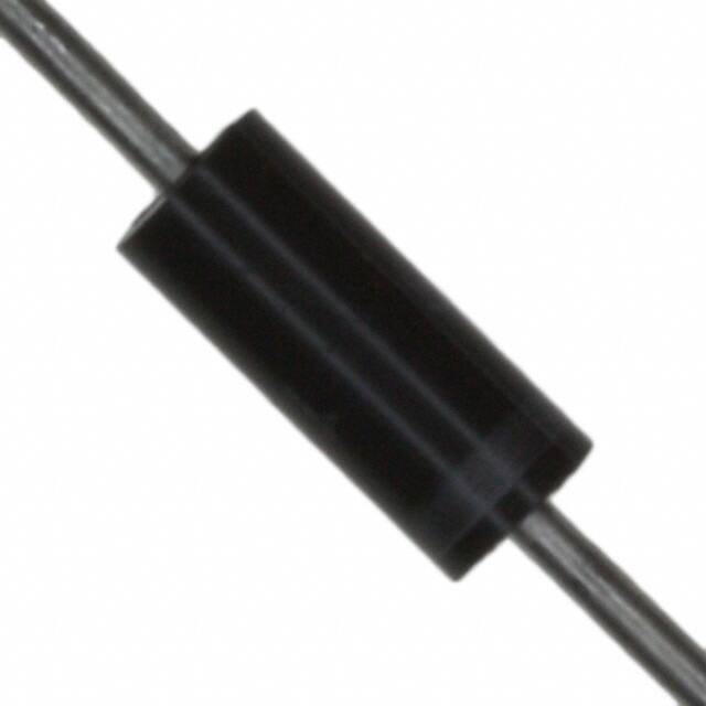

1N5333B thru 1N5388B, e3 Silicon 5 Watt Zener Diodes SCOTTSDALE DIVISION APPEARANCE The 1N5333-5388B JEDEC registered series of axial-leaded 5.0 watt Zeners provides voltage regulation in a selection from 3.3 to 200 volts with different tolerances as identified by specific suffix letter on the part number. These plastic encapsulated Zeners have moisture classification of Level 1 with no dry pack required and are also available in various military equivalent screening levels by adding a prefix identifier as also described in the Features section. They may be operated at high maximum dc currents with adequate heat sinking with their comparatively low thermal resistance design. Microsemi also offers numerous other Zener products to meet higher and lower power applications. T-18 WWW . Microsemi .C OM DESCRIPTION IMPORTANT: For the most current data, consult MICROSEMI’s website: http://www.microsemi.com FEATURES APPLICATIONS / BENEFITS • JEDEC registered 1N5333 to 1N5388B • Zener voltage available 3.3V to 200V • Standard voltage tolerances are plus/minus 5% with B suffix and 10 % with A suffix identification • Tight tolerances available in plus or minus 2% or 1% with C or D suffix respectively • Options for screening in accordance with MIL-PRF19500 for JAN, JANTX, and JANTXV are available by adding MQ, MX, or MV prefixes respectively to part numbers. • Surface mount equivalents available as SMBJ5333 to SMBJ5388B, or SMBG5333B to SMBG5388B • RoHS Compliant devices available by adding e3 suffix • • • • • MAXIMUM RATINGS MECHANICAL AND PACKAGING º • CASE: Void-free transfer molded thermosetting epoxy body meeting UL94V-0 • TERMINALS: Leads, Tin-Lead or RoHS Compliant annealed matte-Tin plating solderable per MIL-STD750, method 2026 • POLARITY: Cathode indicated by band. Diode to be operated with the banded end positive with respect to the opposite end. • MARKING: Part number • TAPE & REEL option: Standard per EIA-296 (add “TR” suffix to part number) • WEIGHT: 0.7 grams • See package dimensions on last page Power dissipation at 25 C: 5.0 watts (also see derating in Figure 1). Operating and Storage temperature: -65ºC to +150ºC Thermal Resistance: 25 ºC/W junction to lead at 3/8 (10 mm) lead length from body, or 85ºC/W junction to ambient when mounted on FR4 PC board (1oz Cu) with 4 mm2 copper pads and track width 1 mm, length 25 mm Steady-State Power: 5 watts at TL < 25oC 3/8 inch (10 mm) from body, or 1.47 watts at TA = 25ºC when mounted on FR4 PC described for thermal resistance (also see Figure 1) Forward voltage @1.0 A: 1.2 volts (maximum) Solder Temperatures: 260 ºC for 10 s (max) Copyright © 2008 8-06-2008 REV D Microsemi Scottsdale Division 8700 E. Thomas Rd. PO Box 1390, Scottsdale, AZ 85252 USA, (480) 941-6300, Fax: (480) 947-1503 Page 1 1N5333B thru 1N5388B, e3 • • Regulates voltage over a broad operating current and temperature range • Wide selection from 3.3 to 200 V • Flexible axial-lead mounting terminals • Nonsensitive to ESD per MIL-STD-750 Method 1020 • Withstands high surge stresses • Minimal changes of voltage versus current as specified by voltage regulation (ΔVZ) • High specified maximum current (IZM) when adequately heat sunk • Moisture classification is Level 1 per IPC/JEDEC JSTD-020B with no dry pack required 1N5333B thru 1N5388B, e3 Silicon 5 Watt Zener Diodes SCOTTSDALE DIVISION TYPE NUMBER REGULATOR VOLTAGE TEST CURRENT MAXIMUM DYNAMIC IMPEDANCE (VZ) (IZT) (ZZ) (IR) IR TEST VOLTAGE (VR) (Non-Suffix & A Suffix) IR TEST VOLTAGE (VR) (B,C,D Suffix) MAXIMUM REGULATOR CURRENT (IZM) (B,C,D Suffix) MAXIMUM DYNAMIC KNEE IMPEDANCE ZZK @ 1.0 mA (A,B,C,D Suffix) MAXIMUM SURGE CURRENT MAXIMUM VOLTAGE REGULATION (ΔVZ) (IZSM) (A,B,C,D Suffix) V mA dc OHMS μA V V mA OHMS AMPS VOLTS 3.3 3.6 3.9 4.3 4.7 5.1 5.6 6.0 6.2 6.8 7.5 8.2 8.7 9.1 10 11 12 13 14 15 16 17 18 19 20 22 24 25 27 28 30 33 36 39 43 47 51 56 60 62 68 75 82 87 91 100 110 120 130 140 150 160 170 180 190 200 380 350 320 290 260 240 220 200 200 175 175 150 150 150 125 125 100 100 100 75 75 70 65 65 65 50 50 50 50 50 40 40 30 30 30 25 25 20 20 20 20 20 15 15 15 12 12 10 10 8.0 8.0 8.0 8.0 5.0 5.0 5.0 3.0 2.5 2.0 2.0 2.0 1.5 1.0 1.0 1.0 1.0 1.5 1.5 2.0 2.0 2.0 2.5 2.5 2.5 2.5 2.5 2.5 2.5 2.5 3.0 3.0 3.5 3.5 4.0 5.0 6.0 8.0 10 11 14 20 25 27 35 40 42 44 45 65 75 75 90 125 170 190 230 330 350 380 430 450 480 300 150 50 10 5.0 1.0 1.0 1.0 1.0 10 10 10 10 7.5 5.0 5.0 2.0 1.0 1.0 1.0 1.0 0.5 0.5 0.5 0.5 0.5 0.5 0.5 0.5 0.5 0.5 0.5 0.5 0.5 0.5 0.5 0.5 0.5 0.5 0.5 0.5 0.5 0.5 0.5 0.5 0.5 0.5 0.5 0.5 0.5 0.5 0.5 0.5 0.5 0.5 0.5 1.0 1.0 1.0 1.0 1.0 1.0 2.0 3.0 3.0 4.9 5.4 5.9 6.25 6.6 7.2 8.0 8.6 9.4 10.1 10.8 11.5 12.2 13 13.7 14.4 15.8 17.3 18 19.4 20.1 21.6 23.8 25.9 28.1 31 33.8 36.7 40.3 43 44.6 49 54 59 63 65.5 72 79.2 86.4 93.6 101 108 115 122 130 137 144 1.0 1.0 1.0 1.0 1.0 1.0 2.0 3.0 3.0 5.2 5.7 6.2 6.6 6.9 7.6 8.4 9.1 9.9 10.6 11.5 12.2 12.9 13.7 14.4 15.2 16.7 18.2 19 20.6 21.2 22.8 25.1 27.4 29.7 32.7 35.8 38.8 42.6 45.5 47.1 51.7 56 62.2 66 69.2 76 83.6 91.2 98.8 106 114 122 129 137 144 152 1440 1320 1220 1100 1010 930 865 790 765 700 630 580 545 520 475 430 395 365 340 315 295 280 264 250 237 216 198 190 176 170 158 144 132 122 110 100 93 86 79 76 70 63 58 54.5 52.5 47.5 43 39.5 36.6 34 31.6 29.4 28 26.4 25 23.6 400 500 500 500 450 400 400 300 200 200 200 200 200 150 125 125 125 100 75 75 75 75 75 75 75 75 100 110 120 130 140 150 160 170 190 210 230 280 350 400 500 620 720 760 760 800 1000 1150 1250 1500 1500 1650 1750 1750 1850 1850 20 18.7 17.6 16.4 15.3 14.4 13.4 12.7 12.4 11.5 10.7 10 9.5 9.2 8.6 8.0 7.5 7.0 6.7 6.3 6.0 5.8 5.5 5.3 5.1 4.7 4.4 4.3 4.1 3.9 3.7 3.5 3.3 3.1 2.8 2.7 2.5 2.3 2.2 2.1 2.0 1.9 1.8 1.7 1.6 1.5 1.4 1.3 1.2 1.2 1.1 1.1 1.0 1.0 0.9 0.9 0.85 0.80 0.54 0.49 0.44 0.39 0.25 0.19 0.10 0.15 0.15 0.20 0.20 0.22 0.22 0.25 0.25 0.25 0.25 0.25 0.30 0.35 0.40 0.40 0.40 0.45 0.55 0.55 0.60 0.60 0.60 0.60 0.65 0.65 0.70 0.80 0.90 1.00 1.20 1.35 1.50 1.60 1.80 2.00 2.20 2.30 2.50 2.50 2.50 2.50 3.00 3.00 3.00 4.00 5.00 5.00 *JEDEC Registered Data. NOTE 1: Devices listed above with B suffix have ±5% tolerance, A suffix designates ±10% tolerance, C suffix designates ±2% tolerance, and D suffix designates ±1% tolerance. No suffix designates ±20%. o o NOTE 2: Zener voltage (Vz) is measured at TL = 25 C (+8, -2 C). Voltage measurement performed at 40 ±10 milliseconds after application of dc current. NOTE 3: The zener impedance is derived from 1 kHz ac voltage resulting from an ac current modulation having an rms value equal to 10% of the dc zener current (IZT or IZK) superimposed on IZT or IZK. See Micro Note 202 for zener impedance variation with different operating currents. NOTE 4: The maximum current (IZM) shown is for a ±5% tolerance devices. The IZM for other tolerances can be calculated using the formula: IZM = P/VZM where VZM is the VZ at the high end of the voltage tolerance specified and P is the rated power for the method of mounting. NOTE 5: The surge current (IZSM) is specified as the maximum peak of a non-recurrent half-sine wave of 8.3 ms duration. NOTE 6: Voltage regulation (ΔVZ) is the difference between the voltage measured at 10% and 50% of IZM. Copyright © 2008 8-06-2008 REV D Microsemi Scottsdale Division 8700 E. Thomas Rd. PO Box 1390, Scottsdale, AZ 85252 USA, (480) 941-6300, Fax: (480) 947-1503 Page 2 1N5333B thru 1N5388B, e3 1N5333B 1N5334B 1N5335B 1N5336B 1N5337B 1N5338B 1N5339B 1N5340B 1N5341B 1N5342B 1N5343B 1N5344B 1N5345B 1N5346B 1N5347B 1N5348B 1N5349B 1N5350B 1N5351B 1N5352B 1N5353B 1N5354B 1N5355B 1N5356B 1N5357B 1N5358B 1N5359B 1N5360B 1N5361B 1N5362B 1N5363B 1N5364B 1N5365B 1N5366B 1N5367B 1N5368B 1N5369B 1N5370B 1N5371B 1N5372B 1N5373B 1N5374B 1N5375B 1N5376B 1N5377B 1N5378B 1N5379B 1N5380B 1N5381B 1N5382B 1N5383B 1N5384B 1N5385B 1N5386B 1N5387B 1N5388B (A&B Suffix) MAXIMUM REVERSE CURRENT WWW . Microsemi .C OM *ELECTRICAL CHARACTERISTICS @ 25oC 1N5333B thru 1N5388B, e3 Silicon 5 Watt Zener Diodes SCOTTSDALE DIVISION WWW . Microsemi .C OM OUTLINE AND CIRCUIT Pd, Maximum Power Dissipation (Watts) TL TA on FR4 PC board o TL, Lead temperature ( C) 3/8” from body. or TA ambient temperature on FR4 PC Board FIGURE 1 Power Derating Curve FIGURE 2 Typical Capacitance vs. Reverse Voltage for 5 Watt Zeners PACKAGE DIMENSIONS 1N5333B thru 1N5388B, e3 FIGURE 3 Typical Capacitance vs. Reverse Voltage for 5 Watt Zeners Copyright © 2008 8-06-2008 REV D Microsemi Scottsdale Division 8700 E. Thomas Rd. PO Box 1390, Scottsdale, AZ 85252 USA, (480) 941-6300, Fax: (480) 947-1503 Page 3

物料型号: 1N5333B 至 1N5388B
器件简介: - 这些是Microsemi生产的5瓦Zener二极管,JEDEC注册系列,提供从3.3到200伏的电压调节。 - 封装为轴向引线,塑料封装,具有较低的热阻设计,可在适当的散热条件下在高直流电流下工作。
引脚分配: - 引脚分配为轴向引线,标记带表示阴极。
参数特性: - 电压容差:B后缀为±5%,A后缀为±10%,C后缀为±2%,D后缀为±1%,无后缀为±20%。 - 动态阻抗(Zz)、最大反向电流(IR)、测试电压(VR)、最大调节电流(IZM)、最大动态膝阻抗(Zzx@1.0mA)、最大浪涌电流(IZSM)和最大电压调节(AVz)等参数随不同型号而变化。
功能详解: - 用于在宽广的电流和温度范围内调节电压。 - 具有灵活的轴向引脚安装终端。 - 非静电放电敏感,符合MIL-STD-750方法1020。 - 提供符合MIL-PRF19500的筛选选项。
应用信息: - 可用于需要电压调节的多种应用。
封装信息: - 封装类型为T-18,符合IPC/JEDEC JSTD-020B的1级湿度分类,无需干燥包装。 - 还提供表面贴装等效型号,如SMBJ5333至SMBJ5388B或SMBG5333B至SMBG5388B。
