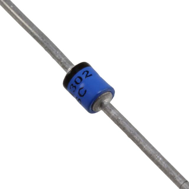

1N5415 thru 1N5420 Available on commercial versions Qualified Levels: JAN, JANTX, JANTXV and JANS VOIDLESS HERMETICALLY SEALED FAST RECOVERY GLASS RECTIFIERS Qualified per MIL-PRF-19500/411 DESCRIPTION This “fast recovery” rectifier diode series is military qualified and is ideal for high-reliability applications where a failure cannot be tolerated. These industry-recognized 3.0 amp rated rectifiers for working peak reverse voltages from 50 to 600 volts are hermetically sealed with voidless-glass construction using an internal “Category 1” metallurgical bond. These devices are also available in surface mount MELF package configurations. Microsemi also offers numerous other rectifier products to meet higher and lower current ratings with various recovery time speed requirements including fast and ultrafast device types in both through-hole and surface mount packages. Important: For the latest information, visit our website http://www.microsemi.com. FEATURES • Popular JEDEC registered 1N5415 thru 1N5420 series. • • • • • • Voidless hermetically sealed glass package. Quadruple-layer passivation. Internal “Category 1” metallurgical bonds. Working Peak Reverse Voltage 50 to 600 volts. JAN, JANTX, JANTXV and JANS qualifications available per MIL-PRF-19500/411. RoHS compliant versions available (commercial grade only). “B” Package APPLICATIONS / BENEFITS • • • • • • • • Fast recovery 3 amp 50 to 600 volt rectifiers. Military and other high-reliability applications. General rectifier applications including bridges, half-bridges, catch diodes, etc. High forward surge current capability. Extremely robust construction. Low thermal resistance. Controlled avalanche with peak reverse power capability. Inherently radiation hard as described in Microsemi “MicroNote 050”. Also available in: “B” SQ-MELF (D-5B) Package (surface mount) 1N5415US – 1N5420US MAXIMUM RATINGS Parameters/Test Conditions Junction and Storage Temperature (1) Thermal Resistance Junction-to-Lead Forward Surge Current @ 8.3 ms half-sine (4) o Average Rectified Forward Current @ TA = +55 C @ TA = +100 o C Working Peak Reverse Voltage 1N5415 1N5416 1N5417 1N5418 1N5419 1N5420 (5) Maximum Reverse Recovery Time 1N5415 1N5416 1N5417 1N5418 1N5419 1N5420 Solder Temperature @ 10 s Symbol Value TJ and TSTG R ӨJL I FSM (2, 3) IO (3) IO -65 to +175 22 80 3 2 V RWM 50 100 200 400 500 600 150 150 150 150 250 400 260 t rr TSP Unit o C C/W A A o V ns o C MSC – Lawrence 6 Lake Street, Lawrence, MA 01841 Tel: 1-800-446-1158 or (978) 620-2600 Fax: (978) 689-0803 MSC – Ireland Gort Road Business Park, Ennis, Co. Clare, Ireland Tel: +353 (0) 65 6840044 Fax: +353 (0) 65 6822298 Website: www.microsemi.com See notes on next page. T4-LDS-0231, Rev. 1 (111902) ©2011 Microsemi Corporation Page 1 of 5 1N5415 thru 1N5420 MAXIMUM RATINGS Notes: 1. 2. 3. 4. At 3/8 inch (10 mm) lead length from body. o o o Derate linearly at 22 mA/ C for 55 C < T A < 100 C. o o Above T A = 100 C, derate linearly at 26.7 mA/ C to zero at T A = 175 oC. These ambient ratings are for PC boards where thermal resistance from mounting point to ambient is sufficiently controlled where T J(max) o does not exceed 175 C. 5. I F = 0.5 A, I RM = 1 A, I R(REC) = 0.250 A. MECHANICAL and PACKAGING • • • • • • • CASE: Hermetically sealed voidless hard glass with tungsten slugs. TERMINALS: Axial-leads are tin/lead (Sn/Pb) over copper. RoHS compliant matte-tin is available for commercial grade only. MARKING: Body paint and part number. POLARITY: Cathode band. TAPE & REEL option: Standard per EIA-296. Contact factory for quantities. WEIGHT: 750 milligrams. See Package Dimensions on last page. PART NOMENCLATURE JAN 1N5415 (e3) Reliability Level JAN = JAN Level JANTX = JANTX Level JANTXV = JANTXV Level JANS = JANS Level Blank = commercial RoHS Compliance e3 = RoHS compliant (available on commercial grade only) Blank = non-RoHS compliant JEDEC type number See Electrical Characteristics table SYMBOLS & DEFINITIONS Definition Symbol V BR V RWM IO VF IR t rr Minimum Breakdown Voltage: The minimum voltage the device will exhibit at a specified current. Working Peak Reverse Voltage: The maximum peak voltage that can be applied over the operating temperature range excluding all transient voltages (ref JESD282-B). Average Rectified Output Current: The Output Current averaged over a full cycle with a 50 Hz or 60 Hz sine-wave input and a 180 degree conduction angle. Maximum Forward Voltage: The maximum forward voltage the device will exhibit at a specified current. Maximum Reverse Current: The maximum reverse (leakage) current that will flow at the specified voltage and temperature. Reverse Recovery Time: The time interval between the instant the current passes through zero when changing from the forward direction to the reverse direction and a specified decay point after a peak reverse current occurs. T4-LDS-0231, Rev. 1 (111902) ©2011 Microsemi Corporation Page 2 of 5 1N5415 thru 1N5420 ELECTRICAL CHARACTERISTICS MINIMUM BREAKDOWN VOLTAGE FORWARD VOLTAGE VF @ 9 A TYPE MAXIMUM REVERSE CURRENT I R @ V RWM CAPACITANCE C VR @ 4 V V BR @ 50 µA 1N5415 1N5416 1N5417 1N5418 1N5419 1N5420 Volts 55 110 220 440 550 660 MIN. Volts 0.6 0.6 0.6 0.6 0.6 0.6 MAX. Volts 1.5 1.5 1.5 1.5 1.5 1.5 25 oC µA 1.0 1.0 1.0 1.0 1.0 1.0 100 oC µA 20 20 20 20 20 20 pF 550 430 250 165 140 120 NOTE 1: I F = 0.5 A, I RM = 1 A, I R(REC) = 0.250 A. T4-LDS-0231, Rev. 1 (111902) ©2011 Microsemi Corporation Page 3 of 5 1N5415 thru 1N5420 ZӨJX (oC/Watt) IF – Current (µA) GRAPHS t H Heating Time (seconds) % PIV FIGURE 2 Maximum Thermal Impedance IF – Current (A) FIGURE 1 Typical Reverse Current vs. PIV V F – Voltage (V) FIGURE 3 Typical Forward Current vs. Forward Voltage T4-LDS-0231, Rev. 1 (111902) ©2011 Microsemi Corporation Page 4 of 5 1N5415 thru 1N5420 PACKAGE DIMENSIONS Symbol BD LD BL LL Dimensions Inch Millimeters Min Max Min Max 0.110 0.180 2.79 4.57 0.036 0.042 0.91 1.07 0.130 0.260 3.30 6.60 0.90 1.30 22.9 33.0 Notes 3 4 4 NOTES: 1. Dimensions are in inches. 2. Millimeter equivalents are given for general information only. 3. Dimension BD shall be measured at the largest diameter. 4. The BL dimension shall include the entire body including slugs and sections of the lead over which the diameter is uncontrolled. This uncontrolled area is defined as the zone between the edge of the diode body and extending .050 inch (1.27 mm) onto the leads. 5. In accordance with ASME Y14.5M, diameters are equivalent to Φx symbology. T4-LDS-0231, Rev. 1 (111902) ©2011 Microsemi Corporation Page 5 of 5

物料型号:1N5415至1N5420
器件简介:这些二极管是军用级别的快速恢复整流二极管,适用于高可靠性应用,工作峰值反向电压从50到600伏,采用无空洞玻璃封装和内部“Category 1”冶金键合。
引脚分配:文档中没有明确提供引脚分配图,但提到了轴向引脚是锡/铅(Sn/Pb)覆盖铜,对于商业等级,提供符合RoHS标准的无铅焊锡。
参数特性: - 工作峰值反向电压:1N5415为50V,1N5416为100V,1N5417为200V,1N5418为400V,1N5419为500V,1N5420为600V。 - 最大反向恢复时间:1N5415至1N5419为150ns至400ns,1N5420为250ns。 - 最大正向浪涌电流:未明确列出具体数值。 - 热阻:未提供具体数值。
功能详解:这些二极管具有快速恢复能力,适用于军事和其他高可靠性应用,包括整流桥、半桥、捕获二极管等。它们具有高正向浪涌电流能力、极低的热阻和控制的雪崩能力。
应用信息:适用于一般的整流器应用,包括整流桥、半桥、捕获二极管等。
封装信息:提供SQ-MELF(D-5B)表面贴装封装,重量为750毫克,符合EIA-296标准的胶带和卷轴选项。
