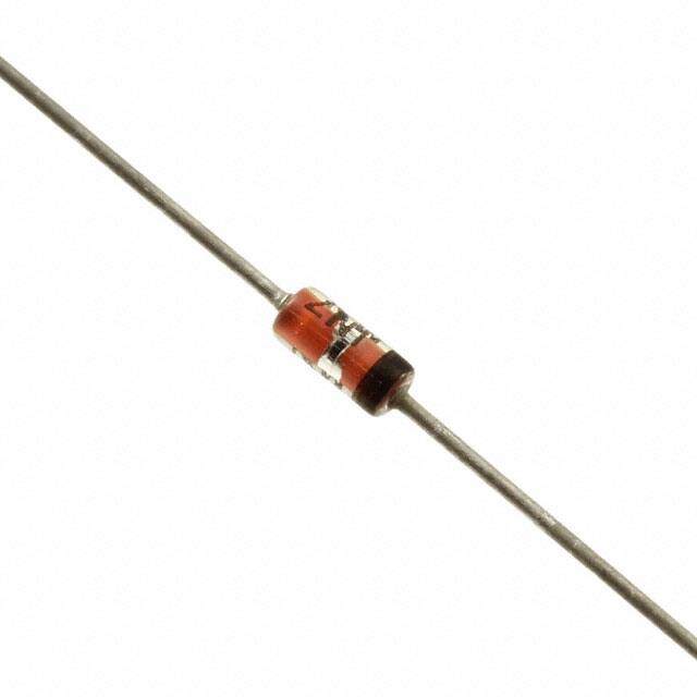

1N5728B thru 1N5757B-1 DO-35 Axial-Leaded 500 mW Zener Diodes SCOTTSDALE DIVISION APPEARANCE The 1N5728 thru 1N5757 series of 0.5 watt Zener Voltage Regulators provides a selection from 4.7 to 75 volts in standard 5% tolerances as well as tighter tolerances identified by a “C” or “D” suffix letter on the part number. These glass axial-leaded DO-35 Zeners are also available with an internal-metallurgical-bond option by adding a “-1” suffix. Microsemi also offers numerous other Zener products to meet higher and lower power applications. WWW . Microsemi .C OM DESCRIPTION DO-35 (DO-204AH) IMPORTANT: For the most current data, consult MICROSEMI’s website: http://www.microsemi.com FEATURES • • • • • APPLICATIONS / BENEFITS JEDEC registered 1N5728 to 1N5757 series Internal metallurgical bond option available by adding a “-1” suffix Options for screening in accordance with MILPRF-19500 for JAN, JANTX, JANTXV, and JANS are available by adding MQ, MX, MV, or MSP prefixes respectively to part numbers with “-1” suffix Surface Mount equivalents are also available in DO-213AA by adding a UR or UR-1 suffix, e.g. 1N5728UR, 1N5746UR-1, etc. (see separate data sheets) DO-7 glass body axial-leaded Zener equivalents are also available MAXIMUM RATINGS • • • • • • • • MECHANICAL AND PACKAGING º Operating and Storage temperature: -65 C to +175ºC Thermal Resistance: 250 ºC/W junction to lead at 3/8 (10 mm) lead length from body, or 310ºC/W junction to ambient when mounted on FR4 PC board (1 oz Cu) with 4 mm2 copper pads and track width 1 mm, length 25 mm Steady-State Power: 0.5 watts at TL < 50oC 3/8 inch (10 mm) from body or 0.48 W at TA < 25ºC when mounted on FR4 PC board as described for thermal resistance above (also see Figure1) Forward voltage @10 mA: 0.9 volts (maximum) Solder Temperatures: 260 ºC for 10 s (max) Copyright  2003 11-03-2003 REV A • • Regulates voltage over a broad operating current and temperature range Extensive selection from 4.7 to 75 V Standard voltage tolerances of plus/minus 5% with a B suffix Tight tolerances available in plus or minus 2% or 1% with C or D suffix respectively Flexible axial-lead mounting terminals Nonsensitive to ESD per MIL-STD-750 Method 1020 Minimal capacitance (see Figure 3) Inherently radiation hard as described in Microsemi MicroNote 050 • • • • • • • CASE: Hermetically sealed axial-lead glass DO-35 (DO-204AH) package TERMINALS: Leads, tin-lead plated solderable per MIL-STD-750, method 2026 POLARITY: Cathode indicated by band. Diode to be operated with the banded end positive with respect to the opposite end for Zener regulation MARKING: Part number TAPE & REEL option: Standard per EIA-296 (add “TR” suffix to part number) WEIGHT: 0.2 grams See package dimensions on last page Microsemi Scottsdale Division 8700 E. Thomas Rd. PO Box 1390, Scottsdale, AZ 85252 USA, (480) 941-6300, Fax: (480) 947-1503 Page 1 1N5728B thru 1N5757B-1 • • • 1N5728B thru 1N5757B-1 DO-35 Axial-Leaded 500 mW Zener Diodes SCOTTSDALE DIVISION TYPE NUMBER (Note 1) 1N5728B 1N5729B 1N5730B 1N5731B 1N5732B 1N5733B 1N5734B 1N5735B 1N5736B 1N5737B 1N5738B 1N5739B 1N5740B 1N5741B 1N5742B 1N5743B 1N5744B 1N5745B 1N5746B 1N5747B 1N5748B 1N5749B 1N5750B 1N5751B 1N5752B 1N5753B 1N5754B 1N5755B 1N5756B 1N5757B REGULATOR VOLTAGE TEST CURRENT DYNAMIC IMPEDANCE REVERSE CURRENT (VZ) Volts 4.7 5.1 5.6 6.2 6.8 7.5 8.2 9.1 10 11 12 13 15 16 18 20 22 24 27 30 33 36 39 43 47 51 56 62 68 75 (IZ) Amps 10 10 10 10 10 10 10 10 10 5 5 5 5 5 5 5 5 5 2 2 2 2 2 2 2 2 2 2 2 2 (ZZ) Ohms 70 50 25 10 10 10 15 15 20 20 25 30 30 40 45 55 55 70 80 80 90 90 130 150 170 180 200 215 240 255 µA 3.0 3.0 3.0 3.0 3.0 2.0 1.0 0.5 0.2 0.1 0.1 0.1 0.1 0.1 0.1 0.1 0.1 0.1 0.1 0.1 0.1 0.1 0.1 0.1 0.1 0.1 0.1 0.1 0.1 0.1 IR IR TEST VOLTAGE (VR) Volts 2 2 2 4 4 5 5 6 7 8 8 9 10 11 12 14 15 17 19 21 23 25 27 30 33 36 39 43 48 53 MAXIMUM REGULATOR CURRENT (IZM) mA 70 65 60 55 50 45 40 40 35 30 30 25 25 20 20 15 15 15 10 10 10 10 9 9 8 7 6 6 5 5 TEMPERATURE COEFFICIENT (αVZ) o mV/ C -1.0 -0.2 +1.2 +2.3 +3.0 +4.0 +5.0 +6.0 +7.0 +8.0 +9.0 +10.5 +12.9 +13 +15 +17 +19 +21 +23.5 +26 +29 +31 +34 +37 +40 +44 +47 +51 +56 +60 WWW . Microsemi .C OM ELECTRICAL CHARACTERISTICS* *JEDEC Registered Data. The Type Number indicates 5% Tolerance. (See Note 1.) NOTES: 1. 2. 3. Devices listed have a +/-5% voltage tolerance on nominal Vz with a B suffix. An A suffix is +/-10% and no suffix is +/-20%. Suffix C denotes a +/-2% tolerance and suffix D denotes a +/-1% tolerance. All static parameters measured under pulsed conditions, tp = 300 µs. Dynamic Impedance is derived by measuring the ac voltage when superimposing an ac rms current of 0.2 mA at 1000 Hz on to the dc level of IZT. 1N5728B thru 1N5757B-1 Copyright  2003 11-03-2003 REV A Microsemi Scottsdale Division 8700 E. Thomas Rd. PO Box 1390, Scottsdale, AZ 85252 USA, (480) 941-6300, Fax: (480) 947-1503 Page 2 1N5728B thru 1N5757B-1 DO-35 Axial-Leaded 500 mW Zener Diodes SCOTTSDALE DIVISION WWW . Microsemi .C OM o TEMPERATURE COEFFICIENT %/ C mV Change /ºC o o TL – LEAD TEMPERATURE ( C) 3/8” FROM BODY or TA on FR4 PC BOARD Voltage Temperature o Coefficient %/ C TEMPERATURE COEFFICIENT mV/ C RATED POWER DISSIPATION - mW GRAPHS NOMINAL ZENER VOLTAGE (VOLTS) FIGURE 2 ZENER VOLTAGE TEMPERATURE COEFFICIENT vs. ZENER VOLTAGE FIGURE 1 POWER DERATING CURVE CAPACITANCE vs. VZ CURVE 1N5728B thru 1N5757B-1 TYPICAL CAPACITANCE IN PICOFARADS PACKAGE DIMENSIONS All dimensions in: INCH mm ZENER VOLTAGE VZ FIGURE 3 Copyright  2003 11-03-2003 REV A Microsemi Scottsdale Division 8700 E. Thomas Rd. PO Box 1390, Scottsdale, AZ 85252 USA, (480) 941-6300, Fax: (480) 947-1503 Page 3
1N5730D
物料型号:1N5728B至1N5757B-1
器件简介:这系列齐纳二极管提供从4.7到75伏的电压调节选项,具有标准5%的容差以及更严格的容差选项,后者在型号后缀以“C”或“D”表示。这些二极管采用玻璃轴向引线DO-35封装,也提供内部冶金键合选项,型号后缀为“-1”。
引脚分配:二极管的阴极由带子标识,二极管应在带子端为正时进行齐纳调节。
参数特性:包括工作和存储温度范围(-65℃至+175℃)、热阻、稳态功率、正向电压、焊接温度等。
功能详解:这些二极管在广泛的工作电流和温度范围内调节电压,具有从4.7到75V的广泛选择,标准电压容差为±5%,也可提供±2%或±1%的紧密容差。它们对静电放电不敏感,具有最小的电容特性,并且具有固有的辐射硬度。
应用信息:适用于需要电压调节的场合,具有灵活的轴向引脚安装终端。
封装信息:采用密封的轴向引线玻璃DO-35(DO-204AH)封装,引脚为锡铅镀层可焊性,符合MIL-STD-750标准。
电气特性表格提供了不同型号的齐纳电压、测试电流、动态阻抗、反向电流、测试电压、最大调节电流和温度系数等参数。
图表部分展示了功率降额曲线、齐纳电压温度系数与齐纳电压的关系,以及典型电容与齐纳电压的曲线。
封装尺寸图提供了详细的尺寸信息,包括直径、极性标记、引脚直径等。
