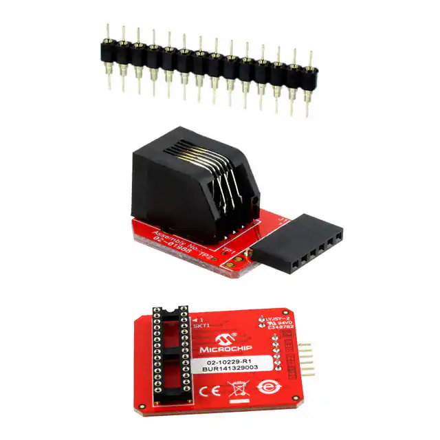

PEP and Debug Header Help AC244062 1/2 Required Debug Headers : AC244062 AC244062 Header Identification The AC number is used for ordering the Processor Extension Pak, which contains the debug header. However, this number is not on the header, as the board may be used for multiple headers by inserting different -ICE/-ICD devices. To identify these headers, use the following information. AC Number AC244062 -ICE/-ICD Device PIC16F570-ICD Board Assembly Number 02-10229 Header Setup and Operation For these headers, there are no jumpers/switches.MPLAB X IDE will use its selected device to choose the correct device to emulate. Header Limitations See the “Limitations” section in your debug tool online Help file for details. Header Dimensions The figure below lists the dimensions for the debug headers. Dimensions are design values in inches. If the length and/or width of the debug header is too large a footprint for the target board, consider using stand-offs, transition sockets or other extenders in the header connection socket to raise the header above the target. Figure: Dimensions - AC244062 AC244062 2/2 Microchip Support Help Updated: 2014-06-10 16:25:02Z Help Page: 26
