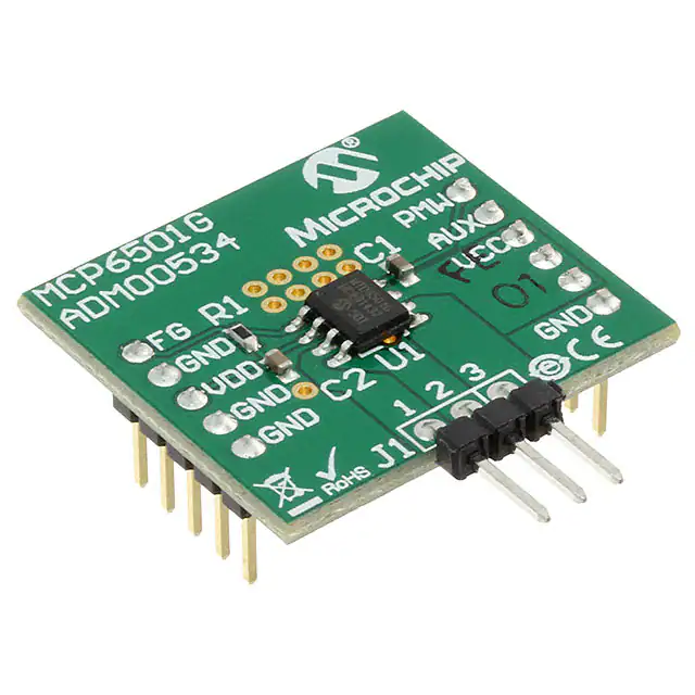

MTD6501C/D/G 3-Phase Brushless DC Sinusoidal Sensorless Fan Motor Driver Features Description • Position Sensorless BLDC Drivers (No Hall Sensor Required) • 180° Sinusoidal Drive, for High Efficiency and Low Acoustic Noise • Support 2V to 14V Power Supplies • Speed Control Through PAM and/or PWM • Built-in Frequency Generator (FG Output Signal) • Built-in Lock-up Protection and Automatic Recovery Circuit (External Capacitor not Necessary) • Built-in Over Current Limitation and Short Circuit Protection • Built-in Thermal Shutdown Protection • Thermally Enhanced SOP-8 Package for MTD6501C and MTD6501G (Maximum Output Current – 800 mA); • MSOP-10L Package for MTD6501D (Maximum Output Current – 500 mA) • 20 kHz PWM Output Frequency for MTD6501C/D and 23 kHz for MTD6501G • Boost Mode (Optional Back Electromotive Force (BEMF) Pre-amplification in MTD6501D) • No External Tuning Required The MTD6501C/D/G devices are 3-phase, full-wave drivers for brushless sensorless DC motors. They feature 180° sinusoidal drive, high torque output, and silent drive. Due to their adaptive features and wide power-supply range capabilities (2V to 14V), they are intended to cover a wide range of motor characteristics, while requiring no external tuning from the user. Speed control can be achieved through either power supply modulation or pulse-width modulation (using the PWM digital input pin). The MTD6501C/D/G devices are formerly products of Advanced Silicon. Due to the compact packaging and minimum bill of materials (power transistors incorporated, no Hall sensor, no external tuning), they are best suited for lowcost fan applications requiring high efficiency and low acoustic noise, such as CPU cooling fans. Frequency generator output enables precision speed control in closed-loop applications. The MTD6501C/D/G drivers include a Lock-up Protection mode, which turns off the output current when the motor is under lock condition, and an automatic recovery that enables the fan to run when the lock condition is removed. Motor overcurrent limitation, short-circuit protection and thermalshutdown protection are also included. The MTD6501C and the MTD6501G are available in a compact thermally-enhanced SOP-8 package, while the MTD6501D is available in the MSOP-10L package. Package Types MTD6501C, MTD6501G SOP-8 FG 1 VDD 2 8 PWM 7 VCC OUT1 3 6 OUT3 OUT2 4 5 GND MTD6501D MSOP FG 1 GND 2 VDD 3  2010-2012 Microchip Technology Inc. 10 PWM 9 BOOST 8 VCC OUT1 4 7 OUT3 OUT2 5 6 GND DS22263B-page 1 MTD6501C/D/G Functional Block Diagram BOOST *MTD6501D Only VCC VREF Motor Phase Detection Circuit VDD Regulator Overcurrent protection VCC PWM PWM Input Output Drive Circuit VDD Timing Controller Soft Switching Drive FG OUT3 OUT2 OUT1 GND Thermal protection DS22263B-page 2 Short-circuit protection  2010-2012 Microchip Technology Inc. MTD6501C/D/G Typical Application – Fan Motor Driver Using the MTD6501C or MTD6501G PWM input (0.02-100 kHz) Vlogic (controller side) 1 FG 2 VDD C1 3 OUT1 4 OUT2 MTD6501C/G R1 PWM 8 VCC VCC 7 C2 OUT3 6 GND 5 Recommended External Components for Typical Application Element Type/Value Comment C1 >1 µF Connect as close as possible to IC input pins C2 >1 µF Connect as close as possible to IC input pins R1 >10 kΩ  2010-2012 Microchip Technology Inc. Connect to Vlogic on controller side DS22263B-page 3 MTD6501C/D/G Typical Application – Fan Motor Driver Using the MTD6501D PWM input (0.02-100 kHz) Vlogic (controller side) R1 1 FG 3 VDD C1 4 OUT1 5 OUT2 MTD6501D 2 GND PWM 10 BOOST 9 Tie to GND for BOOST mode VCC 8 C2 OUT3 7 GND 6 Recommended External Components for Typical Application Element C1 Type/Value >1 µF C2 >1 µF R1 >10 kΩ DS22263B-page 4 Comment Connect as close as possible to IC input pins Connect as close as possible to IC input pins Connect to Vlogic on controller side  2010-2012 Microchip Technology Inc. MTD6501C/D/G 1.0 ELECTRICAL CHARACTERISTICS Absolute Maximum Ratings† Power Supply Voltage (VCC_MAX) .................... -0.7 to +15.3V Maximum OUT1, 2, 3 Output Voltage (VOUT_MAX) ................. ................................................................ -0.7 to +15.3V+0.7V FG Maximum Output Voltage (VFG_MAX) ......... -0.7 to +15.3V Maximum Output Current(3,4) (IOUT_MAX)....................800 mA Maximum Output Current(3,5) (IOUT_MAX)....................500 mA FG Maximum Output Voltage (VFG_MAX) ......... -0.7 to +15.3V FG Maximum Output Current (IFG_MAX) .....................5.0 mA VDD Maximum Voltage (VDD_MAX) ..................... -0.7 to +4.0V PWM Maximum Voltage (VPWM_MAX) ................ -0.7 to +4.0V † Notice: Stresses above those listed under “Maximum Ratings” may cause permanent damage to the device. This is a stress rating only and functional operation of the device at those or any other conditions above those indicated in the operational listings of this specification is not implied. Exposure to maximum rating conditions for extended periods may affect device reliability. Note 1: Reference PCB, according to JEDEC standard EIA/JESD 51-9. 2: Derating applies for ambient temperatures outside the specified operating range (refer to Figure 1-1). 3: OUT1, OUT2, OUT3 (Continuous, 100% duty cycle). Allowable Power Dissipation(1,2,4)(PD_MAX).....................1.0W Allowable Power Dissipation(1,2,5)(PD_MAX).....................0.5W Max Junction Temperature (TJ)....................................+150°C 4: MTD6501C and MTD6501G 5: MTD6501D ELECTRICAL CHARACTERISTICS Electrical Specifications: Unless otherwise specified, all limits are established for VCC = 5.0V, TA = +25°C Parameters Sym. Min. Typ. Max. Units Power Supply Voltage VCC 2 — 14 V Power Supply Current IVCC — 10 — mA 5 Conditions Rotation Mode Lock-Protection Mode OUTx High Resistance RON(H) — 0.75 1 Ω IOUT = 0.5A, VCC = 3.3V to 14V OUTx Low Resistance RON(L) — 0.75 1 Ω IOUT = -0.5A, VCC = 3.3V to 14V OUTx Total Resistance RON(H+L) — 1.5 2 Ω IOUT = 0.5A, VCC = 3.3V to 14V VDD Output Voltage VDD — 3 — V VCC = 3.3V to 14V V VCC < 3.3V PWM Input Frequency fPWM 0.02 100 kHz — VCC – 0.2 — PWM Input H Level VPWM_H 0.8*VDD — 3.6 V — PWM Input L Level VPWM_L 0 — 0.2*VDD V — PWM Internal Pull-Up Current IPWM_L 17 34 — µA PWM = GND, VCC = 3.3V to 14V 8 17 — µA PWM = GND, VCC < 3.3V PWM Output Frequency fPWM_O — 20 — kHz MTD6501C and MTD6501D kHz MTD6501G FG Output Pin Low Level Voltage VOL_FG — — 0.25 V IFG = -1 mA FG Output Pin Leakage Current ILH_FG — — 10 µA VFG = 14V Lock Protection Operating Time TRUN — 0.5 — s — Lock Protection Waiting Time TWAIT 4.5 5 5.5 s — Thermal Shutdown TSD — 170 — °C — Thermal Shutdown Hysteresis TSD_HYS — 25 — °C — 23  2010-2012 Microchip Technology Inc. DS22263B-page 5 MTD6501C/D/G TEMPERATURE SPECIFICATIONS Electrical Specifications: Unless otherwise specified, all limits are established for VCC = 5.0V, TA = +25°C Parameters Sym. Min. Typ. Max. Units Operating Temperature TOPR -30 — +95 °C Storage Temperature Range TSTG -55 — +150 °C Conditions Temperature Ranges 1.2 PDMAX (W) 1 SOP-8 0.8 0.6 MSOP-10 0.4 0.2 -10 0 10 20 30 40 50 60 70 80 90 100 110 120 130 140 150 0 TA (°C) FIGURE 1-1: DS22263B-page 6 Allowable Power Dissipation (PD_MAX) as a Function of Ambient Temperature (TA).  2010-2012 Microchip Technology Inc. MTD6501C/D/G 2.0 PIN DESCRIPTIONS The descriptions of the pins are listed in Table 2-1. TABLE 2-1: MTD6501C/D/G PIN FUNCTION TABLE MTD6501C, MTD6501G MTD6501D SOP-8 MSOP 1 1 Type Symbol O FG Description Motor speed indication output Internal regulator output (for decoupling only) 2 3 P VDD 3 4 O OUT1 Single-phase coil output pin 4 5 O OUT2 Single-phase coil output pin 5 2, 6 P GND Negative voltage supply (ground) 6 7 O OUT3 Single-phase coil output pin 7 8 P VCC 8 10 I PWM PWM input signal for speed control N/A 9 I BOOST Boost mode selection: • Pin floating for Normal mode • Pin tied to GND for Boost mode Positive voltage supply for motor driver Legend: I = Input; O = Output; P = Power  2010-2012 Microchip Technology Inc. DS22263B-page 7 MTD6501C/D/G NOTES: DS22263B-page 8  2010-2012 Microchip Technology Inc. MTD6501C/D/G 3.0 FUNCTIONAL DESCRIPTION The MTD6501C/D/G devices generate a full-wave signal to drive a 3-phase sensorless BLDC motor. High efficiency and low-power consumption are achieved due to DMOS transistors and synchronous rectification drive type. The current carrying order of the output is as follows: OUT1  OUT2  OUT3. 3.1 Frequency Generator Function The Frequency Generator output is a “Hall-sensor equivalent” digital output, giving information to an external controller about the speed and phase of the motor. The FG pin is an open drain output, connecting to a logical voltage level through an external pull-up resistor. When a lock (or out-of-sync) situation is detected by the driver, this output is set to high-impedance until the motor is restarted. Leave the pin open when not used. The FG signal can be used to compute the motor speed in rotations per minute (RPM). Typically, for a four pole BLDC fan, the speed in RPMs is 30 FG frequency (Hz). 3.3 Overcurrent Protection and Short Circuit Detection The motor peak current is limited by the driver to a fixed value (defined internally), thus limiting the maximum power dissipation in the coils. The detection of a shortcircuit situation immediately sets the driver outputs to high-impedance, in order to avoid permanent damage to the IC. Speed Control The rotational speed of the motor can be controlled either through the PWM digital input signal or by acting directly on the power supply (VCC). When the PWM signal is “High” (or left open) the motor rotates at full speed. When the PWM signal is “Low”, the motor is stopped (and the IC outputs are set to highimpedance). By changing the PWM duty cycle, the speed can be adjusted. Notice that the PWM frequency has no special meaning for the motor speed and is asynchronous with the activation of the output transistors. Thus, the user has maximum freedom to choose the PWM system frequency within a wide range (from 20 Hz to 100 kHz), while the output transistor activation always occurs at a fixed rate, which is outside of the range of audible frequencies. The MTD6501C and MTD6501D typical output frequency is 20 kHz. The MTD6501G output frequency is 23 kHz. 3.2 3.4 Lockup Protection and Automatic Restart 3.5 Thermal Shutdown The MTD6501C/D/G have a thermal protection function which detects when the die temperature exceeds TSD = +170°C. When this temperature is reached, the circuit enters Thermal Shutdown mode and the outputs OUT1, OUT2 and OUT3 are disabled (high-impedance), avoiding IC destruction and allowing the circuit to cool down. Once the junction temperature (TSD) has dropped below +145°C, the normal operation resumes (thermal detection circuit has +25°C hysteresis function). Thermal Shutdown Normal operation TSD +145°C FIGURE 3-1: Hysteresis. 3.6 +170°C Thermal Protection Internal Voltage Regulator VDD voltage is generated internally and is used to supply internal logical blocks. The VDD pin is used to connect an external decoupling capacitor (1 µF or higher). Notice that this pin is for IC internal use and is not designed to supply DC current to external blocks. If the motor is stopped (blocked) or if it loses synchronization with the driver, a lock-up protection circuit detects this situation and disables the driver (by setting its outputs to high-impedance) in order to prevent the motor coil from burnout. After a “waiting time” (TWAIT), the lock-up protection is released and normal operation resumes for a given time (TRUN). In case the motor is still blocked, a new period of waiting time is started. TWAIT and TRUN timings are fixed internally, so that no external capacitor is needed.  2010-2012 Microchip Technology Inc. DS22263B-page 9 MTD6501C/D/G 3.7 Boost Mode (MTD6501D) The Boost mode is an optional BEMF pre-amplification by a factor of three. The intention of Boost mode is to compensate for motors with a low coupling coefficient (= BEMF coefficient), thus allowing it to cover an even wider range of motor characteristics. Notice that Boost mode impacts the mechanical performance of the motor altogether. In Boost mode, the speed of the motor will adjust faster to variations of the control (VCC or PWM) and/or of the load, including at start-up. However, when the BEMF is amplified too much, the mechanical performance (in terms of vibration and acoustic noise) may start degrading. Thus, Boost mode may be inappropriate for motors that already have a good coupling coefficient. The optimum choice between normal mode and Boost mode depends both on the application requirements and on the motor characteristics. Refer to Table 3-1 for usage of Boost pin 9; leaving this pin floating results in the normal mode of operation, while tying this pin to GND activates Boost mode (active low feature, internal pull-up). TABLE 3-1: POSSIBLE MODES OF OPERATION BASED ON THE BOOST PIN CONNECTION BOOST Pin Mode of Operation Floating Normal Tied to GND Boost DS22263B-page 10  2010-2012 Microchip Technology Inc. MTD6501C/D/G 4.0 PACKAGING INFORMATION 4.1 Package Marking Information 8-Lead SOP (3.90 mm) (MTD6501C, MTD6501G) Example MTD6501C HC e^^1135 3 256 NNN 10-Lead MSOP (MTD6501D) Example 6501D 135256 Legend: XX...X Y YY WW NNN e3 * Note: Customer-specific information Year code (last digit of calendar year) Year code (last 2 digits of calendar year) Week code (week of January 1 is week ‘01’) Alphanumeric traceability code Pb-free JEDEC designator for Matte Tin (Sn) This package is Pb-free. The Pb-free JEDEC designator ( e3 ) can be found on the outer packaging for this package. In the event the full Microchip part number cannot be marked on one line, it will be carried over to the next line, thus limiting the number of available characters for customer-specific information.  2010-2012 Microchip Technology Inc. DS22263B-page 11 MTD6501C/D/G DS22263B-page 12  2010-2012 Microchip Technology Inc. MTD6501C/D/G  2010-2012 Microchip Technology Inc. DS22263B-page 13 MTD6501C/D/G DS22263B-page 14  2010-2012 Microchip Technology Inc. MTD6501C/D/G Note: For the most current package drawings, please see the Microchip Packaging Specification located at http://www.microchip.com/packaging  2010-2012 Microchip Technology Inc. DS22263B-page 15 MTD6501C/D/G Note: For the most current package drawings, please see the Microchip Packaging Specification located at http://www.microchip.com/packaging DS22263B-page 16  2010-2012 Microchip Technology Inc. MTD6501C/D/G Note: For the most current package drawings, please see the Microchip Packaging Specification located at http://www.microchip.com/packaging  2010-2012 Microchip Technology Inc. DS22263B-page 17 MTD6501C/D/G NOTES: DS22263B-page 18  2010-2012 Microchip Technology Inc. MTD6501C/D/G APPENDIX A: REVISION HISTORY Revision B (May 2012) The following is the list of modifications: 1. 2. 3. 4. 5. 6. 7. Added the MTD6501G device to the family and related information throughout the document. Updated the Temperature Specifications table. Sorted the information in Table 2-1. Corrected Frequency Generator output to open drain in Section 3.2 “Frequency Generator Function”. Renamed Section 4.0 “Packaging Information”. Added Section 4.1 “Package Marking Information”. Added Product Identification System section. Other minor typographical corrections. Revision A (September 2010) • Original data sheet for the MTD6501C/D/G family of devices.  2010-2012 Microchip Technology Inc. DS22263B-page 19 MTD6501C/D/G NOTES: DS22263B-page 20  2010-2012 Microchip Technology Inc. MTD6501C/D/G PRODUCT IDENTIFICATION SYSTEM To order or obtain information, e.g., on pricing or delivery, refer to the factory or the listed sales office. PART NO. -X XX Device Tube/Tape and Reel Package Device MTD6501C-H: MTD6501C-L: MTD6501D-H: MTD6501D-L: MTD6501G-H: MTD6501G-L: Package C1* = = 3-Phase BLDC Sinusoidal Sensorless Fan Motor Driver (IOUT maximum 800 mA, PWM 20 kHz) (Tube) 3-Phase BLDC Sinusoidal Sensorless Fan Motor Driver (IOUT maximum 800 mA, PWM 20 kHz) (Tape and Reel) 3-Phase BLDC Sinusoidal Sensorless Fan Motor Driver (IOUT maximum 500 mA, PWM 20 kHz, Boost option) (Tube) 3-Phase BLDC Sinusoidal Sensorless Fan Motor Driver (IOUT maximum 500 mA, PWM 20 kHz, Boost option) (Tape and Reel) 3-Phase BLDC Sinusoidal Sensorless Fan Motor Driver (IOUT maximum 800 mA, PWM 23 kHz) (Tube) 3-Phase BLDC Sinusoidal Sensorless Fan Motor Driver (IOUT maximum 800 mA, PWM 23 kHz) (Tape and Reel) Examples: a) MTD6501C-HC1 b) MTD6501C-LC1 c) MTD6501D-HC1 d) MTD6501D-LC1 e) MTD6501G-HC1 f) MTD6501G-LC1 Tube, 8LD SOP Package Tape and Reel, 8LD SOP Package Tube, 10LD MSOP Package Tape and Reel, 10LD MSOP Package Tube, 8LD SOP Package Tape and Reel, 8LD SOP Package 8-Lead Plastic Small Outline – Thermally Enhanced Package (SOP) 10-Lead Plastic Micro Small Outline Package (MSOP) * These devices are formerly products of Advanced Silicon  2010-2012 Microchip Technology Inc. DS22263B-page 21 MTD6501C/D/G NOTES: DS22263B-page 22  2010-2012 Microchip Technology Inc. Note the following details of the code protection feature on Microchip devices: • Microchip products meet the specification contained in their particular Microchip Data Sheet. • Microchip believes that its family of products is one of the most secure families of its kind on the market today, when used in the intended manner and under normal conditions. • There are dishonest and possibly illegal methods used to breach the code protection feature. All of these methods, to our knowledge, require using the Microchip products in a manner outside the operating specifications contained in Microchip’s Data Sheets. Most likely, the person doing so is engaged in theft of intellectual property. • Microchip is willing to work with the customer who is concerned about the integrity of their code. • Neither Microchip nor any other semiconductor manufacturer can guarantee the security of their code. Code protection does not mean that we are guaranteeing the product as “unbreakable.” Code protection is constantly evolving. We at Microchip are committed to continuously improving the code protection features of our products. Attempts to break Microchip’s code protection feature may be a violation of the Digital Millennium Copyright Act. If such acts allow unauthorized access to your software or other copyrighted work, you may have a right to sue for relief under that Act. Information contained in this publication regarding device applications and the like is provided only for your convenience and may be superseded by updates. It is your responsibility to ensure that your application meets with your specifications. MICROCHIP MAKES NO REPRESENTATIONS OR WARRANTIES OF ANY KIND WHETHER EXPRESS OR IMPLIED, WRITTEN OR ORAL, STATUTORY OR OTHERWISE, RELATED TO THE INFORMATION, INCLUDING BUT NOT LIMITED TO ITS CONDITION, QUALITY, PERFORMANCE, MERCHANTABILITY OR FITNESS FOR PURPOSE. Microchip disclaims all liability arising from this information and its use. Use of Microchip devices in life support and/or safety applications is entirely at the buyer’s risk, and the buyer agrees to defend, indemnify and hold harmless Microchip from any and all damages, claims, suits, or expenses resulting from such use. No licenses are conveyed, implicitly or otherwise, under any Microchip intellectual property rights. Trademarks The Microchip name and logo, the Microchip logo, dsPIC, KEELOQ, KEELOQ logo, MPLAB, PIC, PICmicro, PICSTART, PIC32 logo, rfPIC and UNI/O are registered trademarks of Microchip Technology Incorporated in the U.S.A. and other countries. FilterLab, Hampshire, HI-TECH C, Linear Active Thermistor, MXDEV, MXLAB, SEEVAL and The Embedded Control Solutions Company are registered trademarks of Microchip Technology Incorporated in the U.S.A. Analog-for-the-Digital Age, Application Maestro, chipKIT, chipKIT logo, CodeGuard, dsPICDEM, dsPICDEM.net, dsPICworks, dsSPEAK, ECAN, ECONOMONITOR, FanSense, HI-TIDE, In-Circuit Serial Programming, ICSP, Mindi, MiWi, MPASM, MPLAB Certified logo, MPLIB, MPLINK, mTouch, Omniscient Code Generation, PICC, PICC-18, PICDEM, PICDEM.net, PICkit, PICtail, REAL ICE, rfLAB, Select Mode, Total Endurance, TSHARC, UniWinDriver, WiperLock and ZENA are trademarks of Microchip Technology Incorporated in the U.S.A. and other countries. SQTP is a service mark of Microchip Technology Incorporated in the U.S.A. All other trademarks mentioned herein are property of their respective companies. © 2010-2012, Microchip Technology Incorporated, Printed in the U.S.A., All Rights Reserved. Printed on recycled paper. ISBN: 978-1-62076-278-3 QUALITY MANAGEMENT SYSTEM CERTIFIED BY DNV == ISO/TS 16949 ==  2010-2012 Microchip Technology Inc. Microchip received ISO/TS-16949:2009 certification for its worldwide headquarters, design and wafer fabrication facilities in Chandler and Tempe, Arizona; Gresham, Oregon and design centers in California and India. The Company’s quality system processes and procedures are for its PIC® MCUs and dsPIC® DSCs, KEELOQ® code hopping devices, Serial EEPROMs, microperipherals, nonvolatile memory and analog products. In addition, Microchip’s quality system for the design and manufacture of development systems is ISO 9001:2000 certified. DS22263B-page 23 Worldwide Sales and Service AMERICAS ASIA/PACIFIC ASIA/PACIFIC EUROPE Corporate Office 2355 West Chandler Blvd. Chandler, AZ 85224-6199 Tel: 480-792-7200 Fax: 480-792-7277 Technical Support: http://www.microchip.com/ support Web Address: www.microchip.com Asia Pacific Office Suites 3707-14, 37th Floor Tower 6, The Gateway Harbour City, Kowloon Hong Kong Tel: 852-2401-1200 Fax: 852-2401-3431 India - Bangalore Tel: 91-80-3090-4444 Fax: 91-80-3090-4123 India - New Delhi Tel: 91-11-4160-8631 Fax: 91-11-4160-8632 Austria - Wels Tel: 43-7242-2244-39 Fax: 43-7242-2244-393 Denmark - Copenhagen Tel: 45-4450-2828 Fax: 45-4485-2829 India - Pune Tel: 91-20-2566-1512 Fax: 91-20-2566-1513 France - Paris Tel: 33-1-69-53-63-20 Fax: 33-1-69-30-90-79 Japan - Osaka Tel: 81-66-152-7160 Fax: 81-66-152-9310 Germany - Munich Tel: 49-89-627-144-0 Fax: 49-89-627-144-44 Atlanta Duluth, GA Tel: 678-957-9614 Fax: 678-957-1455 Boston Westborough, MA Tel: 774-760-0087 Fax: 774-760-0088 Chicago Itasca, IL Tel: 630-285-0071 Fax: 630-285-0075 Cleveland Independence, OH Tel: 216-447-0464 Fax: 216-447-0643 Dallas Addison, TX Tel: 972-818-7423 Fax: 972-818-2924 Detroit Farmington Hills, MI Tel: 248-538-2250 Fax: 248-538-2260 Indianapolis Noblesville, IN Tel: 317-773-8323 Fax: 317-773-5453 Los Angeles Mission Viejo, CA Tel: 949-462-9523 Fax: 949-462-9608 Santa Clara Santa Clara, CA Tel: 408-961-6444 Fax: 408-961-6445 Toronto Mississauga, Ontario, Canada Tel: 905-673-0699 Fax: 905-673-6509 Australia - Sydney Tel: 61-2-9868-6733 Fax: 61-2-9868-6755 China - Beijing Tel: 86-10-8569-7000 Fax: 86-10-8528-2104 China - Chengdu Tel: 86-28-8665-5511 Fax: 86-28-8665-7889 China - Chongqing Tel: 86-23-8980-9588 Fax: 86-23-8980-9500 Netherlands - Drunen Tel: 31-416-690399 Fax: 31-416-690340 Korea - Daegu Tel: 82-53-744-4301 Fax: 82-53-744-4302 Spain - Madrid Tel: 34-91-708-08-90 Fax: 34-91-708-08-91 China - Hangzhou Tel: 86-571-2819-3187 Fax: 86-571-2819-3189 Korea - Seoul Tel: 82-2-554-7200 Fax: 82-2-558-5932 or 82-2-558-5934 China - Hong Kong SAR Tel: 852-2401-1200 Fax: 852-2401-3431 Malaysia - Kuala Lumpur Tel: 60-3-6201-9857 Fax: 60-3-6201-9859 China - Nanjing Tel: 86-25-8473-2460 Fax: 86-25-8473-2470 Malaysia - Penang Tel: 60-4-227-8870 Fax: 60-4-227-4068 China - Qingdao Tel: 86-532-8502-7355 Fax: 86-532-8502-7205 Philippines - Manila Tel: 63-2-634-9065 Fax: 63-2-634-9069 China - Shanghai Tel: 86-21-5407-5533 Fax: 86-21-5407-5066 Singapore Tel: 65-6334-8870 Fax: 65-6334-8850 China - Shenyang Tel: 86-24-2334-2829 Fax: 86-24-2334-2393 Taiwan - Hsin Chu Tel: 886-3-5778-366 Fax: 886-3-5770-955 China - Shenzhen Tel: 86-755-8203-2660 Fax: 86-755-8203-1760 Taiwan - Kaohsiung Tel: 886-7-536-4818 Fax: 886-7-330-9305 China - Wuhan Tel: 86-27-5980-5300 Fax: 86-27-5980-5118 Taiwan - Taipei Tel: 886-2-2500-6610 Fax: 886-2-2508-0102 China - Xian Tel: 86-29-8833-7252 Fax: 86-29-8833-7256 Thailand - Bangkok Tel: 66-2-694-1351 Fax: 66-2-694-1350 UK - Wokingham Tel: 44-118-921-5869 Fax: 44-118-921-5820 China - Xiamen Tel: 86-592-2388138 Fax: 86-592-2388130 China - Zhuhai Tel: 86-756-3210040 Fax: 86-756-3210049 DS22263B-page 24 Italy - Milan Tel: 39-0331-742611 Fax: 39-0331-466781 Japan - Yokohama Tel: 81-45-471- 6166 Fax: 81-45-471-6122 11/29/11  2010-2012 Microchip Technology Inc.
