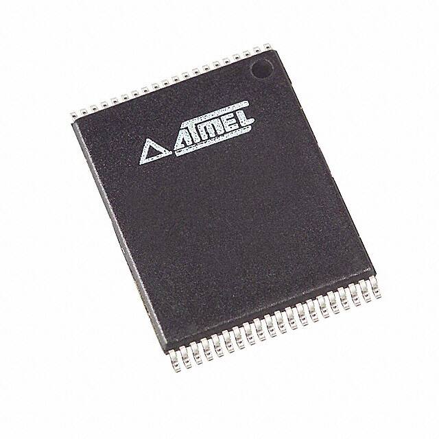

AT27C516-70VC 数据手册
Features • Fast Read Access Time - 45 ns • Low Power CMOS Operation • • • • • • • – 100 µA max. Standby – 30 mA max. Active at 5 MHz JEDEC Standard Packages – 44-Lead PLCC – 40-Lead VSOP (10mm x 14mm) 5V ± 10% Power Supply High Reliability CMOS Technology – 2000V ESD Protection – 200 mA Latchup Immunity Rapid™ Programming Algorithm - 50 µs/word (typical) CMOS and TTL Compatible Inputs and Outputs Integrated Product Identification Code Commercial and Industrial Temperature Ranges 512K (32K x 16) OTP EPROM AT27C516 Description The AT27C516 is a low-power, high performance 524,288-bit one-time programmable read only memory (OTP EPROM) organized 32K by 16 bits. It requires only one 5V power supply in normal read mode operation. Any word can be accessed in less than 45 ns, eliminating the need for speed reducing WAIT states. The by-16 organization make this part ideal for high-performance 16- and 32-bit microprocessor systems. In read mode, the AT27C516 typically consumes 15 mA. Standby mode supply current is typically less than 10 µA. (continued) Pin Configurations Pin Name Function A0 - A14 Addresses O0 - O15 Outputs CE Chip Enable OE Output Enable PGM Program Strobe NC No Connect Note: VSOP Top View Type 1 Both GND pins must be connected. 39 38 37 36 35 34 33 32 31 30 29 18 19 20 21 22 23 24 25 26 27 28 7 8 9 10 11 12 13 14 15 16 17 A13 A12 A11 A10 A9 GND NC A8 A7 A6 A5 O3 O2 O1 O0 OE NC A0 A1 A2 A3 A4 O12 O11 O10 O9 O8 GND NC O7 O6 O5 O4 6 5 4 3 2 1 44 43 42 41 40 O13 O14 O15 CE VPP NC VCC PGM NC NC A14 PLCC Top View A9 A10 A11 A12 A13 A14 NC NC PGM VCC VPP CE O15 O14 O13 O12 O11 O10 O9 O8 1 2 3 4 5 6 7 8 9 10 11 12 13 14 15 16 17 18 19 20 40 39 38 37 36 35 34 33 32 31 30 29 28 27 26 25 24 23 22 21 GND A8 A7 A6 A5 A4 A3 A2 A1 A0 OE O0 O1 O2 O3 O4 O5 O6 O7 GND Rev. 0362C–10/98 Note: PLCC Package Pins 1 and 23 are DON’T CONNECT. 1 The AT27C516 is available in industry standard JEDECapproved one-time programmable (OTP) plastic PLCC and VSOP packages. The device features two-line control (CE, OE) to eliminate bus contention in high-speed systems. With 32K word storage capability, the AT27C516 allows firmware to be stored reliably and to be accessed by the system without the delays of mass storage media. Atmel’s 27C516 have additional features to ensure high quality and efficient production use. The Rapid™ Programming Algorithm reduces the time required to program the part and guarantees reliable programming. Programming time is typically only 50 µs/word. The Integrated Product Identification Code electronically identifies the device and manufacturer. This feature is used by industry standard programming equipment to select the proper programming algorithms and voltages. Block Diagram 2 AT27C516 System Considerations Switching between active and standby conditions via the Chip Enable pin may produce transient voltage excursions. Unless accommodated by the system design, these transients may exceed data sheet limits, resulting in device non-conformance. At a minimum, a 0.1 µF high frequency, low inherent inductance, ceramic capacitor should be utilized for each device. This capacitor should be connected between the V CC and Ground terminals of the device, as close to the device as possible. Additionally, to stabilize the supply voltage level on printed circuit boards with large EPROM arrays, a 4.7 µF bulk electrolytic capacitor should be utilized, again connected between the VCC and Ground terminals. This capacitor should be positioned as close as possible to the point where the power supply is connected to the array. AT27C516 Absolute Maximum Ratings* *NOTICE: Temperature Under Bias ................................ -55°C to +125°C Storage Temperature ..................................... -65°C to +150°C Voltage on Any Pin with Respect to Ground .........................................-2.0V to +7.0V(1) Voltage on A9 with Respect to Ground ......................................-2.0V to +14.0V(1) Stresses beyond those listed under “Absolute Maximum Ratings” may cause permanent damage to the device. This is a stress rating only and functional operation of the device at these or any other conditions beyond those indicated in the operational sections of this specification is not implied. Exposure to absolute maximum rating conditions for extended periods may affect device reliability VPP Supply Voltage with Respect to Ground .......................................-2.0V to +14.0V(1) Note: 1. Minimum voltage is -0.6V dc which may undershoot to -2.0V for pulses of less than 20 ns. Maximum output pin voltage is VCC + 0.75V dc which may overshoot to +7.0 volts for pulses of less than 20 ns. Operating Modes Mode \ Pin CE OE PGM Ai VPP (1) Outputs Read VIL VIL X Ai X DOUT Output Disable X VIH X X X High Z (5) VIH X X X X VIL VIH VIL Ai VPP DIN PGM Verify VIL VIL VIH Ai VPP DOUT PGM Inhibit VIH X X X VPP High Z X A9 = VH(3) A0 = VIH or VIL A1 - A14 = VIL VCC Identification Code Standby Rapid Program (2) (4) Product Identification Notes: VIL VIL High Z 1. X can be VIL or VIH. 2. Refer to Programming Characteristics. 3. VH = 12.0 ± 0.5V. 4. Two identifier bytes may be selected. All Ai inputs are held low (VIL), except A9 which is set to VH and A0 which is toggled low (VIL) to select the Manufacturer’s Identification byte and high (VIH) to select the Device Code byte. 5. Standby VCC current (ISB) is specified with VPP = VCC. VCC > VPP will cause a slight increase in ISB. 3 DC and AC Operating Conditions for Read Operation AT27C516 Operating Temperature (Case) -45 -55 -70 -85 -10 0°C - 70°C 0°C - 70°C 0°C - 70°C 0°C - 70°C 0°C - 70°C -40°C - 85°C -40°C - 85°C -40°C - 85°C -40°C - 85°C -40°C - 85°C 5V ± 10% 5V ± 10% 5V ± 10% 5V ± 10% 5V ± 10% Com. Ind. VCC Power Supply DC and Operating Characteristics for Read Operation Symbol Parameter Condition ILI Input Load Current ILO Max Units VIN = 0V to VCC ±1 µA Output Leakage Current VOUT = 0V to VCC ±5 µA IPP1(2) VPP(1) Read/Standby Current VPP = VCC 10 µA VCC(1) Standby Current ISB1 (CMOS), CE = VCC ± 0.3V 100 ISB µA ISB2 (TTL), CE = 2.0 to VCC + 0.5V 1 mA ICC VCC Active Current f = 5 MHz, IOUT = 0 mA, CE = VIL 30 mA VIL Input Low Voltage -0.6 0.8 V VIH Input High Voltage 2.0 VCC + 0.5 V VOL Output Low Voltage IOL = 2.1 mA 0.4 V VOH Output High Voltage IOH = -400 µA Notes: Min 2.4 V 1. VCC must be applied simultaneously with or before VPP, and removed simultaneously with or after VPP. 2. VPP may be connected directly to VCC, except during programming. The supply current would then be the sum of ICC and IPP. 4 AT27C516 AT27C516 AC Waveforms for Read Operation(1) AC Characteristics for Read Operation AT27C516 -45 -55 -70 -85 Symbol Parameter Condition tACC(3) Address to Output Delay CE = OE = VIL 45 55 70 tCE(2) CE to Output Delay OE = VIL 45 55 tOE(2)(3) OE to Output Delay CE = VIL 20 tDF(4)(5) OE or CE High to Output Float, whichever occurred first 20 tOH Output Hold from Address, CE or OE, whichever occurred first Notes: Min Max 7 Min -10 Max Units 85 100 ns 70 85 100 ns 25 25 30 30 ns 25 25 30 30 ns Max 7 Min Max 7 Min 0 Max Min 0 ns 1. Timing measurement reference level is 1.5V for -45 and -55 devices. Input AC drive levels are VIL = 0.0V and VIH = 3.0V. Timing measurement reference levels for all other speed grades are VOL = 0.8V and VOH = 2.0V. Input AC drive levels are VIL = 0.45V and VIH = 2.4V. 2. OE may be delayed up to tCE - tOE after the falling edge of CE without impact on tCE. 3. OE may be delayed up to tACC - tOE after the address is valid without impact on tACC. 4. This parameter is only sampled and is not 100% tested. 5. Output float is defined as the point when data is no longer driven. 5 Input Test Waveforms and Measurement Levels Output Test Load For -45, -55, and -70 devices only: tR, tF < 5 ns (10% to 90%) Note: For -85 and -10 devices only: CL = 100 pF including jig capacitance, except -45, -55, and -70 devices, where CL = 30 pF. tR, tF < 20 ns (10% to 90%) Pin Capacitance f = 1 MHz, T = 25°C(1) Symbol CIN COUT Note: 6 Typ Max Units Conditions 4 10 pF VIN = 0V 8 12 pF VOUT = 0V 1. Typical values for nominal supply voltage. This parameter is only sampled and is not 100% tested. AT27C516 AT27C516 Programming Waveforms(1) Notes: 1. The Input Timing Reference is 0.8V for VIL and 2.0V for VIH. 2. tOE and tDFP are characteristics of the device but must be accommodated by the programmer. 3. When programming the AT27C516 at 0.1 µF capacitor is required across VPP and ground to suppress spurious voltage transients. DC Programming Characteristics TA = 25 ± 5°C, VCC = 6.5 ± 0.25V, VPP = 13.0 ± 0.25V Limits Symbol Parameter Test Conditions ILI Input Load Current VIN = VIL, VIH VIL Input Low Level VIH Input High Level VOL Output Low Voltage IOL = 2.1 mA VOH Output High Voltage IOH = -400 µA ICC2 VCC Supply Current (Program and Verify) IPP2 VPP Supply Current VID A9 Product Identification Voltage Min Max Units ±10 µA -0.6 0.8 V 2.0 VCC + 0.1 V 0.4 V 2.4 CE = PGM = VIL 11.5 V 50 mA 30 mA 12.5 V 7 AC Programming Characteristics TA = 25 ± 5°C, VCC = 6.5 ± 0.25V, VPP = 13.0 ± 0.25V Limit (1) Symbol Parameter tAS Address Setup Time 2 µs tCES CE Setup Time 2 µs tOES OE Setup Time 2 µs tDS Data Setup Time 2 µs tAH Address Hold Time 0 µs tDH Data Hold Time 2 µs tDFP OE High to Output Float Delay(2) tVPS VPP Setup Time tVCS VCC Setup Time tPW PGM Program Pulse Width(3) tOE Data Valid from OE tPRT VPP Pulse Rise Time During Programming Notes: Test Conditions Min Input Rise and Fall Times: (10% to 90%) 20 ns Input Pulse Levels: 0.45V to 2.4V Max 0 Input Timing Reference Level: 0.8V to 2.0V Output Timing Reference Level: 0.8V to 2.0V Units 130 ns 2 µs 2 µs 47.5 52.5 µs 150 ns 50 ns 1. VCC must be applied simultaneously or before VPP and removed simultaneously or after VPP. 2. This parameter is only sampled and is not 100% tested. Output Float is defined as the point where data is no longer driven— see timing diagram. 3. Program Pulse width tolerance is 50 µsec ± 5%. Atmel’s 27C516 Integrated Product Identification Code Pins A0 O15-O8 O7 O6 O5 O4 O3 O2 O1 O0 Hex Data Manufacturer 0 0 0 0 0 1 1 1 1 0 001E Device Type 1 0 1 1 1 1 0 0 1 0 00F2 Codes 8 AT27C516 AT27C516 Rapid Programming Algorithm A 50 µs PGM pulse width is used to program. The address is set to the first location. VCC is raised to 6.5V and VPP is raised to 13.0V. Each address is first programmed with one 50 µs PGM pulse without verification. Then a verification / reprogramming loop is executed for each address. In the event a word fails to pass verification, up to 10 successive 50 µs pulses are applied with a verification after each pulse. If the word fails to verify after 10 pulses have been applied, the part is considered failed. After the word verifies properly, the next address is selected until all have been checked. VPP is then lowered to 5.0V and VCC to 5.0V. All words are read again and compared with the original data to determine if the device passes or fails. 9 Ordering Information tACC (ns) ICC (mA) Active Standby Ordering Code Package 30 0.1 AT27C516-45JC AT27C516-45VC 44J 40V Commercial (0°C to 70°C) 30 0.1 AT27C516-45JI AT27C516-45VI 44J 40V Industrial (-40°C to 85°C) 30 0.1 AT27C516-55JC AT27C516-55VC 44J 40V Commercial (0°C to 70°C) 30 0.1 AT27C516-55JI AT27C516-55VI 44J 40V Industrial (-40°C to 85°C) 30 0.1 AT27C516-70JC AT27C516-70VC 44J 40V Commercial (0°C to 70°C) 30 0.1 AT27C516-70JI AT27C516-70VI 44J 40V Industrial (-40°C to 85°C) 30 0.1 AT27C516-85JC AT27C516-85VC 44J 40V Commercial (0°C to 70°C) 30 0.1 AT27C516-85JI AT27C516-85VI 44J 40V Industrial (-40°C to 85°C) 30 0.1 AT27C516-10JC AT27C516-10VC 44J 40V Commercial (0°C to 70°C) 30 0.1 AT27C516-10JI AT27C516-10VI 44J 40V Industrial (-40°C to 85°C) 45 55 70 85 100 Package Type 44J 44-Lead, Plastic J-Leaded Chip Carrier (PLCC) 40V 40-Lead, Plastic Thin Small Outline Package (VSOP) (10mm x 14mm) 10 AT27C516 Operation Range AT27C516 Packaging Information 44J, 44-Lead, Plastic J-Leaded Chip Carrier (PLCC) Dimensions in Inches and (Millimeters) JEDEC STANDARD MS-018 AC 40V, 40-Lead, Plastic Thin Small Outline Package (TSOP) Dimensions in Millimeters and (Inches) JEDEC OUTLINE MO-142 CA .045(1.14) X 45° PIN NO. 1 IDENTIFY .045(1.14) X 30° - 45° .012(.305) .008(.203) .630(16.0) .590(15.0) .656(16.7) SQ .650(16.5) .032(.813) .026(.660) .695(17.7) SQ .685(17.4) .050(1.27) TYP .500(12.7) REF SQ .021(.533) .013(.330) .043(1.09) .020(.508) .120(3.05) .090(2.29) .180(4.57) .165(4.19) .022(.559) X 45° MAX (3X) 11 Atmel Headquarters Atmel Operations Corporate Headquarters Atmel Colorado Springs 2325 Orchard Parkway San Jose, CA 95131 TEL (408) 441-0311 FAX (408) 487-2600 Europe 1150 E. Cheyenne Mtn. Blvd. Colorado Springs, CO 80906 TEL (719) 576-3300 FAX (719) 540-1759 Atmel Rousset Atmel U.K., Ltd. Coliseum Business Centre Riverside Way Camberley, Surrey GU15 3YL England TEL (44) 1276-686677 FAX (44) 1276-686697 Zone Industrielle 13106 Rousset Cedex, France TEL (33) 4 42 53 60 00 FAX (33) 4 42 53 60 01 Asia Atmel Asia, Ltd. Room 1219 Chinachem Golden Plaza 77 Mody Road Tsimshatsui East Kowloon, Hong Kong TEL (852) 27219778 FAX (852) 27221369 Japan Atmel Japan K.K. Tonetsu Shinkawa Bldg., 9F 1-24-8 Shinkawa Chuo-ku, Tokyo 104-0033 Japan TEL (81) 3-3523-3551 FAX (81) 3-3523-7581 Fax-on-Demand North America: 1-(800) 292-8635 International: 1-(408) 441-0732 e-mail literature@atmel.com Web Site http://www.atmel.com BBS 1-(408) 436-4309 © Atmel Corporation 1998. Atmel Cor poration makes no warranty for the use of its products, other than those expressly contained in the Company’s standard warranty which is detailed in Atmel’s Terms and Conditions located on the Company’s website. The Company assumes no responsibility for any errors which may appear in this document, reserves the right to change devices or specifications detailed herein at any time without notice, and does not make any commitment to update the information contained herein. No licenses to patents or other intellectual proper ty of Atmel are granted by the Company in connection with the sale of Atmel products, expressly or by implication. Atmel’s products are not authorized for use as critical components in life suppor t devices or systems. Marks bearing ® and/or ™ are registered trademarks and trademarks of Atmel Corporation. Terms and product names in this document may be trademarks of others. Printed on recycled paper. 0362C–10/98/xM
AT27C516-70VC
- 物料型号:AT27C516 - 器件简介:该器件具有快速读取访问时间(45ns)、低功耗CMOS操作、JEDEC标准封装、5V ±10%电源供应、高可靠性CMOS技术以及2000V ESD保护等特点。 - 引脚分配:文档提供了详细的引脚配置表,包括地址引脚A0-A14、数据输出引脚O0-O15、控制引脚CE(Chip Enable)、OE(Output Enable)、PGM(Program Strobe)等。 - 参数特性:包括操作模式、绝对最大额定值、DC和AC操作条件、输入和输出特性等。 - 功能详解:介绍了Rapid™编程算法,该算法可以减少编程所需时间并保证编程的可靠性,编程时间典型值为50µs/word。还包括了集成产品识别码,可通过标准编程设备选择正确的编程算法和电压。 - 应用信息:说明了存储器的存储能力,允许系统可靠地存储固件,并在没有大容量存储介质延迟的情况下被访问。 - 封装信息:提供了器件的封装类型,包括44-Lead PLCC和40-Lead VSOP,以及封装的尺寸信息。
