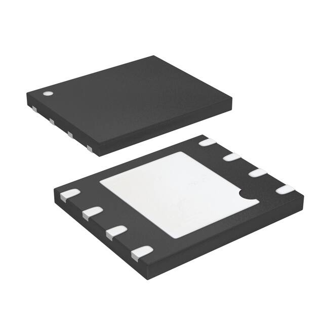

    IC FLASH 1MBIT SPI 66MHZ 8UDFN
AT45DB011D-MH-Y 数据手册
Features • Single 2.7V to 3.6V Supply • RapidS Serial Interface: 66 MHz Maximum Clock Frequency – SPI Compatible Modes 0 and 3 • User Configurable Page Size • • • • • • • • • • • • • – 256 Bytes per Page – 264 Bytes per Page – Page Size Can Be Factory Pre-configured for 256 Bytes Page Program Operation – Intelligent Programming Operation – 512 Pages (256/264 Bytes/Page) Main Memory Flexible Erase Options – Page Erase (256 Bytes) – Block Erase (2 Kbytes) – Sector Erase (32 Kbytes) – Chip Erase (1 Mbits) One SRAM Data Buffer (256/264 Bytes) Continuous Read Capability through Entire Array – Ideal for Code Shadowing Applications Low-power Dissipation – 7 mA Active Read Current Typical – 25 µA Standby Current Typical – 15 µA Deep Power-down Typical Hardware and Software Data Protection Features – Individual Sector Sector Lockdown for Secure Code and Data Storage – Individual Sector Security: 128-byte Security Register – 64-byte User Programmable Space – Unique 64-byte Device Identifier JEDEC Standard Manufacturer and Device ID Read 100,000 Program/Erase Cycles Per Page Minimum Data Retention – 20 Years Industrial Temperature Range Green (Pb/Halide-free/RoHS Compliant) Packaging Options 1-megabit 2.7-volt Minimum DataFlash® AT45DB011D 1. Description The AT45DB011D is a 2.7V, serial-interface Flash memory ideally suited for a wide variety of digital voice-, image-, program code- and data-storage applications. The AT45DB011D supports RapidS serial interface for applications requiring very high speed operations. RapidS serial interface is SPI compatible for frequencies up to 66 MHz. Its 1,081,344 bits of memory are organized as 512 pages of 256 bytes or 264 bytes each. In addition to the main memory, the AT45DB011D also contains one SRAM buffer of 256/264 bytes. EEPROM emulation (bit or byte alterability) is easily handled with a self-contained three step read-modify-write operation. Unlike conventional Flash memories that are accessed randomly with multiple address lines and a parallel interface, the DataFlash ® uses a RapidS serial interface to sequentially access its data. The simple sequential access dramatically reduces active pin count, facilitates hardware layout, increases system reliability, minimizes switching noise, and reduces package size. 3639H–DFLASH–04/09 The device is optimized for use in many commercial and industrial applications where high-density, low-pin count, low-voltage and low-power are essential. To allow for simple in-system reprogrammability, the AT45DB011D does not require high input voltages for programming. The device operates from a single power supply, 2.7V to 3.6V, for both the program and read operations. The AT45DB011D is enabled through the chip select pin (CS) and accessed via a three-wire interface consisting of the Serial Input (SI), Serial Output (SO), and the Serial Clock (SCK). All programming and erase cycles are self-timed. 2. Pin Configurations and Pinouts Table 2-1. Symbol CS Pin Configurations Name and Function Chip Select: Asserting the CS pin selects the device. When the CS pin is deasserted, the device will be deselected and normally be placed in the standby mode (not Deep Power-Down mode), and the output pin (SO) will be in a high-impedance state. When the device is deselected, data will not be accepted on the input pin (SI). A high-to-low transition on the CS pin is required to start an operation, and a low-to-high transition is required to end an operation. When ending an internally self-timed operation such as a program or erase cycle, the device will not enter the standby mode until the completion of the operation. Asserted State Type Low Input SCK Serial Clock: This pin is used to provide a clock to the device and is used to control the flow of data to and from the device. Command, address, and input data present on the SI pin is always latched on the rising edge of SCK, while output data on the SO pin is always clocked out on the falling edge of SCK. – Input SI Serial Input: The SI pin is used to shift data into the device. The SI pin is used for all data input including command and address sequences. Data on the SI pin is always latched on the rising edge of SCK. – Input SO Serial Output: The SO pin is used to shift data out from the device. Data on the SO pin is always clocked out on the falling edge of SCK. – Output Low Input Low Input – Power – Ground Write Protect: When the WP pin is asserted, all sectors specified for protection by the Sector Protection Register will be protected against program and erase operations regardless of whether the Enable Sector Protection command has been issued or not. The WP pin functions independently of the software controlled protection method. After the WP pin goes low, the content of the Sector Protection Register cannot be modified. WP If a program or erase command is issued to the device while the WP pin is asserted, the device will simply ignore the command and perform no operation. The device will return to the idle state once the CS pin has been deasserted. The Enable Sector Protection command and Sector Lockdown command, however, will be recognized by the device when the WP pin is asserted. The WP pin is internally pulled-high and may be left floating if hardware controlled protection will not be used. However, it is recommended that the WP pin also be externally connected to VCC whenever possible. RESET VCC GND 2 Reset: A low state on the reset pin (RESET) will terminate the operation in progress and reset the internal state machine to an idle state. The device will remain in the reset condition as long as a low level is present on the RESET pin. Normal operation can resume once the RESET pin is brought back to a high level. The device incorporates an internal power-on reset circuit, so there are no restrictions on the RESET pin during power-on sequences. If this pin and feature are not utilized it is recommended that the RESET pin be driven high externally. Device Power Supply: The VCC pin is used to supply the source voltage to the device. Operations at invalid VCC voltages may produce spurious results and should not be attempted. Ground: The ground reference for the power supply. GND should be connected to the system ground. AT45DB011D 3639H–DFLASH–04/09 AT45DB011D Figure 2-1. SOIC Top View SI SCK RESET CS Note: 1 2 3 4 Figure 2-2. 8 7 6 5 UDFN Top View(1) SI SCK RESET CS SO GND VCC WP 1 8 2 7 3 6 4 5 SO GND VCC WP 1. The metal pad on the bottom of the UDFN package is floating. This pad can be a “No Connect” or connected to GND. 3. Block Diagram FLASH MEMORY ARRAY WP PAGE (256/264 BYTES) BUFFER (256/264 BYTES) SCK CS RESET VCC GND I/O INTERFACE SI SO 3 3639H–DFLASH–04/09 4. Memory Array To provide optimal flexibility, the memory array of the AT45DB011D is divided into three levels of granularity comprising of sectors, blocks, and pages. The “Memory Architecture Diagram” illustrates the breakdown of each level and details the number of pages per sector and block. All program operations to the DataFlash occur on a page-by-page basis. The erase operations can be performed at the chip, sector, block or page level. Memory Architecture Diagram SECTOR ARCHITECTURE BLOCK ARCHITECTURE SECTOR 0a SECTOR 0a = 8 Pages 2,048/2,112 bytes BLOCK 0 SECTOR 0b BLOCK 1 SECTOR 0b = 120 Pages 31,744/32,726 bytes BLOCK 2 PAGE ARCHITECTURE 8 Pages PAGE 0 BLOCK 0 Figure 4-1. PAGE 8 SECTOR 1 SECTOR 1 = 128 Pages 32,768/33,792 bytes SECTOR 2 = 128 Pages 32,768/33,792 bytes BLOCK 1 BLOCK 15 BLOCK 17 PAGE 6 PAGE 7 BLOCK 14 BLOCK 16 PAGE 1 PAGE 9 PAGE 14 PAGE 15 BLOCK 30 PAGE 16 BLOCK 31 PAGE 17 BLOCK 32 PAGE 18 BLOCK 33 SECTOR 3 = 128 Pages 32,768/33,792 bytes BLOCK 62 BLOCK 63 Block = 2,048/2,112 bytes PAGE 510 PAGE 511 Page = 256/264 bytes 5. Device Operation The device operation is controlled by instructions from the host processor. The list of instructions and their associated opcodes are contained in Tables 15-1 through 15-7. A valid instruction starts with the falling edge of CS followed by the appropriate 8-bit opcode and the desired buffer or main memory address location. While the CS pin is low, toggling the SCK pin controls the loading of the opcode and the desired buffer or main memory address location through the SI (serial input) pin. All instructions, addresses, and data are transferred with the most significant bit (MSB) first. Buffer addressing for the DataFlash standard page size (264 bytes) is referenced in the datasheet using the terminology BFA8 - BFA0 to denote the 9 address bits required to designate a byte address within a buffer. Main memory addressing is referenced using the terminology PA8 - PA0 and BA8 - BA0, where PA8 - PA0 denotes the 9 address bits required to designate a page address and BA8 - BA0 denotes the 9 address bits required to designate a byte address within the page. For the “Power of 2” binary page size (256 bytes), the Buffer addressing is referenced in the datasheet using the conventional terminology BFA7 - BFA0 to denote the 8 address bits required to designate a byte address within a buffer. Main memory addressing is referenced using the terminology A16 - A0, where A16 - A8 denotes the 9 address bits required to designate a page address and A7 - A0 denotes the 8 address bits required to designate a byte address within a page. 4 AT45DB011D 3639H–DFLASH–04/09 AT45DB011D 6. Read Commands By specifying the appropriate opcode, data can be read from the main memory or from the SRAM data buffer. The DataFlash supports RapidS protocols for Mode 0 and Mode 3. Please refer to the “Detailed Bit-level Read Timing” diagrams in this datasheet for details on the clock cycle sequences for each mode. 6.1 Continuous Array Read (Legacy Command – E8H): Up to 66 MHz By supplying an initial starting address for the main memory array, the Continuous Array Read command can be utilized to sequentially read a continuous stream of data from the device by simply providing a clock signal; no additional addressing information or control signals need to be provided. The DataFlash incorporates an internal address counter that will automatically increment on every clock cycle, allowing one continuous read operation without the need of additional address sequences. To perform a continuous read from the DataFlash standard page size (264 bytes), an opcode of E8H must be clocked into the device followed by three address bytes (which comprise the 24-bit page and byte address sequence) and 4 don’t care bytes. The first 9 bits (PA8 - PA0) of the 18-bit address sequence specify which page of the main memory array to read, and the last 9 bits (BA8 - BA0) of the 18-bit address sequence specify the starting byte address within the page. To perform a continuous read from the binary page size (256 bytes), the opcode (E8H) must be clocked into the device followed by three address bytes and 4 don’t care bytes. The first 9 bits (A16 - A8) of the 17-bits sequence specify which page of the main memory array to read, and the last 8 bits (A7 - A0) of the 18-bits address sequence specify the starting byte address within the page. The don’t care bytes that follow the address bytes are needed to initialize the read operation. Following the don’t care bytes, additional clock pulses on the SCK pin will result in data being output on the SO (serial output) pin. The CS pin must remain low during the loading of the opcode, the address bytes, the don’t care bytes, and the reading of data. When the end of a page in main memory is reached during a Continuous Array Read, the device will continue reading at the beginning of the next page with no delays incurred during the page boundary crossover (the crossover from the end of one page to the beginning of the next page). When the last bit in the main memory array has been read, the device will continue reading back at the beginning of the first page of memory. As with crossing over page boundaries, no delays will be incurred when wrapping around from the end of the array to the beginning of the array. A low-to-high transition on the CS pin will terminate the read operation and tri-state the output pin (SO). The maximum SCK frequency allowable for the Continuous Array Read is defined by the fCAR1 specification. The Continuous Array Read bypasses the data buffer and leaves the contents of the buffer unchanged. 6.2 Continuous Array Read (High Frequency Mode – 0BH): Up to 66 MHz This command can be used with the serial interface to read the main memory array sequentially in high speed mode for any clock frequency up to the maximum specified by fCAR1. To perform a continuous read array with the page size set to 264 bytes, the CS must first be asserted then an opcode 0BH must be clocked into the device followed by three address bytes and a dummy byte. The first 9 bits (PA8 - PA0) of the 18-bit address sequence specify which page of the main memory array to read, and the last 9 bits (BA8 - BA0) of the 18-bit address sequence specify the starting byte address within the page. To perform a continuous read with the page size set to 256 bytes, the opcode, 0BH, must be clocked into the device followed by three address bytes (A16 - A0) and a dummy byte. Following the dummy byte, additional clock pulses on the SCK pin will result in data being output on the SO (serial output) pin. 5 3639H–DFLASH–04/09 The CS pin must remain low during the loading of the opcode, the address bytes, and the reading of data. When the end of a page in the main memory is reached during a Continuous Array Read, the device will continue reading at the beginning of the next page with no delays incurred during the page boundary crossover (the crossover from the end of one page to the beginning of the next page). When the last bit in the main memory array has been read, the device will continue reading back at the beginning of the first page of memory. As with crossing over page boundaries, no delays will be incurred when wrapping around from the end of the array to the beginning of the array. A low-to-high transition on the CS pin will terminate the read operation and tri-state the output pin (SO). The maximum SCK frequency allowable for the Continuous Array Read is defined by the fCAR1 specification. The Continuous Array Read bypasses the data buffer and leaves the contents of the buffer unchanged. 6.3 Continuous Array Read (Low Frequency Mode: 03H): Up to 33 MHz This command can be used with the serial interface to read the main memory array sequentially without a dummy byte up to maximum frequencies specified by fCAR2. To perform a continuous read array with the page size set to 264 bytes, the CS must first be asserted then an opcode, 03H, must be clocked into the device followed by three address bytes (which comprise the 24-bit page and byte address sequence). The first 9 bits (PA8 - PA0) of the 18-bit address sequence specify which page of the main memory array to read, and the last 9 bits (BA8 - BA0) of the 18-bit address sequence specify the starting byte address within the page. To perform a continuous read with the page size set to 256 bytes, the opcode, 03H, must be clocked into the device followed by three address bytes (A16 - A0). Following the address bytes, additional clock pulses on the SCK pin will result in data being output on the SO (serial output) pin. The CS pin must remain low during the loading of the opcode, the address bytes, and the reading of data. When the end of a page in the main memory is reached during a Continuous Array Read, the device will continue reading at the beginning of the next page with no delays incurred during the page boundary crossover (the crossover from the end of one page to the beginning of the next page). When the last bit in the main memory array has been read, the device will continue reading back at the beginning of the first page of memory. As with crossing over page boundaries, no delays will be incurred when wrapping around from the end of the array to the beginning of the array. A low-to-high transition on the CS pin will terminate the read operation and tri-state the output pin (SO). The Continuous Array Read bypasses the data buffer and leaves the contents of the buffer unchanged. 6.4 Main Memory Page Read A main memory page read allows the user to read data directly from any one of the 2,048 pages in the main memory, bypassing the data buffer and leaving the contents of the buffer unchanged. To start a page read from the DataFlash standard page size (264 bytes), an opcode of D2H must be clocked into the device followed by three address bytes (which comprise the 24-bit page and byte address sequence) and 4 don’t care bytes. The first 9 bits (PA8 - PA0) of the 18-bit address sequence specify the page in main memory to be read, and the last 9 bits (BA8 - BA0) of the 18-bit address sequence specify the starting byte address within that page. To start a page read from the binary page size (256 bytes), the opcode D2H must be clocked into the device followed by three address bytes and 4 don’t care bytes. The first 9 bits (A16 - A8) of the 17-bit sequence specify which page of the main memory array to read, and the last 8 bits (A7 - A0) of the 17-bit address sequence specify the starting byte address within the page. The don’t care bytes that follow the address bytes are sent to initialize the read operation. Following the don’t care bytes, additional pulses on SCK result in data being output on the SO (serial output) pin. The CS pin must remain low during the loading of the opcode, the address bytes, the don’t care bytes, and the reading of data. When the end of a page in main memory is 6 AT45DB011D 3639H–DFLASH–04/09 AT45DB011D reached, the device will continue reading back at the beginning of the same page. A low-to-high transition on the CS pin will terminate the read operation and tri-state the output pin (SO). The maximum SCK frequency allowable for the Main Memory Page Read is defined by the f SCK specification. The Main Memory Page Read bypasses the data buffer and leaves the contents of the buffer unchanged. 6.5 Buffer Read The SRAM data buffer can be accessed independently from the main memory array, and utilizing the Buffer Read Command allows data to be sequentially read directly from the buffer. Two opcodes, D4H or D1H, can be used for the Buffer Read Command. The use of each opcode depends on the maximum SCK frequency that will be used to read data from the buffer. The D4H opcode can be used at any SCK frequency up to the maximum specified by fCAR1. The D1H opcode can be used for lower frequency read operations up to the maximum specified by fCAR2. To perform a buffer read from the DataFlash standard buffer (264 bytes), the opcode must be clocked into the device followed by three address bytes comprised of 15 don’t care bits and 9 buffer address bits (BFA8 - BFA0). To perform a buffer read from the binary buffer (256 bytes), the opcode must be clocked into the device followed by three address bytes comprised of 16 don’t care bits and 8 buffer address bits (BFA7 - BFA0). Following the address bytes, one don’t care byte must be clocked in to initialize the read operation. The CS pin must remain low during the loading of the opcode, the address bytes, the don’t care bytes, and the reading of data. When the end of a buffer is reached, the device will continue reading back at the beginning of the buffer. A low-to-high transition on the CS pin will terminate the read operation and tri-state the output pin (SO). 7. Program and Erase Commands 7.1 Buffer Write Data can be clocked in from the input pin (SI) into the buffer. To load data into the DataFlash standard buffer (264 bytes), a 1-byte opcode, 84H, must be clocked into the device followed by three address bytes comprised of 15 don’t care bits and 9 buffer address bits (BFA8 - BFA0). The 9 buffer address bits specify the first byte in the buffer to be written. To load data into the binary buffers (256 bytes each), a 1-byte opcode, 84H, must be clocked into the device followed by three address bytes comprised of 16 don’t care bits and 8 buffer address bits (BFA7 - BFA0). The 8 buffer address bits specify the first byte in the buffer to be written. After the last address byte has been clocked into the device, data can then be clocked in on subsequent clock cycles. If the end of the data buffer is reached, the device will wrap around back to the beginning of the buffer. Data will continue to be loaded into the buffer until a low-to-high transition is detected on the CS pin. 7.2 Buffer to Main Memory Page Program with Built-in Erase Data written into the buffer can be programmed into the main memory. A 1-byte opcode, 83H, must be clocked into the device. For the DataFlash standard page size (264 bytes), the opcode must be followed by three address bytes consist of 5 don’t care bits, 9 page address bits (PA8 - PA0) that specify the page in the main memory to be written and 9 don’t care bits. To perform a buffer to main memory page program with built-in erase for the binary page size (256 bytes), the opcode 83H must be clocked into the device followed by three address bytes consisting of 7 don’t care bits, 9 page address bits (A16 - A8) that specify the page in the main memory to be written and 8 don’t care bits. When a low-to-high transition occurs on the CS pin, the part 7 3639H–DFLASH–04/09 will first erase the selected page in main memory (the erased state is a logic 1) and then program the data stored in the buffer into the specified page in main memory. Both the erase and the programming of the page are internally self-timed and should take place in a maximum time of tEP. During this time, the status register will indicate that the part is busy. 7.3 Buffer to Main Memory Page Program without Built-in Erase A previously-erased page within main memory can be programmed with the contents of the buffer. A 1-byte opcode, 88H, must be clocked into the device. For the DataFlash standard page size (264 bytes), the opcode must be followed by three address bytes consist of 6 don’t care bits, 9 page address bits (PA8 - PA0) that specify the page in the main memory to be written and 9 don’t care bits. To perform a buffer to main memory page program without built-in erase for the binary page size (256 bytes), the opcode 88H must be clocked into the device followed by three address bytes consisting of 7 don’t care bits, 9 page address bits (A16 - A8) that specify the page in the main memory to be written and 8 don’t care bits. When a low-to-high transition occurs on the CS pin, the part will program the data stored in the buffer into the specified page in the main memory. It is necessary that the page in main memory that is being programmed has been previously erased using one of the erase commands (Page Erase or Block Erase). The programming of the page is internally self-timed and should take place in a maximum time of tP. During this time, the status register will indicate that the part is busy. 7.4 Page Erase The Page Erase command can be used to individually erase any page in the main memory array allowing the Buffer to Main Memory Page Program to be utilized at a later time. To perform a page erase in the DataFlash standard page size (264 bytes), an opcode of 81H must be loaded into the device, followed by three address bytes comprised of 6 don’t care bits, 9 page address bits (PA8 - PA0) that specify the page in the main memory to be erased and 9 don’t care bits. To perform a page erase in the binary page size (256 bytes), the opcode 81H must be loaded into the device, followed by three address bytes consist of 7 don’t care bits, 9 page address bits (A16 - A8) that specify the page in the main memory to be erased and 8 don’t care bits. When a low-to-high transition occurs on the CS pin, the part will erase the selected page (the erased state is a logical 1). The erase operation is internally self-timed and should take place in a maximum time of tPE. During this time, the status register will indicate that the part is busy. 7.5 Block Erase A block of eight pages can be erased at one time. This command is useful when large amounts of data has to be written into the device. This will avoid using multiple Page Erase Commands. To perform a block erase for the DataFlash standard page size (264 bytes), an opcode of 50H must be loaded into the device, followed by three address bytes comprised of 6 don’t care bits, 6 page address bits (PA8 -PA3) and 12 don’t care bits. The 6 page address bits are used to specify which block of eight pages is to be erased. To perform a block erase for the binary page size (256 bytes), the opcode 50H must be loaded into the device, followed by three address bytes consisting of 7 don’t care bits, 6 page address bits (A16 - A11) and 11 don’t care bits. The 6 page address bits are used to specify which block of eight pages is to be erased. When a lowto-high transition occurs on the CS pin, the part will erase the selected block of eight pages. The erase operation is internally self-timed and should take place in a maximum time of tBE. During this time, the status register will indicate that the part is busy. 8 AT45DB011D 3639H–DFLASH–04/09 AT45DB011D Table 7-1. Block Erase Addressing PA8/ A16 PA7/ A15 PA6/ A14 PA5/ A13 PA4/ A12 PA3/ A11 PA2/ A10 PA1/ A9 PA0/ A8 Block 0 0 0 0 0 0 X X X 0 0 0 0 0 0 1 X X X 1 0 0 0 0 1 0 X X X 2 0 0 0 0 1 1 X X X 3 • • • • • • • • • • • • • • • • • • • • • • • • • • • • • • 1 1 1 1 0 0 X X X 60 1 1 1 1 0 1 X X X 61 1 1 1 1 1 0 X X X 62 1 1 1 1 1 1 X X X 63 7.6 Sector Erase The Sector Erase command can be used to individually erase any sector in the main memory. There are 4 sectors and only one sector can be erased at one time. To perform sector 0a or sector 0b erase for the DataFlash standard page size (264 bytes), an opcode of 7CH must be loaded into the device, followed by three address bytes comprised of 5 don’t care bits, 7 page address bits (PA9 - PA3) and 12 don’t care bits. To perform a sector 1-3 erase, the opcode 7CH must be loaded into the device, followed by three address bytes comprised of 6 don’t care bits, 2 page address bits (PA8 - PA7) and 16 don’t care bits. To perform sector 0a or sector 0b erase for the binary page size (256 bytes), an opcode of 7CH must be loaded into the device, followed by three address bytes comprised of 6 don’t care bits and 7 page address bits (A17 - A11) and 11 don’t care bits. To perform a sector 1-3 erase, the opcode 7CH must be loaded into the device, followed by three address bytes comprised of 7 don’t care bit and 2 page address bits (A16 - A15) and 16 don’t care bits. The page address bits are used to specify any valid address location within the sector which is to be erased. When a low-to-high transition occurs on the CS pin, the part will erase the selected sector. The erase operation is internally self-timed and should take place in a maximum time of tSE. During this time, the status register will indicate that the part is busy. 9 3639H–DFLASH–04/09 Table 7-2. Sector Erase Addressing PA8/ A16 PA7/ A15 PA6/ A14 PA5/ A13 PA4/ A12 PA3/ A11 PA2/ A10 PA1/ A9 PA0/ A8 Sector 0 0 0 0 0 0 X X X 0a 0 0 0 0 0 1 X X X 0b 0 1 0 0 0 0 0 0 0 1 1 0 X X X X X X X 2 1 1 X X X X X X X 3 7.7 Chip Erase The entire main memory can be erased at one time by using the Chip Erase command. To execute the Chip Erase command, a 4-byte command sequence C7H, 94H, 80H and 9AH must be clocked into the device. Since the entire memory array is to be erased, no address bytes need to be clocked into the device, and any data clocked in after the opcode will be ignored. After the last bit of the opcode sequence has been clocked in, the CS pin can be deasserted to start the erase process. The erase operation is internally self-timed and should take place in a time of tCE. During this time, the Status Register will indicate that the device is busy. The Chip Erase command will not affect sectors that are protected or locked down; the contents of those sectors will remain unchanged. Only those sectors that are not protected or locked down will be erased. The WP pin can be asserted while the device is erasing, but protection will not be activated until the internal erase cycle completes. Command Byte 1 Byte 2 Byte 3 Byte 4 Chip Erase C7H 94H 80H 9AH Figure 7-1. Chip Erase CS SI Opcode Byte 1 Opcode Byte 2 Opcode Byte 3 Opcode Byte 4 Each transition represents 8 bits 10 AT45DB011D 3639H–DFLASH–04/09 AT45DB011D 7.8 Main Memory Page Program Through Buffer This operation is a combination of the Buffer Write and Buffer to Main Memory Page Program with Built-in Erase operations. Data is first clocked into the buffer from the input pin (SI) and then programmed into a specified page in the main memory. To perform a main memory page program through buffer for the DataFlash standard page size (264 bytes), a 1-byte opcode, 82H, must first be clocked into the device, followed by three address bytes. The address bytes are comprised of 6 don’t care bits, 9 page address bits, (PA8 - PA0) that select the page in the main memory where data is to be written, and 9 buffer address bits (BFA8 - BFA0) that select the first byte in the buffer to be written. To perform a main memory page program through buffer for the binary page size (256 bytes), the opcode 82H must be clocked into the device followed by three address bytes consisting of 7 don’t care bits, 9 page address bits (A16 - A8) that specify the page in the main memory to be written, and 8 buffer address bits (BFA7 - BFA0) that selects the first byte in the buffer to be written. After all address bytes are clocked in, the part will take data from the input pins and store it in the specified data buffer. If the end of the buffer is reached, the device will wrap around back to the beginning of the buffer. When there is a low-to-high transition on the CS pin, the part will first erase the selected page in main memory to all 1s and then program the data stored in the buffer into that memory page. Both the erase and the programming of the page are internally self-timed and should take place in a maximum time of tEP. During this time, the status register will indicate that the part is busy. 8. Sector Protection Two protection methods, hardware and software controlled, are provided for protection against inadvertent or erroneous program and erase cycles. The software controlled method relies on the use of software commands to enable and disable sector protection while the hardware controlled method employs the use of the Write Protect (WP) pin. The selection of which sectors that are to be protected or unprotected against program and erase operations is specified in the nonvolatile Sector Protection Register. The status of whether or not sector protection has been enabled or disabled by either the software or the hardware controlled methods can be determined by checking the Status Register. 11 3639H–DFLASH–04/09 8.1 8.1.1 Software Sector Protection Enable Sector Protection Command Sectors specified for protection in the Sector Protection Register can be protected from program and erase operations by issuing the Enable Sector Protection command. To enable the sector protection using the software controlled method, the CS pin must first be asserted as it would be with any other command. Once the CS pin has been asserted, the appropriate 4-byte command sequence must be clocked in via the input pin (SI). After the last bit of the command sequence has been clocked in, the CS pin must be deasserted after which the sector protection will be enabled. Command Enable Sector Protection Figure 8-1. Byte 1 Byte 2 Byte 3 Byte 4 3DH 2AH 7FH A9H Enable Sector Protection CS Opcode Byte 1 SI Opcode Byte 2 Opcode Byte 3 Opcode Byte 4 Each transition represents 8 bits 8.1.2 Disable Sector Protection Command To disable the sector protection using the software controlled method, the CS pin must first be asserted as it would be with any other command. Once the CS pin has been asserted, the appropriate 4-byte sequence for the Disable Sector Protection command must be clocked in via the input pin (SI). After the last bit of the command sequence has been clocked in, the CS pin must be deasserted after which the sector protection will be disabled. The WP pin must be in the deasserted state; otherwise, the Disable Sector Protection command will be ignored. Command Disable Sector Protection Figure 8-2. Byte 1 Byte 2 Byte 3 Byte 4 3DH 2AH 7FH 9AH Disable Sector Protection CS SI Opcode Byte 1 Opcode Byte 2 Opcode Byte 3 Opcode Byte 4 Each transition represents 8 bits 8.1.3 Various Aspects About Software Controlled Protection Software controlled protection is useful in applications in which the WP pin is not or cannot be controlled by a host processor. In such instances, the WP pin may be left floating (the WP pin is internally pulled high) and sector protection can be controlled using the Enable Sector Protection and Disable Sector Protection commands. If the device is power cycled, then the software controlled protection will be disabled. Once the device is powered up, the Enable Sector Protection command should be reissued if sector protection is desired and if the WP pin is not used. 12 AT45DB011D 3639H–DFLASH–04/09 AT45DB011D 9. Hardware Controlled Protection Sectors specified for protection in the Sector Protection Register and the Sector Protection Register itself can be protected from program and erase operations by asserting the WP pin and keeping the pin in its asserted state. The Sector Protection Register and any sector specified for protection cannot be erased or reprogrammed as long as the WP pin is asserted. In order to modify the Sector Protection Register, the WP pin must be deasserted. If the WP pin is permanently connected to GND, then the content of the Sector Protection Register cannot be changed. If the WP pin is deasserted, or permanently connected to VCC, then the content of the Sector Protection Register can be modified. The WP pin will override the software controlled protection method but only for protecting the sectors. For example, if the sectors were not previously protected by the Enable Sector Protection command, then simply asserting the WP pin would enable the sector protection within the maximum specified tWPE time. When the WP pin is deasserted; however, the sector protection would no longer be enabled (after the maximum specified tWPD time) as long as the Enable Sector Protection command was not issued while the WP pin was asserted. If the Enable Sector Protection command was issued before or while the WP pin was asserted, then simply deasserting the WP pin would not disable the sector protection. In this case, the Disable Sector Protection command would need to be issued while the WP pin is deasserted to disable the sector protection. The Disable Sector Protection command is also ignored whenever the WP pin is asserted. A noise filter is incorporated to help protect against spurious noise that may inadvertently assert or deassert the WP pin. The table below details the sector protection status for various scenarios of the WP pin, the Enable Sector Protection command, and the Disable Sector Protection command. Figure 9-1. WP Pin and Protection Status 1 3 2 WP Table 9-1. WP Pin and Protection Status Enable Sector Protection Command Disable Sector Protection Command Sector Protection Status Sector Protection Register High Command Not Issued Previously – Issue Command X Issue Command – Disabled Disabled Enabled Read/Write Read/Write Read/Write Low X X Enabled Read Only High Command Issued During Period 1 or 2 – Issue Command Not Issued Yet Issue Command – Enabled Disabled Enabled Read/Write Read/Write Read/Write Time Period WP Pin 1 2 3 13 3639H–DFLASH–04/09 9.1 Sector Protection Register The nonvolatile Sector Protection Register specifies which sectors are to be protected or unprotected with either the software or hardware controlled protection methods. The Sector Protection Register contains 4 bytes of data, of which byte locations 0 through 3 contain values that specify whether sectors 0 through 3 will be protected or unprotected. The Sector Protection Register is user modifiable and must first be erased before it can be reprogrammed. Table 9-3 illustrates the format of the Sector Protection Register. Table 9-2. Sector Protection Register Sector Number 0 (0a, 0b) Protected 00H Sector 0 (0a, 0b) 0a 0b (Page 0-7) (Page 8-127) Bit 7, 6 Bit 5, 4 Bit 3, 2 Bit 1, 0 Data Value Sectors 0a, 0b Unprotected 00 00 xx xx 0xH Protect Sector 0a 11 00 xx xx CxH Protect Sector 0b (Page 8-127) 00 11 xx xx 3xH Protect Sectors 0a (Page 0-7), 0b (Page 8-127)(1) 11 11 xx xx FxH Note: 14 FFH See Table 9-3 Unprotected Table 9-3. 1 to 3 1. The default value for bytes 0 through 3 when shipped from Atmel® is 00H. x = don’t care. AT45DB011D 3639H–DFLASH–04/09 AT45DB011D 9.1.1 Erase Sector Protection Register Command In order to modify and change the values of the Sector Protection Register, it must first be erased using the Erase Sector Protection Register command. To erase the Sector Protection Register, the CS pin must first be asserted as it would be with any other command. Once the CS pin has been asserted, the appropriate 4-byte opcode sequence must be clocked into the device via the SI pin. The 4-byte opcode sequence must start with 3DH and be followed by 2AH, 7FH, and CFH. After the last bit of the opcode sequence has been clocked in, the CS pin must be deasserted to initiate the internally self-timed erase cycle. The erasing of the Sector Protection Register should take place in a time of tPE, during which time the Status Register will indicate that the device is busy. If the device is powereddown before the completion of the erase cycle, then the contents of the Sector Protection Register cannot be guaranteed. The Sector Protection Register can be erased with the sector protection enabled or disabled. Since the erased state (FFH) of each byte in the Sector Protection Register is used to indicate that a sector is specified for protection, leaving the sector protection enabled during the erasing of the register allows the protection scheme to be more effective in the prevention of accidental programming or erasing of the device. If for some reason an erroneous program or erase command is sent to the device immediately after erasing the Sector Protection Register and before the register can be reprogrammed, then the erroneous program or erase command will not be processed because all sectors would be protected. Command Erase Sector Protection Register Figure 9-2. Byte 1 Byte 2 Byte 3 Byte 4 3DH 2AH 7FH CFH Erase Sector Protection Register CS SI Opcode Byte 1 Opcode Byte 2 Opcode Byte 3 Opcode Byte 4 Each transition represents 8 bits 15 3639H–DFLASH–04/09 9.1.2 Program Sector Protection Register Command Once the Sector Protection Register has been erased, it can be reprogrammed using the Program Sector Protection Register command. To program the Sector Protection Register, the CS pin must first be asserted and the appropriate 4-byte opcode sequence must be clocked into the device via the SI pin. The 4-byte opcode sequence must start with 3DH and be followed by 2AH, 7FH, and FCH. After the last bit of the opcode sequence has been clocked into the device, the data for the contents of the Sector Protection Register must be clocked in. As described in Section 9.1, the Sector Protection Register contains 4 bytes of data, so 4 bytes must be clocked into the device. The first byte of data corresponds to sector 0, the second byte corresponds to sector 1, the third byte corresponds to sector 2, and the last byte of data corresponding to sector 3. After the last data byte has been clocked in, the CS pin must be deasserted to initiate the internally self-timed program cycle. The programming of the Sector Protection Register should take place in a time of tP, during which time the Status Register will indicate that the device is busy. If the device is powered-down during the program cycle, then the contents of the Sector Protection Register cannot be guaranteed. If the proper number of data bytes is not clocked in before the CS pin is deasserted, then the protection status of the sectors corresponding to the bytes not clocked in can not be guaranteed. For example, if only the first two bytes are clocked in instead of the complete 4 bytes, then the protection status of the last 2 sectors cannot be guaranteed. Furthermore, if more than 4 bytes of data is clocked into the device, then the data will wrap back around to the beginning of the register. For instance, if 5 bytes of data are clocked in, then the 5th byte will be stored at byte location 0 of the Sector Protection Register. If a value other than 00H or FFH is clocked into a byte location of the Sector Protection Register, then the protection status of the sector corresponding to that byte location cannot be guaranteed. For example, if a value of 17H is clocked into byte location 2 of the Sector Protection Register, then the protection status of sector 2 cannot be guaranteed. The Sector Protection Register can be reprogrammed while the sector protection enabled or disabled. Being able to reprogram the Sector Protection Register with the sector protection enabled allows the user to temporarily disable the sector protection to an individual sector rather than disabling sector protection completely. The Program Sector Protection Register command utilizes the internal SRAM buffer for processing. Therefore, the contents of the buffer will be altered from its previous state when this command is issued. Command Program Sector Protection Register Figure 9-3. Byte 1 Byte 2 Byte 3 Byte 4 3DH 2AH 7FH FCH Program Sector Protection Register CS SI Opcode Byte 1 Opcode Byte 2 Opcode Byte 3 Opcode Byte 4 Data Byte n Data Byte n+1 Data Byte n+3 Each transition represents 8 bits 16 AT45DB011D 3639H–DFLASH–04/09 AT45DB011D 9.1.3 Read Sector Protection Register Command To read the Sector Protection Register, the CS pin must first be asserted. Once the CS pin has been asserted, an opcode of 32H and 3 dummy bytes must be clocked in via the SI pin. After the last bit of the opcode and dummy bytes have been clocked in, any additional clock pulses on the SCK pins will result in data for the content of the Sector Protection Register being output on the SO pin. The first byte corresponds to sector 0 (0a, 0b), the second byte corresponds to sector 1, the third byte corresponds to sector 2, and the last byte (byte 4) corresponds to sector 3. Once the last byte of the Sector Protection Register has been clocked out, any additional clock pulses will result in undefined data being output on the SO pin. The CS must be deasserted to terminate the Read Sector Protection Register operation and put the output into a high-impedance state. Command Read Sector Protection Register Note: Byte 1 Byte 2 Byte 3 Byte 4 32H xxH xxH xxH xx = Dummy Byte Figure 9-4. Read Sector Protection Register CS SI Opcode X X X Data Byte n SO Data Byte n+1 Data Byte n+3 Each transition represents 8 bits 9.1.4 Various Aspects About the Sector Protection Register The Sector Protection Register is subject to a limit of 10,000 erase/program cycles. Users are encouraged to carefully evaluate the number of times the Sector Protection Register will be modified during the course of the applications’ life cycle. If the application requires that the Sector Protection Register be modified more than the specified limit of 10,000 cycles because the application needs to temporarily unprotect individual sectors (sector protection remains enabled while the Sector Protection Register is reprogrammed), then the application will need to limit this practice. Instead, a combination of temporarily unprotecting individual sectors along with disabling sector protection completely will need to be implemented by the application to ensure that the limit of 10,000 cycles is not exceeded. 17 3639H–DFLASH–04/09 10. Security Features 10.1 Sector Lockdown The device incorporates a Sector Lockdown mechanism that allows each individual sector to be permanently locked so that it becomes read only. This is useful for applications that require the ability to permanently protect a number of sectors against malicious attempts at altering program code or security information. Once a sector is locked down, it can never be erased or programmed, and it can never be unlocked. To issue the Sector Lockdown command, the CS pin must first be asserted as it would be for any other command. Once the CS pin has been asserted, the appropriate 4-byte opcode sequence must be clocked into the device in the correct order. The 4-byte opcode sequence must start with 3DH and be followed by 2AH, 7FH, and 30H. After the last byte of the command sequence has been clocked in, then three address bytes specifying any address within the sector to be locked down must be clocked into the device. After the last address bit has been clocked in, the CS pin must then be deasserted to initiate the internally self-timed lockdown sequence. The lockdown sequence should take place in a maximum time of tP, during which time the Status Register will indicate that the device is busy. If the device is powered-down before the completion of the lockdown sequence, then the lockdown status of the sector cannot be guaranteed. In this case, it is recommended that the user read the Sector Lockdown Register to determine the status of the appropriate sector lockdown bits or bytes and reissue the Sector Lockdown command if necessary. Command Sector Lockdown Byte 1 Byte 2 Byte 3 Byte 4 3DH 2AH 7FH 30H Figure 10-1. Sector Lockdown CS Opcode Byte 1 SI Opcode Byte 2 Opcode Byte 3 Opcode Byte 4 Address Bytes Address Bytes Address Bytes Each transition represents 8 bits 18 AT45DB011D 3639H–DFLASH–04/09 AT45DB011D 10.1.1 Sector Lockdown Register Sector Lockdown Register is a nonvolatile register that contains 4 bytes of data, as shown below: Sector Number 0 (0a, 0b) Locked FFH See Below Unlocked Table 10-1. 10.1.2 1 to 3 00H Sector 0 (0a, 0b) 0a 0b (Page 0-7) (Page 8-127) Bit 7, 6 Bit 5, 4 Bit 3, 2 Bit 1, 0 Data Value Sectors 0a, 0b Unlocked 00 00 00 00 00H Sector 0a Locked (Page 0-7) 11 00 00 00 C0H Sector 0b Locked (Page 8-127) 00 11 00 00 30H Sectors 0a, 0b Locked (Page 0-127) 11 11 00 00 F0H Reading the Sector Lockdown Register The Sector Lockdown Register can be read to determine which sectors in the memory array are permanently locked down. To read the Sector Lockdown Register, the CS pin must first be asserted. Once the CS pin has been asserted, an opcode of 35H and 3 dummy bytes must be clocked into the device via the SI pin. After the last bit of the opcode and dummy bytes have been clocked in, the data for the contents of the Sector Lockdown Register will be clocked out on the SO pin. The first byte corresponds to sector 0 (0a, 0b) the second byte corresponds to sector 1 and the last byte (byte 4) corresponds to sector 3. After the last byte of the Sector Lockdown Register has been read, additional pulses on the SCK pin will simply result in undefined data being output on the SO pin. Deasserting the CS pin will terminate the Read Sector Lockdown Register operation and put the SO pin into a high-impedance state. Table 10-2 details the values read from the Sector Lockdown Register. Table 10-2. Sector Lockdown Register Command Read Sector Lockdown Register Note: Byte 1 Byte 2 Byte 3 Byte 4 35H xxH xxH xxH xx = Dummy Byte Figure 10-2. Read Sector Lockdown Register CS SI Opcode X X X Data Byte n SO Data Byte n+1 Data Byte n+3 Each transition represents 8 bits 19 3639H–DFLASH–04/09 10.2 Security Register The device contains a specialized Security Register that can be used for purposes such as unique device serialization or locked key storage. The register is comprised of a total of 128 bytes that is divided into two portions. The first 64 bytes (byte locations 0 through 63) of the Security Register are allocated as a one-time user programmable space. Once these 64 bytes have been programmed, they cannot be reprogrammed. The remaining 64 bytes of the register (byte locations 64 through 127) are factory programmed by Atmel and will contain a unique value for each device. The factory programmed data is fixed and cannot be changed. Table 10-3. Security Register Security Register Byte Number 0 Data Type 10.2.1 1 ••• 62 63 One-time User Programmable 64 65 ••• 126 127 Factory Programmed By Atmel Programming the Security Register The user programmable portion of the Security Register does not need to be erased before it is programmed. To program the Security Register, the CS pin must first be asserted and the appropriate 4-byte opcode sequence must be clocked into the device in the correct order. The 4-byte opcode sequence must start with 9BH and be followed by 00H, 00H, and 00H. After the last bit of the opcode sequence has been clocked into the device, the data for the contents of the 64-byte user programmable portion of the Security Register must be clocked in. After the last data byte has been clocked in, the CS pin must be deasserted to initiate the internally self-timed program cycle. The programming of the Security Register should take place in a time of tP, during which time the Status Register will indicate that the device is busy. If the device is powered-down during the program cycle, then the contents of the 64-byte user programmable portion of the Security Register cannot be guaranteed. If the full 64 bytes of data is not clocked in before the CS pin is deasserted, then the values of the byte locations not clocked in cannot be guaranteed. For example, if only the first two bytes are clocked in instead of the complete 64 bytes, then the remaining 62 bytes of the user programmable portion of the Security Register cannot be guaranteed. Furthermore, if more than 64 bytes of data is clocked into the device, then the data will wrap back around to the beginning of the register. For instance, if 65 bytes of data are clocked in, then the 65th byte will be stored at byte location 0 of the Security Register. The user programmable portion of the Security Register can only be programmed one time. Therefore, it is not possible to only program the first two bytes of the register and then program the remaining 62 bytes at a later time. The Program Security Register command utilizes the internal SRAM buffer for processing. Therefore, the contents of the buffer will be altered from its previous state when this command is issued. Figure 10-3. Program Security Register CS SI Opcode Byte 1 Opcode Byte 2 Opcode Byte 3 Opcode Byte 4 Data Byte n Data Byte n+1 Data Byte n+x Each transition represents 8 bits 20 AT45DB011D 3639H–DFLASH–04/09 AT45DB011D 10.2.2 Reading the Security Register The Security Register can be read by first asserting the CS pin and then clocking in an opcode of 77H followed by three dummy bytes. After the last don’t care bit has been clocked in, the content of the Security Register can be clocked out on the SO pins. After the last byte of the Security Register has been read, additional pulses on the SCK pin will simply result in undefined data being output on the SO pins. Deasserting the CS pin will terminate the Read Security Register operation and put the SO pins into a high-impedance state. Figure 10-4. Read Security Register CS SI Opcode X X X Data Byte n SO Data Byte n+1 Data Byte n+x Each transition represents 8 bits 11. Additional Commands 11.1 Main Memory Page to Buffer Transfer A page of data can be transferred from the main memory to the buffer. To start the operation for the DataFlash standard page size (264 bytes), a 1-byte opcode, 53H, must be clocked into the device, followed by three address bytes comprised of 6 don’t care bits, 9 page address bits (PA8 - PA0), which specify the page in main memory that is to be transferred, and 9 don’t care bits. To perform a main memory page to buffer transfer for the binary page size (256 bytes), the opcode 53H must be clocked into the device followed by three address bytes consisting of 7 don’t care bits, 9 page address bits (A16 - A8) which specify the page in the main memory that is to be transferred, and 8 don’t care bits. The CS pin must be low while toggling the SCK pin to load the opcode and the address bytes from the input pin (SI). The transfer of the page of data from the main memory to the buffer will begin when the CS pin transitions from a low to a high state. During the transfer of a page of data (tXFR), the status register can be read to determine whether the transfer has been completed. 11.2 Main Memory Page to Buffer Compare A page of data in main memory can be compared to the data in the buffer. To initiate the operation for the DataFlash standard page size, a 1-byte opcode, 60H, must be clocked into the device, followed by three address bytes consisting of 6 don’t care bits, 9 page address bits (PA8 - PA0) that specify the page in the main memory that is to be compared to the buffer, and 9 don’t care bits. To start a main memory page to buffer compare for a binary page size, the opcode 60H must be clocked into the device followed by three address bytes consisting of 6 don’t care bits, 9 page address bits (A16 - A8) that specify the page in the main memory that is to be compared to the buffer, and 8 don’t care bits. The CS pin must be low while toggling the SCK pin to load the opcode and the address bytes from the input pin (SI). On the low-to-high transition of the CS pin, the data bytes in the selected main memory page will be compared with 21 3639H–DFLASH–04/09 the data bytes in the buffer. During this time (tCOMP), the status register will indicate that the part is busy. On completion of the compare operation, bit 6 of the status register is updated with the result of the compare. 11.3 Auto Page Rewrite This mode is only needed if multiple bytes within a page or multiple pages of data are modified in a random fashion within a sector. This mode is a combination of two operations: Main Memory Page to Buffer Transfer and Buffer to Main Memory Page Program with Built-in Erase. A page of data is first transferred from the main memory to the buffer and then the same data (from the buffer) is programmed back into its original page of main memory. To start the rewrite operation for the DataFlash standard page size (264 bytes), a 1-byte opcode, 58H, must be clocked into the device, followed by three address bytes comprised of 6 don’t care bits, 9 page address bits (PA8 - PA0) that specify the page in main memory to be rewritten and 9 don’t care bits. To initiate an auto page rewrite for a binary page size (256 bytes), the opcode 58H must be clocked into the device followed by three address bytes consisting of 7 don’t care bits, 9 page address bits (A16 - A8) that specify the page in the main memory that is to be written and 8 don’t care bits. When a low-to-high transition occurs on the CS pin, the part will first transfer data from the page in main memory to a buffer and then program the data from the buffer back into same page of main memory. The operation is internally self-timed and should take place in a maximum time of tEP. During this time, the status register will indicate that the part is busy. If a sector is programmed or reprogrammed sequentially page by page, then the programming algorithm shown in Figure 25-1 (page 45) is recommended. Otherwise, if multiple bytes in a page or several pages are programmed randomly in a sector, then the programming algorithm shown in Figure 25-2 (page 46) is recommended. Each page within a sector must be updated/rewritten at least once within every 10,000 cumulative page erase/program operations in that sector. 11.4 Status Register Read The status register can be used to determine the device’s ready/busy status, page size, a Main Memory Page to Buffer Compare operation result, the Sector Protection status or the device density. The Status Register can be read at any time, including during an internally self-timed program or erase operation. To read the status register, the CS pin must be asserted and the opcode of D7H must be loaded into the device. After the opcode is clocked in, the 1-byte status register will be clocked out on the output pin (SO), starting with the next clock cycle. The data in the status register, starting with the MSB (bit 7), will be clocked out on the SO pin during the next eight clock cycles. After the one byte of the status register has been clocked out, the sequence will repeat itself (as long as CS remains low and SCK is being toggled). The data in the status register is constantly updated, so each repeating sequence will output new data. Ready/busy status is indicated using bit 7 of the status register. If bit 7 is a 1, then the device is not busy and is ready to accept the next command. If bit 7 is a 0, then the device is in a busy state. Since the data in the status register is constantly updated, the user must toggle SCK pin to check the ready/busy status. There are several operations that can cause the device to be in a busy state: Main Memory Page to Buffer Transfer, Main Memory Page to Buffer Compare, Buffer to Main Memory Page Program, Main Memory Page Program through Buffer, Page Erase, Block Erase, Sector Erase, Chip Erase and Auto Page Rewrite. The result of the most recent Main Memory Page to Buffer Compare operation is indicated using bit 6 of the status register. If bit 6 is a 0, then the data in the main memory page matches the 22 AT45DB011D 3639H–DFLASH–04/09 AT45DB011D data in the buffer. If bit 6 is a 1, then at least one bit of the data in the main memory page does not match the data in the buffer. Bit 1 in the Status Register is used to provide information to the user whether or not the sector protection has been enabled or disabled, either by software-controlled method or hardware-controlled method. A logic 1 indicates that sector protection has been enabled and logic 0 indicates that sector protection has been disabled. Bit 0 in the Status Register indicates whether the page size of the main memory array is configured for “power of 2” binary page size (256 bytes) or the DataFlash standard page size (264 bytes). If bit 0 is a 1, then the page size is set to 256 bytes. If bit 0 is a 0, then the page size is set to 264 bytes. The device density is indicated using bits 5, 4, 3, and 2 of the status register. For the AT45DB011D, the four bits are 0011 The decimal value of these four binary bits does not equate to the device density; the four bits represent a combinational code relating to differing densities of DataFlash devices. The device density is not the same as the density code indicated in the JEDEC device ID information. The device density is provided only for backward compatibility. Table 11-1. Status Register Format Bit 7 Bit 6 Bit 5 Bit 4 Bit 3 Bit 2 Bit 1 Bit 0 RDY/BUSY COMP 0 0 1 1 PROTECT PAGE SIZE 23 3639H–DFLASH–04/09 12. Deep Power-down After initial power-up, the device will default in standby mode. The Deep Power-down command allows the device to enter into the lowest power consumption mode. To enter the Deep Powerdown mode, the CS pin must first be asserted. Once the CS pin has been asserted, an opcode of B9H command must be clocked in via input pin (SI). After the last bit of the command has been clocked in, the CS pin must be de-asserted to initiate the Deep Power-down operation. After the CS pin is de-asserted, the will device enter the Deep Power-down mode within the maximum tEDPD time. Once the device has entered the Deep Power-down mode, all instructions are ignored except for the Resume from Deep Power-down command. Command Opcode Deep Power-down B9H Figure 12-1. Deep Power-down CS SI Opcode Each transition represents 8 bits 12.1 Resume from Deep Power-down The Resume from Deep Power-down command takes the device out of the Deep Power-down mode and returns it to the normal standby mode. To Resume from Deep Power-down mode, the CS pin must first be asserted and an opcode of ABH command must be clocked in via input pin (SI). After the last bit of the command has been clocked in, the CS pin must be de-asserted to terminate the Deep Power-down mode. After the CS pin is de-asserted, the device will return to the normal standby mode within the maximum tRDPD time. The CS pin must remain high during the tRDPD time before the device can receive any commands. After resuming form Deep Powerdown, the device will return to the normal standby mode. Command Opcode Resume from Deep Power-down ABH Figure 12-2. Resume from Deep Power-Down CS SI Opcode Each transition represents 8 bits 24 AT45DB011D 3639H–DFLASH–04/09 AT45DB011D 13. “Power of 2” Binary Page Size Option “Power of 2” binary page size Configuration Register is a user-programmable nonvolatile register that allows the page size of the main memory to be configured for binary page size (256 bytes) or the DataFlash standard page size (264 bytes). The “power of 2” page size is a One-time Programmable (OTP) register and once the device is configured for “power of 2” page size, it cannot be reconfigured again. The devices are initially shipped with the page size set to 264 bytes. The user has the option of ordering binary page size (256 bytes) devices from the factory. For details, please refer to Section 26. ”Ordering Information” on page 47. For the binary “power of 2” page size to become effective, the following steps must be followed: 1. Program the one-time programmable configuration resister using opcode sequence 3DH, 2AH, 80H and A6H (please see Section 13.1). 2. Power cycle the device (i.e. power down and power up again). 3. The page for the binary page size can now be programmed. If the above steps are not followed to set the page size prior to page programming, incorrect data during a read operation may be encountered. 13.1 Programming the Configuration Register To program the Configuration Register for “power of 2” binary page size, the CS pin must first be asserted as it would be with any other command. Once the CS pin has been asserted, the appropriate 4-byte opcode sequence must be clocked into the device in the correct order. The 4-byte opcode sequence must start with 3DH and be followed by 2AH, 80H, and A6H. After the last bit of the opcode sequence has been clocked in, the CS pin must be deasserted to initiate the internally self-timed program cycle. The programming of the Configuration Register should take place in a time of tP, during which time the Status Register will indicate that the device is busy. The device must be power-cycled after the completion of the program cycle to set the “power of 2” page size. If the device is powered-down before the completion of the program cycle, then setting the Configuration Register cannot be guaranteed. However, the user should check bit 0 of the status register to see whether the page size was configured for binary page size. If not, the command can be re-issued again. Command Power of Two Page Size Byte 1 Byte 2 Byte 3 Byte 4 3DH 2AH 80H A6H Figure 13-1. Erase Sector Protection Register CS Opcode Byte 1 SI Opcode Byte 2 Opcode Byte 3 Opcode Byte 4 Each transition represents 8 bits 14. Manufacturer and Device ID Read Identification information can be read from the device to enable systems to electronically query and identify the device while it is in system. The identification method and the command opcode comply with the JEDEC standard for “Manufacturer and Device ID Read Methodology for SPI Compatible Serial Interface Memory Devices”. The type of information that can be read from the device includes the JEDEC defined Manufacturer ID, the vendor specific Device ID, and the vendor specific Extended Device Information. 25 3639H–DFLASH–04/09 To read the identification information, the CS pin must first be asserted and the opcode of 9FH must be clocked into the device. After the opcode has been clocked in, the device will begin outputting the identification data on the SO pin during the subsequent clock cycles. The first byte that will be output will be the Manufacturer ID followed by two bytes of Device ID information. The fourth byte output will be the Extended Device Information String Length, which will be 00H indicating that no Extended Device Information follows. As indicated in the JEDEC standard, reading the Extended Device Information String Length and any subsequent data is optional. Deasserting the CS pin will terminate the Manufacturer and Device ID Read operation and put the SO pin into a high-impedance state. The CS pin can be deasserted at any time and does not require that a full byte of data be read. 14.1 14.1.1 Manufacturer and Device ID Information Byte 1 – Manufacturer ID JEDEC Assigned Code Hex Value Bit 7 Bit 6 Bit 5 Bit 4 Bit 3 Bit 2 Bit 1 Bit 0 1FH 0 0 0 1 1 1 1 1 14.1.2 Manufacturer ID Byte 2 – Device ID (Part 1) Family Code Density Code Hex Value Bit 7 Bit 6 Bit 5 Bit 4 Bit 3 Bit 2 Bit 1 Bit 0 Family Code 22H 0 0 1 0 0 0 1 0 Density Code 14.1.3 001 = DataFlash 00010 = 1-Mbit Byte 3 – Device ID (Part 2) MLC Code Product Version Code Hex Value Bit 7 Bit 6 Bit 5 Bit 4 Bit 3 Bit 2 Bit 1 Bit 0 00H 0 0 0 0 0 0 0 0 14.1.4 1FH = Atmel MLC Code 000 = 1-bit/Cell Technology Product Version 00000 = Initial Version Byte Count 00H = 0 Bytes of Information Byte 4 – Extended Device Information String Length Byte Count Hex Value Bit 7 Bit 6 Bit 5 Bit 4 Bit 3 Bit 2 Bit 1 Bit 0 00H 0 0 0 0 0 0 0 0 CS SI 9FH Opcode SO 1FH 22H 00H 00H Data Data Manufacturer ID Byte n Device ID Byte 1 Device ID Byte 2 Extended Device Information String Length Extended Device Information Byte x Extended Device Information Byte x + 1 Each transition represents 8 bits Note: 26 This information would only be output if the Extended Device Information String Length value was something other than 00H. Based on JEDEC publication 106 (JEP106), Manufacturer ID data can be comprised of any number of bytes. Some manufacturers may have Manufacturer ID codes that are two, three or even four bytes long with the first byte(s) in the sequence being 7FH. A system should detect code 7FH as a “Continuation Code” and continue to read Manufacturer ID bytes. The first non-7FH byte would signify the last byte of Manufacturer ID data. For Atmel (and some other manufacturers), the Manufacturer ID data is comprised of only one byte. AT45DB011D 3639H–DFLASH–04/09 AT45DB011D 14.2 Operation Mode Summary The commands described previously can be grouped into four different categories to better describe which commands can be executed at what times. Group A commands consist of: 1. Main Memory Page Read 2. Continuous Array Read 3. Read Sector Protection Register 4. Read Sector Lockdown Register 5. Read Security Register Group B commands consist of: 1. Page Erase 2. Block Erase 3. Sector Erase 4. Chip Erase 5. Main Memory Page to Buffer Transfer 6. Main Memory Page to Buffer Compare 7. Buffer to Main Memory Page Program with Built-in Erase 8. Buffer to Main Memory Page Program without Built-in Erase 9. Main Memory Page Program through Buffer 10. Auto Page Rewrite Group C commands consist of: 1. Buffer Read 2. Buffer Write 3. Status Register Read 4. Manufacturer and Device ID Read Group D commands consist of: 1. Erase Sector Protection Register 2. Program Sector Protection Register 3. Sector Lockdown 4. Program Security Register If a Group A command is in progress (not fully completed), then another command in Group A, B, C, or D should not be started. However, during the internally self-timed portion of Group B commands 1 through 4, any command in Group C can be executed. During the internally selftimed portion of Group B commands 5 through 10, only Group C commands 3 and 4 can be executed. Finally, during the internally self-timed portion of a Group D command, only the Status Register Read command should be executed. 27 3639H–DFLASH–04/09 15. Command Tables Table 15-1. Read Commands Command Opcode Main Memory Page Read D2H Continuous Array Read (Legacy Command) E8H Continuous Array Read (Low Frequency) 03H Continuous Array Read (High Frequency) 0BH Buffer Read (Low Frequency) D1H Buffer Read D4H Table 15-2. Program and Erase Commands Command Opcode Buffer Write 84H Buffer to Main Memory Page Program with Built-in Erase 83H Buffer to Main Memory Page Program without Built-in Erase 88H Page Erase 81H Block Erase 50H Sector Erase 7CH Chip Erase Main Memory Page Program through Buffer 28 7CH, 94H, 80H, 9AH 82H AT45DB011D 3639H–DFLASH–04/09 AT45DB011D Table 15-3. Protection and Security Commands Command Opcode Enable Sector Protection 3DH + 2AH + 7FH + A9H Disable Sector Protection 3DH + 2AH + 7FH + 9AH Erase Sector Protection Register 3DH + 2AH + 7FH + CFH Program Sector Protection Register 3DH + 2AH + 7FH + FCH Read Sector Protection Register Sector Lockdown 32H 3DH + 2AH + 7FH + 30H Read Sector Lockdown Register Program Security Register 35H 9BH + 00H + 00H + 00H Read Security Register Table 15-4. 77H Additional Commands Command Opcode Main Memory Page to Buffer Transfer 53H Main Memory Page to Buffer Compare 60H Auto Page Rewrite through Buffer 58H Deep Power-down B9H Resume from Deep Power-down ABH Status Register Read D7H Manufacturer and Device ID Read 9FH Table 15-5. Legacy Commands(1) Command Opcode Buffer Read 54H Main Memory Page Read 52H Continuous Array Read 68H Status Register Read 57H Note: 1. These legacy commands are not recommended for new designs. 29 3639H–DFLASH–04/09 Table 15-6. Detailed Bit-level Addressing Sequence for Binary Page Size (256 Bytes) A14 A13 A12 A11 A10 A9 A8 A7 A6 A5 A4 A3 A2 A1 A0 1 A15 1 A16 0 Reserved 0 Reserved 0 Reserved 0 Reserved 0 Additional Don’t Care Bytes x x x x x x x A A A A A A A A A A A A A A A A A N/A 0Bh 0 0 0 0 1 0 1 1 x x x x x x x A A A A A A A A A A A A A A A A A 1 50h 0 1 0 1 0 0 0 0 x x x x x x x A A A A A x x x x x x x x x x x x N/A 53h 0 1 0 1 0 0 1 1 x x x x x x x A A A A A A A A A x x x x x x x x N/A 58h 0 1 0 1 1 0 0 0 x x x x x x x A A A A A A A A A x x x x x x x x N/A 60h 0 1 1 0 0 0 0 0 x x x x x x x A A A A A A A A A x x x x x x x x N/A 77h 0 1 1 1 0 1 1 1 x x x x x x x x x x x x x x x x x x x x x x x x N/A 7Ch 0 1 1 1 1 1 0 0 x x x x x x x x x x x x x x x x x x x x x x x x N/A 81h 1 0 0 0 0 0 0 1 x x x x x x x A A A A A A A A A x x x x x x x x N/A 82h 1 0 0 0 0 0 1 0 x x x x x x x A A A A A A A A A A A A A A A A A N/A 83h 1 0 0 0 0 0 1 1 x x x x x x x A A A A A A A A A x x x x x x x x N/A 84h 1 0 0 0 0 1 0 0 x x x x x x x x x x x x x x x x A A A A A A A A N/A 88h 1 0 0 0 1 0 0 0 x x x x x x x A A A A A A A A A x x x x x x x x N/A 9Fh 1 0 0 1 1 1 1 1 N/A N/A N/A N/A B9h 1 0 1 1 1 0 0 1 N/A N/A N/A N/A ABh 1 0 1 0 1 0 1 1 D1h 1 1 0 1 0 0 0 1 x x x x x x x x x x x x x x x x D2h 1 1 0 1 0 0 1 0 x x x x x x x A A A A A A A A D4h 1 1 0 1 0 1 0 0 x x x x x x x x x x x x x x x D7h 1 1 0 1 0 1 1 1 E8h 1 1 1 0 1 0 0 0 x x x x x x A A A A A A A Note: 30 Opcode 0 Address Byte Reserved 03h Address Byte Reserved Opcode Address Byte Reserved Page Size = 256 bytes N/A N/A N/A x N/A A A A A A A A N/A A A A A A A A A A 4 x A A A A A A A A 1 A A A A A A A A N/A A N/A A N/A A N/A 4 x = Don’t Care AT45DB011D 3639H–DFLASH–04/09 AT45DB011D Detailed Bit-level Addressing Sequence for Standard DataFlash Page Size (264 Bytes) B B B B B B B BA0 B BA1 P P P P P P P BA2 P BA3 P BA4 x BA5 x BA6 BA7 x PA1 x PA2 x PA3 x PA4 BA8 1 BA0 1 PA6 0 PA7 0 PA8 0 Reserved 0 Reserved 0 Reserved Opcode 0 Address Byte Reserved 03h Address Byte Reserved Opcode Address Byte Reserved Page Size = 264 bytes PA5 Table 15-7. Additional Don’t Care Bytes B N/A 0Bh 0 0 0 0 1 0 1 1 x x x x x x P P P P P P P P P B B B B B B B B B 1 50h 0 1 0 1 0 0 0 0 x x x x x x P P P P P x x x x x x x x x x N/A 53h 0 1 0 1 0 0 1 1 x x x x x x P P P P P P P P P x x x x x x x x x N/A 58h 0 1 0 1 1 0 0 0 x x x x x x P P P P P P P P P x x x x x x x x x N/A 60h 0 1 1 0 0 0 0 0 x x x x x x P P P P P P P P P x x x x x x x x x N/A 77h 0 1 1 1 0 1 1 1 x x x x x x x x x x x x x x x x x x x x x x x x N/A 7Ch 0 1 1 1 1 1 0 0 x x x x x x x x x x x x x x x x x x x x x x x x N/A 81h 1 0 0 0 0 0 0 1 x x x x x x P P P P P P P P P x x x x x x x x x N/A x x x 82h 1 0 0 0 0 0 1 0 x x x x x x P P P P P P P P P B B B B B B B B B N/A 83h 1 0 0 0 0 0 1 1 x x x x x x P P P P P P P P P x x x x N/A 84h 1 0 0 0 0 1 0 0 x x x x x x x x x x B B B B B B B B B N/A 88h 1 0 0 0 1 0 0 0 x x x x x x P P P P P P P P P x x x N/A x x x x x x x x x x x x x x x x 9Fh 1 0 0 1 1 1 1 1 N/A N/A N/A N/A B9h 1 0 1 1 1 0 0 1 N/A N/A N/A N/A ABh 1 0 1 0 1 0 1 1 D1h 1 1 0 1 0 0 0 1 x x x x x x x x x D2h 1 1 0 1 0 0 1 0 x x x x x x P P P P P P P P P B D4h 1 1 0 1 0 1 0 0 x x x x x x x x x x B D7h 1 1 0 1 0 1 1 1 E8h 1 1 1 0 1 0 0 0 x x x x x P P P P P P P P P B B B B B B B B Note: N/A N/A N/A x x x x x x x x x N/A x x x B N/A B B B B B B B N/A B N/A B B B B B B B B 4 B B B B B B B B 1 N/A N/A B 4 P = Page Address Bit B = Byte/Buffer Address Bit x = Don’t Care 31 3639H–DFLASH–04/09 16. Power-on/Reset State When power is first applied to the device, or when recovering from a reset condition, the device will default to Mode 3. In addition, the output pin (SO) will be in a high impedance state, and a high-to-low transition on the CS pin will be required to start a valid instruction. The mode (Mode 3 or Mode 0) will be automatically selected on every falling edge of CS by sampling the inactive clock state. 16.1 Initial Power-up/Reset Timing Restrictions At power up, the device must not be selected until the supply voltage reaches the VCC (min.) and further delay of tVCSL. During power-up, the internal Power-on Reset circuitry keeps the device in reset mode until the VCC rises above the Power-on Reset threshold value (VPOR). At this time, all operations are disabled and the device does not respond to any commands. After power up is applied and the VCC is at the minimum operating voltage VCC (min.), the tVCSL delay is required before the device can be selected in order to perform a read operation. Similarly, the tPUW delay is required after the VCC rises above the Power-on Reset threshold value (VPOR) before the device can perform a write (Program or Erase) operation. After initial power-up, the device will default in Standby mode. Symbol Parameter tVCSL VCC (min.) to Chip Select low tPUW Power-Up Device Delay before Write Allowed VPOR Power-On Reset Voltage Min Typ Max 1 1.5 Units ms 20 ms 2.5 V 17. System Considerations The RapidS serial interface is controlled by the clock SCK, serial input SI and chip select CS pins. These signals must rise and fall monotonically and be free from noise. Excessive noise or ringing on these pins can be misinterpreted as multiple edges and cause improper operation of the device. The PC board traces must be kept to a minimum distance or appropriately terminated to ensure proper operation. If necessary, decoupling capacitors can be added on these pins to provide filtering against noise glitches. As system complexity continues to increase, voltage regulation is becoming more important. A key element of any voltage regulation scheme is its current sourcing capability. Like all Flash memories, the peak current for DataFlash occur during the programming and erase operation. The regulator needs to supply this peak current requirement. An under specified regulator can cause current starvation. Besides increasing system noise, current starvation during programming or erase can lead to improper operation and possible data corruption. 32 AT45DB011D 3639H–DFLASH–04/09 AT45DB011D 18. Electrical Specifications Table 18-1. Absolute Maximum Ratings* Temperature under Bias ................................ -55°C to +125°C *NOTICE: Storage Temperature ..................................... -65°C to +150°C All Input Voltages (except VCC but including NC Pins) with Respect to Ground ...................................-0.6V to +6.25V All Output Voltages with Respect to Ground .............................-0.6V to VCC + 0.6V Table 18-2. Stresses beyond those listed under “Absolute Maximum Ratings” may cause permanent damage to the device. The "Absolute Maximum Ratings" are stress ratings only and functional operation of the device at these or any other conditions beyond those indicated in the operational sections of this specification is not implied. Exposure to absolute maximum rating conditions for extended periods may affect device reliability. Voltage Extremes referenced in the "Absolute Maximum Ratings" are intended to accommodate short duration undershoot/overshoot conditions and does not imply or guarantee functional device operation at these levels for any extended period of time DC and AC Operating Range AT45DB011D Operating Temperature (Case) Ind. -40°C to 85°C VCC Power Supply Table 18-3. 2.7V to 3.6V DC Characteristics Symbol Parameter Condition IDP Deep Power-down Current ISB Standby Current ICC1(1) Active Current, Read Operation Min Typ Max Units CS, RESET, WP = VIH, all inputs at CMOS levels 15 25 µA CS, RESET, WP = VIH, all inputs at CMOS levels 25 50 µA f = 20 MHz; IOUT = 0 mA; VCC = 3.6V 7 10 mA f = 33 MHz; IOUT = 0 mA; VCC = 3.6V 8 12 mA f = 50 MHz; IOUT = 0 mA; VCC = 3.6V 10 14 mA f = 66 MHz; IOUT = 0 mA; VCC = 3.6V 15 25 mA 12 20 mA ICC2 Active Current, Program/Erase Operation VCC = 3.6V ILI Input Load Current VIN = CMOS levels 1 µA ILO Output Leakage Current VI/O = CMOS levels 1 µA VIL Input Low Voltage VCC x 0.3 V VIH Input High Voltage VOL Output Low Voltage IOL = 1.6 mA; VCC = 2.7V VOH Output High Voltage IOH = -100 µA Notes: VCC x 0.7 V 0.4 VCC - 0.2V V V 1. ICC1 during a buffer read is 20 mA maximum @ 20 MHz. 2. All inputs (SI, SCK, CS, WP, and RESET) are guaranteed by design to be 5-Volt tolerant. 33 3639H–DFLASH–04/09 Table 18-4. AC Characteristics – RapidS/Serial Interface Symbol Parameter fSCK Min Typ Max Units SCK Frequency 66 MHz fCAR1 SCK Frequency for Continuous Array Read 66 MHz fCAR2 SCK Frequency for Continuous Array Read (Low Frequency) 33 MHz tWH SCK High Time 6.8 ns tWL SCK Low Time 6.8 ns tSCKR(1) SCK Rise Time, Peak-to-Peak (Slew Rate) 0.1 V/ns tSCKF(1) SCK Fall Time, Peak-to-Peak (Slew Rate) 0.1 V/ns tCS Minimum CS High Time 50 ns tCSS CS Setup Time 5 ns tCSH CS Hold Time 5 ns tSU Data In Setup Time 2 ns tH Data In Hold Time 3 ns tHO Output Hold Time 0 ns tDIS Output Disable Time tV 35 ns Output Valid 6 ns tWPE WP Low to Protection Enabled 1 µs tWPD WP High to Protection Disabled 1 µs tEDPD CS High to Deep Power-down Mode 3 µs tRDPD CS High to Standby Mode 35 µs tXFR Page to Buffer Transfer Time 200 µs tcomp Page to Buffer Compare Time 200 µs tEP Page Erase and Programming Time (256/264 bytes) 14 35 ms tP Page Programming Time (256/264 bytes) 2 4 ms tPE Page Erase Time (256/264 bytes) 13 32 ms tBE Block Erase Time (2,048/2,112 bytes) 18 35 ms tSE Sector Erase Time (32,768/33,792 bytes) 0.8 2.5 s tCE Chip Erase Time 1.8 3 s tRST RESET Pulse Width tREC RESET Recovery Time 34 27 10 µs 1 µs AT45DB011D 3639H–DFLASH–04/09 AT45DB011D 19. Input Test Waveforms and Measurement Levels AC DRIVING LEVELS 2.4V 1.5V 0.45V AC MEASUREMENT LEVEL tR, tF < 2 ns (10% to 90%) 20. Output Test Load DEVICE UNDER TEST 30 pF 21. AC Waveforms Six different timing waveforms are shown on page 36. Waveform 1 shows the SCK signal being low when CS makes a high-to-low transition, and waveform 2 shows the SCK signal being high when CS makes a high-to-low transition. In both cases, output SO becomes valid while the SCK signal is still low (SCK low time is specified as tWL). Timing waveforms 1 and 2 conform to RapidS serial interface but for frequencies up to 66 MHz. Waveforms 1 and 2 are compatible with SPI Mode 0 and SPI Mode 3, respectively. Waveform 3 and waveform 4 illustrate general timing diagram for RapidS serial interface. These are similar to waveform 1 and waveform 2, except that output SO is not restricted to become valid during the tWL period. These timing waveforms are valid over the full frequency range (maximum frequency = 66 MHz) of the RapidS serial case. 35 3639H–DFLASH–04/09 21.1 Waveform 1 – SPI Mode 0 Compatible (for Frequencies up to 66 MHz) tCS CS tWH tCSS tWL tCSH SCK tHO tV SO HIGH IMPEDANCE VALID OUT tSU SI 21.2 tDIS HIGH IMPEDANCE tH VALID IN Waveform 2 – SPI Mode 3 Compatible (for Frequencies up to 66 MHz) tCS CS tCSS tWL tWH tCSH SCK tV SO tHO HIGH Z VALID OUT tSU tH VALID IN SI 21.3 tDIS HIGH IMPEDANCE Waveform 3 – RapidS Mode 0 (FMAX = 66 MHz) tCS CS tWH tCSS tWL tCSH SCK tHO tV SO HIGH IMPEDANCE VALID OUT tSU HIGH IMPEDANCE tH VALID IN SI 21.4 tDIS Waveform 4 – RapidS Mode 3 (FMAX = 66 MHz) tCS CS tCSS tWL tWH tCSH SCK tV SO HIGH Z tHO VALID OUT tSU SI 36 tDIS HIGH IMPEDANCE tH VALID IN AT45DB011D 3639H–DFLASH–04/09 AT45DB011D 21.5 Utilizing the RapidS Function To take advantage of the RapidS function's ability to operate at higher clock frequencies, a full clock cycle must be used to transmit data back and forth across the serial bus. The DataFlash is designed to always clock its data out on the falling edge of the SCK signal and clock data in on the rising edge of SCK. For full clock cycle operation to be achieved, when the DataFlash is clocking data out on the falling edge of SCK, the host controller should wait until the next falling edge of SCK to latch the data in. Similarly, the host controller should clock its data out on the rising edge of SCK in order to give the DataFlash a full clock cycle to latch the incoming data in on the next rising edge of SCK. Figure 21-1. RapidS Mode Slave CS 1 8 2 3 4 5 6 1 1 8 7 2 3 4 5 6 7 SCK B A MOSI E C D MSB LSB BYTE-MOSI H I G F MISO MSB LSB BYTE-SO MOSI = Master Out, Slave In MISO = Master In, Slave Out The Master is the host controller and the Slave is the DataFlash The Master always clocks data out on the rising edge of SCK and always clocks data in on the falling edge of SCK. The Slave always clocks data out on the falling edge of SCK and always clocks data in on the rising edge of SCK. A. B. C. D. E. F. G. H. I. Master clocks out first bit of BYTE-MOSI on the rising edge of SCK. Slave clocks in first bit of BYTE-MOSI on the next rising edge of SCK. Master clocks out second bit of BYTE-MOSI on the same rising edge of SCK. Last bit of BYTE-MOSI is clocked out from the Master. Last bit of BYTE-MOSI is clocked into the slave. Slave clocks out first bit of BYTE-SO. Master clocks in first bit of BYTE-SO. Slave clocks out second bit of BYTE-SO. Master clocks in last bit of BYTE-SO. 37 3639H–DFLASH–04/09 21.6 Reset Timing CS tREC tCSS SCK tRST RESET HIGH IMPEDANCE SO (OUTPUT) HIGH IMPEDANCE SI (INPUT) Note: The CS signal should be in the high state before the RESET signal is deasserted. 21.7 Command Sequence for Read/Write Operations for Page Size 256 Bytes (Except Status Register Read, Manufacturer and Device ID Read) SI (INPUT) MSB CMD XXXXXXX 7 Don’t Care Bits 21.8 X 8 bits 8 bits XXXX XXXX XXXX XXXX Page Address (A16 - A8) LSB Byte/Buffer Address (A7 - A0/BFA7 - BFA0) Command Sequence for Read/Write Operations for Page Size 264 Bytes (Except Status Register Read, Manufacturer and Device ID Read) SI (INPUT) CMD XXXXXX MSB 6 Don’t Care Bits 38 8 bits 8 bits 8 bits XXX 8 bits XXXX XX X Page Address (PA8 - PA0) XXXX XXXX LSB Byte/Buffer Address (BA8 - BA0/BFA8 - BFA0) AT45DB011D 3639H–DFLASH–04/09 AT45DB011D 22. Write Operations The following block diagram and waveforms illustrate the various write sequences available. FLASH MEMORY ARRAY PAGE (256/264 BYTES) BUFFER TO MAIN MEMORY PAGE PROGRAM BUFFER (256/264 BYTES) BUFFER WRITE I/O INTERFACE SI 22.1 Buffer Write Completes writing into the buffer CS BINARY PAGE SIZE 16 DON'T CARE + BFA7-BFA0 SI (INPUT) 22.2 CMD X X···X, BFA8 BFA7-0 n n+1 Last Byte Buffer to Main Memory Page Program (Data from Buffer Programmed into Flash Page) Starts self-timed erase/program operation CS BINARY PAGE SIZE A16-A8 + 8 DON'T CARE BITS SI (INPUT) CMD Each transition represents 8 bits PA8-7 PA6-0, X XXXX XX n = 1st byte read n+1 = 2nd byte read 39 3639H–DFLASH–04/09 23. Read Operations The following block diagram and waveforms illustrate the various read sequences available. FLASH MEMORY ARRAY PAGE (256/264 BYTES) MAIN MEMORY PAGE TO BUFFER BUFFER (256/264 BYTES) BUFFER READ MAIN MEMORY PAGE READ I/O INTERFACE SO 23.1 Main Memory Page Read CS ADDRESS FOR BINARY PAGE SIZE A16 A15-A8 A7-A0 SI (INPUT) CMD PA8-7 PA6-0, BA8 BA7-0 X X 4 Dummy Bytes SO (OUTPUT) 23.2 n n+1 Main Memory Page to Buffer Transfer (Data from Flash Page Read into Buffer) Starts reading page data into buffer CS BINARY PAGE SIZE 7 DON’T CARE BITS + A16-A8 + 8 DON'T CARE BITS SI (INPUT) CMD X···X, PA8-7 PA6-0, X XXXX XXXX SO (OUTPUT) 40 AT45DB011D 3639H–DFLASH–04/09 AT45DB011D 23.3 Buffer Read CS BINARY PAGE SIZE 16 DON'T CARE + BFA7-BFA0 1 Dummy Byte SI (INPUT) CMD X X BFA7- 0 X..X, BFA8 SO (OUTPUT) n n+1 Each transition represents 8 bits 24. Detailed Bit-level Read Waveform – RapidS Serial Interface Mode 0/Mode 3 24.1 Continuous Array Read (Legacy Opcode E8H) CS 0 1 2 3 4 5 6 7 8 9 10 11 12 29 30 31 32 33 34 62 63 64 65 66 67 68 69 70 71 72 SCK OPCODE SI 1 1 1 0 1 ADDRESS BITS 0 0 0 MSB A A A A A A 32 DON'T CARE BITS A A A MSB X X X X X X MSB DATA BYTE 1 HIGH-IMPEDANCE SO D D D D D D D D MSB D BIT 0 OF PAGE n+1 BIT 2047/2111 OF PAGE n 24.2 D MSB Continuous Array Read (Opcode 0BH) CS 0 1 2 3 4 5 6 7 8 9 29 30 31 32 33 34 35 36 37 38 39 40 41 42 43 44 45 46 47 48 10 11 12 SCK OPCODE SI 0 0 0 0 1 ADDRESS BITS A16 - A0 0 MSB 1 1 A MSB A A A A A A DON'T CARE A A X X X X X X X X MSB DATA BYTE 1 SO HIGH-IMPEDANCE D MSB D D D D D D D D D MSB 41 3639H–DFLASH–04/09 24.3 Continuous Array Read (Low Frequency: Opcode 03H) CS 0 1 2 3 4 5 6 7 8 9 10 11 12 29 30 31 32 33 34 35 36 37 38 39 40 SCK OPCODE SI 0 0 0 0 0 ADDRESS BITS A16-A0 0 1 1 MSB A A A A A A A A A MSB DATA BYTE 1 HIGH-IMPEDANCE SO D D D D D D D D MSB 24.4 D D MSB Main Memory Page Read (Opcode: D2H) CS 0 1 2 3 4 5 6 7 8 9 10 11 12 29 30 31 32 33 34 62 63 64 65 66 67 68 69 70 71 72 SCK OPCODE SI 1 1 0 1 0 ADDRESS BITS 0 1 0 A MSB A A A A A 32 DON'T CARE BITS A A A MSB X X X X X X MSB DATA BYTE 1 HIGH-IMPEDANCE SO D D D D D D D D MSB 24.5 D D MSB Buffer Read (Opcode D4H) CS 0 1 2 3 4 5 6 7 8 9 10 11 12 29 30 31 32 33 34 35 36 37 38 39 40 41 42 43 44 45 46 47 48 SCK ADDRESS BITS BINARY PAGE SIZE = 16 DON'T CARE + BFA7-BFA0 STANDARD DATAFLASH PAGE SIZE = 15 DON'T CARE + BFA8-BFA0 OPCODE SI 1 1 0 1 0 1 0 MSB 0 X MSB X X X X X A A A X DON'T CARE X X X X X X X MSB DATA BYTE 1 SO HIGH-IMPEDANCE D MSB 42 D D D D D D D D D MSB AT45DB011D 3639H–DFLASH–04/09 AT45DB011D 24.6 Buffer Read (Low Frequency: Opcode D1H) CS 0 1 2 3 4 5 6 7 8 9 10 11 12 29 30 31 32 33 34 35 36 37 38 39 40 SCK ADDRESS BITS BINARY PAGE SIZE = 16 DON'T CARE + BFA7-BFA0 STANDARD DATAFLASH PAGE SIZE = 15 DON'T CARE + BFA8-BFA0 OPCODE SI 1 1 0 1 0 0 0 1 MSB X X X X X X A A A MSB DATA BYTE 1 SO HIGH-IMPEDANCE D D D D D D D D MSB 24.7 D D MSB Read Sector Protection Register (Opcode 32H) CS 0 1 2 3 4 5 6 7 8 9 10 11 12 29 30 31 32 33 34 35 36 37 38 39 40 SCK OPCODE SI 0 0 1 1 0 DON'T CARE 0 1 0 MSB X X X X X X X X X MSB DATA BYTE 1 SO HIGH-IMPEDANCE D D D D D D D D MSB 24.8 D MSB Read Sector Lockdown Register (Opcode 35H) CS 0 1 2 3 4 5 6 7 8 9 10 11 12 29 30 31 32 33 34 35 36 37 38 39 40 SCK OPCODE SI 0 0 1 1 0 DON'T CARE 1 MSB 0 1 X X X X X X X X X MSB DATA BYTE 1 SO HIGH-IMPEDANCE D MSB D D D D D D D D MSB 43 3639H–DFLASH–04/09 24.9 Read Security Register (Opcode 77H) CS 0 1 2 3 4 5 6 7 8 9 10 11 12 29 30 31 32 33 34 35 36 37 38 39 40 SCK OPCODE SI 0 1 1 1 0 DON'T CARE 1 1 1 MSB X X X X X X X X X MSB DATA BYTE 1 HIGH-IMPEDANCE SO D D D D D D D D MSB D MSB 24.10 Status Register Read (Opcode D7H) CS 0 1 2 3 4 5 6 7 8 9 10 11 12 13 14 15 16 17 18 19 20 21 22 23 24 SCK OPCODE SI 1 1 0 1 0 1 1 1 MSB STATUS REGISTER DATA SO HIGH-IMPEDANCE D D D D D D D MSB STATUS REGISTER DATA D D D D D D D D D MSB D D MSB 24.11 Manufacturer and Device Read (Opcode 9FH) CS 0 6 7 8 14 15 16 22 23 24 30 31 32 38 SCK OPCODE SI SO 9FH HIGH-IMPEDANCE Note: Each transition 44 1FH DEVICE ID BYTE 1 DEVICE ID BYTE 2 00H shown for SI and SO represents one byte (8 bits) AT45DB011D 3639H–DFLASH–04/09 AT45DB011D 25. Auto Page Rewrite Flowchart Figure 25-1. Algorithm for Programming or Reprogramming of the Entire Array Sequentially START provide address and data BUFFER WRITE (84H) MAIN MEMORY PAGE PROGRAM THROUGH BUFFER (82H) BUFFER TO MAIN MEMORY PAGE PROGRAM (83H) END Notes: 1. This type of algorithm is used for applications in which the entire array is programmed sequentially, filling the array page-bypage. 2. A page can be written using either a Main Memory Page Program operation or a Buffer Write operation followed by a Buffer to Main Memory Page Program operation. 3. The algorithm above shows the programming of a single page. The algorithm will be repeated sequentially for each page within the entire array. 45 3639H–DFLASH–04/09 Figure 25-2. Algorithm for Randomly Modifying Data START provide address of page to modify MAIN MEMORY PAGE TO BUFFER TRANSFER (53H) If planning to modify multiple bytes currently stored within a page of the Flash array BUFFER WRITE (84H) MAIN MEMORY PAGE PROGRAM THROUGH BUFFER (82H) BUFFER TO MAIN MEMORY PAGE PROGRAM (83H) AUTO PAGE REWRITE (58H) (2) INCREMENT PAGE (2) ADDRESS POINTER END Notes: 1. To preserve data integrity, each page of a DataFlash sector must be updated/rewritten at least once within every 10,000 cumulative page erase and program operations. 2. A Page Address Pointer must be maintained to indicate which page is to be rewritten. The Auto Page Rewrite command must use the address specified by the Page Address Pointer. 3. Other algorithms can be used to rewrite portions of the Flash array. Low-power applications may choose to wait until 10,000 cumulative page erase and program operations have accumulated before rewriting all pages of the sector. See application note AN-4 (“Using Atmel’s Serial DataFlash”) for more details. 46 AT45DB011D 3639H–DFLASH–04/09 AT45DB011D 26. Ordering Information 26.1 Ordering Code Detail AT 4 5 DB 0 1 1 D – SSH – B Atmel Designator Shipping Carrier Option B = Bulk (tubes) Y = Trays T = Tape and reel Product Family Device Grade H = NiPdAu lead finish, industrial temperature range (-40°C to +85°C) Package Option Device Density SS = 8-lead, 0.150" wide SOIC S = 8-lead, 0.208" wide SOIC M = 8-pad, 5 x 6 x 0.6 mm UDFN 01 = 1-megabit Interface 1 = Serial Device Revision 26.2 Green Package Options (Pb/Halide-free/RoHS Compliant) Ordering Code(1)(2) Package Lead Finish AT45DB011D-MH-Y AT45DB011D-MH-T 8MA1 AT45DB011D-MH-SL954(3) AT45DB011D-MH-SL955(4) AT45DB011D-SSH-B AT45DB011D-SSH-T NiPdAu 8S1 AT45DB011D-SSH-SL954(3) AT45DB011D-SSH-SL955(4) AT45DB011D-SH-B AT45DB011D-SH-T 8S2 AT45DB011D-SH-SL954(3) AT45DB011D-SH-SL955(4) Notes: 1. The shipping carrier option is not marked on the devices. Operating Voltage fSCK (MHz) Operation Range 2.7V to 3.6V 66 Industrial (-40°C to +85°C) 2. Standard parts are shipped with the page size set to 264 bytes. The user is able to configure these parts to a 256-byte page size if desired. 3. Parts ordered with suffix SL954 are shipped in bulk with the page size set to 256 bytes. Parts will have a 954 or SL954 marked on them. 4. Parts ordered with suffix SL955 are shipped in tape and reel with the page size set to 256 bytes. Parts will have a 954 or SL954 marked on them. Package Type 8MA1 8-pad, 5 x 6 x 0.6 mm, Thermally Enhanced Ultra Thin Dual Flat No Lead Package (UDFN) 8S1 8-lead, 0.150” Wide, Plastic Gull Wing Small Outline Package (JEDEC SOIC) 8S2 8-lead, 0.208” Wide, Plastic Gull Wing Small Outline Package (EIAJ SOIC) 47 3639H–DFLASH–04/09 27. Packaging Information 27.1 8MA1 – UDFN E C Pin 1 ID SIDE VIEW D y TOP VIEW A1 A K E2 0.45 8 Pin #1 Notch (0.20 R) (Option B) 7 Option A Pin #1 Chamfer (C 0.35) 1 2 e D2 6 3 5 4 COMMON DIMENSIONS (Unit of Measure = mm) SYMBOL MIN NOM MAX A 0.45 0.55 0.60 A1 0.00 0.02 0.05 b 0.35 0.40 0.48 C D b L BOTTOM VIEW NOTE 0.152 REF 4.90 5.00 5.10 D2 3.80 4.00 4.20 E 5.90 6.00 6.10 E2 3.20 3.40 3.60 e 1.27 L 0.50 0.60 0.75 y 0.00 – 0.08 K 0.20 – – 4/15/08 Package Drawing Contact: packagedrawings@atmel.com 48 TITLE 8MA1, 8-pad (5 x 6 x 0.6 mm Body), Thermally Enhanced Plastic Ultra Thin Dual Flat No Lead Package (UDFN) GPC YFG DRAWING NO. 8MA1 REV. D AT45DB011D 3639H–DFLASH–04/09 AT45DB011D 27.2 8S1 – JEDEC SOIC C 1 E E1 L N Ø TOP VIEW END VIEW e b COMMON DIMENSIONS (Unit of Measure = mm) A A1 SYMBOL MIN NOM MAX A1 0.10 – 0.25 NOTE D SIDE VIEW Note: These drawings are for general information only. Refer to JEDEC Drawing MS-012, Variation AA for proper dimensions, tolerances, datums, etc. 3/17/05 R 1150 E. Cheyenne Mtn. Blvd. Colorado Springs, CO 80906 TITLE 8S1, 8-lead (0.150" Wide Body), Plastic Gull Wing Small Outline (JEDEC SOIC) DRAWING NO. REV. 8S1 C 49 3639H–DFLASH–04/09 27.3 8S2 – EIAJ SOIC C 1 E E1 L N θ TOP VIEW END VIEW e b COMMON DIMENSIONS (Unit of Measure = mm) A SYMBOL A1 D SIDE VIEW NOTE 1.70 2.16 A1 0.05 0.25 b 0.35 0.48 4 C 0.15 0.35 4 D 5.13 5.35 E1 5.18 5.40 E 7.70 8.26 L 0.51 0.85 θ 0° 2 8° 1.27 BSC 3 This drawing is for general information only; refer to EIAJ Drawing EDR-7320 for additional information. Mismatch of the upper and lower dies and resin burrs aren't included. Determines the true geometric position. Values b,C apply to plated terminal. The standard thickness of the plating layer shall measure between 0.007 to .021 mm. Package Drawing Contact: packagedrawings@atmel.com 50 MAX NOM A e Notes: 1. 2. 3. 4. MIN TITLE 8S2, 8-lead, 0.208” Body, Plastic Small Outline Package (EIAJ) GPC STN 4/15/08 DRAWING NO. REV. 8S2 F AT45DB011D 3639H–DFLASH–04/09 AT45DB011D 28. Revision History Revision Level – Release Date History A – June 2006 Initial Release B – February 2007 Removed RDY/BUSY pin references. C – November 2007 Fixed the typographical error in the Block Architecture diagram. Changed tVCSL time to 1 ms. Changed IDP (Max) to 15 µA. Added Chip Erase time. Changed tRDPD time to 35 µs. Changed the tXFR and tCOMP times from 400 µs to 200 µs. Changed part number ordering code to reflect NiPdAu lead finish. - Changed AT45DB011D-SSU to AT45DB011D-SSH. - Changed AT45DB011D-SU to AT45DB011D-SH. - Changed AT45DB011D-MU to AT45DB011D-MH. Added lead finish details to Ordering Information table. Added Ordering Code Detail. D – March 2008 Changed ICC1 (Typ) and ICC1 (Max), for f = 66 MHz, to 15 mA and 25 mA, respectively. Changed ICC2 (Max) to 20 mA. Changed tBE (Typ) to 18 ms. Changed 8M1-A MLF package to 8MA1 UDFN package. E – May 2008 Added part number ordering code details for suffixes SL954/955. F – February 2009 Changed tDIS (Typ and Max) to 27 ns and 35 ns, respectively. G – March 2009 Changed Deep Power-Down Current values - Increased typical value from 5 µA to 15 µA. - Increased maximum value from 15 µA to 25 µA. H - April 2009 Updated Absolute Maximum Ratings 51 3639H–DFLASH–04/09 Headquarters International Atmel Corporation 2325 Orchard Parkway San Jose, CA 95131 USA Tel: 1(408) 441-0311 Fax: 1(408) 487-2600 Atmel Asia Unit 1-5 & 16, 19/F BEA Tower, Millennium City 5 418 Kwun Tong Road Kwun Tong, Kowloon Hong Kong Tel: (852) 2245-6100 Fax: (852) 2722-1369 Atmel Europe Le Krebs 8, Rue Jean-Pierre Timbaud BP 309 78054 Saint-Quentin-enYvelines Cedex France Tel: (33) 1-30-60-70-00 Fax: (33) 1-30-60-71-11 Atmel Japan 9F, Tonetsu Shinkawa Bldg. 1-24-8 Shinkawa Chuo-ku, Tokyo 104-0033 Japan Tel: (81) 3-3523-3551 Fax: (81) 3-3523-7581 Technical Support dataflash@atmel.com Sales Contact www.atmel.com/contacts Product Contact Web Site www.atmel.com Literature Requests www.atmel.com/literature Disclaimer: The information in this document is provided in connection with Atmel products. No license, express or implied, by estoppel or otherwise, to any intellectual property right is granted by this document or in connection with the sale of Atmel products. EXCEPT AS SET FORTH IN ATMEL’S TERMS AND CONDITIONS OF SALE LOCATED ON ATMEL’S WEB SITE, ATMEL ASSUMES NO LIABILITY WHATSOEVER AND DISCLAIMS ANY EXPRESS, IMPLIED OR STATUTORY WARRANTY RELATING TO ITS PRODUCTS INCLUDING, BUT NOT LIMITED TO, THE IMPLIED WARRANTY OF MERCHANTABILITY, FITNESS FOR A PARTICULAR PURPOSE, OR NON-INFRINGEMENT. IN NO EVENT SHALL ATMEL BE LIABLE FOR ANY DIRECT, INDIRECT, CONSEQUENTIAL, PUNITIVE, SPECIAL OR INCIDENTAL DAMAGES (INCLUDING, WITHOUT LIMITATION, DAMAGES FOR LOSS OF PROFITS, BUSINESS INTERRUPTION, OR LOSS OF INFORMATION) ARISING OUT OF THE USE OR INABILITY TO USE THIS DOCUMENT, EVEN IF ATMEL HAS BEEN ADVISED OF THE POSSIBILITY OF SUCH DAMAGES. Atmel makes no representations or warranties with respect to the accuracy or completeness of the contents of this document and reserves the right to make changes to specifications and product descriptions at any time without notice. Atmel does not make any commitment to update the information contained herein. Unless specifically provided otherwise, Atmel products are not suitable for, and shall not be used in, automotive applications. Atmel’s products are not intended, authorized, or warranted for use as components in applications intended to support or sustain life. © 2009 Atmel Corporation. All rights reserved. Atmel ®, Atmel logo and combinations thereof, Everywhere You Are ®, DataFlash ®, RapidS ® logo and others are registered trademarks or trademarks of Atmel Corporation or its subsidiaries. Other terms and product names may be trademarks of others. 3639H–DFLASH–04/09
