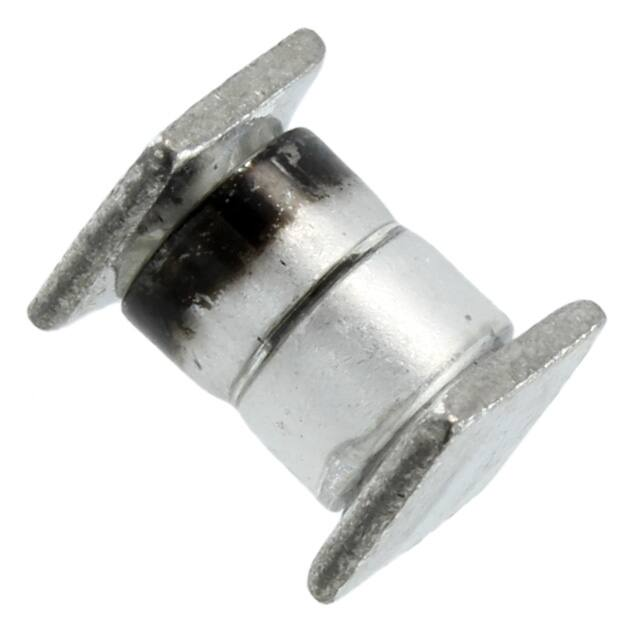

1N4954US thru 1N4996US, 1N5968US thru 1N5969US, and 1N6632US thru 1N6637US VOIDLESS-HERMETICALLY-SEALED Surface Mount 5 WATT GLASS ZENER SCOTTSDALE DIVISION APPEARANCE This surface mount Zener Voltage Regulator series is military qualified to MIL-PRF-19500/356 and is ideal for high-reliability applications where a failure cannot be tolerated. These industry-recognized 5 Watt Zener Voltage Regulators are hermetically sealed with voidless-glass construction using an internal metallurgical bond. It includes Zener selections from 3.3 to 390 volts in standard 5% tolerances as well as tighter tolerances identified by different suffix letters on the part number. They are also available in axial-leaded packages for thru hole mounting by deleting the “US” suffix (see separate data sheet for 1N4954 thru 1N4996, 1N5968 thru 1N5969, and 1N6632 thru 1N6637). Microsemi also offers numerous other Zener products to meet higher and lower power ratings in both thru-hole and surface mount packages. WWW . Microsemi .C OM DESCRIPTION “E” Package (or “D-5B”) IMPORTANT: For the most current data, consult MICROSEMI’s website: http://www.microsemi.com FEATURES • • • • • • APPLICATIONS / BENEFITS Popular JEDEC registered series Voidless hermetically sealed glass package Triple-layer passivation Internal “Category I” Metallurgical bonds for 1N4954US thru 1N4996US, and “Category III” for 1N6632US thru 1N6637US as well as 1N5968US thru 1N5959US JAN, JANTX, JANTXV, and JANS available per MILPRF-19500/356 Axial-leaded equivalents (see separate data sheet for 1N4954 thru 1N4996, 1N6632 thru 1N6637 and 1N5968 thru 1N5969) • • • • • • • MAXIMUM RATINGS • • • • • MECHANICAL AND PACKAGING o Operating (TJ) Temperature: -65 C to +175 C. Storage Temperature: -65oC to +175 oC. o Power Dissipation: 5 Watts @ TEC = 140 C for 1N4954US thru 1N4996US or @ TEC = 125oC for both the 1N6632US thru 1N6637US & 1N5968US thru 1N5969US. Derate linearly above these o temperatures to zero at 175 C. o Thermal Resistance: 7 C/W junction to end cap for o 1N4954US thru 1N4996US and 10 C/W for 1N6632US thru 1N6637US as well as 1N5968US thru 1N5969US Thermal Impedance at 10 ms: 1.8oC/W for 1N4954US thru 1N4996US, and 3.0oC/W for both the 1N6632US thru 1N6637US & 1N5968US thru 1N5969US Forward Voltage: 1.50 V at 1.0 A Copyright © 2010 3-29-2010 REV E; SD44A.pdf • • • • • • CASE: Hermetically sealed voidless hard glass with Tungsten slugs TERMINATIONS: End caps are Copper with Tin/Lead (Sn/Pb) finish. Note: Previous inventory had solid Silver end caps with Tin/Lead (Sn/Pb) finish. MARKING: None POLARITY: Cathode indicated by band Tape & Reel option: Standard per EIA-481-B Weight: 539 mg Microsemi Scottsdale Division 8700 E. Thomas Rd. PO Box 1390, Scottsdale, AZ 85252 USA, (480) 941-6300, Fax: (480) 947-1503 1N4954US thru 1N4996US 1N5968US thru 1N5969US 1N6632US thru 1N6637US • o Regulates voltage over a broad operating current and temperature range Extensive selection from 3.3 to 390 V Standard voltage tolerances are plus/minus 5% with no suffix Tight tolerances available in plus or minus 2% or 1% with C or D suffix respectively Extremely robust construction Nonsensitive to ESD per MIL-STD-750 Method 1020 Inherently radiation hard as described in Microsemi MicroNote 050 Page 1 1N4954US thru 1N4996US, 1N5968US thru 1N5969US, and 1N6632US thru 1N6637US VOIDLESS-HERMETICALLY-SEALED Surface Mount 5 WATT GLASS ZENER SCOTTSDALE DIVISION WWW . Microsemi .C OM ELECTRICAL CHARACTERISTICS @ 25oC TYPE* MAXIMUM DYNAMIC IMPEDANCE ZZ @ ZZK* @ IZT IZK=1mA VOLTAGE REGULATION (Note 1) Δ VZ TEST CURRENT VOLTS mA OHMS OHMS VOLTS 1N6632US 1N6633US 1N6634US 1N6635US 1N6636US 1N6637US 3.3 3.6 3.9 4.3 4.7 5.1 380 350 320 290 260 240 3.0 2.5 2.0 2.0 2.0 1.5 500 500 500 500 450 400 1N5968US 1N5969US 1N4954US 1N4955US 1N4956US 1N4957US 1N4958US 1N4959US 1N4960US 1N4961US 1N4962US 1N4963US 1N4964US 1N4965US 1N4966US 1N4967US 1N4968US 1N4969US 1N4970US 1N4971US 1N4972US 1N4973US 1N4974US 1N4975US 1N4976US 1N4977US 1N4978US 1N4979US 1N4980US 1N4981US 1N4982US 1N4983US 1N4984US 1N4985US 1N4986US 1N4987US 1N4988US 1N4989US 1N4990US 1N4991US 1N4992US 1N4993US 1N4994US 1N4995US 1N4996US 5.6 6.2 6.8 7.5 8.2 9.1 10.0 11 12 13 15 16 18 20 22 24 27 30 33 36 39 43 47 51 56 62 68 75 82 91 100 110 120 130 150 160 180 200 220 240 270 300 330 360 390 220 220 175 175 150 150 125 125 100 100 75 75 65 65 50 50 50 40 40 30 30 30 25 25 20 20 20 20 15 15 12 12 10 10 8 8 5 5 5 5 5 4 4 3 3 1.0 1.0 1.0 1.5 1.5 2.0 2.0 2.5 2.5 3.0 3.5 3.5 4.0 4.5 5.0 5.0 6.0 8 10 11 14 20 25 27 35 42 50 55 80 90 110 125 170 190 330 350 450 500 550 650 800 950 1175 1400 1800 400 1000 1000 800 600 400 125 130 140 145 150 155 160 165 170 175 180 190 200 220 230 240 250 270 320 400 500 620 720 760 800 1000 1150 1250 1500 1650 1750 1850 2000 2050 2100 2150 2200 2300 2500 IZT MAXIMUM REVERSE LEAKAGE CURRENT VOLTAGE MAXIMUM TEMPERATURE COEFF. αVZ @ IZT MAXIMUM CONTINUOUS CURRENT SURGE CURRENT @ 8.3 ms sq. wave IR VR VOLTS %/oC mA AMPS 0.90 0.80 0.75 0.70 0.60 0.50 μA 300 250 175 25 20 5 1.0 1.0 1.0 1.0 1.0 1.0 -.075 -.070 -.060 -.050 +/-.025 +/-.030 1440 1320 1220 1100 1010 930 20.0 18.7 17.6 16.4 15.3 14.4 0.4 0.5 0.7 0.7 0.7 0.7 0.8 0.8 0.8 0.9 1.0 1.1 1.2 1.5 1.8 2.0 2.0 2.5 2.8 3.0 3.0 3.3 3.5 4.0 4.4 5.0 5.5 6.0 6.6 7.5 8.0 9.0 10 11 13 14 16 18 19 22 25 28 32 35 40 5000 1000 150 100 50 25 25 10 10 10 5 5 5 2 2 2 2 2 2 2 2 2 2 2 2 2 2 2 2 2 2 2 2 2 2 2 2 2 2 2 2 2 2 2 2 4.28 4.74 5.2 5.7 6.2 6.9 7.6 8.4 9.1 9.9 11.4 12.2 13.7 15.2 16.7 18.2 20.6 22.8 25.1 27.4 29.7 32.7 35.8 38.8 42.6 47.1 51.7 56.0 62.2 69.2 76.0 83.6 91.2 98.8 114.0 121.6 136.8 152 167 182 206 228 251 274 297 .04 .04 .05 .06 .06 .06 .07 .07 .07 .08 .08 .08 .085 .085 .085 .090 .090 .090 .095 .095 .095 .095 .095 .095 .095 .100 .100 .100 .100 .100 .100 .100 .100 .105 .105 .105 .110 .110 .115 .115 .120 .120 .120 .120 .120 865 765 700 630 580 520 475 430 395 365 315 294 264 237 216 198 176 158 144 132 122 110 100 92 84 76 70 63.0 58.0 52.5 47.5 43.0 39.5 36.6 31.6 29.4 26.4 23.6 21.6 19.8 17.5 15.6 14.4 13.0 12.0 20 20 29.3 26.4 24 22 20 19 18 16 12 10 9.0 8.0 7.0 6.5 6.0 5.5 5.0 4.5 4.0 3.5 3.2 3.0 2.8 2.5 2.2 2.0 1.8 1.6 1.4 1.2 1.00 0.80 0.75 0.70 0.60 0.50 0.50 0.40 0.35 0.30 0.25 0.22 0.20 *IZK = 5 mA for 1N5968 IZM IZSM 1N4954US thru 1N4996US 1N5968US thru 1N5969US 1N6632US thru 1N6637US NOMINAL ZENER VOLTAGE VZ @ IZT NOTE 1: Maximum voltage change ΔVZ between 10% of IZM and 50% of IZM Copyright © 2010 3-29-2010 REV E; SD44A.pdf Microsemi Scottsdale Division 8700 E. Thomas Rd. PO Box 1390, Scottsdale, AZ 85252 USA, (480) 941-6300, Fax: (480) 947-1503 Page 2 1N4954US thru 1N4996US, 1N5968US thru 1N5969US, and 1N6632US thru 1N6637US SCOTTSDALE DIVISION ZZT or ZZK VF IR IZM IZSM WWW . Microsemi .C OM SYMBOLS & DEFINITIONS Definition Symbol VZ IZ, IZT, IZK VOIDLESS-HERMETICALLY-SEALED Surface Mount 5 WATT GLASS ZENER Zener Voltage: The zener voltage the device will exhibit at a specified current (IZ) in its breakdown region. Regulator Current: The dc regulator current (IZ), at a specified test point (IZT), or near breakdown knee (IZK). Dynamic Impedance: The small signal impedance of the diode when biased to operate in its breakdown region at a specified rms current modulation (typically 10% of IZT or IZK) and superimposed on IZT or IZK respectively. Maximum Forward Voltage: The maximum forward voltage the device will exhibit at a specified current. Maximum Reverse Current: The maximum reverse (leakage) current that will flow at the specified voltage and temperature. Maximum Regulator (Zener) Current: The maximum rated dc current for the specified power rating. Maximum Zener Surge Current: The nonrepetitive peak value of zener surge current at a specified wave form. GRAPHS FIGURE 1 SURGE POWER vs. SURGE DURATION Copyright © 2010 3-29-2010 REV E; SD44A.pdf Microsemi Scottsdale Division 8700 E. Thomas Rd. PO Box 1390, Scottsdale, AZ 85252 USA, (480) 941-6300, Fax: (480) 947-1503 1N4954US thru 1N4996US 1N5968US thru 1N5969US 1N6632US thru 1N6637US FIGURE 2 TYPICAL ZENER IMPEDANCE vs. ZENER CURRENT Page 3 1N4954US thru 1N4996US, 1N5968US thru 1N5969US, and 1N6632US thru 1N6637US SCOTTSDALE DIVISION VOIDLESS-HERMETICALLY-SEALED Surface Mount 5 WATT GLASS ZENER WWW . Microsemi .C OM PACKAGE DIMENSIONS AND PAD LAYOUT This Package Outline has also previously been identified as “D-5B” Note: If mounting requires adhesive separate from the solder, an additional 0.080 inch diameter contact may be placed in the center between the pads as an optional spot for cement as shown in the pad layout. 1N4954US thru 1N4996US 1N5968US thru 1N5969US 1N6632US thru 1N6637US Copyright © 2010 3-29-2010 REV E; SD44A.pdf Microsemi Scottsdale Division 8700 E. Thomas Rd. PO Box 1390, Scottsdale, AZ 85252 USA, (480) 941-6300, Fax: (480) 947-1503 Page 4

物料型号: - 1N4954US至1N4996US - 1N5968US至1N5969US - 1N6632US至1N6637US
器件简介: - 这些齐纳电压调节器系列是军用级别的,符合MIL-PRF-19500/356标准,适用于高可靠性应用,不允许故障发生。 - 采用无空洞玻璃封装和内部冶金键合,提供从3.3至390伏的齐纳选择。
引脚分配: - 该器件为表面安装型,没有引脚分配描述,但提供了封装尺寸和焊盘布局。
参数特性: - 工作温度范围:-65°C至+175°C - 存储温度范围:-65°C至+175°C - 功率耗散:5瓦特 - 热阻:依据型号不同,分别为7°C/W或10°C/W
功能详解: - 齐纳电压调节器在广泛的操作电流和温度范围内调节电压。 - 提供从3.3V至390V的广泛选择。 - 标准电压容差为±5%,也可提供±2%或±1%的更紧密容差。
应用信息: - 用于电压调节,具有非常坚固的构造,对静电放电不敏感,具有固有的辐射硬度。
封装信息: - 封装类型为“E”(或“D-5B”),为无空洞硬玻璃封装,带有钨块。 - 端盖为铜制,表面有锡/铅(Sn/Pb)镀层。
