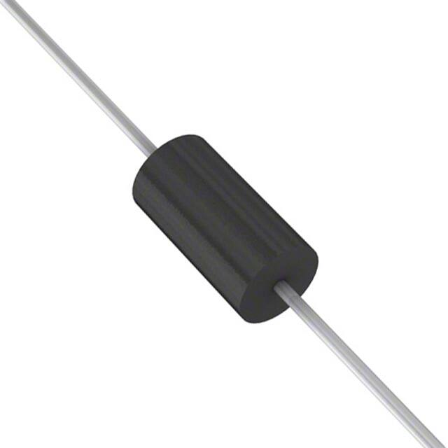

1N3016B-1 – 1N3045B-1 Available on commercial versions 1 Watt Glass Case Zener Diodes Qualified per MIL-PRF-19500/115 Qualified Levels: JAN, JANTX, and JANTXV DESCRIPTION This well established Zener diode series for the 1N3016B-1 through 1N3045B-1 JEDEC registration in the glass DO-41 package provides a glass hermetic seal for 6.8 to 110 volts. It is also well suited for high-reliability applications where it is available in JAN, JANTX, and JANTXV military qualifications. Lower voltages are also available in the 1N3821 through 1N3828 series (3.3 V to 7.5 V) in the same package (see separate data sheet). Important: For the latest information, visit our website http://www.microsemi.com. FEATURES DO-41 Package • JEDEC registered 1N3016 through 1N3045 numbers. • Zener voltage range: 6.8 volts to 110 volts. • Hermetically sealed DO-41 glass package. • Metallurgically bonded. • • • Double plug construction. Voltage tolerances of 5%, 2%, and 1% available. JAN, JANTX, and JANTXV qualifications also available per MIL-PRF-19500/115. • RoHS compliant versions available (commercial grade only). Also available in: DO-213AB package (surface mount) 1N3016BUR-1 – 1N3045BUR-1 (See part nomenclature for all available options.) APPLICATIONS / BENEFITS • • • • • Regulates voltage over a broad operating current and temperature range. Wide selection from 6.8 to 110 volts. Low reverse (leakage) currents. Non-sensitive to ESD. Inherently radiation hard as described in Microsemi “MicroNote 050”. MAXIMUM RATINGS Parameters/Test Conditions Junction and Storage Temperature (1) Thermal Resistance Junction-to-Lead (2) DC Power Dissipation Forward Voltage @ 200 mA Solder Temperature @ 10 s Symbol Value Unit T J and T STG R ӨJL PD VF T SP -55 to +175 80 1.0 1.2 260 ºC ºC/W W V o C Notes: 1. At L = 0.375 inches (10 mm) from body. 2. At T L < +95 oC 3/8” (10 mm) from body or 1.0 watts at T L < +65 oC when mounted on FR4 PC board as described for thermal resistance above (also see Figure 1). (Derate power to 0 at T L = +175 °C). MSC – Lawrence 6 Lake Street, Lawrence, MA 01841 Tel: 1-800-446-1158 or (978) 620-2600 Fax: (978) 689-0803 MSC – Ireland Gort Road Business Park, Ennis, Co. Clare, Ireland Tel: +353 (0) 65 6840044 Fax: +353 (0) 65 6822298 Website: www.microsemi.com T4-LDS-0285, Rev. 1 (4/22/13) ©2013 Microsemi Corporation Page 1 of 5 1N3016B-1 – 1N3045B-1 MECHANICAL and PACKAGING • • • • • • • CASE: Hermetically sealed voidless hard glass with tungsten slugs. TERMINALS: Tin/lead or RoHS compliant matte/tin (commercial grade only) over copper. MARKING: Body coated in blue with part number. POLARITY: Cathode indicated by band. TAPE & REEL option: Standard per EIA-296. Consult factory for quantities. WEIGHT: 340 milligrams. See Package Dimensions on last page. PART NOMENCLATURE JAN 1N3016 B -1 e3 Reliability Level JAN = JAN level JANTX = JANTX level JANTXV = JANTXV level Blank = Commercial RoHS Compliance e3 = RoHS compliant (available on commercial grade only) Blank = non-RoHS compliant Metallurgically Bonded DO-41 JEDEC type number (See Electrical Characteristics table) Zener Voltage Tolerance B = 5% C = 2% D = 1% SYMBOLS & DEFINITIONS Definition Symbol IR I Z , I ZT , I ZK I ZM VF VR VZ Z ZT or Z ZK Reverse Current: The maximum reverse (leakage) current that will flow at the specified voltage and temperature. Regulator Current: The dc regulator current (I Z ), at a specified test point (I ZT ), near breakdown knee (I ZK ). Maximum Regulator (Zener) Current: The maximum rated dc current for the specified power rating. Maximum Forward Voltage: The maximum forward voltage the device will exhibit at a specified current. Reverse Voltage: The reverse voltage dc value, no alternating component. Zener Voltage: The Zener voltage the device will exhibit at a specified current (I Z ) in its breakdown region. Dynamic Impedance: The small signal impedance of the diode when biased to operate in its breakdown region at a specified rms current modulation (typically 10% of I ZT or I ZK ) and superimposed on I ZT or I ZK respectively. T4-LDS-0285, Rev. 1 (4/22/13) ©2013 Microsemi Corporation Page 2 of 5 1N3016B-1 – 1N3045B-1 *ELECTRICAL CHARACTERISTICS @ 25°C JEDEC TYPE NUMBER 1N3016B-1 1N3017B-1 1N3018B-1 1N3019B-1 1N3020B-1 1N3021B-1 1N3022B-1 1N3023B-1 1N3024B-1 1N3025B-1 1N3026B-1 1N3027B-1 1N3028B-1 1N3029B-1 1N3030B-1 1N3031B-1 1N3032B-1 1N3033B-1 1N3034B-1 1N3035B-1 1N3036B-1 1N3037B-1 1N3038B-1 1N3039B-1 1N3040B-1 1N3041B-1 1N3042B-1 1N3043B-1 1N3044B-1 1N3045B-1 NOMINAL ZENER VOLTAGE V Z @ I ZT (Note 1) Volts 6.8 7.5 8.2 9.1 10 11 12 13 15 16 18 20 22 24 27 30 33 36 39 43 47 51 56 62 68 75 82 91 100 110 ZENER TEST CURRENT *JEDEC Registered Data. NOTES: 1. I ZT mA 37 34 31 28 25 23 21 19 17 15.5 14 12.5 11.5 10.5 9.5 8.5 7.5 7.0 6.5 6.0 5.5 5.0 4.5 4.0 3.7 3.3 3.0 2.8 2.5 2.3 MAXIMUM ZENER IMPEDANCE (Note 3) Z ZT @ I ZT Ohms 3.5 4.0 4.5 6 7 8 9 10 14 16 20 22 23 25 35 40 45 50 60 70 80 95 110 125 150 175 200 250 350 450 Z ZK @ I ZK Ohms mA 700 1.0 700 .5 700 .5 700 .5 700 .25 700 .25 700 .25 700 .25 700 .25 700 .25 750 .25 750 .25 750 .25 750 .25 750 .25 1000 .25 1000 .25 1000 .25 1000 .25 1500 .25 1500 .25 1500 .25 2000 .25 2000 .25 2000 .25 2000 .25 3000 .25 3000 .25 3000 .25 4000 .25 MAXIMUM ZENER CURRENT I ZM (Note 3) mA 140 125 115 105 95 85 80 74 63 60 52 47 43 40 34 31 28 26 23 21 19 18 17 15 14 12 11 10 9.0 8.3 MAXIMUM REVERSE LEAKAGE CURRENT† IR @ VR µA Volts 150 5.2 100 5.7 50 6.2 25 6.9 25 7.6 10 8.4 10 9.1 10 9.9 10 11.4 10 12.2 10 13.7 10 15.2 10 16.7 10 18.2 10 20.6 10 22.8 10 25.1 10 27.4 10 29.7 10 32.7 10 35.8 10 38.8 10 42.6 10 47.1 10 51.7 10 56.0 10 62.2 10 69.2 10 76.0 10 83.6 MAXIMUM TEMP. COEFF. OF ZENER VOLTAGE α VZ %/oC 0.061 0.065 0.070 0.073 0.076 0.078 0.081 0.085 0.088 0.089 0.091 0.092 0.093 0.094 0.096 0.098 0.099 0.100 0.101 0.102 0.102 0.103 0.103 0.104 0.104 0.105 0.106 0.108 0.11 0.11 †Not JEDEC Data. Zener Voltage (V Z ) is measured with junction in thermal equilibrium with still air at a temperature of 25oC. The test currents (I ZT ) at nominal voltages provide a constant 0.25 watts. 2. The Zener impedance is derived when a 60 cycle ac current having an rms value equal to 10% of the dc Zener current (I ZT or I ZK ) is superimposed on I ZT or I ZK . Zener impedance is measured at 2 points to ensure a sharp knee on the breakdown curve and to eliminate unstable units. See MicroNote 202 for variation in dynamic impedance with different Zener currents. 3. These values of I ZM may often be exceeded in the case of individual diodes. The values shown are calculated for a unit at the high voltage end of its tolerance range. Allowance has also been made for the rise in Zener voltage above V ZT that results from Zener impedance and the increase in junction temperature as a unit approaches thermal equilibrium at a dissipation of 1 watt. The I ZM values shown for +/- 5% tolerance units may be used with little error for +/-10% tolerance units, but should be reduced by 7% to include a +/- 20% tolerance unit near the high voltage end of its tolerance range. T4-LDS-0285, Rev. 1 (4/22/13) ©2013 Microsemi Corporation Page 3 of 5 1N3016B-1 – 1N3045B-1 DC Operation Maximum Rating (W) GRAPHS T L (ºC) (Leads 3/8”) FIGURE 1 Temperature-Power Derating Curve T4-LDS-0285, Rev. 1 (4/22/13) ©2013 Microsemi Corporation Page 4 of 5 1N3016B-1 – 1N3045B-1 PACKAGE DIMENSIONS NOTES: 1. Dimensions are in inches. Millimeters are given for general information only. 2. Package contour optional with BD and length BL. Heat slugs, if any, shall be included within this cylinder length but shall not be subject to minimum limit of BD. 3. Within this zone lead, diameter may vary to allow for lead finishes and irregularities other than heat slugs. 4. In accordance with ASME Y14.5M, diameters are equivalent to Φx symbology. T4-LDS-0285, Rev. 1 (4/22/13) ©2013 Microsemi Corporation Ltr BD BL LD LL LU DIMENSIONS INCH MILLIMETERS Min Max Min Max 0.080 0.107 2.03 2.72 0.160 0.205 4.06 5.21 0.028 0.034 0.71 0.86 1.000 25.40 0.050 1.27 Notes 2 2 3 Page 5 of 5
JANTX1N3028B-1/TR
物料型号:1N3016B-1至1N3045B-1
器件简介:这些齐纳二极管提供6.8至110伏的电压范围,采用玻璃DO-41封装,具有玻璃密封,适用于高可靠性应用。
引脚分配:文档中未明确提供引脚分配图,但通常DO-41封装的二极管具有两个引脚,阳极和阴极。
参数特性: - 工作温度范围:-55°C至+175°C - 热阻:80°C/W - 最大直流功耗:1W - 最大正向电压:1.2V(在200mA时) - 焊接温度:260°C(10秒)
功能详解: - 这些二极管用于在广泛的工作电流和温度范围内调节电压。 - 提供从6.8V至110V的广泛选择。 - 低反向(漏)电流。 - 对静电放电不敏感。 - 固有的辐射硬度。
应用信息: - 用于电压调节,具有广泛的工作电流和温度范围。
封装信息: - 除了DO-41封装外,还提供DO-213AB封装(表面贴装)。
电气特性表提供了每个型号的标称齐纳电压、测试电流、最大齐纳阻抗、最大齐纳电流、最大反向漏电流和最大温度系数等详细信息。
