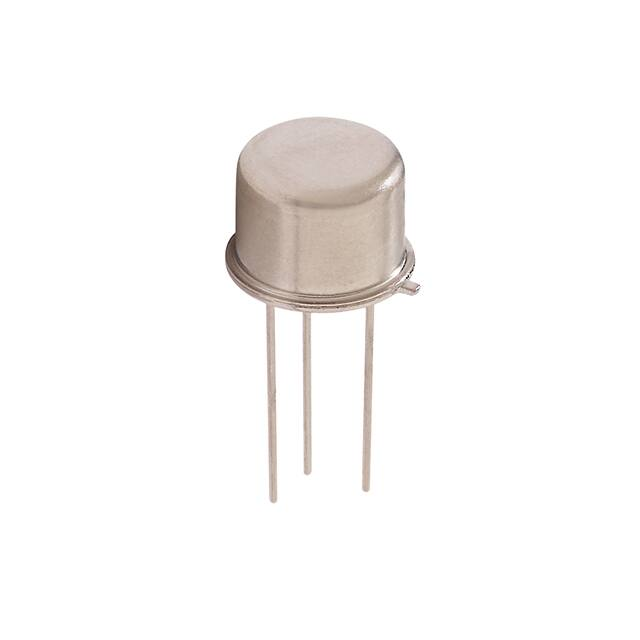

    TRANS PNP 120V 1A TO39
JANTXV2N5680 数据手册
TECHNICAL DATA PNP POWER TRANSISTOR SILICON AMPLIFIER Qualified per MIL-PRF-19500/582 Devices Qualified Level 2N5679 JAN JANTX JANTXV 2N5680 MAXIMUM RATINGS (TA = 250C unless otherwise noted) Ratings Symbol 2N5679 Collector-Emitter Voltage Collector-Base Voltage Emitter-Base Voltage Collector Current Base Current Total Power Dissipation @ TA = +250C(1) @ TC = +250C(2) Operating & Storage Temperature Range VCEO VCBO VEBO IC IB PT Top, Tstg 2N5680 Unit 100 120 100 120 4.0 4.0 1.0 1.0 0.5 0.5 1.0 1.0 10 10 -65 to +200 -65 to +200 Vdc Vdc Vdc Adc Adc W W °C Max. 17.5 Unit 0 C TO-39* (TO-205AD) THERMAL CHARACTERISTICS Characteristics Thermal Resistance, Junction-to-Case 1) Derate linearly 5.7 mW/0C for TA > +250C 2) Derate linearly 57 mW/0C for TC > +250C Symbol RθJC *See appendix A for package outline ELECTRICAL CHARACTERISTICS (TA = 250C unless otherwise noted) Characteristics Symbol Min. V(BR)CEO 100 120 Max. Unit OFF CHARACTERISTICS Collector-Emitter Breakdown Voltage IC = 10 mAdc 2N5679 2N5680 Emitter-Base Cutoff Current VEB = 4.0 Vdc Collector-Emitter Cutoff Current VCE = 70 Vdc 2N5679 VCE = 80 Vdc 2N5680 Collector-Emitter Cutoff Current VBE = 1.5 Vdc VCE = 100 Vdc 2N5679 VCE = 120 Vdc 2N5680 IEBO 1.0 µAdc ICEO 10 µAdc ICEX 100 nAdc 6 Lake Street, Lawrence, MA 01841 1-800-446-1158 / (978) 794-1666 / Fax: (978) 689-0803 Downloaded from Elcodis.com electronic components distributor Vdc 120101 Page 1 of 2 2N5679, 2N5680 JAN SERIES ELECTRICAL CHARACTERISTICS (con’t) Characteristics Symbol Min. Max. hFE 40 20 5 150 Unit ON CHARACTERISTICS Forward Current Transfer Ratio IC = 250 mAdc, VCE = 2.0 Vdc IC = 500 mAdc, VCE = 2.0 Vdc IC = 1.0 Adc, VCE = 2.0 Vdc Collector-Emitter Saturation Voltage IC = 250 mAdc, IB = 25 mAdc IC = 500 mAdc, IB = 50 mAdc Base-Emitter Saturation Voltage IC = 250 mAdc, IB = 25 mAdc IC = 500 mAdc, IB = 50 mAdc VCE(sat) 0.6 1.0 Vdc VBE(sat) 1.1 1.3 Vdc 50 pF DYNAMIC CHARACTERISTICS Magnitude of Common Emitter Small-Signal Short Circuit Forward-Current Transfer Ratio IC = 0.1 Adc, VCE = 10 Vdc, f = 10 kHz Small Signal Short Circuit Forward-Current Transfer Ratio IC = 0.2 Adc, VCE = 1.5 Vdc, f = 1.0 kHz Output Capacitance VCB = 20 Vdc, IE = 0, f = 1 MHz hfe 3.0 hfe 40 Cobo SAFE OPERATING AREA DC Tests TC = +250C, 1 Cycle, t ≥ 0.5 s Test 1 VCE = 2 Vdc, IC = 1.0 Adc Test 2 VCE = 10 Vdc, IC = 1.0 Adc Test 3 VCE = 90 Vdc, IC = 50 mAdc 6 Lake Street, Lawrence, MA 01841 1-800-446-1158 / (978) 794-1666 / Fax: (978) 689-0803 Downloaded from Elcodis.com electronic components distributor 120101 Page 2 of 2
