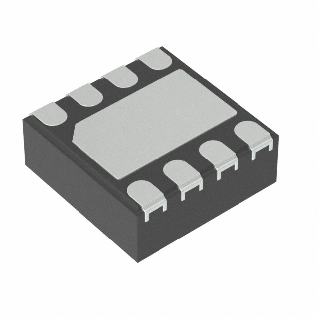

MCP14A0301/2 3.0A MOSFET Driver with Low Threshold Input and Enable Features General Description • High Peak Output Current: 3.0A (typical) • Wide Input Supply Voltage Operating Range: - 4.5V to 18V • Low Shoot-Through/Cross-Conduction Current in Output Stage • High Capacitive Load Drive Capability: - 1800 pF in 13 ns (typical) • Short Delay Times: 15 ns (tD1), 18 ns (tD2) (typical) • Low Supply Current: 360 µA (typical) • Low-Voltage Threshold Input and Enable with Hysteresis • Latch-Up Protected: Withstands 500 mA Reverse Current • Space-Saving Packages: - 8-Lead MSOP - 8-Lead SOIC - 8-Lead 2 x 2 WDFN The MCP14A0301/2 devices are high-speed MOSFET drivers that are capable of providing up to 3.0A of peak current while operating from a single 4.5V to 18V supply. There are two output configurations available; inverting (MCP14A0301) and noninverting (MCP14A0302). These devices feature low shootthrough current, fast rise and fall times, and short propagation delays, which make them ideal for high switching frequency applications. Applications • • • • • Switch Mode Power Supplies Pulse Transformer Drive Line Drivers Level Translator Motor and Solenoid Drive The MCP14A0301/2 family of devices offers enhanced control with Enable functionality. The active-high Enable pin can be driven low to drive the output of the MCP14A0301/2 low, regardless of the status of the Input pin. An integrated pull-up resistor allows the user to leave the Enable pin floating for standard operation. These devices are highly latch-up resistant under any condition within their power and voltage ratings. They can accept up to 500 mA of reverse current being forced back into their outputs without damage or logic upset. All terminals are fully protected against electrostatic discharge (ESD) up to 2 kV (HBM) and 200V (MM). Package Types MCP14A0301 MSOP/SOIC MCP14A0302 MSOP/SOIC VDD 1 8 VDD VDD 1 8 VDD IN 2 7 OUT IN 2 7 OUT EN 3 6 OUT EN 3 6 OUT GND 4 5 GND GND 4 5 GND MCP14A0301 2 x 2 WDFN* MCP14A0302 2 x 2 WDFN* VDD 1 8 VDD VDD 1 IN 2 7 OUT IN 2 6 OUT 5 GND GND 4 EN 3 GND 4 EP* 9 EN 3 8 VDD EP* 9 7 OUT 6 OUT 5 GND * Includes Exposed Thermal Pad (EP); see Table 3-1.  2017 Microchip Technology Inc. DS20005807A-page 1 MCP14A0301/2 Functional Block Diagram VDD Internal Pull-Up Enable VREF GND Inverting Output VDD Input VREF GND DS20005807A-page 2 Non-Inverting MCP14A0301 Inverting MCP14A0302 Non-Inverting  2017 Microchip Technology Inc. MCP14A0301/2 1.0 ELECTRICAL CHARACTERISTICS 1.1 Electrical Specifications Absolute Maximum Ratings † VDD, Supply Voltage..................................................................................................................................................+20V VIN, Input Voltage ............................................................................................................... (VDD + 0.3V) to (GND – 0.3V) VEN, Enable Voltage........................................................................................................... (VDD + 0.3V) to (GND – 0.3V) Package Power Dissipation (TA = +50°C) 8L MSOP .................................................................................................................................................0.58W 8L SOIC ...................................................................................................................................................0.90W 8L 2 X 2 WDFN ........................................................................................................................................1.63W ESD protection on all pins ..............................................................................................................................2 kV (HBM) ESD protection on all pins .............................................................................................................................. 200V (MM) † Notice: Stresses above those listed under “Maximum ratings” may cause permanent damage to the device. This is a stress rating only and functional operation of the device at those or any other conditions above those indicated in the operational listings of this specification is not implied. Exposure to maximum rating conditions for extended periods may affect device reliability.  2017 Microchip Technology Inc. DS20005807A-page 3 MCP14A0301/2 TABLE 1-1: DC CHARACTERISTICS Electrical Specifications: Unless otherwise noted, TA = +25°C, with 4.5V  VDD  18V. Parameters Sym. Min. Typ. Max. Units Conditions Input Voltage Range VIN GND – 0.3V — VDD + 0.3 V Logic ‘1’ High Input Voltage VIH 2.0 1.6 — V Logic ‘0’ Low Input Voltage VIL — 1.3 0.8 V VHYST(IN) — 0.3 — V IIN -1 — +1 µA Enable Voltage Range VEN GND – 0.3V — VDD + 0.3 V Logic ‘1’ High Enable Voltage VEH 2.0 1.6 — V Logic ‘0’ Low Enable Voltage VEL — 1.3 0.8 V VHYST(EN) — 0.3 — V RENBL — 1.5 — MΩ Enable Input Current IEN — 12 — µA VDD = 18V, ENB = AGND Propagation Delay tD3 — 15 22 ns VDD = 18V, VEN = 5V, see Figure 4-3, (Note 1) Propagation Delay tD4 — 18 25 ns VDD = 18V, VEN = 5V, see Figure 4-3, (Note 1) VOH VDD – 0.025 — — V IOUT = 0A Low Output Voltage VOL — — 0.025 V IOUT = 0A Output Resistance, High ROH — 2.2 3.3 Ω IOUT = 10 mA, VDD = 18V Output Resistance, Low ROL — 1.5 2.3 Ω IOUT = 10 mA, VDD = 18V Peak Output Current IPK — 3.0 — A VDD = 18V (Note 1) Latch-Up Protection Withstand Reverse Current IREV 0.5 — — A Duty cycle  2%, t  300 µs (Note 1) Rise Time tR — 13 18 ns VDD = 18V, CL = 1800 pF, see Figure 4-1, Figure 4-2 Fall Time tF — 12 17 ns VDD = 18V, CL = 1800 pF, see Figure 4-1, Figure 4-2 Delay Time tD1 — 15 22 ns VDD = 18V, VIN = 5V, see Figure 4-1, Figure 4-2 tD2 — 18 25 ns VDD = 18V, VIN = 5V, see Figure 4-1, Figure 4-2 VDD 4.5 — 18 V Input Input Voltage Hysteresis Input Current 0V  VIN  VDD Enable Enable Voltage Hysteresis Enable Pin Pull-Up Resistance VDD = 18V, ENB = AGND Output High Output Voltage Switching Time (Note 1) Power Supply Supply Voltage Power Supply Current Note 1: IDD — 360 580 µA VIN = 3V, VEN = 3V IDD — 360 580 µA VIN = 0V, VEN = 3V IDD — 360 580 µA VIN = 3V, VEN = 0V IDD — 360 580 µA VIN = 0V, VEN = 0V Tested during characterization, not production tested. DS20005807A-page 4  2017 Microchip Technology Inc. MCP14A0301/2 TABLE 1-2: DC CHARACTERISTICS (OVER OPERATING TEMP. RANGE) Electrical Specifications: Unless otherwise indicated, over the operating range with 4.5V  VDD  18V. Parameters Sym. Min. Typ. Max. Units Input Voltage Range VIN GND – 0.3V — VDD + 0.3 V Logic ‘1’ High Input Voltage VIH 2.0 1.6 — V Logic ‘0’ Low Input Voltage VIL — 1.3 0.8 V VHYST(IN) — 0.3 — V IIN –10 — +10 µA Enable Voltage Range VEN GND – 0.3V — VDD + 0.3 V Logic ‘1’ High Enable Voltage VEH 2.0 1.6 — V Logic ‘0’ Low Enable Voltage VEL — 1.3 0.8 V Conditions Input Input Voltage Hysteresis Input Current 0V  VIN  VDD Enable Enable Voltage Hysteresis VHYST(EN) — 0.3 — V Enable Input Current IEN — 12 — µA VDD = 18V, ENB = AGND Propagation Delay tD3 — 20 27 ns VDD = 18V, VEN = 5V, TA = +125°C, see Figure 4-3 Propagation Delay tD4 — 24 31 ns VDD = 18V, VEN = 5V, TA = +125°C, see Figure 4-3 High Output Voltage VOH VDD – 0.025 — — V DC Test Low Output Voltage VOL — — 0.025 V DC Test Output Resistance, High ROH — — 4.1 Ω IOUT = 10 mA, VDD = 18V Output Resistance, Low ROL — — 3.3 Ω IOUT = 10 mA, VDD = 18V Output Note 1: Tested during characterization, not production tested.  2017 Microchip Technology Inc. DS20005807A-page 5 MCP14A0301/2 TABLE 1-2: DC CHARACTERISTICS (OVER OPERATING TEMP. RANGE) (CONTINUED) Electrical Specifications: Unless otherwise indicated, over the operating range with 4.5V  VDD  18V. Parameters Sym. Min. Typ. Max. Units Conditions Rise Time tR — 15 20 ns VDD = 18V, CL = 1800 pF, TA = +125°C, see Figure 4-1, Figure 4-2 Fall Time tF — 13 18 ns VDD = 18V, CL = 1800 pF, TA = +125°C, see Figure 4-1, Figure 4-2 Delay Time tD1 — 20 27 ns VDD = 18V, VIN = 5V, TA = +125°C, see Figure 4-1, Figure 4-2 tD2 — 24 31 VDD 4.5 — 18 V Switching Time (Note 1) VDD = 18V, VIN = 5V, TA = +125°C, see Figure 4-1, Figure 4-2 Power Supply Supply Voltage Power Supply Current Note 1: 1.2 IDD — — 800 uA VIN = 3V, VEN = 3V IDD — — 800 uA VIN = 0V, VEN = 3V IDD — — 800 uA VIN = 3V, VEN = 0V IDD — — 800 uA VIN = 0V, VEN = 0V Tested during characterization, not production tested. Temperature Characteristics Electrical Specifications: Unless otherwise noted, all parameters apply with 4.5V  VDD  18V Parameter Sym. Min. Typ. Max. Units Comments Temperature Ranges Specified Temperature Range TA -40 — +125 °C Maximum Junction Temperature TJ — — +150 °C Storage Temperature Range TA -65 — +150 °C Junction-to-Ambient Thermal Resistance, 8LD MSOP JA — 172 — °C/W Note 1 Junction-to-Ambient Thermal Resistance, 8LD SOIC JA — 111 — °C/W Note 1 Junction-to-Ambient Thermal Resistance, 8LD WDFN JA — 61 — °C/W Note 1 Junction-to-Top Characterization Parameter, 8LD MSOP JT — 7 — °C/W Note 1 Junction-to-Top Characterization Parameter, 8LD SOIC JT — 12 — °C/W Note 1 Junction-to-Top Characterization Parameter, 8LD WDFN JT — 1.6 — °C/W Note 1 Junction-to-Board Characterization Parameter, 8LD MSOP JB — 130 — °C/W Note 1 Junction-to-Board Characterization Parameter, 8LD SOIC JB — 76 — °C/W Note 1 Junction-to-Board Characterization Parameter, 8LD WDFN JB — 29 — °C/W Note 1 Package Thermal Resistances Note 1: Parameter is determined using High K 2S2P 4-Layer board as described in JESD 51-7, as well as JESD 51-5 for packages with exposed pads DS20005807A-page 6  2017 Microchip Technology Inc. MCP14A0301/2 2.0 TYPICAL PERFORMANCE CURVES The graphs and tables provided following this note are a statistical summary based on a limited number of samples and are provided for informational purposes only. The performance characteristics listed herein are not tested or guaranteed. In some graphs or tables, the data presented may be outside the specified operating range (e.g., outside specified power supply range) and therefore outside the warranted range. Note: Note: Unless otherwise indicated, TA = +25°C with 4.5V  VDD  18V. 160 Rise Time (ns) 120 100 Fall Time (ns) 10000 pF 6800 pF 4700 pF 3300 pF 1800 pF 1000 pF 140 80 60 40 20 0 4 6 FIGURE 2-1: Voltage. 8 10 12 14 Supply Voltage (V) 16 120 Time (ns) Rise Time (ns) 18V 10000 FIGURE 2-4: Load. 140 5V 80 12V 40 18V 20 0 1000 12V Capacitive Load (pF) 160 60 5V 18 Rise Time vs. Supply 100 100 90 80 70 60 50 40 30 20 10 0 1000 28 26 24 22 20 18 16 14 12 10 8 Fall Time vs. Capacitive VDD = 18V tR, 4700 pF tF, 4700 pF tR, 1800 pF tF, 1800 pF -40 -25 -10 10000 Capacitive Load (pF) Rise Time vs. Capacitive 100 90 80 70 60 50 40 30 20 10 0 FIGURE 2-3: Voltage. 6 8 10 12 14 Supply Voltage (V) 16 Fall Time vs. Supply  2017 Microchip Technology Inc. 20 35 50 65 80 95 110 125 Temperature (°C) Rise and Fall Time vs. 10000 10000 pF 6800 pF 4700 pF 3300 pF 1800 pF 1000 pF 4 FIGURE 2-5: Temperature. Crossover Current (µA) Fall Time (ns) FIGURE 2-2: Load. 5 18 1 MHz 500 kHz 200 kHz 100 kHz 50 kHz 1000 100 10 4 FIGURE 2-6: Supply Voltage. 6 8 10 12 14 Supply Voltage (V) 16 18 Crossover Current vs. DS20005807A-page 7 MCP14A0301/2 Input Propagation Delay (ns) 50 Enable Propagation Delay (ns) Note: Unless otherwise indicated, TA = +25°C with 4.5V  VDD  18V. VIN = 5V 45 40 35 30 tD2 25 20 tD1 15 10 4 6 8 FIGURE 2-7: Supply Voltage. 10 12 14 Supply Voltage (V) 16 Input Propagation Delay vs. Enable Propagation Delay (ns) Input Propogation Delay (ns) 20 tD2 15 tD1 10 18 FIGURE 2-8: Input Propagation Delay Time vs. Input Amplitude. Input Propagation Delay (ns) 24 VDD = 18V 22 20 tD2 18 16 tD1 14 12 -40 -25 -10 FIGURE 2-9: Temperature. DS20005807A-page 8 5 30 20 35 50 65 80 95 110 125 Temperature (°C) Input Propagation Delay vs. tD4 25 20 tD3 15 10 6 8 10 12 14 Supply Voltage (V) 16 18 30 VDD = 18V 25 20 tD4 15 tD3 10 2 4 6 8 10 12 14 Enable Voltage Amplitude (V) 16 18 FIGURE 2-11: Enable Propagation Delay Time vs. Enable Voltage Amplitude. Enable Propagation Delay (ns) 16 35 FIGURE 2-10: Enable Propagation Delay vs. Supply Voltage. 25 6 8 10 12 14 Input Voltage Amplitude (V) 40 4 VDD = 18V 4 VEN = 5V 45 18 30 2 50 24 22 VDD = 18V VEN = 5V tD4 20 18 16 tD3 14 12 -40 -25 -10 FIGURE 2-12: vs. Temperature. 5 20 35 50 65 80 95 110 125 Temperature (°C) Enable Propagation Delay  2017 Microchip Technology Inc. MCP14A0301/2 Note: Unless otherwise indicated, TA = +25°C with 4.5V  VDD  18V. 1.8 1.7 Input Threshold (V) Quiescent Current (µA) 400 350 300 VIH 1.6 1.5 1.4 1.3 VIL 1.2 1.1 250 1 4 6 8 10 12 14 Supply Voltage (V) 16 FIGURE 2-13: Quiescent Supply Current vs. Supply Voltage. VDD = 18V Enable Threshold (V) 350 300 16 18 Input Threshold vs Supply VDD = 18V VEH 1.6 1.5 1.4 1.3 1.2 VEL 1.1 1 250 -40 -25 -10 FIGURE 2-14: vs. Temperature. 5 -40 -25 -10 20 35 50 65 80 95 110 125 Temperature (°C) Quiescent Supply Current 5 FIGURE 2-17: Temperature. 20 35 50 65 80 95 110 125 Temperature (°C) Enable Threshold vs. 1.8 1.8 VDD = 18V 1.7 Enable Threshold (V) Input Threshold (V) 10 12 14 Supply Voltage (V) 1.7 400 VIH 1.6 1.5 1.4 1.3 1.2 8 FIGURE 2-16: Voltage. 450 1.7 6 1.8 500 Quiescent Current (µA) 4 18 VIL 1.1 VEH 1.6 1.5 1.4 1.3 VEL 1.2 1.1 1 -40 -25 -10 FIGURE 2-15: Temperature. 5 20 35 50 65 80 95 110 125 Temperature (°C) Input Threshold vs.  2017 Microchip Technology Inc. 1 4 6 FIGURE 2-18: Voltage. 8 10 12 14 Supply Voltage (V) 16 18 Enable Threshold vs Supply DS20005807A-page 9 MCP14A0301/2 Note: Unless otherwise indicated, TA = +25°C with 4.5V  VDD  18V. VIN = 0V (MCP14A0301) VIN = 5V (MCP14A0302) Supply Current (mA) ROH - Output Resistance (Ÿ) 6 5.5 5 TA = +125°C 4.5 4 3.5 TA = +25°C 3 2.5 2 4 6 8 10 12 14 Supply Voltage (V) 16 18 FIGURE 2-19: Output Resistance (Output High) vs. Supply Voltage. 50 45 40 35 30 25 20 15 10 5 0 VDD = 12V 1 MHz 500 kHz 200 kHz 100 kHz 50 kHz 10 kHz 100 1000 Capacitive Load (pF) 10000 FIGURE 2-22: Supply Current vs. Capacitive Load (VDD = 12V). VIN = 5V (MCP14A0301) VIN = 0V (MCP14A0302) 3.5 30 VDD = 6V Supply Current (mA) ROL - Output Resistance (Ÿ) 4 TA = +125°C 3 2.5 2 TA = +25°C 1.5 1 6 8 10 12 14 Supply Voltage (V) 16 18 FIGURE 2-20: Output Resistance (Output Low) vs. Supply Voltage. 15 10 5 100 VDD = 18V 1 MHz 500 kHz 200 kHz 100 kHz 50 kHz 10 kHz 100 1000 Capacitive Load (pF) FIGURE 2-21: Supply Current vs. Capacitive Load (VDD = 18V). DS20005807A-page 10 10000 1000 Capacitive Load (pF) 10000 FIGURE 2-23: Supply Current vs. Capacitive Load (VDD = 6V). Supply Current (mA) Supply Current (mA) 1 MHz 500 kHz 200 kHz 100 kHz 50 kHz 10 kHz 20 0 4 100 90 80 70 60 50 40 30 20 10 0 25 100 90 80 70 60 50 40 30 20 10 0 VDD = 18V 10000 pF 6800 pF 3300 pF 1000 pF 470 pF 100 pF 10 100 Switching Frequency (kHz) 1000 FIGURE 2-24: Supply Current vs. Frequency (VDD = 18V).  2017 Microchip Technology Inc. MCP14A0301/2 Supply Current (mA) Note: Unless otherwise indicated, TA = +25°C with 4.5V  VDD  18V. 50 45 40 35 30 25 20 15 10 5 0 VDD = 12V 10000 pF 6800 pF 3300 pF 1000 pF 470 pF 100 pF 10 100 Switching Frequency (kHz) 1000 FIGURE 2-25: Supply Current vs. Frequency (VDD = 12V). Supply Current (mA) 30 VDD = 6V 25 10000 pF 6800 pF 3300 pF 1000 pF 470 pF 100 pF 20 15 10 5 0 10 100 Switching Frequency (kHz) 1000 FIGURE 2-26: Supply Current vs. Frequency (VDD = 6V). Enable Current (µA) 14 13 12 11 10 9 8 4 6 FIGURE 2-27: Voltage. 8 10 12 14 Supply Voltage (V) 16 18 Enable Current vs. Supply  2017 Microchip Technology Inc. DS20005807A-page 11 MCP14A0301/2 NOTES: DS20005807A-page 12  2017 Microchip Technology Inc. MCP14A0301/2 3.0 PIN DESCRIPTIONS The descriptions of the pins are listed in Table 3-1. TABLE 3-1: PIN FUNCTION TABLE MCP14A0301/2 Symbol Description 8L 2 x 2 WDFN 8L MSOP/SOIC 1 1 VDD Supply Input 2 2 IN Control Input 3 3 EN Device Enable 4 4 GND Power Ground 5 5 GND Power Ground 6 6 OUT/OUT 7 7 OUT/OUT 8 8 VDD Supply Input EP — EP Exposed Thermal Pad (GND) 3.1 Supply Input Pin (VDD) VDD is the bias supply input for the MOSFET driver and has a voltage range of 4.5V to 18V. This input must be decoupled to ground with a local capacitor. This bypass capacitor provides a localized low-impedance path for the peak currents that are provided to the load. 3.2 Push-Pull Output 3.5 Output Pin (OUT, OUT) The Output is a CMOS push-pull output that is capable of sourcing and sinking 3.0A of peak current (VDD = 18V). The low output impedance ensures the gate of the external MOSFET stays in the intended state even during large transients. This output also has a reverse current latch-up rating of 500 mA. Control Input Pin (IN) The MOSFET driver Control Input is a high-impedance input featuring low threshold levels. The Input also has hysteresis between the high and low input levels, allowing them to be driven from slow rising and falling signals and to provide noise immunity. 3.3 Push-Pull Output 3.6 Exposed Metal Pad Pin (EP) The exposed metal pad of the WDFN package is internally connected to GND. Therefore, this pad should be connected to a Ground plane to aid in heat removal from the package. Device Enable Pin (EN) The MOSFET driver Device Enable is a highimpedance input featuring low threshold levels. The Enable input also has hysteresis between the high and low input levels, allowing them to be driven from slow rising and falling signals and to provide noise immunity. Driving the Enable pin below the threshold will disable the output of the device, pulling OUT/OUT low, regardless of the status of the Input pin. Driving the Enable pin above the threshold allows normal operation of the OUT/OUT pin based on the status of the Input pin. The Enable pin utilizes an internal pull up resistor, allowing the pin to be left floating for standard driver operation. 3.4 Power Ground Pin (GND) GND is the device return pin for the input and output stages. The GND pin should have a low-impedance connection to the bias supply source return. When the capacitive load is being discharged, high peak currents will flow out of the ground pin.  2017 Microchip Technology Inc. DS20005807A-page 13 MCP14A0301/2 NOTES: DS20005807A-page 14  2017 Microchip Technology Inc. MCP14A0301/2 4.0 APPLICATION INFORMATION 4.1 General Information VDD = 18V MOSFET drivers are high-speed, high-current devices that are intended to source/sink high-peak currents to charge/discharge the gate capacitance of external MOSFETs or Insulated-Gate Bipolar Transistors (IGBTs). In high-frequency switching power supplies, the Pulse-Width Modulation (PWM) controller may not have the drive capability to directly drive the power MOSFET. A MOSFET driver such as the MCP14A0301/2 family can be used to provide additional source/sink current capability. 4.2 MOSFET Driver Timing 1 µF Input MCP14A0302 5V VIH (Typ.) 0V tD2 tF 90% 10% 0V FIGURE 4-2: Waveform. 0.1 µF Input Output CL = 1800 pF MCP14A0301 5V Input VIL (Typ.) tD2 18V tR 90% Output 10% 0V Input Signal: tRISE = tFALL ” 10 ns, 100 Hz, 0-5V Square Wave Inverting Driver Timing  2017 Microchip Technology Inc. tR Output 4.3 FIGURE 4-1: Waveform. tD1 Input Signal: tRISE = tFALL ” 10 ns, 100 Hz, 0-5V Square Wave 1 µF tF VIL (Typ.) 18V VDD = 18V tD1 Output CL = 1800 pF Input The ability of a MOSFET driver to transition from a fullyoff state to a fully-on state is characterized by the driver’s rise time (tR), fall time (tF) and propagation delays (tD1 and tD2). Figure 4-1 and Figure 4-2 show the test circuit and timing waveform used to verify the MCP14A0301/2 timing. VIH (Typ.) 0V 0.1 µF Noninverting Driver Timing Enable Function The enable pin (EN) provides additional control of the output pin (OUT). This pin is active high and is internally pulled up to VDD so that the pin can be left floating to provide standard MOSFET driver operation. When the enable pin’s input voltage is above the enable pin high voltage threshold, (VEN_H), the output is enabled and allowed to react to the status of the Input pin. However, when the voltage applied to the Enable pin falls below the low threshold voltage (VEN_L), the driver’s output is disabled and doesn't respond to changes in the status of the Input pin. When the driver is disabled, the output is pulled down to a low state. Refer to Table 4-1 for enable pin logic. The threshold voltage levels for the Enable pin are similar to the threshold voltage levels of the Input pin. Hysteresis is provided to help increase the noise immunity of the enable function, avoiding false triggers of the enable signal during driver switching. There are propagation delays associated with the driver receiving an enable signal and the output reacting. These propagation delays, tD3 and tD4, are graphically represented in Figure 4-3. DS20005807A-page 15 MCP14A0301/2 TABLE 4-1: 4.6 ENABLE PIN LOGIC MCP14A0301 OUT MCP14A0302 OUT H L H L H L X L L ENB IN H H L Power Dissipation The total internal power dissipation in a MOSFET driver is the summation of three separate power dissipation elements, as shown in Equation 4-1. EQUATION 4-1: P T = P L + P Q + P CC Where: 5V Enable VEH (Typ.) tD3 tD4 18V 90% 10% 0V Enable Signal: tRISE = tFALL ” 10 ns, 100 Hz, 0-5V Square Wave FIGURE 4-3: Enable Timing Waveform. Decoupling Capacitors Careful Printed Circuit Board (PCB) layout and decoupling capacitors are required when using power MOSFET drivers. Large current is required to charge and discharge capacitive loads quickly. For example, approximately 720 mA are needed to charge a 1000 pF load with 18V in 25 ns. To operate the MOSFET driver over a wide frequency range with low supply impedance, it is recommended to place 1.0 µF and 0.1 µF low ESR ceramic capacitors in parallel between the driver VDD and GND. These capacitors should be placed close to the driver to minimize circuit board parasitics and provide a local source for the required current. 4.5 Total power dissipation PL = Load power dissipation = Quiescent power dissipation PCC = Operating power dissipation 4.6.1 Output 4.4 = PQ VEL (Typ.) 0V PT PCB Layout Considerations Proper PCB layout is important in high-current, fastswitching circuits to provide proper device operation and robustness of design. Improper component placement may cause errant switching, excessive voltage ringing or circuit latch-up. The PCB trace loop length and inductance should be minimized by the use of ground planes or traces under the MOSFET gate drive signal. Separate analog and power grounds and local driver decoupling should also be used. CAPACITIVE LOAD DISSIPATION The power dissipation caused by a capacitive load is a direct function of the frequency, total capacitive load and supply voltage. The power lost in the MOSFET driver for a complete charging and discharging cycle of a MOSFET is shown in Equation 4-2. EQUATION 4-2: P L = f  C T  V DD Where: 2 f = Switching frequency CT = Total load capacitance VDD = MOSFET driver supply voltage 4.6.2 QUIESCENT POWER DISSIPATION The power dissipation associated with the quiescent current draw depends on the state of the Input and Enable pins. See Section 1.0 “Electrical Characteristics” for typical quiescent current draw values in different operating states. The quiescent power dissipation is shown in Equation 4-3. EQUATION 4-3: P Q =  I QH  D + I QL   1 – D    V DD Where: IQH = Quiescent current in the High state D = Duty cycle IQL = Quiescent current in the Low state VDD = MOSFET driver supply voltage Placing a ground plane beneath the MCP14A0301/2 devices will help as a radiated noise shield, as well as providing some heat sinking for power dissipated within the device. DS20005807A-page 16  2017 Microchip Technology Inc. MCP14A0301/2 4.6.3 OPERATING POWER DISSIPATION The operating power dissipation occurs each time the MOSFET driver output transitions because, for a very short period of time, both MOSFETs in the output stage are on simultaneously. This cross-conduction current leads to a power dissipation described in Equation 4-4. EQUATION 4-4: P CC = Where: V DD  I CO ICO = Crossover Current VDD = MOSFET driver supply voltage  2017 Microchip Technology Inc. DS20005807A-page 17 MCP14A0301/2 NOTES: DS20005807A-page 18  2017 Microchip Technology Inc. MCP14A0301/2 5.0 PACKAGING INFORMATION 5.1 Package Marking Information 8-Lead MSOP Example: Part Number Code MCP14A0301-E/MS A0301 MCP14A0301T-E/MS A0301 MCP14A0302-E/MS A0302 MCP14A0302T-E/MS A0302 8-Lead SOIC Example: Part Number Code MCP14A0301-E/SN 14A0301 MCP14A0301T-E/SN 14A0301 MCP14A0302-E/SN 14A0302 MCP14A0302T-E/SN 14A0302 8-Lead WDFN e3 * Note: 14A0301 e3 1721 256 Example: Part Number Legend: XX...X Y YY WW NNN A0301 721256 Code MCP14A0301T-E/KBA AAA MCP14A0302T-E/KBA AAB AAA 256 Customer-specific information Year code (last digit of calendar year) Year code (last 2 digits of calendar year) Week code (week of January 1 is week ‘01’) Alphanumeric traceability code Pb-free JEDEC® designator for Matte Tin (Sn) This package is Pb-free. The Pb-free JEDEC designator ( e3 ) can be found on the outer packaging for this package. In the event the full Microchip part number cannot be marked on one line, it will be carried over to the next line, thus limiting the number of available characters for customer-specific information.  2017 Microchip Technology Inc. DS20005807A-page 19 MCP14A0301/2 Note: For the most current package drawings, please see the Microchip Packaging Specification located at http://www.microchip.com/packaging DS20005807A-page 20  2017 Microchip Technology Inc. MCP14A0301/2 Note: For the most current package drawings, please see the Microchip Packaging Specification located at http://www.microchip.com/packaging  2017 Microchip Technology Inc. DS20005807A-page 21 MCP14A0301/2 Note: For the most current package drawings, please see the Microchip Packaging Specification located at http://www.microchip.com/packaging DS20005807A-page 22  2017 Microchip Technology Inc. MCP14A0301/2 8-Lead Plastic Small Outline (SN) - Narrow, 3.90 mm (.150 In.) Body [SOIC] Note: For the most current package drawings, please see the Microchip Packaging Specification located at http://www.microchip.com/packaging 2X 0.10 C A–B D A D NOTE 5 N E 2 E1 2 E1 E NOTE 1 2 1 e B NOTE 5 NX b 0.25 C A–B D TOP VIEW 0.10 C C A A2 SEATING PLANE 8X A1 SIDE VIEW 0.10 C h R0.13 h R0.13 H SEE VIEW C VIEW A–A 0.23 L (L1) VIEW C Microchip Technology Drawing No. C04-057-SN Rev D Sheet 1 of 2  2017 Microchip Technology Inc. DS20005807A-page 23 MCP14A0301/2 8-Lead Plastic Small Outline (SN) - Narrow, 3.90 mm (.150 In.) Body [SOIC] Note: For the most current package drawings, please see the Microchip Packaging Specification located at http://www.microchip.com/packaging Units Dimension Limits Number of Pins N e Pitch Overall Height A Molded Package Thickness A2 § Standoff A1 Overall Width E Molded Package Width E1 Overall Length D Chamfer (Optional) h Foot Length L L1 Footprint Foot Angle c Lead Thickness b Lead Width Mold Draft Angle Top Mold Draft Angle Bottom MIN 1.25 0.10 0.25 0.40 0° 0.17 0.31 5° 5° MILLIMETERS NOM 8 1.27 BSC 6.00 BSC 3.90 BSC 4.90 BSC 1.04 REF - MAX 1.75 0.25 0.50 1.27 8° 0.25 0.51 15° 15° Notes: 1. Pin 1 visual index feature may vary, but must be located within the hatched area. 2. § Significant Characteristic 3. Dimensions D and E1 do not include mold flash or protrusions. Mold flash or protrusions shall not exceed 0.15mm per side. 4. Dimensioning and tolerancing per ASME Y14.5M BSC: Basic Dimension. Theoretically exact value shown without tolerances. REF: Reference Dimension, usually without tolerance, for information purposes only. 5. Datums A & B to be determined at Datum H. Microchip Technology Drawing No. C04-057-SN Rev D Sheet 2 of 2 DS20005807A-page 24  2017 Microchip Technology Inc. MCP14A0301/2 8-Lead Plastic Small Outline (SN) - Narrow, 3.90 mm Body [SOIC] Note: For the most current package drawings, please see the Microchip Packaging Specification located at http://www.microchip.com/packaging SILK SCREEN C Y1 X1 E RECOMMENDED LAND PATTERN Units Dimension Limits E Contact Pitch Contact Pad Spacing C Contact Pad Width (X8) X1 Contact Pad Length (X8) Y1 MIN MILLIMETERS NOM 1.27 BSC 5.40 MAX 0.60 1.55 Notes: 1. Dimensioning and tolerancing per ASME Y14.5M BSC: Basic Dimension. Theoretically exact value shown without tolerances. Microchip Technology Drawing C04-2057-SN Rev B  2017 Microchip Technology Inc. DS20005807A-page 25 MCP14A0301/2 8-Lead Very, Very Thin Dual FlatPack, No Lead Package (KBA) - 2x2 mm Body [WDFN] Wettable Flanks (Stepped); Saw Singulated Note: For the most current package drawings, please see the Microchip Packaging Specification located at http://www.microchip.com/packaging D A B N (DATUM A) (DATUM B) E NOTE 1 2X 0.05 C 1 2X 2 0.05 C TOP VIEW 0.05 C C SEATING PLANE (A4) A (A3) 8X A1 0.05 C SIDE VIEW 0.10 C A B D2 1 2 L1 0.10 C A B NOTE 1 E2 K L N 8X b e BOTTOM VIEW 0.10 0.05 C A B C Microchip Technology Drawing C04-1218A Sheet 1 of 2 DS20005807A-page 26  2017 Microchip Technology Inc. MCP14A0301/2 8-Lead Very, Very Thin Dual FlatPack, No Lead Package (KBA) - 2x2 mm Body [WDFN] Wettable Flanks (Stepped); Saw Singulated Note: For the most current package drawings, please see the Microchip Packaging Specification located at http://www.microchip.com/packaging Units Dimension Limits N Number of Terminals e Pitch A Overall Height Standoff A1 A3 Terminal Thickness Step Height A4 Overall Length D Exposed Pad Length D2 E Overall Width E2 Exposed Pad Width b Terminal Width L Terminal Length Step Length L1 K Terminal-to-Exposed-Pad MIN 0.70 0.00 1.50 0.80 0.20 0.20 0.20 MILLIMETERS NOM 8 0.50 BSC 0.75 0.02 0.203 REF 0.100 REF 2.00 BSC 1.60 2.00 BSC 0.90 0.25 0.30 0.050 REF - MAX 0.80 0.05 1.70 1.00 0.30 0.40 - Notes: 1. Pin 1 visual index feature may vary, but must be located within the hatched area. 2. Package is saw singulated 3. Dimensioning and tolerancing per ASME Y14.5M BSC: Basic Dimension. Theoretically exact value shown without tolerances. REF: Reference Dimension, usually without tolerance, for information purposes only. Microchip Technology Drawing C04-1218A Sheet 2 of 2  2017 Microchip Technology Inc. DS20005807A-page 27 MCP14A0301/2 8-Lead Very, Very Thin Dual FlatPack, No Lead Package (KBA) - 2x2 mm Body [WDFN] Wettable Flanks (Stepped); Saw Singulated Note: For the most current package drawings, please see the Microchip Packaging Specification located at http://www.microchip.com/packaging X2 EV 8 ØV C G1 Y2 Y1 1 2 SILK SCREEN X1 E RECOMMENDED LAND PATTERN Units Dimension Limits E Contact Pitch Optional Center Pad Width Y2 Optional Center Pad Length X2 Contact Pad Spacing C Contact Pad Width (X8) X1 Contact Pad Length (X8) Y1 Contact Pad to Center Pad (X20) G1 Thermal Via Diameter V Thermal Via Pitch EV MIN MILLIMETERS NOM 0.50 BSC MAX 1.00 1.70 2.10 0.30 0.70 0.20 0.30 1.00 Notes: 1. Dimensioning and tolerancing per ASME Y14.5M BSC: Basic Dimension. Theoretically exact value shown without tolerances. 2. For best soldering results, thermal vias, if used, should be filled or tented to avoid solder loss during reflow process Microchip Technology Drawing C04-21218A DS20005807A-page 28  2017 Microchip Technology Inc. MCP14A0301/2 APPENDIX A: REVISION HISTORY Revision A (July 2017) • Original Release of this Document.  2017 Microchip Technology Inc. DS20005807A-page 29 MCP14A0301/2 NOTES: DS20005807A-page 30  2017 Microchip Technology Inc. MCP14A0301/2 PRODUCT IDENTIFICATION SYSTEM To order or obtain information, e.g., on pricing or delivery, refer to the factory or the listed sales office. PART NO. [X](1) –X Device Tape and Reel Temperature Range /XX Package Device: MCP14A0301T: High-Speed MOSFET Driver (Tape and Reel) MCP14A0302T: High-Speed MOSFET Driver (Tape and Reel) Temperature Range: E Package: MS Examples: a) MCP14A0301T-E/MS: Tape and Reel, Extended temperature, 8LD MSOP package b) MCP14A0302T-E/SN: Tape and Reel, Extended temperature, 8LD SOIC package c) MCP14A0302T-E/KBA: Tape and Reel Extended temperature, 8LD WDFN package = -40°C to +125°C (Extended) Note 1: = Plastic Micro Small Outline Package (MSOP),8-lead 8-lead SN = Plastic Small Outline Package (SOIC), 8-lead KBA = Plastic Dual Flat, No Lead Package, Wettable Flanks 2 x 2 mm Body (WDFN) 8-lead  2017 Microchip Technology Inc. Tape and Reel identifier only appears in the catalog part number description. This identifier is used for ordering purposes and is not printed on the device package. Check with your Microchip Sales Office for package availability with the Tape and Reel option. DS20005807A-page 31 MCP14A0301/2 NOTES: DS20005807A-page 32  2017 Microchip Technology Inc. Note the following details of the code protection feature on Microchip devices: • Microchip products meet the specification contained in their particular Microchip Data Sheet. • Microchip believes that its family of products is one of the most secure families of its kind on the market today, when used in the intended manner and under normal conditions. • There are dishonest and possibly illegal methods used to breach the code protection feature. All of these methods, to our knowledge, require using the Microchip products in a manner outside the operating specifications contained in Microchip’s Data Sheets. Most likely, the person doing so is engaged in theft of intellectual property. • Microchip is willing to work with the customer who is concerned about the integrity of their code. • Neither Microchip nor any other semiconductor manufacturer can guarantee the security of their code. Code protection does not mean that we are guaranteeing the product as “unbreakable.” Code protection is constantly evolving. We at Microchip are committed to continuously improving the code protection features of our products. Attempts to break Microchip’s code protection feature may be a violation of the Digital Millennium Copyright Act. If such acts allow unauthorized access to your software or other copyrighted work, you may have a right to sue for relief under that Act. Information contained in this publication regarding device applications and the like is provided only for your convenience and may be superseded by updates. It is your responsibility to ensure that your application meets with your specifications. MICROCHIP MAKES NO REPRESENTATIONS OR WARRANTIES OF ANY KIND WHETHER EXPRESS OR IMPLIED, WRITTEN OR ORAL, STATUTORY OR OTHERWISE, RELATED TO THE INFORMATION, INCLUDING BUT NOT LIMITED TO ITS CONDITION, QUALITY, PERFORMANCE, MERCHANTABILITY OR FITNESS FOR PURPOSE. Microchip disclaims all liability arising from this information and its use. Use of Microchip devices in life support and/or safety applications is entirely at the buyer’s risk, and the buyer agrees to defend, indemnify and hold harmless Microchip from any and all damages, claims, suits, or expenses resulting from such use. No licenses are conveyed, implicitly or otherwise, under any Microchip intellectual property rights unless otherwise stated. Microchip received ISO/TS-16949:2009 certification for its worldwide headquarters, design and wafer fabrication facilities in Chandler and Tempe, Arizona; Gresham, Oregon and design centers in California and India. The Company’s quality system processes and procedures are for its PIC® MCUs and dsPIC® DSCs, KEELOQ® code hopping devices, Serial EEPROMs, microperipherals, nonvolatile memory and analog products. In addition, Microchip’s quality system for the design and manufacture of development systems is ISO 9001:2000 certified. QUALITY MANAGEMENT SYSTEM CERTIFIED BY DNV Trademarks The Microchip name and logo, the Microchip logo, AnyRate, AVR, AVR logo, AVR Freaks, BeaconThings, BitCloud, CryptoMemory, CryptoRF, dsPIC, FlashFlex, flexPWR, Heldo, JukeBlox, KEELOQ, KEELOQ logo, Kleer, LANCheck, LINK MD, maXStylus, maXTouch, MediaLB, megaAVR, MOST, MOST logo, MPLAB, OptoLyzer, PIC, picoPower, PICSTART, PIC32 logo, Prochip Designer, QTouch, RightTouch, SAM-BA, SpyNIC, SST, SST Logo, SuperFlash, tinyAVR, UNI/O, and XMEGA are registered trademarks of Microchip Technology Incorporated in the U.S.A. and other countries. ClockWorks, The Embedded Control Solutions Company, EtherSynch, Hyper Speed Control, HyperLight Load, IntelliMOS, mTouch, Precision Edge, and Quiet-Wire are registered trademarks of Microchip Technology Incorporated in the U.S.A. Adjacent Key Suppression, AKS, Analog-for-the-Digital Age, Any Capacitor, AnyIn, AnyOut, BodyCom, chipKIT, chipKIT logo, CodeGuard, CryptoAuthentication, CryptoCompanion, CryptoController, dsPICDEM, dsPICDEM.net, Dynamic Average Matching, DAM, ECAN, EtherGREEN, In-Circuit Serial Programming, ICSP, Inter-Chip Connectivity, JitterBlocker, KleerNet, KleerNet logo, Mindi, MiWi, motorBench, MPASM, MPF, MPLAB Certified logo, MPLIB, MPLINK, MultiTRAK, NetDetach, Omniscient Code Generation, PICDEM, PICDEM.net, PICkit, PICtail, PureSilicon, QMatrix, RightTouch logo, REAL ICE, Ripple Blocker, SAM-ICE, Serial Quad I/O, SMART-I.S., SQI, SuperSwitcher, SuperSwitcher II, Total Endurance, TSHARC, USBCheck, VariSense, ViewSpan, WiperLock, Wireless DNA, and ZENA are trademarks of Microchip Technology Incorporated in the U.S.A. and other countries. SQTP is a service mark of Microchip Technology Incorporated in the U.S.A. Silicon Storage Technology is a registered trademark of Microchip Technology Inc. in other countries. GestIC is a registered trademark of Microchip Technology Germany II GmbH & Co. KG, a subsidiary of Microchip Technology Inc., in other countries. All other trademarks mentioned herein are property of their respective companies. © 2017, Microchip Technology Incorporated, All Rights Reserved. ISBN: 978-1-5224-1886-3 == ISO/TS 16949 ==  2017 Microchip Technology Inc. DS20005807A-page 33 Worldwide Sales and Service AMERICAS ASIA/PACIFIC ASIA/PACIFIC EUROPE Corporate Office 2355 West Chandler Blvd. Chandler, AZ 85224-6199 Tel: 480-792-7200 Fax: 480-792-7277 Technical Support: http://www.microchip.com/ support Web Address: www.microchip.com Asia Pacific Office Suites 3707-14, 37th Floor Tower 6, The Gateway Harbour City, Kowloon China - Xiamen Tel: 86-592-2388138 Fax: 86-592-2388130 Austria - Wels Tel: 43-7242-2244-39 Fax: 43-7242-2244-393 China - Zhuhai Tel: 86-756-3210040 Fax: 86-756-3210049 Denmark - Copenhagen Tel: 45-4450-2828 Fax: 45-4485-2829 India - Bangalore Tel: 91-80-3090-4444 Fax: 91-80-3090-4123 Finland - Espoo Tel: 358-9-4520-820 Atlanta Duluth, GA Tel: 678-957-9614 Fax: 678-957-1455 Hong Kong Tel: 852-2943-5100 Fax: 852-2401-3431 Australia - Sydney Tel: 61-2-9868-6733 Fax: 61-2-9868-6755 China - Beijing Tel: 86-10-8569-7000 Fax: 86-10-8528-2104 Austin, TX Tel: 512-257-3370 China - Chengdu Tel: 86-28-8665-5511 Fax: 86-28-8665-7889 Boston Westborough, MA Tel: 774-760-0087 Fax: 774-760-0088 China - Chongqing Tel: 86-23-8980-9588 Fax: 86-23-8980-9500 Chicago Itasca, IL Tel: 630-285-0071 Fax: 630-285-0075 Dallas Addison, TX Tel: 972-818-7423 Fax: 972-818-2924 Detroit Novi, MI Tel: 248-848-4000 Houston, TX Tel: 281-894-5983 Indianapolis Noblesville, IN Tel: 317-773-8323 Fax: 317-773-5453 Tel: 317-536-2380 Los Angeles Mission Viejo, CA Tel: 949-462-9523 Fax: 949-462-9608 Tel: 951-273-7800 Raleigh, NC Tel: 919-844-7510 New York, NY Tel: 631-435-6000 San Jose, CA Tel: 408-735-9110 Tel: 408-436-4270 Canada - Toronto Tel: 905-695-1980 Fax: 905-695-2078 DS20005807A-page 34 China - Dongguan Tel: 86-769-8702-9880 China - Guangzhou Tel: 86-20-8755-8029 China - Hangzhou Tel: 86-571-8792-8115 Fax: 86-571-8792-8116 China - Hong Kong SAR Tel: 852-2943-5100 Fax: 852-2401-3431 China - Nanjing Tel: 86-25-8473-2460 Fax: 86-25-8473-2470 China - Qingdao Tel: 86-532-8502-7355 Fax: 86-532-8502-7205 China - Shanghai Tel: 86-21-3326-8000 Fax: 86-21-3326-8021 China - Shenyang Tel: 86-24-2334-2829 Fax: 86-24-2334-2393 China - Shenzhen Tel: 86-755-8864-2200 Fax: 86-755-8203-1760 India - New Delhi Tel: 91-11-4160-8631 Fax: 91-11-4160-8632 India - Pune Tel: 91-20-3019-1500 Japan - Osaka Tel: 81-6-6152-7160 Fax: 81-6-6152-9310 Japan - Tokyo Tel: 81-3-6880- 3770 Fax: 81-3-6880-3771 Korea - Daegu Tel: 82-53-744-4301 Fax: 82-53-744-4302 Korea - Seoul Tel: 82-2-554-7200 Fax: 82-2-558-5932 or 82-2-558-5934 Malaysia - Kuala Lumpur Tel: 60-3-6201-9857 Fax: 60-3-6201-9859 Malaysia - Penang Tel: 60-4-227-8870 Fax: 60-4-227-4068 Philippines - Manila Tel: 63-2-634-9065 Fax: 63-2-634-9069 Singapore Tel: 65-6334-8870 Fax: 65-6334-8850 Taiwan - Hsin Chu Tel: 886-3-5778-366 Fax: 886-3-5770-955 Taiwan - Kaohsiung Tel: 886-7-213-7830 China - Wuhan Tel: 86-27-5980-5300 Fax: 86-27-5980-5118 Taiwan - Taipei Tel: 886-2-2508-8600 Fax: 886-2-2508-0102 China - Xian Tel: 86-29-8833-7252 Fax: 86-29-8833-7256 Thailand - Bangkok Tel: 66-2-694-1351 Fax: 66-2-694-1350 France - Paris Tel: 33-1-69-53-63-20 Fax: 33-1-69-30-90-79 France - Saint Cloud Tel: 33-1-30-60-70-00 Germany - Garching Tel: 49-8931-9700 Germany - Haan Tel: 49-2129-3766400 Germany - Heilbronn Tel: 49-7131-67-3636 Germany - Karlsruhe Tel: 49-721-625370 Germany - Munich Tel: 49-89-627-144-0 Fax: 49-89-627-144-44 Germany - Rosenheim Tel: 49-8031-354-560 Israel - Ra’anana Tel: 972-9-744-7705 Italy - Milan Tel: 39-0331-742611 Fax: 39-0331-466781 Italy - Padova Tel: 39-049-7625286 Netherlands - Drunen Tel: 31-416-690399 Fax: 31-416-690340 Norway - Trondheim Tel: 47-7289-7561 Poland - Warsaw Tel: 48-22-3325737 Romania - Bucharest Tel: 40-21-407-87-50 Spain - Madrid Tel: 34-91-708-08-90 Fax: 34-91-708-08-91 Sweden - Gothenberg Tel: 46-31-704-60-40 Sweden - Stockholm Tel: 46-8-5090-4654 UK - Wokingham Tel: 44-118-921-5800 Fax: 44-118-921-5820  2017 Microchip Technology Inc. 11/07/16
