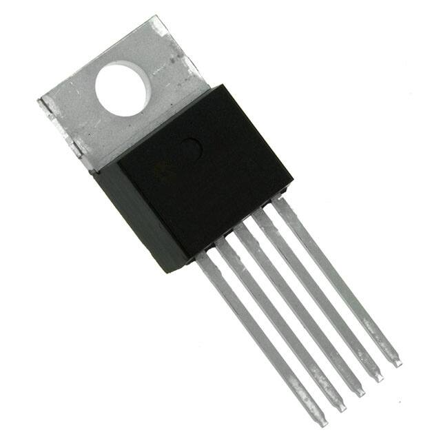

MCP1826/MCP1826S 1000 mA, Low-Voltage, Low Quiescent Current LDO Regulator Features Description • 1000 mA Output Current Capability • Input Operating Voltage Range: 2.3V to 6.0V • Adjustable Output Voltage Range: 0.8V to 5.0V (MCP1826 only) • Standard Fixed Output Voltages: - 0.8V, 1.2V, 1.8V, 2.5V, 3.0V, 3.3V, 5.0V • Other Fixed Output Voltage Options Available Upon Request • Low Dropout Voltage: 250 mV Typical at 1000 mA • Typical Output Voltage Tolerance: 0.5% • Stable with 1.0 µF Ceramic Output Capacitor • Fast Response to Load Transients • Low Supply Current: 120 µA (typ) • Low Shutdown Supply Current: 0.1 µA (typ) (MCP1826 only) • Fixed Delay on Power Good Output (MCP1826 only) • Short Circuit Current Limiting and Overtemperature Protection • TO-263-5 (DDPAK-5), TO-220-5, SOT-223-5 Package Options (MCP1826) • TO-263-3 (DDPAK-3), TO-220-3, SOT-223-3 Package Options (MCP1826S) • Pass Automotive AEC-Q100 Reliability Testing The MCP1826/MCP1826S is a 1000 mA Low Dropout (LDO) linear regulator that provides high-current and low-output voltages. The MCP1826 comes in a fixed or adjustable output voltage version, with an output voltage range of 0.8V to 5.0V. The 1000 mA output current capability, combined with the low-output voltage capability, make the MCP1826 a good choice for new sub-1.8V output voltage LDO applications that have high current demands. The MCP1826S is a 3-pin fixed voltage version. Applications: The MCP1826/MCP1826S is stable using ceramic output capacitors that inherently provide lower output noise and reduce the size and cost of the entire regulator solution. Only 1 µF of output capacitance is needed to stabilize the LDO. Using CMOS construction, the quiescent current consumed by the MCP1826/MCP1826S is typically less than 120 µA over the entire input voltage range, making it attractive for portable computing applications that demand high-output current. The MCP1826 versions have a Shutdown (SHDN) pin. When shut down, the quiescent current is reduced to less than 0.1 µA. On the MCP1826 fixed output versions the scaled-down output voltage is internally monitored and a power good (PWRGD) output is provided when the output is within 92% of regulation (typical). The PWRGD delay is internally fixed at 200 µs (typical). High-Speed Driver Chipset Power Networking Backplane Cards Notebook Computers Network Interface Cards Palmtop Computers The overtemperature and short circuit current-limiting provide additional protection for the LDO during system Fault conditions.  2007-2021 Microchip Technology Inc. DS20002057C-page 1 • • • • • MCP1826/MCP1826S Package Types MCP1826 DDPAK-5 MCP1826S TO-220-5 Fixed/Adjustable DDPAK-3 1 2 TO-220-3 3 1 1 2 3 4 5 2 3 1 2 3 4 5 SOT-223-5 SOT-223-3 6 4 1 2 3 4 1 5 2 3 Pin Fixed Adjustable Pin 1 SHDN SHDN 1 VIN 2 VIN VIN 2 GND (TAB) 3 GND (TAB) GND (TAB) 3 VOUT 4 VOUT VOUT 4 GND (TAB) 5 PWRGD ADJ 6 GND (TAB) GND (TAB) DS20002057C-page 2  2007-2021 Microchip Technology Inc. MCP1826/MCP1826S Typical Application MCP1826 Fixed Output Voltage PWRGD R1 100 k On SHDN Off VIN = 2.3V to 2.8V 1 VIN VOUT = 1.8V @ 1000 mA VOUT GND C1 4.7 µF C2 1 µF MCP1826 Adjustable Output Voltage VADJ R1 40 k On R2 20 k SHDN Off VIN = 2.3V to 2.8V VIN 1 VOUT C1 4.7 µF GND  2007-2021 Microchip Technology Inc. VOUT = 1.2V @ 1000 mA C2 1 µF DS20002057C-page 3 MCP1826/MCP1826S Functional Block Diagram – Adjustable Output PMOS VIN VOUT Undervoltage Lockout (UVLO) ISNS Cf Rf SHDN ADJ/SENSE Overtemperature Sensing + Driver w/limit and SHDN EA – SHDN VREF V IN SHDN Reference Soft-Start Comp TDELAY GND 92% of VREF DS20002057C-page 4  2007-2021 Microchip Technology Inc. MCP1826/MCP1826S Functional Block Diagram – Fixed Output (3-Pin) PMOS VIN VOUT Undervoltage Lockout (UVLO) Sense ISNS Cf Rf SHDN Overtemperature Sensing + Driver w/limit and SHDN EA – SHDN VREF V IN SHDN Reference Soft-Start Comp TDELAY GND 92% of VREF  2007-2021 Microchip Technology Inc. DS20002057C-page 5 MCP1826/MCP1826S Functional Block Diagram – Fixed Output (5-Pin) PMOS VIN VOUT Undervoltage Lockout (UVLO) Sense ISNS Cf Rf SHDN Overtemperature Sensing + Driver w/limit and SHDN EA – SHDN VREF V IN SHDN Reference Soft-Start Comp GND TDELAY PWRGD 92% of VREF DS20002057C-page 6  2007-2021 Microchip Technology Inc. MCP1826/MCP1826S 1.0 ELECTRICAL CHARACTERISTICS Absolute Maximum Ratings † VIN ....................................................................................6.5V † Notice: Stresses above those listed under “Maximum Ratings” may cause permanent damage to the device. This is a stress rating only and functional operation of the device at those or any other conditions above those indicated in the operational listings of this specification is not implied. Exposure to maximum rating conditions for extended periods may affect device reliability. Maximum Voltage on Any Pin .. (GND – 0.3V) to (VDD + 0.3)V Maximum Power Dissipation......... Internally-Limited (Note 6) Output Short Circuit Duration ................................ Continuous Storage temperature .....................................-65°C to +150°C Maximum Junction Temperature, TJ ........................... +150°C ESD protection on all pins (HBM/MM)   4 kV;  300V AC/DC CHARACTERISTICS Electrical Specifications: Unless otherwise noted, VIN = VOUT(MAX) + VDROPOUT(MAX), Note 1, VR=1.8V for Adjustable Output, IOUT = 1 mA, CIN = COUT = 4.7 µF (X7R Ceramic), TA = +25°C. Boldface type applies for junction temperatures, TJ (Note 7) of -40°C to +125°C Parameters Sym. Min. Typ. Max. Input Operating Voltage VIN 2.3 Input Quiescent Current Iq Input Quiescent Current for SHDN Mode Maximum Output Current 6.0 V Note 1 — 120 220 µA IL = 0 mA, VOUT = 0.8V to 5.0V ISHDN — 0.1 3 µA SHDN = GND IOUT 1000 — — mA VIN = 2.3V to 6.0V VR = 0.8V to 5.0V, Note 1 Line Regulation VOUT/ (VOUT x VIN) — ±0.05 ±0.20 %/V (Note 1) VIN 6V Load Regulation VOUT/VOUT -1.0 ±0.5 1.0 % IOUT = 1 mA to 1000 mA, (Note 4) IOUT_SC — 2.2 — A RLOAD < 0.1, Peak Current Output Short Circuit Current Units Conditions Adjust Pin Characteristics (Adjustable Output Only) Adjust Pin Reference Voltage VADJ 0.402 0.410 0.418 V VIN = 2.3V to VIN = 6.0V, IOUT = 1 mA Adjust Pin Leakage Current IADJ -10 ±0.01 +10 nA VIN = 6.0V, VADJ = 0V to 6V TCVOUT — 40 — ppm/°C Note 3 V Note 2 Adjust Temperature Coefficient Fixed-Output Characteristics (Fixed Output Only) Voltage Regulation Note 1: 2: 3: 4: 5: 6: 7: VOUT VR - 2.5% VR ±0.5% VR + 2.5% The minimum VIN must meet two conditions: VIN2.3V and VIN VOUT(MAX)VDROPOUT(MAX). VR is the nominal regulator output voltage for the fixed cases. VR = 1.2V, 1.8V, etc. VR is the desired set point output voltage for the adjustable cases. VR = VADJ * ((R1/R2)+1). Figure 4-1. TCVOUT = (VOUT-HIGH – VOUT-LOW) *106 / (VR * Temperature). VOUT-HIGH is the highest voltage measured over the temperature range. VOUT-LOW is the lowest voltage measured over the temperature range. Load regulation is measured at a constant junction temperature using low duty-cycle pulse testing. Load regulation is tested over a load range from 1 mA to the maximum specified output current. Dropout voltage is defined as the input-to-output voltage differential at which the output voltage drops 2% below its nominal value that was measured with an input voltage of VIN = VOUT(MAX) + VDROPOUT(MAX). The maximum allowable power dissipation is a function of ambient temperature, the maximum allowable junction temperature and the thermal resistance from junction to air. (i.e., TA, TJ, JA). Exceeding the maximum allowable power dissipation will cause the device operating junction temperature to exceed the maximum +150°C rating. Sustained junction temperatures above 150°C can impact device reliability. The junction temperature is approximated by soaking the device under test at an ambient temperature equal to the desired junction temperature. The test time is small enough such that the rise in the junction temperature over the ambient temperature is not significant.  2007-2021 Microchip Technology Inc. DS20002057C-page 7 MCP1826/MCP1826S AC/DC CHARACTERISTICS (CONTINUED) Electrical Specifications: Unless otherwise noted, VIN = VOUT(MAX) + VDROPOUT(MAX), Note 1, VR=1.8V for Adjustable Output, IOUT = 1 mA, CIN = COUT = 4.7 µF (X7R Ceramic), TA = +25°C. Boldface type applies for junction temperatures, TJ (Note 7) of -40°C to +125°C Parameters Sym. Min. Typ. Max. Units VDROPOUT — 250 400 mV VPWRGD_VIN 1.0 — 6.0 V 1.2 — 6.0 Conditions Dropout Characteristics Dropout Voltage Note 5, IOUT = 1000 mA, VIN(MIN) = 2.3V Power Good Characteristics PWRGD Input Voltage Operating Range TA = +25°C TA = -40°C to +125°C For VIN < 2.3V, ISINK = 100 µA PWRGD Threshold Voltage (Referenced to VOUT) %VOUT VPWRGD_TH Falling Edge 89 92 95 VOUT < 2.5V Fixed, VOUT = Adj. 90 92 94 VOUT >= 2.5V Fixed VPWRGD_HYS 1.0 2.0 3.0 %VOUT PWRGD Output Voltage Low VPWRGD_L — 0.2 0.4 V IPWRGD SINK = 1.2 mA, ADJ = 0V PWRGD Leakage PWRGD_LK — 1 — nA VPWRGD = VIN = 6.0V TPG — 125 — µs Rising Edge RPULLUP = 10 k TVDET-PWRGD — 200 — µs VOUT = VPWRGD_TH + 20 mV to VPWRGD_TH - 20 mV Logic High Input VSHDN-HIGH 45 — — %VIN Logic Low Input VSHDN-LOW — — 15 %VIN SHDNILK -0.1 ±0.001 +0.1 µA VIN = 6V, SHDN =VIN, SHDN = GND TOR — 100 — µs SHDN = GND to VIN VOUT = GND to 95% VR eN — 2.0 — µV/Hz PWRGD Threshold Hysteresis PWRGD Time Delay Detect Threshold to PWRGD Active Time Delay Shutdown Input SHDN Input Leakage Current VIN = 2.3V to 6.0V VIN = 2.3V to 6.0V AC Performance Output Delay From SHDN Output Noise Note 1: 2: 3: 4: 5: 6: 7: IOUT = 200 mA, f = 1 kHz, COUT = 10 µF (X7R Ceramic), VOUT = 2.5V The minimum VIN must meet two conditions: VIN2.3V and VIN VOUT(MAX)VDROPOUT(MAX). VR is the nominal regulator output voltage for the fixed cases. VR = 1.2V, 1.8V, etc. VR is the desired set point output voltage for the adjustable cases. VR = VADJ * ((R1/R2)+1). Figure 4-1. TCVOUT = (VOUT-HIGH – VOUT-LOW) *106 / (VR * Temperature). VOUT-HIGH is the highest voltage measured over the temperature range. VOUT-LOW is the lowest voltage measured over the temperature range. Load regulation is measured at a constant junction temperature using low duty-cycle pulse testing. Load regulation is tested over a load range from 1 mA to the maximum specified output current. Dropout voltage is defined as the input-to-output voltage differential at which the output voltage drops 2% below its nominal value that was measured with an input voltage of VIN = VOUT(MAX) + VDROPOUT(MAX). The maximum allowable power dissipation is a function of ambient temperature, the maximum allowable junction temperature and the thermal resistance from junction to air. (i.e., TA, TJ, JA). Exceeding the maximum allowable power dissipation will cause the device operating junction temperature to exceed the maximum +150°C rating. Sustained junction temperatures above 150°C can impact device reliability. The junction temperature is approximated by soaking the device under test at an ambient temperature equal to the desired junction temperature. The test time is small enough such that the rise in the junction temperature over the ambient temperature is not significant. DS20002057C-page 8  2007-2021 Microchip Technology Inc. MCP1826/MCP1826S AC/DC CHARACTERISTICS (CONTINUED) Electrical Specifications: Unless otherwise noted, VIN = VOUT(MAX) + VDROPOUT(MAX), Note 1, VR=1.8V for Adjustable Output, IOUT = 1 mA, CIN = COUT = 4.7 µF (X7R Ceramic), TA = +25°C. Boldface type applies for junction temperatures, TJ (Note 7) of -40°C to +125°C Parameters Sym. Min. Typ. Max. Units PSRR — 60 — dB f = 100 Hz, COUT = 4.7 µF, IOUT = 100 µA, VINAC = 100 mV pk-pk, CIN = 0 µF Thermal Shutdown Temperature TSD — 150 — °C IOUT = 100 µA, VOUT = 1.8V, VIN = 2.8V Thermal Shutdown Hysteresis TSD — 10 — °C IOUT = 100 µA, VOUT = 1.8V, VIN = 2.8V Power Supply Ripple Rejection Ratio Note 1: 2: 3: 4: 5: 6: 7: Conditions The minimum VIN must meet two conditions: VIN2.3V and VIN VOUT(MAX)VDROPOUT(MAX). VR is the nominal regulator output voltage for the fixed cases. VR = 1.2V, 1.8V, etc. VR is the desired set point output voltage for the adjustable cases. VR = VADJ * ((R1/R2)+1). Figure 4-1. TCVOUT = (VOUT-HIGH – VOUT-LOW) *106 / (VR * Temperature). VOUT-HIGH is the highest voltage measured over the temperature range. VOUT-LOW is the lowest voltage measured over the temperature range. Load regulation is measured at a constant junction temperature using low duty-cycle pulse testing. Load regulation is tested over a load range from 1 mA to the maximum specified output current. Dropout voltage is defined as the input-to-output voltage differential at which the output voltage drops 2% below its nominal value that was measured with an input voltage of VIN = VOUT(MAX) + VDROPOUT(MAX). The maximum allowable power dissipation is a function of ambient temperature, the maximum allowable junction temperature and the thermal resistance from junction to air. (i.e., TA, TJ, JA). Exceeding the maximum allowable power dissipation will cause the device operating junction temperature to exceed the maximum +150°C rating. Sustained junction temperatures above 150°C can impact device reliability. The junction temperature is approximated by soaking the device under test at an ambient temperature equal to the desired junction temperature. The test time is small enough such that the rise in the junction temperature over the ambient temperature is not significant. TEMPERATURE SPECIFICATIONS Parameters Sym. Min. Typ. Max. Units Conditions Temperature Ranges Operating Junction Temperature Range TJ -40 — +125 °C Steady State Maximum Junction Temperature TJ — — +150 °C Transient Storage Temperature Range TA -65 — +150 °C Thermal Package Resistances Thermal Resistance, 3L-DDPAK Thermal Resistance, 3L-TO-220 Thermal Resistance, 3L-SOT-223 Thermal Resistance, 5L-DDPAK Thermal Resistance, 5L-TO-220 Thermal Resistance, 5L-SOT-223  2007-2021 Microchip Technology Inc. JA — 31.4 — °C/W JC — 3.0 — °C/W JA — 29.4 — °C/W JC — 2.0 — °C/W JA — 62 — °C/W JC — 15.0 — °C/W JA — 31.2 — °C/W JC — 3.0 — °C/W JA — 29.3 — °C/W JC — 2.0 — °C/W JA — 62 — °C/W JC — 15.0 — °C/W 4-Layer JC51 Standard Board 4-Layer JC51 Standard Board EIA/JEDEC JESD51-751-7 4 Layer Board 4-Layer JC51 Standard Board 4-Layer JC51 Standard Board EIA/JEDEC JESD51-751-7 4 Layer Board DS20002057C-page 9 MCP1826/MCP1826S 2.0 TYPICAL PERFORMANCE CURVES Note: The graphs and tables provided following this note are a statistical summary based on a limited number of samples and are provided for informational purposes only. The performance characteristics listed herein are not tested or guaranteed. In some graphs or tables, the data presented may be outside the specified operating range (e.g., outside specified power supply range) and therefore outside the warranted range. Note: Unless otherwise indicated, COUT = 4.7 µF Ceramic (X7R), CIN = 4.7 µF Ceramic (X7R), IOUT = 1 mA, Temperature = +25°C, VIN = VOUT + 0.6V, Fixed output. 0.10 VOUT = 1.2V Adj IOUT = 0 mA 130 120 Line Regulation (%/V) Quiescent Current (μA) 140 130 CC +130 +90 +90 C C 110 +25 +25 C C 100 0C -45 C 90 IOUT = 1 mA 0.09 0.08 VOUT = 1.2V Adj VIN = 2.3V to 6.0V IOUT = 100 mA IOUT = 50 mA 0.07 0.06 0.05 IOUT = 250 mA 0.04 IOUT = 1000 mA 0.03 80 2 3 4 Input Voltage (V) 5 -45 6 FIGURE 2-1: Quiescent Current vs. Input Voltage (Adjustable Version). 5 30 0.15 Load Regulation (%) 160 150 VIN = 5.0V 140 VIN = 3.3V 130 120 110 VIN = 2.3V 0 130 IOUT = 1.0 mA to 1000 mA VOUT = 3.3V 0.10 0.05 VOUT = 1.8V 0.00 VOUT = 0.8V VOUT = 5.0V -0.05 -0.10 250 500 750 -45 1000 -20 5 30 55 80 105 130 Temperature (°C) Load Current (mA) FIGURE 2-2: Ground Current vs. Load Current (Adjustable Version). FIGURE 2-5: Load Regulation vs. Temperature (Adjustable Version). 0.411 VOUT = 1.2V Adj IOUT = 0 mA Adjust Pin Voltage (V) Quiescent Current (μA) 105 -0.15 100 140 135 130 125 120 115 110 105 100 95 90 85 80 FIGURE 2-4: Line Regulation vs. Temperature (Adjustable Version). VOUT = 1.2V Adj 170 55 Temperature (°C) 180 Ground Current (μA) -20 VIN = 6.0V VIN = 5.0V VIN = 4.0V VIN = 3.0V VOUT = 1.2V IOUT = 1.0 mA VIN = 6.0V 0.410 VIN = 5.0V 0.409 0.408 VIN = 2.3V 0.407 VIN = 2.3V 0.406 -45 -20 5 30 55 80 105 Temperature (°C) FIGURE 2-3: Quiescent Current vs. Junction Temperature (Adjustable Version). DS20002057C-page 10 130 -45 -20 5 30 55 80 105 130 Temperature (°C) FIGURE 2-6: Adjust Pin Voltage vs. Temperature (Adjustable Version).  2007-2021 Microchip Technology Inc. MCP1826/MCP1826S Note: Unless otherwise indicated, COUT = 4.7 µF Ceramic (X7R), CIN = 4.7 µF Ceramic (X7R), IOUT = 1 mA, Temperature = +25°C, VIN = VOUT + 0.6V, Fixed output. 150 Quiescent Current (μA) Dropout Voltage (V) 0.30 0.25 0.20 VOUT = 5.0V Adj 0.15 VOUT = 2.5V Adj 0.10 0.05 0.00 0 200 400 600 800 VOUT = 0.8V IOUT = 0 mA 140 130 +130°C 120 +90°C +25°C 110 0°C 100 -45°C 90 1000 2 3 4 Input Voltage (V) Load Current (mA) FIGURE 2-7: Dropout Voltage vs. Load Current (Adjustable Version). Quiescent Current (μA) IOUT = 1.0A 0.31 VOUT = 5.0V Adj 0.28 0.25 VOUT = 2.5V Adj 0.22 0.19 Quiescent Current vs. Input VOUT = 2.5V IOUT = 0 mA 140 130 +130 C 120 +90 C 110 +25 C 0C 100 -45 C 90 80 -45 -20 5 30 55 80 105 3.0 130 3.5 4.0 FIGURE 2-8: Dropout Voltage vs. Temperature (Adjustable Version). 170 Ground Current (μA) 150 VIN = 6.0V 140 130 120 VIN = 5.0V VIN = 3.9V 110 VIN = 3.1V 100 -45 -20 5 30 55 80 FIGURE 2-11: Voltage. 200 VOUT = 2.5V IOUT= 0 mA 160 5.0 5.5 6.0 105 130 FIGURE 2-9: Power Good (PWRGD) Time Delay vs. Temperature. Quiescent Current vs. Input VIN = 2.3V for VR=0.8V VIN = 3.9V for VR=3.3V 180 160 VOUT=3.3V 140 120 VOUT=0.8V 100 80 60 0 250 500 750 1000 Load Current (mA) Temperature (°C)  2007-2021 Microchip Technology Inc. 4.5 Input Voltage (V) Temperature (°C) Power Good Time Delay (µS) 6 150 0.34 Dropout Voltage (V) FIGURE 2-10: Voltage. 5 FIGURE 2-12: Current. Ground Current vs. Load DS20002057C-page 11 MCP1826/MCP1826S Note: Unless otherwise indicated, COUT = 4.7 µF Ceramic (X7R), CIN = 4.7 µF Ceramic (X7R), IOUT = 1 mA, Temperature = +25°C, VIN = VOUT + 0.6V, Fixed output. 0.040 IOUT = 0 mA 125 Line Regulation (%/V) Quiescent Current (μA) 130 120 115 110 VOUT = 2.5V 105 100 95 VOUT = 0.8V 90 IOUT = 1 mA 0.035 0.030 VR = 2.5V VIN = 3.1 to 6.0V IOUT = 50 mA 0.025 IOUT = 250 mA 0.020 IOUT = 1000 mA IOUT = 500 mA 0.015 -45 -20 5 30 55 80 105 -45 130 -20 5 Temperature (°C) FIGURE 2-13: Temperature. 30 55 80 105 130 Temperature (°C) FIGURE 2-16: Temperature. Quiescent Current vs. Line Regulation vs. 0.50 VR = 0.8V 0.30 0.30 Load Regulation (%) ISHDN (μA) 0.40 VIN = 4.0V VIN = 6.0V VIN = 3.0V 0.20 VIN = 5.0V VIN = 2.3V 0.10 VOUT = 0.8V VIN = 2.3V IOUT = 1 mA to 1000 mA 0.20 0.10 0.00 -0.10 -0.20 -0.30 0.00 -45 -20 5 30 55 80 105 -45 130 -20 5 ISHDN vs. Temperature. 0.10 IOUT = 50 mA IOUT = 100 mA 0.06 0.04 IOUT = 1A 0.02 105 130 0.00 IOUT = 1 mA to 1000 mA -0.05 IOUT = 500mA 0.00 Load Regulation (%) Line Regulation (%/V) 0.08 80 FIGURE 2-17: Load Regulation vs. Temperature (VOUT < 2.5V Fixed). VOUT = 0.8V VIN = 2.3V to 6.0V IOUT = 1 mA 55 Temperature (°C) Temperature (°C) FIGURE 2-14: 30 VOUT = 2.5V -0.10 -0.15 -0.20 VOUT = 5.0V -0.25 -0.30 -0.35 -0.40 -45 -20 5 30 55 80 105 Temperature (°C) FIGURE 2-15: Temperature. DS20002057C-page 12 Line Regulation vs. 130 -45 -20 5 30 55 80 105 130 Temperature (°C) FIGURE 2-18: Load Regulation vs. Temperature (VOUT 2.5V Fixed).  2007-2021 Microchip Technology Inc. MCP1826/MCP1826S Note: Unless otherwise indicated, COUT = 4.7 µF Ceramic (X7R), CIN = 4.7 µF Ceramic (X7R), IOUT = 1 mA, Temperature = +25°C, VIN = VOUT + 0.6V, Fixed output. 10.000 VR=0.8V, VIN=2.3V 0.25 VOUT = 2.5V Noise (P PV/— —Hz) Dropout Voltage (V) 0.30 0.20 0.15 VOUT = 5.0V 0.10 1.000 IOUT=200 mA VR=3.3V, VIN=4.1V 0.100 0.05 0.00 0 200 400 600 800 0.010 0.01 1000 0.1 Load Current (mA) FIGURE 2-19: Current. Dropout Voltage vs. Load PSRR (dB) Dropout Voltage (V) -20 0.26 VOUT = 5.0V -30 -40 VR=1.2V Adj COUT=10 μF ceramic X7R VIN=3.1V CIN=0 μF IOUT=10 mA -50 -60 0.22 -70 0.20 -20 5 30 55 80 105 -80 0.01 130 0.1 Temperature (°C) FIGURE 2-20: Temperature. 1000 0 VOUT = 2.5V -45 100 -10 0.28 0.24 10 FIGURE 2-22: Output Noise Voltage Density vs. Frequency. IOUT = 1000 mA 0.32 0.30 1 Frequency (kHz) 0.34 Dropout Voltage vs. 1 10 Frequency (kHz) 100 1000 FIGURE 2-23: Power Supply Ripple Rejection (PSRR) vs. Frequency (Adjustable). 0 2.00 1.80 1.60 1.40 1.20 1.00 0.80 0.60 0.40 0.20 0.00 VOUT = 0.8V -10 -20 PSRR (dB) Short Circuit Current (A) COUT=1 μF ceramic X7R CIN=10 μF ceramic -30 -40 VR=3.3V Fixed COUT=22 μF ceramic X7R VIN=3.9V CIN=0 μF IOUT=10 mA -50 -60 -70 0 1 2 3 4 5 6 Input Voltage (V) FIGURE 2-21: Input Voltage. Short Circuit Current vs.  2007-2021 Microchip Technology Inc. -80 0.01 0.1 1 10 Frequency (kHz) 100 1000 FIGURE 2-24: Power Supply Ripple Rejection (PSRR) vs. Frequency. DS20002057C-page 13 MCP1826/MCP1826S Note: Unless otherwise indicated, COUT = 4.7 µF Ceramic (X7R), CIN = 4.7 µF Ceramic (X7R), IOUT = 1 mA, Temperature = +25°C, VIN = VOUT + 0.6V, Fixed output. FIGURE 2-25: VIN. 2.5V (Adj.) Start-up from FIGURE 2-28: FIGURE 2-26: Shutdown. 2.5V (Adj.) Start-up from FIGURE 2-29: Dynamic Load Response (10 mA to 1000 mA). FIGURE 2-27: Timing. Power Good (PWRGD) FIGURE 2-30: Dynamic Load Response (100 mA to 1000 mA). DS20002057C-page 14 Dynamic Line Response.  2007-2021 Microchip Technology Inc. MCP1826/MCP1826S 3.0 PIN DESCRIPTION The descriptions of the pins are listed in Table 3-1. TABLE 3-1: 3-Pin Fixed Output 5-Pin Fixed Output Adjustable Output Name Description Shutdown Control Input (active-low) — 1 1 SHDN 1 2 2 VIN 2 3 3 GND Ground Regulated Output Voltage Input Voltage Supply 3 4 4 VOUT — 5 — PWRGD — — 5 ADJ Voltage Adjust/Sense Input EP Exposed Pad of the Package (ground potential) Exposed Pad 3.1 PIN FUNCTION TABLE Exposed Pad Exposed Pad Shutdown Control Input (SHDN) Power Good Output 3.5 Power Good Output (PWRGD) The SHDN input is used to turn the LDO output voltage on and off. When the SHDN input is at a logic-high level, the LDO output voltage is enabled. When the SHDN input is pulled to a logic-low level, the LDO output voltage is disabled. When the SHDN input is pulled low, the PWRGD output also goes low and the LDO enters a low quiescent current shutdown state where the typical quiescent current is 0.1 µA. The PWRGD output is an open-drain output used to indicate when the LDO output voltage is within 92% (typically) of its nominal regulation value. The PWRGD threshold has a typical hysteresis value of 2%. The PWRGD output is delayed by 200 µs (typical) from the time the LDO output is within 92% + 3% (max hysteresis) of the regulated output value on power-up. This delay time is internally fixed. 3.2 3.6 Input Voltage Supply (VIN) Output Voltage Adjust Input (ADJ) Connect the unregulated or regulated input voltage source to VIN. If the input voltage source is located several inches away from the LDO, or the input source is a battery, it is recommended that an input capacitor be used. A typical input capacitance value of 1 µF to 10 µF should be sufficient for most applications. For adjustable applications, the output voltage is connected to the ADJ input through a resistor divider that sets the output voltage regulation value. This provides the user the capability to set the output voltage to any value they desire within the 0.8V to 5.0V range of the device. 3.3 3.7 Ground (GND) Connect the GND pin of the LDO to a quiet circuit ground. This will help the LDO power supply rejection ratio and noise performance. The ground pin of the LDO only conducts the quiescent current of the LDO (typically 120 µA), so a heavy trace is not required. For applications have switching or noisy inputs tie the GND pin to the return of the output capacitor. Ground planes help lower inductance and voltage spikes caused by fast transient load currents and are recommended for applications that are subjected to fast load transients. 3.4 Exposed Pad (EP) The DDPAK and TO-220 package have an exposed tab on the package. A heat sink may be mounted to the tab to aid in the removal of heat from the package during operation. The exposed tab is at the ground potential of the LDO. Regulated Output Voltage (VOUT) The VOUT pin is the regulated output voltage of the LDO. A minimum output capacitance of 1.0 µF is required for LDO stability. The MCP1826/MCP1826S is stable with ceramic, tantalum and aluminum-electrolytic capacitors. See Section 4.3 “Output Capacitor” for output capacitor selection guidance.  2007-2021 Microchip Technology Inc. DS20002057C-page 15 MCP1826/MCP1826S 4.0 DEVICE OVERVIEW EQUATION 4-2: The MCP1826/MCP1826S is a high output current, Low Dropout (LDO) voltage regulator. The low dropout voltage of 300 mV typical at 1000 mA of current makes it ideal for battery-powered applications. Unlike other high output current LDOs, the MCP1826/MCP1826S only draws a maximum of 220 µA of quiescent current. The MCP1826 has a shutdown control input and a power good output. 4.1 The 5-pin MCP1826 LDO is available with either a fixed output voltage or an adjustable output voltage. The output voltage range is 0.8V to 5.0V for both versions. The 3-pin MCP1826S LDO is available as a fixed voltage device. 4.1.1 ADJUST INPUT The adjustable version of the MCP1826 uses the ADJ pin (pin 5) to get the output voltage feedback for output voltage regulation. This allows the user to set the output voltage of the device with two external resistors. The nominal voltage for ADJ is 0.41V. Figure 4-1 shows the adjustable version of the MCP1826. Resistors R1 and R2 form the resistor divider network necessary to set the output voltage. With this configuration, the equation for setting VOUT is: EQUATION 4-1: VOUT = LDO Output Voltage VADJ = ADJ Pin Voltage (typically 0.41V) VOUT SHDN 1 2 3 4 5 R1 ADJ C2 1 µF VIN C1 4.7 µF GND LDO Output Voltage VADJ = ADJ Pin Voltage (typically 0.41V) Output Current and Current Limiting The MCP1826/MCP1826S also incorporates an output current limit. If the output voltage falls below 0.7V due to an overload condition (usually represents a shorted load condition), the output current is limited to 2.2A (typical). If the overload condition is a soft overload, the MCP1826/MCP1826S will supply higher load currents of up to 2.5A. The MCP1826/MCP1826S should not be operated in this condition continuously as it may result in failure of the device. However, this does allow for device usage in applications that have higher pulsed load currents having an average output current value of 1000 mA or less. Output Capacitor The MCP1826/MCP1826S requires a minimum output capacitance of 1 µF for output voltage stability. Ceramic capacitors are recommended because of their size, cost and environmental robustness qualities. MCP1826-ADJ On = The MCP1826/MCP1826S LDO is tested and ensured to supply a minimum of 1000 mA of output current. The MCP1826/MCP1826S has no minimum output load, so the output load current can go to 0 mA and the LDO will continue to regulate the output voltage to within tolerance. 4.3 Off VOUT Output overload conditions may also result in an over-temperature shutdown of the device. If the junction temperature rises above 150°C, the LDO will shut down the output voltage. See Section 4.8 “Overtemperature Protection” for more information on overtemperature shutdown. R1 + R2 V OUT = V ADJ  ------------------  R2  Where: Where: 4.2 LDO Output Voltage V OUT – V ADJ R 1 = R 2  --------------------------------   V ADJ R2 FIGURE 4-1: Typical adjustable output voltage application circuit. Aluminum-electrolytic and tantalum capacitors can be used on the LDO output as well. The Equivalent Series Resistance (ESR) of the electrolytic output capacitor must be no greater than 1 ohm. The output capacitor should be located as close to the LDO output as is practical. Ceramic materials X7R and X5R have low temperature coefficients and are well within the acceptable ESR range required. A typical 1 µF X7R 0805 capacitor has an ESR of 50 milli-ohms. The allowable resistance value range for resistor R2 is from 10 k to 200 k. Solving the equation for R1 yields the following equation: DS20002057C-page 16  2007-2021 Microchip Technology Inc. MCP1826/MCP1826S Larger LDO output capacitors can be used with the MCP1826/MCP1826S to improve dynamic performance and power supply ripple rejection performance. A maximum of 22 µF is recommended. Aluminum-electrolytic capacitors are not recommended for low-temperature applications of  -25°C. 4.4 Input Capacitor Low input source impedance is necessary for the LDO output to operate properly. When operating from batteries, or in applications with long lead length (> 10 inches) between the input source and the LDO, some input capacitance is recommended. A minimum of 1.0 µF to 4.7 µF is recommended for most applications. For applications that have output step load requirements, the input capacitance of the LDO is very important. The input capacitance provides the LDO with a good local low-impedance source to pull the transient currents from in order to respond quickly to the output load step. For good step response performance, the input capacitor should be of equivalent (or higher) value than the output capacitor. The capacitor should be placed as close to the input of the LDO, as is practical. Larger input capacitors will also help reduce any high-frequency noise on the input and output of the LDO and reduce the effects of any inductance that exists between the input source voltage and the input capacitance of the LDO. 4.5 Power Good Output (PWRGD) The PWRGD output is used to indicate when the output voltage of the LDO is within 92% (typical value, see Section 1.0 “Electrical Characteristics” for Minimum and Maximum specifications) of its nominal regulation value. As the output voltage of the LDO rises, the PWRGD output will be held low until the output voltage has exceeded the power good threshold plus the hysteresis value. Once this threshold has been exceeded, the power good time delay is started (shown as TPG in the Electrical Characteristics table). The power good time delay is fixed at 125 µs (typical). After the time delay period, the PWRGD output will go high, indicating that the output voltage is stable and within regulation limits. If the output voltage of the LDO falls below the power good threshold, the power good output will transition low. The power good circuitry has a 200 µs delay when detecting a falling output voltage, which helps to increase noise immunity of the power good output and avoid false triggering of the power good output during fast output transients. See Figure 4-2 for power good timing characteristics.  2007-2021 Microchip Technology Inc. When the LDO is put into Shutdown mode using the SHDN input, the power good output is pulled low immediately, indicating that the output voltage will be out of regulation. The timing diagram for the power good output when using the shutdown input is shown in Figure 4-3. The power good output is an open-drain output that can be pulled up to any voltage that is equal to or less than the LDO input voltage. This output is capable of sinking 1.2 mA (VPWRGD < 0.4V maximum). VPWRGD_TH VOUT TPG VOH TVDET_PWRGD PWRGD VOL FIGURE 4-2: VIN Power Good Timing. TOR 30 µs SHDN 70 µs TPG VOUT PWRGD FIGURE 4-3: Shutdown. Power Good Timing from DS20002057C-page 17 MCP1826/MCP1826S 4.6 Shutdown Input (SHDN) The SHDN input is an active-low input signal that turns the LDO on and off. The SHDN threshold is a percentage of the input voltage. The typical value of this shutdown threshold is 30% of VIN, with minimum and maximum limits over the entire operating temperature range of 45% and 15%, respectively. The SHDN input will ignore low-going pulses (pulses meant to shut down the LDO) that are up to 400 ns in pulse width. If the shutdown input is pulled low for more than 400 ns, the LDO will enter Shutdown mode. This small bit of filtering helps to reject any system noise spikes on the shutdown input signal. On the rising edge of the SHDN input, the shutdown circuitry has a 30 µs delay before allowing the LDO output to turn on. This delay helps to reject any false turn-on signals or noise on the SHDN input signal. After the 30 µs delay, the LDO output enters its soft-start period as it rises from 0V to its final regulation value. If the SHDN input signal is pulled low during the 30 µs delay period, the timer will be reset and the delay time will start over again on the next rising edge of the SHDN input. The total time from the SHDN input going high (turn-on) to the LDO output being in regulation is typically 100 µs. See Figure 4-4 for a timing diagram of the SHDN input. TOR 400 ns (typ) 30 µs 70 µs VOUT DS20002057C-page 18 Shutdown Input Timing Dropout Voltage and Undervoltage Lockout Dropout voltage is defined as the input-to-output voltage differential at which the output voltage drops 2% below the nominal value that was measured with a + 0.5V differential applied. The VR MCP1826/MCP1826S LDO has a very low dropout voltage specification of 250 mV (typical) at 1000 mA of output current. See Section 1.0 “Electrical Characteristics” for maximum dropout voltage specifications. The MCP1826/MCP1826S LDO operates across an input voltage range of 2.3V to 6.0V and incorporates input Undervoltage Lockout (UVLO) circuitry that keeps the LDO output voltage off until the input voltage reaches a minimum of 2.00V (typical) on the rising edge of the input voltage. As the input voltage falls, the LDO output will remain on until the input voltage level reaches 1.82V (typical). Since the MCP1826/MCP1826S LDO undervoltage lockout activates at 1.82V as the input voltage is falling, the dropout voltage specification does not apply for output voltages that are less than 1.8V. For high-current applications, voltage drops across the PCB traces must be taken into account. The trace resistances can cause significant voltage drops between the input voltage source and the LDO. For applications with input voltages near 2.3V, these PCB trace voltage drops can sometimes lower the input voltage enough to trigger a shutdown due to undervoltage lockout. 4.8 SHDN FIGURE 4-4: Diagram. 4.7 Overtemperature Protection The MCP1826/MCP1826S LDO has temperature-sensing circuitry to prevent the junction temperature from exceeding approximately 150°C. If the LDO junction temperature does reach 150°C, the LDO output will be turned off until the junction temperature cools to approximately 140°C, at which point the LDO output will automatically resume normal operation. If the internal power dissipation continues to be excessive, the device will again shut off. The junction temperature of the die is a function of power dissipation, ambient temperature and package thermal resistance. See Section 5.0 “Application Circuits/Issues” for more information on LDO power dissipation and junction temperature.  2007-2021 Microchip Technology Inc. MCP1826/MCP1826S 5.0 APPLICATION CIRCUITS/ISSUES 5.1 Typical Application The MCP1826/MCP1826S is used for applications that require high LDO output current and a power good output. In addition to the LDO pass element power dissipation, there is power dissipation within the MCP1826/MCP1826S as a result of quiescent or ground current. The power dissipation as a result of the ground current can be calculated using the following equation: EQUATION 5-2: P I  GND  = V IN  MAX   I VIN VOUT = 2.5V @ 1000 mA MCP1826-2.5 On Off SHDN 1 2 3 4 5 R1 10 k C2 10 µF VIN 3.3V C1 4.7 µF GND FIGURE 5-1: 5.1.1 Typical Application Circuit. APPLICATION CONDITIONS Package Type = TO-220-5 VIN maximum = 3.465V VIN minimum = 3.135V VDROPOUT (max) = 0.400V VOUT (typical) = 2.5V IOUT = 1000 mA maximum PDISS (typical) = 0.965W Temperature Rise = 28.27°C Power Calculations 5.2.1 PI(GND) = Power dissipation due to the quiescent current of the LDO VIN(MAX) = Maximum input voltage IVIN = Current flowing in the VIN pin with no LDO output current (LDO quiescent current) PWRGD Input Voltage Range = 3.3V ± 5% 5.2 Where: POWER DISSIPATION The internal power dissipation within the MCP1826/MCP1826S is a function of input voltage, output voltage, output current and quiescent current. Equation 5-1 can be used to calculate the internal power dissipation for the LDO. The total power dissipated within the MCP1826/MCP1826S is the sum of the power dissipated in the LDO pass device and the P(IGND) term. Because of the CMOS construction, the typical IGND for the MCP1826/MCP1826S is 120 µA. Operating at a maximum VIN of 3.465V results in a power dissipation of 0.12 milli-Watts for a 2.5V output. For most applications, this is small compared to the LDO pass device power dissipation and can be neglected. The maximum continuous operating junction temperature specified for the MCP1826/MCP1826S is +125°C. To estimate the internal junction temperature of the MCP1826/MCP1826S, the total internal power dissipation is multiplied by the thermal resistance from junction-to-ambient (RJA) of the device. The thermal resistance from junction to ambient for the TO-220-5 package is estimated at 29.3°C/W. EQUATION 5-3: T J  MAX  = P TOTAL  R JA + T A  MAX  TJ(MAX) = Maximum continuous junction temperature PTOTAL = Total device power dissipation RJA = Thermal resistance from junction to ambient EQUATION 5-1: P LDO =  V IN  MAX  – V OUT  MIN    I OUT  MAX  TA(MAX) = Maximum ambient temperature Where: PLDO = LDO Pass device internal power dissipation VIN(MAX) = Maximum input voltage VOUT(MIN) = LDO minimum output voltage  2007-2021 Microchip Technology Inc. DS20002057C-page 19 MCP1826/MCP1826S The maximum power dissipation capability for a package can be calculated given the junction-to-ambient thermal resistance and the maximum ambient temperature for the application. Equation 5-4 can be used to determine the package maximum internal power dissipation. EQUATION 5-4: P D  MAX   T J  MAX  – T A  MAX   = --------------------------------------------------R JA PD(MAX) = Maximum device power dissipation TJ(MAX) = Maximum continuous junction temperature TA(MAX) = Maximum ambient temperature 5.3 Typical Application Internal power dissipation, junction temperature rise, junction temperature and maximum power dissipation is calculated in the following example. The power dissipation as a result of ground current is small enough to be neglected. 5.3.1 POWER DISSIPATION EXAMPLE Package Package Type = TO-220-5 Input Voltage VIN = 3.3V ± 5% LDO Output Voltage and Current VOUT = 2.5V RJA = Thermal resistance from junction to ambient IOUT = 1000 mA Maximum Ambient Temperature EQUATION 5-5: T J  RISE  = P D  MAX   R JA TA(MAX) = 60°C Internal Power Dissipation PLDO(MAX) = (VIN(MAX) – VOUT(MIN)) x IOUT(MAX) TJ(RISE) = Rise in device junction temperature over the ambient temperature PLDO = ((3.3V x 1.05) – (2.5V x 0.975)) x 1000 mA PD(MAX) = Maximum device power dissipation PLDO = 1.028 Watts RJA = Thermal resistance from junction to ambient EQUATION 5-6: T J = T J  RISE  + T A TJ = Junction temperature TJ(RISE) = Rise in device junction temperature over the ambient temperature TA = Ambient temperature 5.3.1.1 Device Junction Temperature Rise The internal junction temperature rise is a function of internal power dissipation and the thermal resistance from junction to ambient for the application. The thermal resistance from junction-to-ambient (RJA) is derived from EIA/JEDEC standards for measuring thermal resistance. The EIA/JEDEC specification is JESD51. The standard describes the test method and board specifications for measuring the thermal resistance from junction to ambient. The actual thermal resistance for a particular application can vary depending on many factors such as copper area and thickness. Refer to AN792, “A Method to Determine How Much Power a SOT23 Can Dissipate in an Application” (DS00792), for more information regarding this subject. TJ(RISE) = PTOTAL x RJA TJ(RISE) = 1.028 W x 29.3°C/W TJ(RISE) = 30.12°C DS20002057C-page 20  2007-2021 Microchip Technology Inc. MCP1826/MCP1826S 5.3.1.2 Junction Temperature Estimate To estimate the internal junction temperature, the calculated temperature rise is added to the ambient or offset temperature. For this example, the worst-case junction temperature is estimated below: TJ = TJ(RISE) + TA(MAX) TJ = 30.12°C + 60.0°C TJ = 90.12°C 5.3.1.3 Maximum Package Power Dissipation at 60°C Ambient Temperature TO-220-5 (29.3° C/W RJA): PD(MAX) = (125°C – 60°C) / 29.3°C/W PD(MAX) = 2.218W DDPAK-5 (31.2°C/Watt RJA): PD(MAX) = (125°C – 60°C)/ 31.2°C/W PD(MAX) = 2.083W From this table, you can see the difference in maximum allowable power dissipation between the TO-220-5 package and the DDPAK-5 package.  2007-2021 Microchip Technology Inc. DS20002057C-page 21 MCP1826/MCP1826S 6.0 PACKAGING INFORMATION 6.1 Package Marking Information 3-Lead DDPAK (MCP1826S) XXXXXXXXX XXXXXXXXX YYWWNNN 1 2 Example: MCP1826S e3 08EEB^^ 0730256 3 1 3-Lead SOT-223 (MCP1826S) 1826S08 EDB0730 256 3-Lead TO-220 (MCP1826S) Example: XXXXXXXXX XXXXXXXXX YYWWNNN MCP1826S 12EAB^^ e3 0730256 1 1 2 3 Legend: XX...X Y YY WW NNN e3 * DS20002057C-page 22 3 Example: XXXXXXX XXXYYWW NNN Note: 2 2 3 Customer-specific information Year code (last digit of calendar year) Year code (last 2 digits of calendar year) Week code (week of January 1 is week ‘01’) Alphanumeric traceability code Pb-free JEDEC designator for Matte Tin (Sn) This package is Pb-free. The Pb-free JEDEC designator ( e3 ) can be found on the outer packaging for this package. In the event the full Microchip part number cannot be marked on one line, it will be carried over to the next line, thus limiting the number of available characters for customer-specific information.  2007-2021 Microchip Technology Inc. MCP1826/MCP1826S Package Marking Information (Continued) 5-Lead DDPAK (MCP1826) XXXXXXXXX XXXXXXXXX YYWWNNN MCP1826 e3 10EET^^ 0730256 1 2 3 4 5 1 2 3 4 5 5-Lead SOT-223 (MCP1826) XXXXXXX XXXYYWW NNN 5-Lead TO-220 (MCP1826) Example: 1826-08 EDC0730 256 Example: XXXXXXXXX XXXXXXXXX YYWWNNN MCP1826 e3 08EAT^^ 0730256 1 2 3 4 5 1 2 3 4 5 Legend: XX...X Y YY WW NNN e3 * Note: Example: Customer-specific information Year code (last digit of calendar year) Year code (last 2 digits of calendar year) Week code (week of January 1 is week ‘01’) Alphanumeric traceability code Pb-free JEDEC designator for Matte Tin (Sn) This package is Pb-free. The Pb-free JEDEC designator ( e3 ) can be found on the outer packaging for this package. In the event the full Microchip part number cannot be marked on one line, it will be carried over to the next line, thus limiting the number of available characters for customer-specific information.  2007-2021 Microchip Technology Inc. DS20002057C-page 23 MCP1826/MCP1826S         )RUWKHPRVWFXUUHQWSDFNDJHGUDZLQJVSOHDVHVHHWKH0LFURFKLS3DFNDJLQJ6SHFLILFDWLRQORFDWHGDW KWWSZZZPLFURFKLSFRPSDFNDJLQJ E E1 L1 D1 D H 1 N b e BOTTOM VIEW TOP VIEW b1 CHAMFER OPTIONAL C2 A φ c A1 L 8QLWV 'LPHQVLRQ/LPLWV 1XPEHURI3LQV ,1&+(6 0,1 1 120 0$;  3LWFK H 2YHUDOO+HLJKW $  %6& ± 6WDQGRII† $  ±  2YHUDOO:LGWK (  ±  ([SRVHG3DG:LGWK (  ± ± 0ROGHG3DFNDJH/HQJWK '  ±  2YHUDOO/HQJWK +  ±  ([SRVHG3DG/HQJWK '  ± ± /HDG7KLFNQHVV F  ±  3DG7KLFNQHVV  &  ±  /RZHU/HDG:LGWK E  ±  8SSHU/HDG:LGWK E  ±  )RRW/HQJWK /  ±  3DG/HQJWK / ± ±  )RRW$QJOH  ƒ ± ƒ     †6LJQLILFDQW&KDUDFWHULVWLF  'LPHQVLRQV'DQG(GRQRWLQFOXGHPROGIODVKRUSURWUXVLRQV0ROGIODVKRUSURWUXVLRQVVKDOOQRWH[FHHGSHUVLGH  'LPHQVLRQLQJDQGWROHUDQFLQJSHU$60(
MCP1826-3002E/AT
- 物料型号:MCP1826/MCP1826S - 器件简介:提供1000mA的输出电流能力,输入工作电压范围2.3V至6.0V,具有可调节或固定输出电压版本,适用于高速驱动芯片集电源、网络背板卡、笔记本电脑、网络接口卡、掌上电脑等应用。 - 引脚分配: - MCP1826(5引脚):1. SHDN(关闭控制输入),2. VIN(输入电压供应),3. GND(TAB),4. VOUT(调节输出电压),5. PWRGD(电源良好输出)/ADJ(可调版本) - MCP1826S(3引脚):1. VIN,2. GND(TAB),3. VOUT - 参数特性: - 输出电流能力:1000 mA - 低 dropout 电压:典型值 250 mV(在1000 mA时) - 输出电压容差:典型值 0.5% - 稳定工作:仅需1.0 µF陶瓷输出电容器 - 快速响应负载瞬变 - 低供电电流:典型值 120 µA - 低关闭供电电流:典型值 0.1 µA(仅限MCP1826) - 过温和短路保护 - 功能详解:MCP1826/MCP1826S使用CMOS结构,具有低静态电流,适合便携式计算应用。MCP1826版本具有关闭(SHDN)引脚,关闭时静态电流降至0.1 µA以下。固定输出版本的MCP1826内部监控缩放的输出电压,并在输出在规定值的92%以内时提供电源良好(PWRGD)输出。 - 应用信息:适用于需要高输出电流和电源良好输出的多种应用,如高速驱动芯片集电源、网络背板卡、笔记本电脑等。 - 封装信息:提供TO-263-5 (DDPAK-5)、TO-220-5、SOT-223-5封装选项(MCP1826),以及TO-263-3 (DDPAK-3)、TO-220-3、SOT-223-3封装选项(MCP1826S)。
