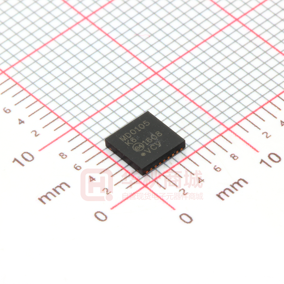

MD0105 4-Channel High-Voltage Protection T/R Switch Features General Description • • • • • The MD0105 is a high-voltage current-limiting protection device. It is designed to protect a low-noise receiver from high-voltage transmit pulses in ultrasound applications. The MD0105 is commonly referred to as a T/R (transmit-and-receive) switch. Up to ±130V Input Voltage Protection Low On-Resistance – 15Ω Typical Fast Switching Speed Four Electrically Isolated Channels No External Supplies Needed The device can be considered as a normally closed switch with a typical switching resistance of 15Ω that allows small signals to pass. Once the voltage drop across the two terminals exceeds a nominal value of ±2V, the device will turn off. In the OFF state, the MD0105 can withstand up to ±130V across its terminals. A small amount of current (typically 200 µA) is allowed to flow through. Applications • • • • • Medical Ultrasound Imaging NDT Applications Fast Resettable Fuses High-Side Switches Data Acquisition The MD0105 is not limited to just ultrasound applications. It can also be used as resettable fuses to protect power lines, for output short-circuit protection and to protect data acquisition instruments. The MD0105 is available in an 18-lead 5 x 5 mm DFN package as a 4-channel device. Package Type 18-lead DFN (Top view) 1 18 NC A1 2 17 B1 NC 3 16 NC A2 4 15 B2 NC 5 14 NC A3 6 13 B3 NC 7 12 NC A4 8 11 B4 NC 9 10 NC NC See Table 2-1 for pin information. Pads are at the bottom of device.  2018 Microchip Technology Inc. DS20005739A-page 1 MD0105 Functional Block Diagram COM Switch Control A DS20005739A-page 2 B  2018 Microchip Technology Inc. MD0105 Typical Application Circuit +130V Piezo Transducers Transmitter -130V Logic Control and Signal Processing TX RX Receiver  2018 Microchip Technology Inc. B MD0105 T/R Switch A High Voltage Switches DS20005739A-page 3 MD0105 1.0 ELECTRICAL CHARACTERISTICS Absolute Maximum Ratings† Differential Voltage, VA-B ............................................................................................................................ 0V to +140V Maximum Junction Temperature, TJ ................................................................................................................... +125°C Storage Temperature, TS ..................................................................................................................... –65°C to +150°C Power Dissipation: 18-lead DFN ................................................................................................................................................. 1.6W † Notice: Stresses above those listed under “Absolute Maximum Ratings” may cause permanent damage to the device. This is a stress rating only, and functional operation of the device at those or any other conditions above those indicated in the operational sections of this specification is not intended. Exposure to maximum rating conditions for extended periods may affect device reliability. Note 1: Device is ESD sensitive. Handling precautions are recommended. DC ELECTRICAL CHARACTERISTICS Electrical Specifications: TJ = 25°C unless otherwise specified. Parameter Sym. Min. Typ. Max. Unit VA-B ±130 — — V IA-B = ±1 mA Switch-On Resistance from A to B RSW — 15 — Ω IA-B = ±5 mA VA-B Trip Point to Turn Off VTRIP — ±1 ±2 V VOFF — ±2 — V IA-B = ±1 mA IA-B(OFF) — ±200 ±300 µA VA-B = ±130V Max. Unit Maximum Differential Input Voltage from A to B Switch Turn-Off Voltage Switch-Off Current Conditions AC ELECTRICAL CHARACTERISTICS Electrical Specifications: TJ = 25°C unless otherwise specified. Parameter Sym. Min. Typ. Peak Switching Current IPEAK — ±60 — mA Turn-Off Time TOFF — — 20 ns Turn-On Time Conditions TON — — 20 ns Switch-On Capacitance from A to B CSW(ON) — 21 — pF SW = ON Switch-Off Capacitance from A to B CSW(OFF) — 15 — pF VSW = 25V BW — 100 — Sym. Min. Typ. Max. Unit Operating Junction Temperature TJ –40 — +125 °C Storage Temperature TS –65 — +150 °C JA — 40 — °C/W Small Signal Bandwidth MHz RLOAD = 50Ω TEMPERATURE SPECIFICATIONS Parameter Conditions TEMPERATURE RANGE PACKAGE THERMAL RESISTANCE 18-lead DFN Note 1: Note 1 Mounted on an FR4 board, 25 mm x 25 mm x 1.57 mm DS20005739A-page 4  2018 Microchip Technology Inc. MD0105 Typical I-V Characteristics +IPEAK IA-B IA-B = +200μA -130V -VOFF +1.0mA -VTRIP +VTRIP +1.0mA +VOFF VA-B +130V IA-B = -200μA RSW = 15Ω -IPEAK  2018 Microchip Technology Inc. DS20005739A-page 5 MD0105 2.0 PIN DESCRIPTION Functional descriptions for the pins are listed in Table 2-1. See Package Type for the location of pins. TABLE 2-1: PIN FUNCTION TABLE Pin Number Pin Name 1 NC No internal connection 2 A1 Switch Terminal A1 3 NC No internal connection 4 A2 Switch Terminal A2 5 NC No internal connection 6 A3 Switch Terminal A3 7 NC No internal connection 8 A4 Switch Terminal A4 9 NC No internal connection 10 NC No internal connection 11 B4 Switch Terminal B4 12 NC No internal connection 13 B3 Switch Terminal B3 14 NC No internal connection 15 B2 Switch Terminal B2 16 NC No internal connection 17 B1 Switch Terminal B1 18 NC No internal connection Center Tab DS20005739A-page 6 Description Connect to ground  2018 Microchip Technology Inc. MD0105 3.0 DETAILED DESCRIPTION The MD0105 can be considered as a normally closed switch controlled by a built-in control circuit. (See Functional Block Diagram.) The switch control circuit monitors the voltage drop across Terminals A and B. If the voltage difference is greater than ±2V, the T/R switch opens. Once in the Open state, there is a small amount of current flowing through the T/R switch (200 µA) to detect if the high voltage is still present. The T/R switch does not close until the voltage across Terminal A and Terminal B drops below ±2V. A pair of back-to-back diodes, from the receiver side of the switch to ground is needed to complete the circuit and allow the peak current (about 60 mA) to flow through the switch. If the diodes are not present, there is no current path and the voltage drop across Terminals A and B becomes less than ±2V. As a result, the switch remains in the closed position. 3.1 On Resistance When the voltage across Terminals A and B is below ±2V, the switch is in Receive mode and the RON is typically 15Ω. Once the voltage across Terminals A and B is greater than ±2V, the switch is in Transmit mode and prevents high-voltage pulses from passing through to the receiver. 3.2 Switch Capacitance The typical switch-on capacitance, CSW(ON), is 21 pF. This is measured from Terminal A to Terminal B when the switch is turned on. The switch-off capacitance is a function of the voltage across the T/R switch. The CSW(OFF) is about 12 pF to 19 pF for 10V to 130V of transmit voltage. 3.3 TON and TOFF Time TON and TOFF of the MD0105 are less than 20 ns, which provides a quick transition between Transmit Receive modes. The TON and TOFF are proportional to the rise and fall times of the transmit pulses.  2018 Microchip Technology Inc. DS20005739A-page 7 MD0105 4.0 PACKAGING INFORMATION 4.1 Package Marking Information 18-lead DFN XXXXXXX XXXXXXX e3 YYWW NNN Legend: XX...X Y YY WW NNN e3 * Note: DS20005739A-page 8 Example MD0105 K6 e3 1823 513 Product Code or Customer-specific information Year code (last digit of calendar year) Year code (last 2 digits of calendar year) Week code (week of January 1 is week ‘01’) Alphanumeric traceability code Pb-free JEDEC® designator for Matte Tin (Sn) This package is Pb-free. The Pb-free JEDEC designator ( e3 ) can be found on the outer packaging for this package. In the event the full Microchip part number cannot be marked on one line, it will be carried over to the next line, thus limiting the number of available characters for product code or customer-specific information. Package may or not include the corporate logo.  2018 Microchip Technology Inc. MD0105 Note: For the most current package drawings, see the Microchip Packaging Specification at www.microchip.com/packaging.  2018 Microchip Technology Inc. DS20005739A-page 9 MD0105 NOTES: DS20005739A-page 10  2018 Microchip Technology Inc. MD0105 APPENDIX A: REVISION HISTORY Revision A (November 2018) • Converted Supertex Doc# DSFP-MD0105 to Microchip DS20005739A • Changed the package marking format • Changed the quantity of the 18-lead DFN K6 M932 media type from 2500/Reel to 3300/Reel • Made minor text changes throughout the document  2018 Microchip Technology Inc. DS20005739A-page 11 MD0105 PRODUCT IDENTIFICATION SYSTEM To order or obtain information, e.g., on pricing or delivery, contact your local Microchip representative or sales office. XX PART NO. - Package Options Device X - Environmental X Media Type Device: MD0105 = 4-Channel High-Voltage Protection T/R Switch Package: K6 = 18-lead VDFN Environmental: G = Lead (Pb)-free/RoHS-compliant Package Media Type: (blank) = 490/Tray for a K6 Package M932 = 3300/Reel for a K6 Package DS20005739A-page 12 Examples: a) MD0105K6-G: 4-Channel High-Voltage Protection T/R Switch 18-lead VDFN, 490/Tray b) MD0105K6-G-M932: 4-Channel High-Voltage Protection T/R Switch 18-lead VDFN, 3300/Reel  2018 Microchip Technology Inc. Note the following details of the code protection feature on Microchip devices: • Microchip products meet the specification contained in their particular Microchip Data Sheet. • Microchip believes that its family of products is one of the most secure families of its kind on the market today, when used in the intended manner and under normal conditions. • There are dishonest and possibly illegal methods used to breach the code protection feature. All of these methods, to our knowledge, require using the Microchip products in a manner outside the operating specifications contained in Microchip’s Data Sheets. Most likely, the person doing so is engaged in theft of intellectual property. • Microchip is willing to work with the customer who is concerned about the integrity of their code. • Neither Microchip nor any other semiconductor manufacturer can guarantee the security of their code. Code protection does not mean that we are guaranteeing the product as “unbreakable.” Code protection is constantly evolving. We at Microchip are committed to continuously improving the code protection features of our products. Attempts to break Microchip’s code protection feature may be a violation of the Digital Millennium Copyright Act. If such acts allow unauthorized access to your software or other copyrighted work, you may have a right to sue for relief under that Act. Information contained in this publication regarding device applications and the like is provided only for your convenience and may be superseded by updates. It is your responsibility to ensure that your application meets with your specifications. MICROCHIP MAKES NO REPRESENTATIONS OR WARRANTIES OF ANY KIND WHETHER EXPRESS OR IMPLIED, WRITTEN OR ORAL, STATUTORY OR OTHERWISE, RELATED TO THE INFORMATION, INCLUDING BUT NOT LIMITED TO ITS CONDITION, QUALITY, PERFORMANCE, MERCHANTABILITY OR FITNESS FOR PURPOSE. Microchip disclaims all liability arising from this information and its use. Use of Microchip devices in life support and/or safety applications is entirely at the buyer’s risk, and the buyer agrees to defend, indemnify and hold harmless Microchip from any and all damages, claims, suits, or expenses resulting from such use. No licenses are conveyed, implicitly or otherwise, under any Microchip intellectual property rights unless otherwise stated. Trademarks Microchip received ISO/TS-16949:2009 certification for its worldwide headquarters, design and wafer fabrication facilities in Chandler and Tempe, Arizona; Gresham, Oregon and design centers in California and India. The Company’s quality system processes and procedures are for its PIC® MCUs and dsPIC® DSCs, KEELOQ® code hopping devices, Serial EEPROMs, microperipherals, nonvolatile memory and analog products. In addition, Microchip’s quality system for the design and manufacture of development systems is ISO 9001:2000 certified. SQTP is a service mark of Microchip Technology Incorporated in the U.S.A. QUALITY MANAGEMENT SYSTEM CERTIFIED BY DNV The Microchip name and logo, the Microchip logo, AnyRate, AVR, AVR logo, AVR Freaks, BitCloud, chipKIT, chipKIT logo, CryptoMemory, CryptoRF, dsPIC, FlashFlex, flexPWR, Heldo, JukeBlox, KeeLoq, Kleer, LANCheck, LINK MD, maXStylus, maXTouch, MediaLB, megaAVR, MOST, MOST logo, MPLAB, OptoLyzer, PIC, picoPower, PICSTART, PIC32 logo, Prochip Designer, QTouch, SAM-BA, SpyNIC, SST, SST Logo, SuperFlash, tinyAVR, UNI/O, and XMEGA are registered trademarks of Microchip Technology Incorporated in the U.S.A. and other countries. ClockWorks, The Embedded Control Solutions Company, EtherSynch, Hyper Speed Control, HyperLight Load, IntelliMOS, mTouch, Precision Edge, and Quiet-Wire are registered trademarks of Microchip Technology Incorporated in the U.S.A. Adjacent Key Suppression, AKS, Analog-for-the-Digital Age, Any Capacitor, AnyIn, AnyOut, BodyCom, CodeGuard, CryptoAuthentication, CryptoAutomotive, CryptoCompanion, CryptoController, dsPICDEM, dsPICDEM.net, Dynamic Average Matching, DAM, ECAN, EtherGREEN, In-Circuit Serial Programming, ICSP, INICnet, Inter-Chip Connectivity, JitterBlocker, KleerNet, KleerNet logo, memBrain, Mindi, MiWi, motorBench, MPASM, MPF, MPLAB Certified logo, MPLIB, MPLINK, MultiTRAK, NetDetach, Omniscient Code Generation, PICDEM, PICDEM.net, PICkit, PICtail, PowerSmart, PureSilicon, QMatrix, REAL ICE, Ripple Blocker, SAM-ICE, Serial Quad I/O, SMART-I.S., SQI, SuperSwitcher, SuperSwitcher II, Total Endurance, TSHARC, USBCheck, VariSense, ViewSpan, WiperLock, Wireless DNA, and ZENA are trademarks of Microchip Technology Incorporated in the U.S.A. and other countries. Silicon Storage Technology is a registered trademark of Microchip Technology Inc. in other countries. GestIC is a registered trademark of Microchip Technology Germany II GmbH & Co. KG, a subsidiary of Microchip Technology Inc., in other countries. All other trademarks mentioned herein are property of their respective companies. © 2018, Microchip Technology Incorporated, All Rights Reserved. ISBN: 978-1-5224-3904-2 == ISO/TS 16949 ==  2018 Microchip Technology Inc. DS20005739A-page 13 Worldwide Sales and Service AMERICAS ASIA/PACIFIC ASIA/PACIFIC EUROPE Corporate Office 2355 West Chandler Blvd. Chandler, AZ 85224-6199 Tel: 480-792-7200 Fax: 480-792-7277 Technical Support: http://www.microchip.com/ support Web Address: www.microchip.com Australia - Sydney Tel: 61-2-9868-6733 India - Bangalore Tel: 91-80-3090-4444 China - Beijing Tel: 86-10-8569-7000 India - New Delhi Tel: 91-11-4160-8631 Austria - Wels Tel: 43-7242-2244-39 Fax: 43-7242-2244-393 China - Chengdu Tel: 86-28-8665-5511 India - Pune Tel: 91-20-4121-0141 Denmark - Copenhagen Tel: 45-4450-2828 Fax: 45-4485-2829 China - Chongqing Tel: 86-23-8980-9588 Japan - Osaka Tel: 81-6-6152-7160 Finland - Espoo Tel: 358-9-4520-820 China - Dongguan Tel: 86-769-8702-9880 Japan - Tokyo Tel: 81-3-6880- 3770 China - Guangzhou Tel: 86-20-8755-8029 Korea - Daegu Tel: 82-53-744-4301 France - Paris Tel: 33-1-69-53-63-20 Fax: 33-1-69-30-90-79 China - Hangzhou Tel: 86-571-8792-8115 Korea - Seoul Tel: 82-2-554-7200 China - Hong Kong SAR Tel: 852-2943-5100 Malaysia - Kuala Lumpur Tel: 60-3-7651-7906 China - Nanjing Tel: 86-25-8473-2460 Malaysia - Penang Tel: 60-4-227-8870 China - Qingdao Tel: 86-532-8502-7355 Philippines - Manila Tel: 63-2-634-9065 China - Shanghai Tel: 86-21-3326-8000 Singapore Tel: 65-6334-8870 China - Shenyang Tel: 86-24-2334-2829 Taiwan - Hsin Chu Tel: 886-3-577-8366 China - Shenzhen Tel: 86-755-8864-2200 Taiwan - Kaohsiung Tel: 886-7-213-7830 Israel - Ra’anana Tel: 972-9-744-7705 China - Suzhou Tel: 86-186-6233-1526 Taiwan - Taipei Tel: 886-2-2508-8600 China - Wuhan Tel: 86-27-5980-5300 Thailand - Bangkok Tel: 66-2-694-1351 Italy - Milan Tel: 39-0331-742611 Fax: 39-0331-466781 China - Xian Tel: 86-29-8833-7252 Vietnam - Ho Chi Minh Tel: 84-28-5448-2100 Atlanta Duluth, GA Tel: 678-957-9614 Fax: 678-957-1455 Austin, TX Tel: 512-257-3370 Boston Westborough, MA Tel: 774-760-0087 Fax: 774-760-0088 Chicago Itasca, IL Tel: 630-285-0071 Fax: 630-285-0075 Dallas Addison, TX Tel: 972-818-7423 Fax: 972-818-2924 Detroit Novi, MI Tel: 248-848-4000 Houston, TX Tel: 281-894-5983 Indianapolis Noblesville, IN Tel: 317-773-8323 Fax: 317-773-5453 Tel: 317-536-2380 Los Angeles Mission Viejo, CA Tel: 949-462-9523 Fax: 949-462-9608 Tel: 951-273-7800 Raleigh, NC Tel: 919-844-7510 New York, NY Tel: 631-435-6000 San Jose, CA Tel: 408-735-9110 Tel: 408-436-4270 Canada - Toronto Tel: 905-695-1980 Fax: 905-695-2078 DS20005739A-page 14 China - Xiamen Tel: 86-592-2388138 China - Zhuhai Tel: 86-756-3210040 Germany - Garching Tel: 49-8931-9700 Germany - Haan Tel: 49-2129-3766400 Germany - Heilbronn Tel: 49-7131-67-3636 Germany - Karlsruhe Tel: 49-721-625370 Germany - Munich Tel: 49-89-627-144-0 Fax: 49-89-627-144-44 Germany - Rosenheim Tel: 49-8031-354-560 Italy - Padova Tel: 39-049-7625286 Netherlands - Drunen Tel: 31-416-690399 Fax: 31-416-690340 Norway - Trondheim Tel: 47-7288-4388 Poland - Warsaw Tel: 48-22-3325737 Romania - Bucharest Tel: 40-21-407-87-50 Spain - Madrid Tel: 34-91-708-08-90 Fax: 34-91-708-08-91 Sweden - Gothenberg Tel: 46-31-704-60-40 Sweden - Stockholm Tel: 46-8-5090-4654 UK - Wokingham Tel: 44-118-921-5800 Fax: 44-118-921-5820  2018 Microchip Technology Inc. 08/15/18
