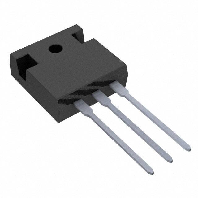

MIC2915X/30X/50X/75X High-Current Low Dropout Regulators Features General Description • High Current Capability: - MIC29150/29151/29152/29153: 1.5A - MIC29300/29301/29302/29303: 3A - MIC29500/29501/29502/29503: 5A - MIC29751/29752: 7.5A • Low Dropout Voltage • Low Ground Current • Accurate 1% Guaranteed Tolerance • Extremely Fast Transient Response • Reverse-Battery and “Load Dump” Protection • Zero-Current Shutdown Mode (5-Pin Versions) • Error Flag Signals Output Out-of-Regulation (5-Pin Versions) • Also Characterized for Smaller Loads with Industry-Leading Performance Specifications • Fixed-Voltage and Adjustable Versions The MIC2915x/2930x/2950x/2975x are high current, high accuracy, low dropout voltage regulators. Using Microchip’s proprietary Super βeta PNP process with a PNP pass element, these regulators feature 350 mV to 425 mV (full load) typical dropout voltages and very low ground current. Designed for high current loads, these devices also find applications in lower current, extremely low dropout-critical systems, where their tiny dropout voltage and ground current values are important attributes. The MIC2915x/2930x/2950x/2975x are fully protected against overcurrent faults, reversed input polarity, reversed lead insertion, overtemperature operation, and positive and negative transient voltage spikes. Five pin fixed-voltage versions feature logic level ON/OFF control and an error flag that signals whenever the output falls out of regulation. Flagged states include low input voltage (dropout), output current limit, overtemperature shutdown, and extremely high voltage spikes on the input. Applications • • • • • Battery-Powered Equipment High-Efficiency Green Computer Systems Automotive Electronics High-Efficiency Linear Power Supplies High-Efficiency Post-Regulator for Switching Supply On the MIC29xx1 and MIC29xx2, the ENABLE pin may be tied to VIN if it is not required for ON/OFF control. The MIC2915x/2930x/2950x are available in 3-pin and 5-pin TO-220 and surface mount TO-263 (D2Pak) packages. The MIC2975x 7.5A regulators are available in a 5-pin TO-247 package. The 1.5A, adjustable output MIC29152 is available in a 5-pin power D-Pak (TO-252) package. For applications with input voltage 6V or below, see MIC37xxx LDOs. Package Types MIC29151/301/501/751 5-Lead TO-220 Fixed Voltage (T) (Top View)  2016-2019 Microchip Technology Inc. 3 OUT 2 GND 1 IN TAB TAB MIC29150/300/500 3-Lead TO-220 (T) (Top View) 5 FLG 4 OUT 3 GND 2 IN 1 EN DS20005685B-page 1 MIC2915X/30X/50X/75X Package Types (Continued) MIC29153/303/503 5-Lead TO-220 Adjustable with Flag (T) (Top View) FLG OUT GND IN EN ADJ OUT GND IN EN TAB MIC29151/301/501 5-Lead TO-263 (D2Pak) Fixed Voltage (U) (Top View) 5 4 3 2 1 3 OUT 2 GND 1 IN MIC29302/502 5-Lead TO-263 (D2Pak) Adj. Voltage (U) (Top View) MIC29752 5-Lead TO-247 Adjustable Voltage (WT) (Top View) 5 4 3 2 1 TAB MIC29150/300 3-Lead TO-263 (D2Pak) (UT) (Top View) MIC29751 5-Lead TO-247 Fixed Voltage (WT) (Top View) 5 4 3 2 1 5 ADJ 4 OUT 3 GND 2 IN 1 FLG FLG OUT GND IN EN TAB TAB 5 ADJ 4 OUT 3 GND 2 IN 1 EN TAB MIC29152/302/502 5-Lead TO-220 Adjustable Voltage (T) (Top View) 5 4 3 2 1 ADJ OUT GND IN EN MIC29152 5-Lead TO-252 (D-Pak) Adjustable Voltage (D) (Top View) 5 4 3 2 1 ADJ OUT GND IN EN TAB MIC29153/303/503 5-Lead TO-263 (D2Pak) Adj. with Flag (U) (Top View) DS20005685B-page 2 5 4 3 2 1 ADJ OUT GND IN FLG  2016-2019 Microchip Technology Inc. MIC2915X/30X/50X/75X Typical Application Circuits MIC29300 Fixed Output Version MIC29152 Adjustable Output Version MIC29300-3.3 5V 3.3V @ 3A OUT IN MIC29152WD 3.3VIN IN 2.5VOUT@1.5A OUT 10μF Tantalum CIN *R1 ȍ CIN EN ADJ *R2 ȍ GND GND + 10μF Tantalum * See Minimum Load Current Section Functional Diagram IN OUT O.V. I LIMIT FLAG 1.180V REFERENCE 32V 1.240V R1* ADJ† EN THERMAL SHUTDOWN R2* GND * FEEDBACK NETWORK IN FIXED VERSIONS ONLY † ADJUSTABLE VERSION ONLY  2016-2019 Microchip Technology Inc. DS20005685B-page 3 MIC2915X/30X/50X/75X 1.0 ELECTRICAL CHARACTERISTICS Absolute Maximum Ratings † (Note 1) Input Supply Voltage (VIN) (Note 1)............................................................................................................. –20V to +60V Enable Input Voltage (VEN) ........................................................................................................................... –0.3V to VIN Power Dissipation...................................................................................................................................Internally Limited ESD Rating ............................................................................................................................................................ Note 2 Operating Ratings‡ Maximum Operating Input Voltage ............................................................................................................................+26V † Notice: Stresses above those listed under “Absolute Maximum Ratings” may cause permanent damage to the device. This is a stress rating only and functional operation of the device at those or any other conditions above those indicated in the operational sections of this specification is not intended. Exposure to maximum rating conditions for extended periods may affect device reliability. ‡ Notice: The device is not guaranteed to function outside its operating ratings. Note 1: Maximum positive supply voltage of 60V must be of limited duration (''3$.@ 1RWH )RUWKHPRVWFXUUHQWSDFNDJHGUDZLQJVSOHDVHVHHWKH0LFURFKLS3DFNDJLQJ6SHFLILFDWLRQORFDWHGDW KWWSZZZPLFURFKLSFRPSDFNDJLQJ E1 E L1 D1 D H 1 N b BOTTOM VIEW e TOP VIEW CHAMFER OPTIONAL C2 A φ c A1 L 8QLWV 'LPHQVLRQ/LPLWV 1XPEHURI3LQV ,1&+(6 0,1 1 120 0$;  3LWFK H 2YHUDOO+HLJKW $  ± 6WDQGRII† $  ±  2YHUDOO:LGWK (  ±  ([SRVHG3DG:LGWK (  ± ± 0ROGHG3DFNDJH/HQJWK '  ±  2YHUDOO/HQJWK +  ±  ([SRVHG3DG/HQJWK '  ± ± /HDG7KLFNQHVV F  ±  3DG7KLFNQHVV &  ±  E  ±  )RRW/HQJWK /  ±  3DG/HQJWK / ± ±  /HDG:LGWK %6&  )RRW$QJOH  ƒ ± ƒ 1RWHV  †6LJQLILFDQW&KDUDFWHULVWLF  'LPHQVLRQV'DQG(GRQRWLQFOXGHPROGIODVKRUSURWUXVLRQV0ROGIODVKRUSURWUXVLRQVVKDOOQRWH[FHHGSHUVLGH  'LPHQVLRQLQJDQGWROHUDQFLQJSHU$60(

物料型号:MIC2915X/30X/50X/75X - 这些型号是Microchip生产的高电流、高精度、低dropout电压调节器。
器件简介: - 这些调节器使用Microchip的专有Super βeta PNP工艺,具有350 mV至425 mV的典型dropout电压和非常低的地电流。 - 设计用于高电流负载,也适用于对dropout电压和地电流值非常关键的低电流系统。
引脚分配: - 3引脚版本:输入(IN)、地(GND)、输出(OUT) - 5引脚版本(固定和可调版本):输入(IN)、地(GND)、输出(OUT)、使能(EN)、调整(ADJ)或错误标志(FLAG)
参数特性: - 高电流能力:1.5A、3A、5A、7.5A不同型号 - 低dropout电压 - 低地电流 - 精确的1%保证容差 - 极快的瞬态响应 - 防反电池和“负载倾倒”保护 - 零电流关闭模式(5引脚版本) - 错误标志信号输出调节失常(5引脚版本)
功能详解: - 这些调节器具有过电流保护、输入极性反转保护、热过载保护和瞬态电压尖峰保护。 - 5引脚固定电压版本具有逻辑电平ON/OFF控制和错误标志,用于指示输出电压调节失常。
应用信息: - 电池供电设备 - 高效率绿色计算机系统 - 汽车电子 - 高效率线性电源 - 高效率开关电源后调节器
封装信息: - 提供3引脚和5引脚的TO-220、TO-263(D2Pak)、TO-247和TO-252封装类型。
